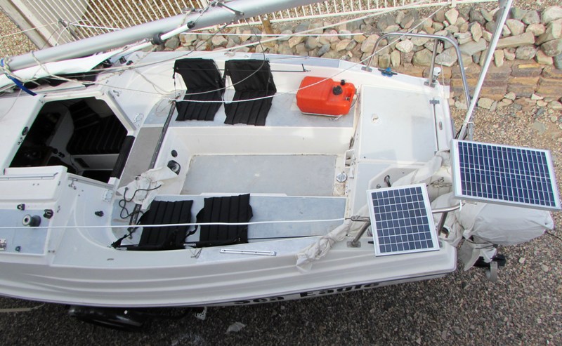

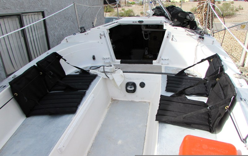

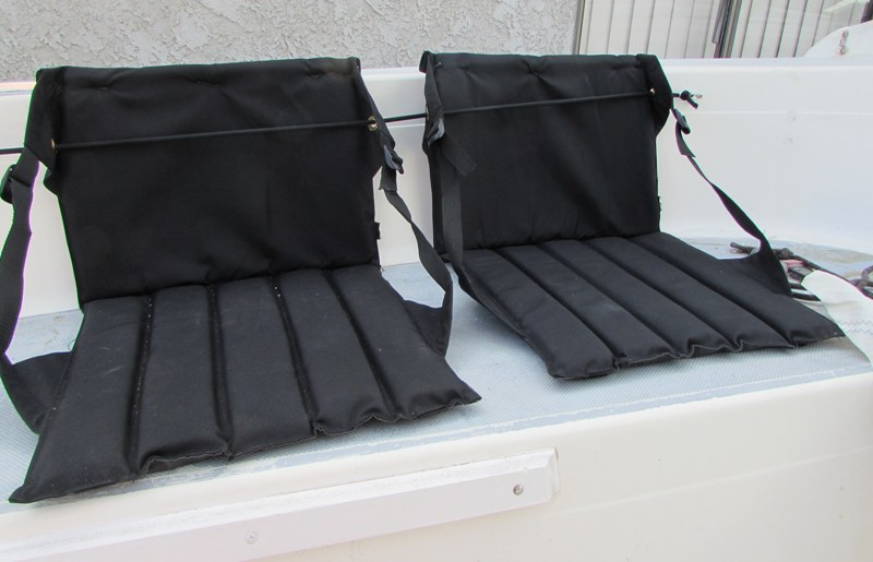

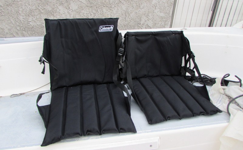

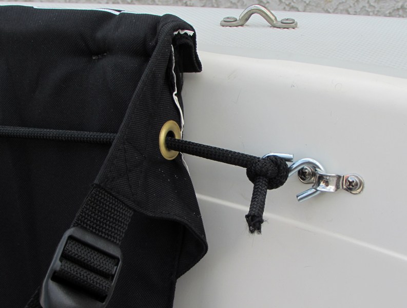

I copied Russ's idea to use stadium seats held in place by a lenght wise peice of shock cord that allows the seats to slide back and forth but keeps them in place including the seat back upright. Well.. I think that was just an awesome idea.. Thanks Russ!!!
I ordered the Coleman seats and the seat back sticks up past the boat coamings and doesnt add any support higher than the coaming so I cut the seats backs down a little. I just cut the very top of the seat back off, removed the fiberglass battens, shortened them, removed the foam backing and cut it down, then folded the top a couple times and stitched (using a speedy sticher) around each batten and a spot in the middle. Overall easy.. For how we use the boat, I think these seats are going to work out very well. I weighed the whole set - about 5 pounds plus they will aborb almost no water if rained on. The bungees are on hooks so the two seat sets are very easy to remove and easily store in the Laz. The first picture below shows the original seat on the left and the modified seat (cut the top of the seat off just above the coaming height).

Walt, how is your fuel tank secured? I am in the process of getting a gas motor and I've been looking for ways to secure a small 3 gallon tank.

Early in the ownership of this boat I made a fiberglass tray (polyester resin) that the tank sits in. I used the actual tank as the "mold" so the tank sits very snug in the tray and its never moved in all the years sailing. I think I originally had a strap as part of the tray.. but its gone now and I haven't had any reason to replace it. That is a three gallon tank and I also keep a spare 2 gallon "sealed type" tank stashed in the Laz. That amount of gas will last me about 2 months marina sailing the boat. The tanks are easy to remove from the boat for when the boat is stored - makes it easy to empty the tanks, burn the left over gas in the truck.

looks good Walt. one thing I did different was to melt an access hole and put the shock cord through the seat back, between the cover and the padding. We spent Wed and Thurs sailing/camping, so mine got a good workout and they worked great. it was in the 80s, and during breaks I couldn't feel the shock cord even with my shirt off. You can even open the laz without messing with the seats. they just fold up with the lid.
great idea you gave me there. ;)
