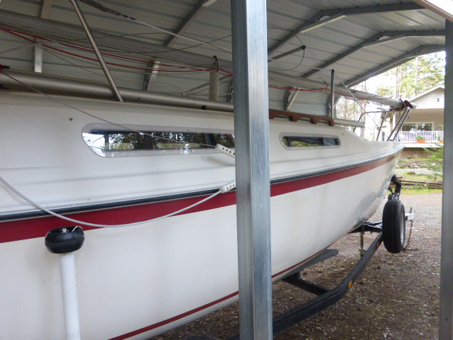

Thanks Russ. By the way, where did you get those rollers guides on the side of your trailer.

Greengas,
As with many of my modifications, the trailer guide rollers are "custom". a friend of mine owns a muffler shop so I had him bend the arms from 2" aluminized exhaust tubing, then I welded in a 1/2" diameter axle at the top to hold rollers from the mowing deck of a riding lawn tractor. they work very well.

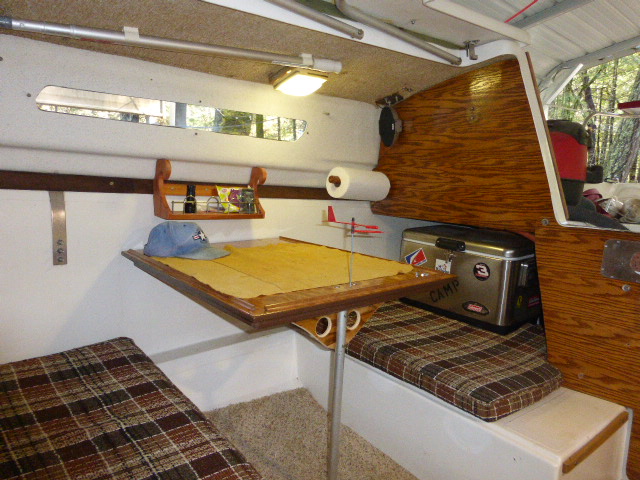

My interior is pretty basic overall. just a few home made do-dads here and there. I'm trying to create more efficient storage solutions wherever possible. efficient use of space wasn't one of the boats strong points from the factory, but it can be improved to suit your own needs with a bit of thought.

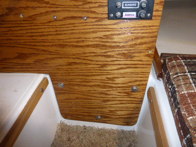

Russ. Thanks for the great photos. That was the exact view I was hoping for. Now another question. How are those boards secured to the boat?
You're referring to the plywood bulkhead??
The bulkheads, on my boat at least, have three 3/8" bolts in the bottom portion of the bulkhead that drops into the walkway, and one more on the lower corners of the companionway. the upper plywood sections are secured with small angled corner brackets screwed into the belt trim on the sides and I think the companionway door trim screws also go into the bulkhead plywood. I don't see any other support screws besides those.
If they're anything like mine, there's an L bracket at the port and starboard extremities, the top fasteners of the companionway hatch board keepers, and the bolts at the top of the actual bulkhead with the winch.

Thats just what I was thinking. Secured from the back with brackets. Thanks so very much. It feels good to know im on the right path. By the way, is that 3/4 or 1/2 inch plywood.
Mine is 5/8" but quality 1/2" should be plenty, and is a bit lighter.

I cut and installed some of the rubber backed carpet runner under the table and down the hall today. I'm really liking this stuff (from Home Depot) because it lays down really well and stays where you put it. no sliding around, soft on the feet. easy to clean, etc. etc.
Also fabricated an extended nose guide, with some carpet scraps glued on for gouge protection. and then relocated the winch up about 2" so it pulls the nose straighter in to the V block, rather than down.

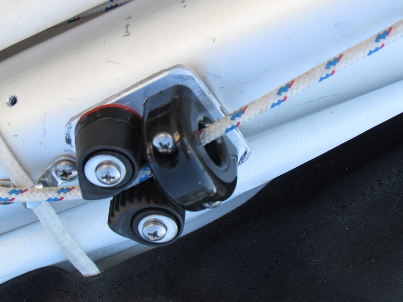

I have a loose foot main with a 4:1 outhaul and use this fairly often. The 4:1 part works nicely but I wanted to improve the cleat so messed with this yesterday in the back yard. At one time I had ran the outhaul line back to the mast, down the mast, to the cockpit but I just dont like all the rigging hassle (personal preference..) so moved the outhaul cleat back to the boom. Pictures below tell the story.
Picture below. This is the change I just made. This is on the underside of the boom and when you need to tighten the main in high winds, there can be a bit of force involved so I wanted a nice fair lead with a direct mounting to the boom. The cleat is behind the fairlead which isnt completely optimal but the other way around causes some issue releasing the cleat. Anyhow.. this is what Im going with at least for now. The line out of the fair lead heads towards the back end of the boom.
Picture below. This is the part of the outhaul that works fine - been using it for a long time. It has 4:1 leverage.
Picture below. This is where I have the cleat for the outhaul (black arrow). This is the old cleat in the picture and the new one is just slightly aft - but essentially in the same spot. Having it on the boom makes rigging the boat easier since its always already rigged. If you put the cleat too far back, it can be hard to get at if the sail is sheeted out. Too far forward and you have to go too far forward to get to it. This spot works OK especially since I sit fairly far forward in the cockpit for sailing (tiller extension very often used).
Picture below. This is the cleat I just removed. Mostly worked OK.. just enough hassle to use especially when its windy single handed that I decided to try and improve things and get rid of this.
Picture below. This is an option I did NOT use. Its a standard high angle fair lead with cleat. It may have worked fine.. but I wanted a more robust fair lead and better leverage since you are going to be pulling the line down - and sometimes with a bit of force when tightening the main in higher winds. FYI, this is the furler cleat on my Hobie TI - shown upside down.

Walt, that's almost exactly how I set up my outhaul. Same cleat position and everything. I haven't had a chance to use it yet but it seems like it should work quite well.
I have a similar set-up for my cunningham only it's lead to the cockpit.
