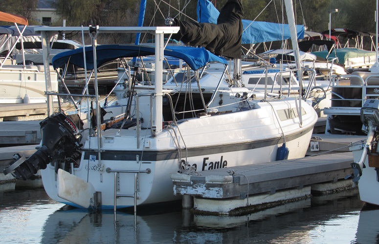

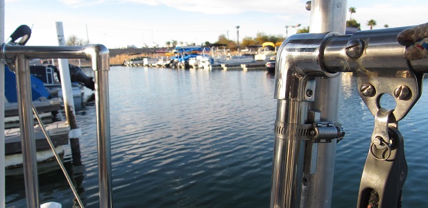

Well.. if someone wants to do some sort of calculation, I will read it but its not something I need at this point. Just pick your own assumptions. If you do cut the rear rail up to improve boarding from the ladder, the new center post strength is something you need to consider. The pictures are from last night and I was standing on the ladder and had my full weight (200 pnds) pulling and bounce pulling on the center new post only and it moves just a hair but my estimation is that it has a lot of margin strength wise and I wont have any issues. I also have the new center post tied to my permanent mast crutch pole and that also adds a little strength but most of the strength comes from the new SS tube that extends down into the inside of the Laz.
Sumner
Jan 31, 2009
5,254
.......but my estimation is that it has a lot of margin strength wise and I wont have any issues....
I'm sure you won't either. Nice work and like the fridge you will enjoy it. We started in our 60's and it was one of the first mods as Ruth at 5' 2" couldn't handle climbing over the rail and it was even awkward for me. We also have never had an issue with it being strong enough,

Sumner, I am holding you responsible for all the fun I am having with that new fridge and Im now doing some of the things you did to accommodate that like the better access on the boarding ladder.
FYI, that fridge has been on all the time now for nearly four months. Even when I am boat camping with it, I just leave it in the mode where the power to the fridge is auto shut off at night. Typical day.. batteries fully charged at sunrise from the previous day. At sunrise, fridge kicks in and uses about 2.5 amp hours before getting back up to temp (about 40F). Solar then kicks in and by mid morning the battery voltage is at 14.4 and sits there for one to two hours. Rest of the day the battery voltage sits at 13.8V. During the day, I can hear the fridge running and the battery monitor will show zero current into the battery meaning the solar is completely running the fridge. 160 Watt has been way more than adequate for my winter slip use including being very easy on the batteries. We will see how it does this summer.
And.. its been nice to have a high power electrical setup where I never worry in the slightest how much power Im using. That big panel and fridge is not for every one but it was a good thing for me after 11 years of owning that boat to get enthused about it again.

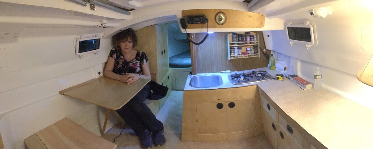

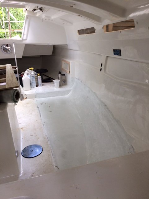

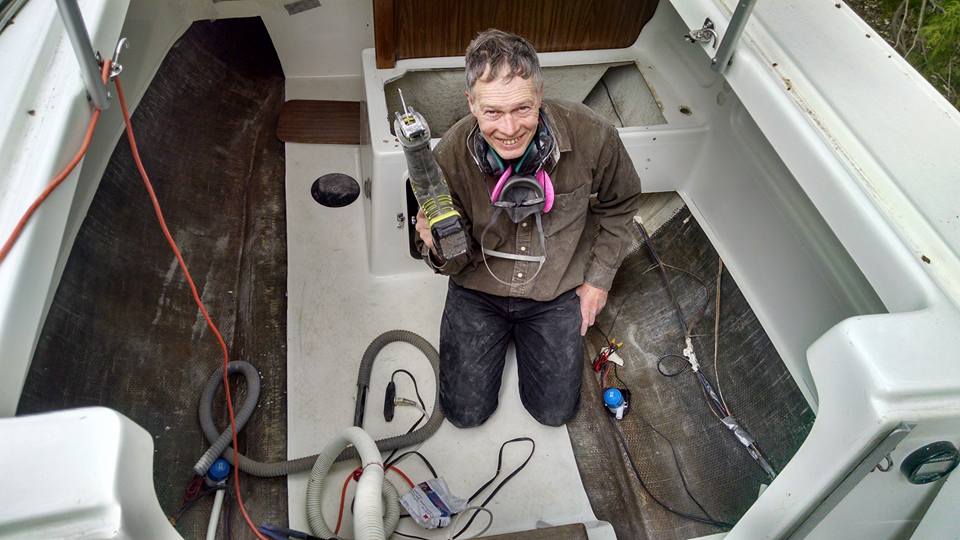

I've been absent from this forum, but I see there are questions.
Wow way cool! Gives some great ideas. Can you tell me what you used to replace the liner where you cut it out? Did you just cover with wood or find some other substitute?

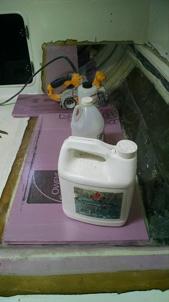

Mostly with a cordless sawzall plus various other implements, I cut out the two settees, exposing the inside of the hull and top of the tank. Then I ground and sanded back the raw edge of existing hull liner. I didn't want to use wood or anything that would rot, so I set rigid foam sheets in where I wanted a new surface to be, and used squirt foam (Great Stuff) as both adhesive and to build up the surface in some areas. Then I carved and sanded it down to the shape I wanted. In the photo I've got various objects weighing down the foam while glue sets.
Next came many layers of fiberglass with epoxy (West Systems) over the foam and onto the tapered edge of the hull liner. This was then skim-coated with auto body filler (Bondo), sanded smooth and painted.
One mistake I made was to glass right over the inside of the hull. When it is very humid (coast of Maine fog) condensation forms here. I should've laid foam as thermal insulation between the outer hull and the new surface I made.

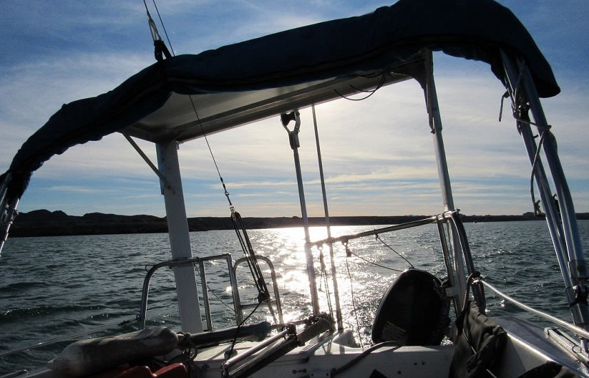

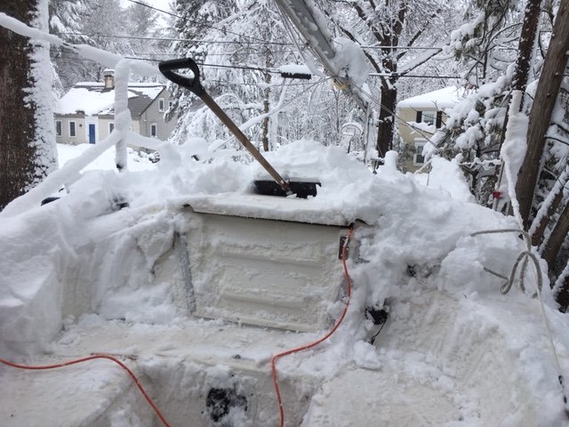

posting too many pictures again.. but it was a fine day today. Rolled up Bimini is held in place with a strap to on the backstay. Third picture.. dog potty break stop.

Oh man...... that hurts just to watch :(
Yep, I use to shovel the snow off and one year tried to build a shelter over it, but now if I don't need to be in the boat I just let the sun take care of the problem. Might take a few weeks or a month or so but eventually he gets around to it,

When I opened up the back railing to make access to the ladder easier, a new problem showed up which is the back stay being right in the way of where you step up. My back stay has a quick connect at the bottom so I added a second place to clip the back stay where its over to the side. Clipped over to the side when the boat is on a mooring or beached. Clipped to the chain plate when Im using the adjustable back stay for sailing.

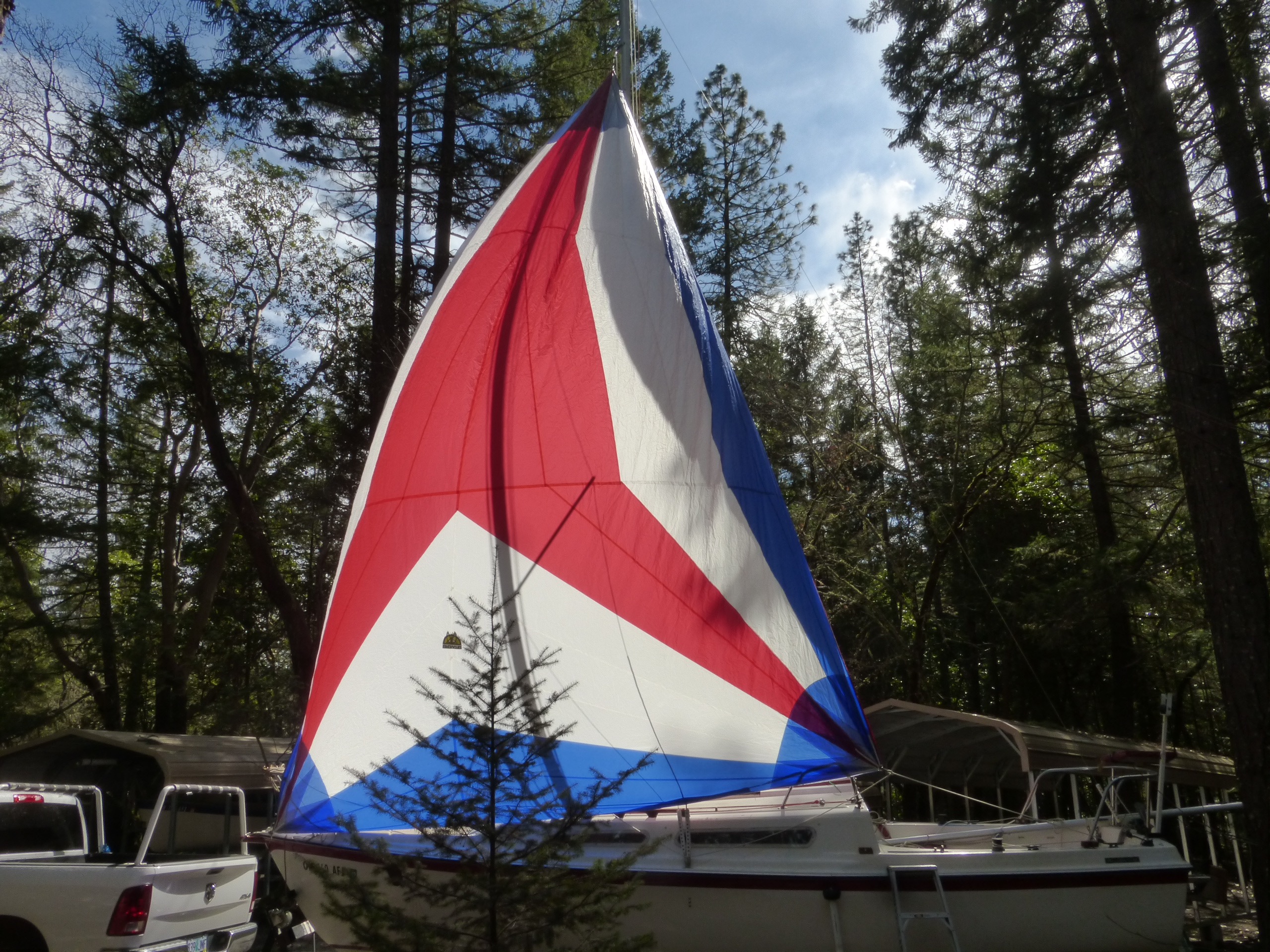

Went for a little "trailer sail" today. I needed to check the line lengths needed for my new spinnaker, so I raised the mast and pulled it up. there couldn't have been 1 mph of wind across the beem today, yet it easily billowed the lightweight sail. very excited to test it out on water next time ;) .

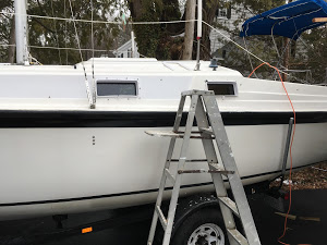

Those old windows we thought, this will not do.
So, out with the old and in with the new!
Cutting, chiseling, scraping out goo,
fitting and cutting for a better view.
The old plexiglass is sharp, beware!
Amarine window ports look to be fair.
They can be opened to let in some air.
If it leaks a little, tighten just a hair.
A boat can be recognized from the shape of it's ports,
That is a distinctive form, of course.
Eclipse is now all out of sorts;
Is that really a Mac? Will be the retorts.
