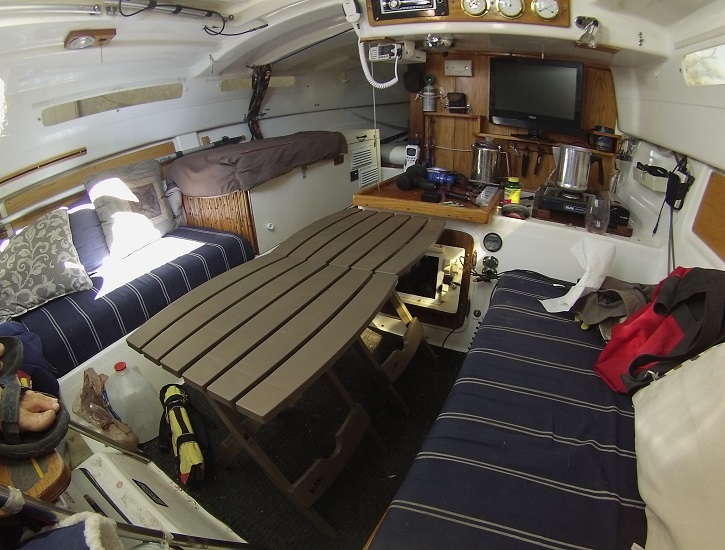

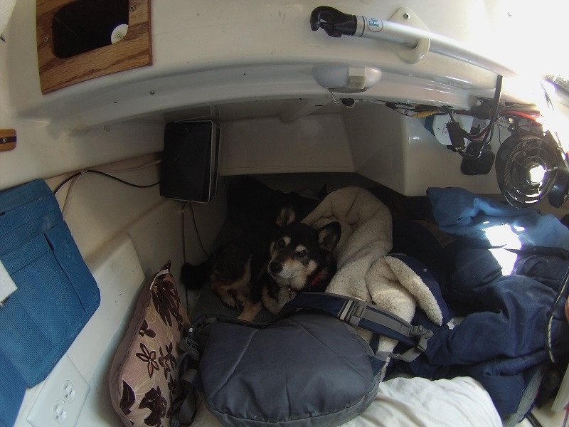

Getting ready for a road trip with the 26S. Times like this prep that I appreciate the under 3000 pound towing weight, no trailer tongue extension and in my case only one axle/ wheel set to deal with. Staying five nights in a slip with the solar powered fridge so will get so see how things work in this case where there will be lots of unavoidable shade from other sailboats.
First picture below.. I sort of got excited about these cheap little folding plastic tables I picked up at Walmart (Ozark trail brand). I never saw a good reason for a table in the cabin but my wife may like them. I really bought them for happy hour on the dock/ slip. The folding tables should get a lot of use year around. They only weigh maybe one pound each and cleverly fold up.

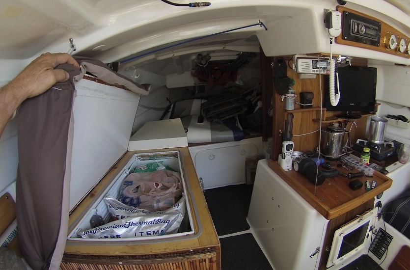

Picture below. I have the electric ice chest all loaded up nearly 24 hours before leaving and running off the house AC. Its a little full.. a few beers may have to be taken out to fit other stuff. I am going to try and fit one frozen gallon jug of water in there for the about eight hour drive where the fridge will be just shut off. Fridge may run just fine with the vibration of trailering.. but Im not going to find out.. it will be turned off.
Up in the Vberth is an inflatable stand up paddle board and the two foldable tables shown in the first picture. Also a ton of other stuff like the camp chairs and bins for human and dog food.

An update on my solar experiment.. The frozen one gallon of water that I was going to put in the ice chest did not fit.. so I just threw a blanket over the ice chest for the drive. The fridge was turned off for the eight hour drive but once we got the boat in the water and turned back on the fridge, no problem for the 160 watt panel, we were in float (13.7 volts) by sunset.
During the evening, I used the lap top computer, charged cell phones and the wifi hot spot about .6 amps of LED lights and watched TV in the boat. We ended up with a deficit of about -7 amp hours at sunrise. Yesterday was cloudy and even rained for about an hour. The boat stayed in the marina all day with the fridge on, lap top and other electronics and a little TV used. The fridge turned on a sunrise and ran up the charge deficit to -9,5 amp hours before the solar (even with the clouds) started to run the loads plus make up the deficit. By about 1 PM, I was back to a net zero amp hour use and the solar was supplying all the power. The battery voltage got up to 14.4 and then by mid afternoon was sitting at 13.7 volts float. During the morning, I even saw 10.2 amps going into the battery.
Another data point that a well placed 160 watt panel (effort spent to reduce any shading - this panel happens to be monocrystaline but that likely doesnt matter much) is adequate for a heavy power user (electric fridge, lap top, TV). Still plenty of margin in use and Im also being very easy on my batteries.

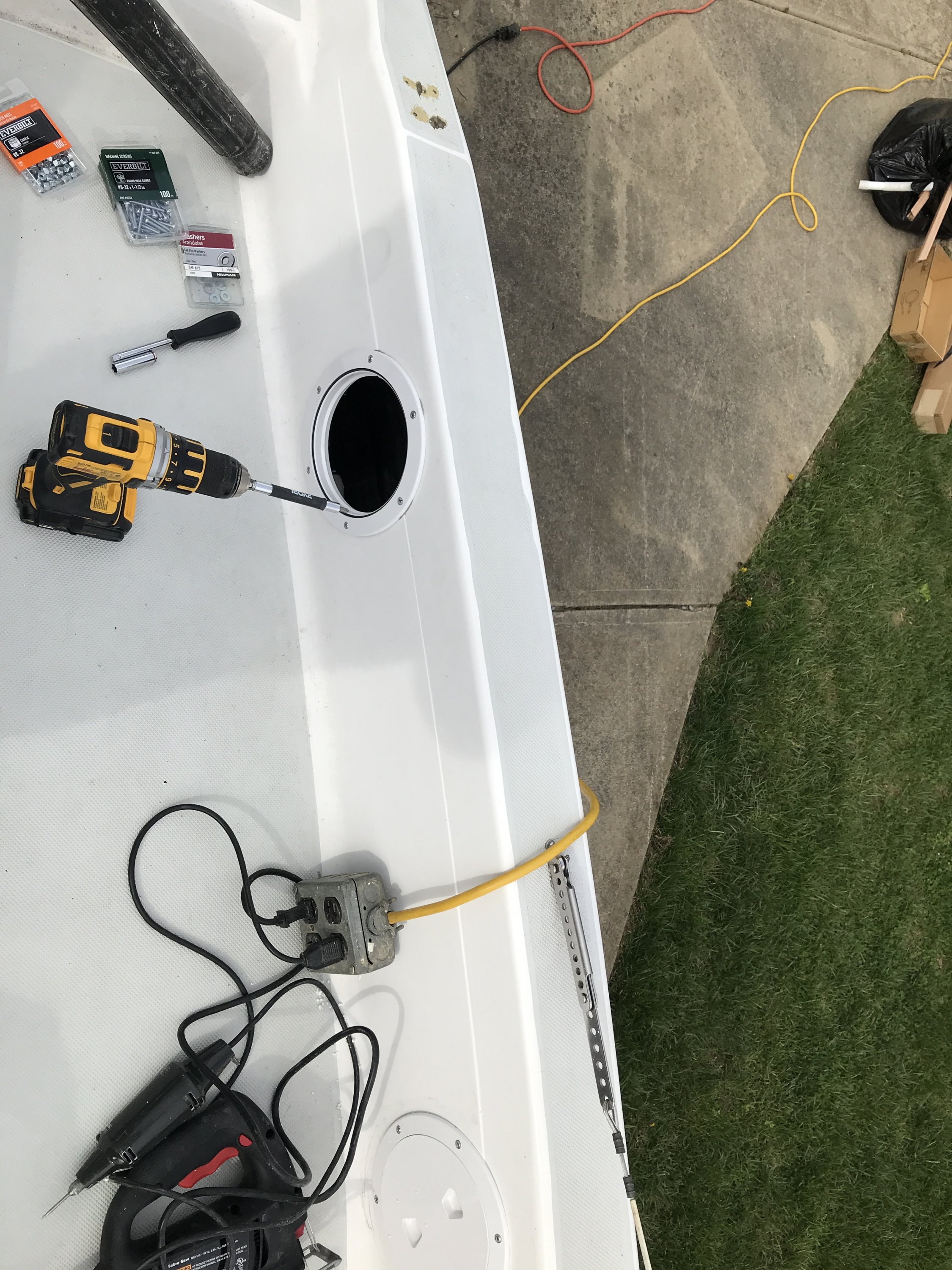

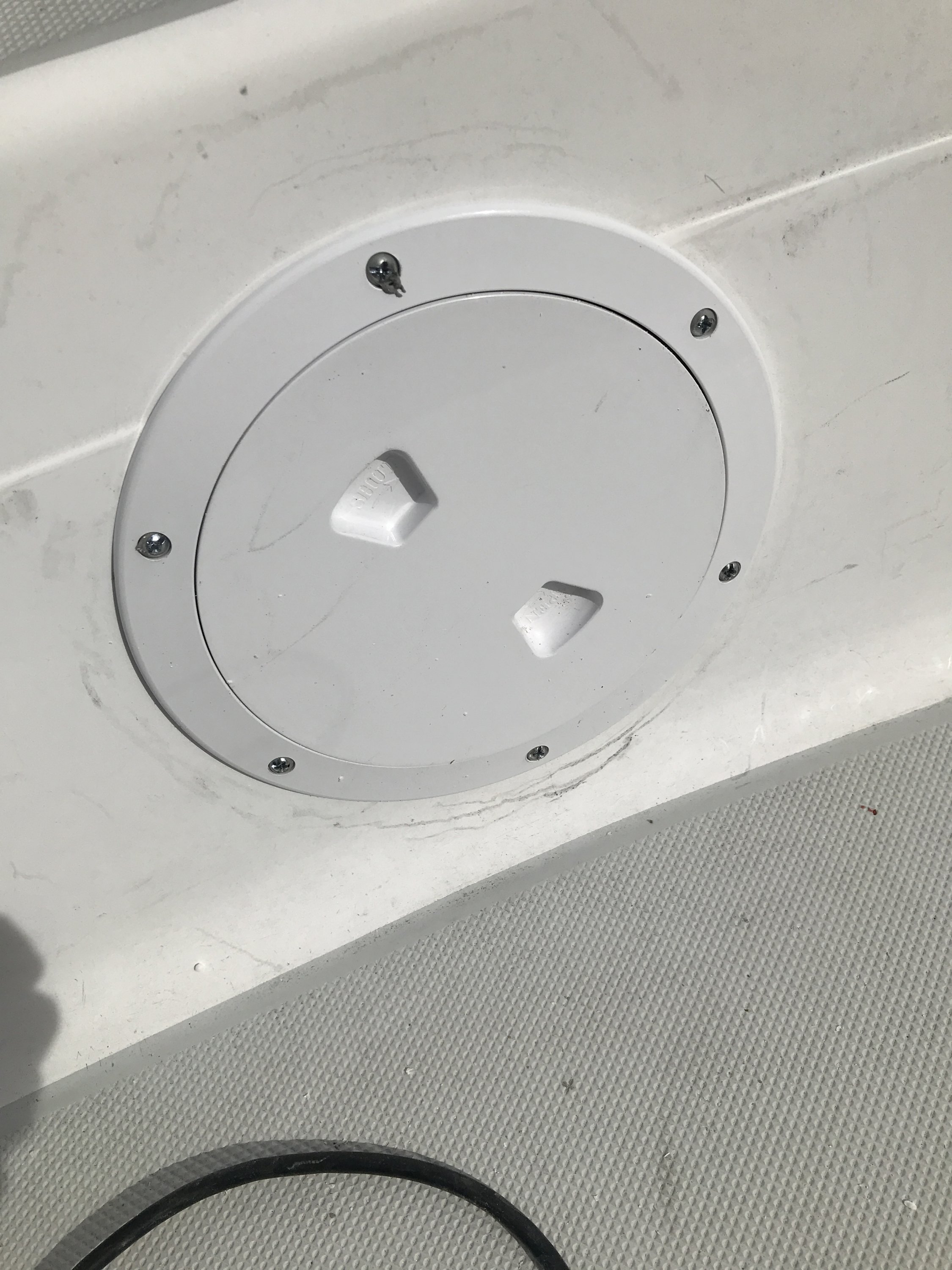

Last year while trailering the Mac a screw pulled out on the Bimini rail (you read that right). I couldn’t believe it was just screwed in. Well, I thought I’ll fix that and just bolt it back on. That wouldn’t work because I apparently don’t have enough joints in my arm to get where the nut would go. Not one to give up, I decided to put access hatches in and reclaim the space. If you want to debate the floatation removal please join one of the current threads as this is not the one . I’ll be adding to one of those threads.
I put in four access hatches, two on each side. Thumbnails attached Used half a role of butyl tape to seal em up.

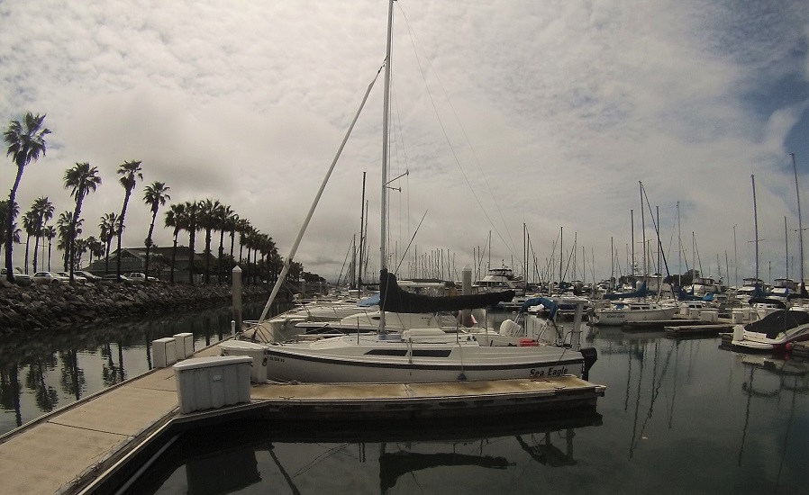

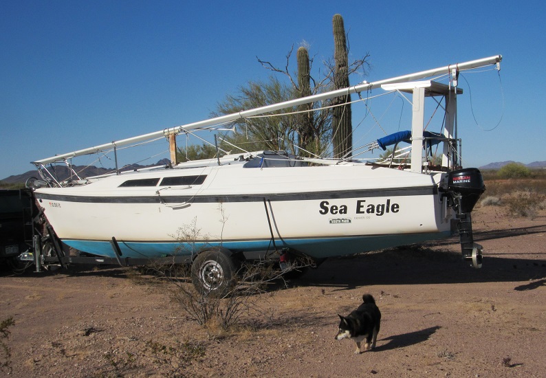

Sailboat/ dog pictures from what may have been our last sail until next fall (on the old 26S, Hobie TI is getting dusted off now)... First picture is from a very pleasant over 10 mile downwind sail from near Shelter Island to Chula Vista less than a month ago. Centerboard was pulled up completely into the hull and under auto pilot for almost the whole run.
I ended up epoxying small squares of plastic (cutting board) to the outside of the boat and screwing into that. I had drilled a number of holes in each location trying to get something to hold onto the thin fiberglass in those locations. I wasn’t willing to drill large holes or bolt the bimini on...

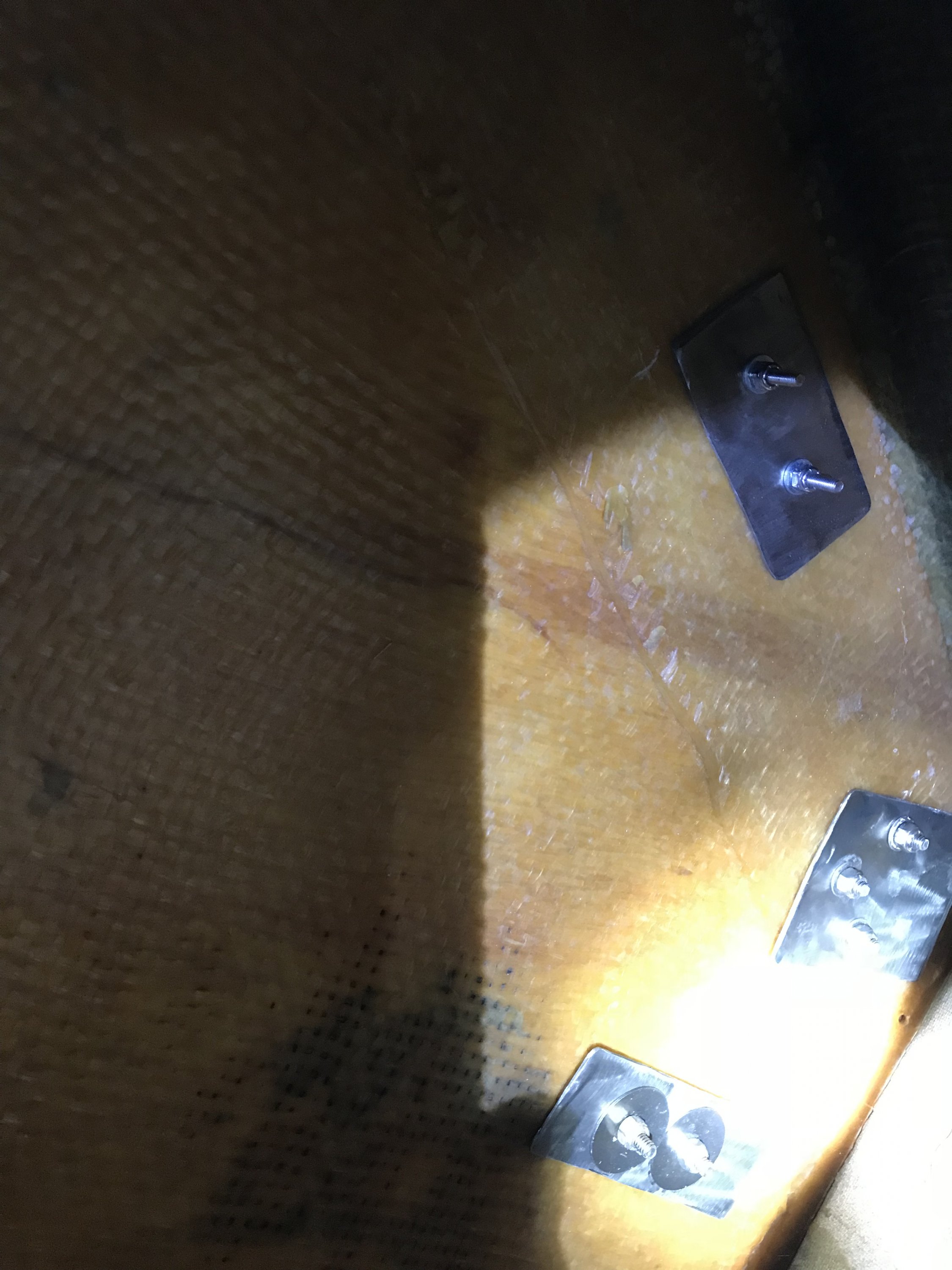

On one of my last overnights discovered rain water coming through the flotation hold above the v-berth. ... then removed all of the deck hardware (3 cleats and 4 stachion bases. ...

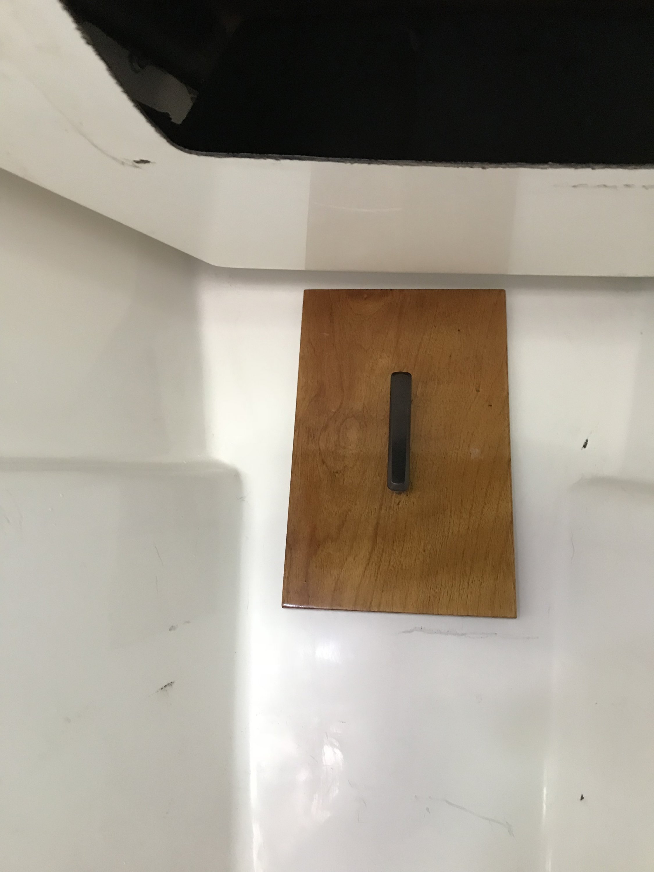

Also, while in the v-berth, cut a hole to make an access panel to the bow.
Some follow up pictures of the backers behind the rebedded hardware. A friend help me cut them out of some stainless steel sheets I had.
I reclaimed a drawer front to use to cover the new access hole I made. I used a trick I learned from a grandfather clock I inherited to avoid hinges. There is a shallow slot at the bottom edge and a tall or deep slot in the upper edge. Slide the door top in as far as it will go and then the bottom goes in and slides down in place. Reverse to remove.

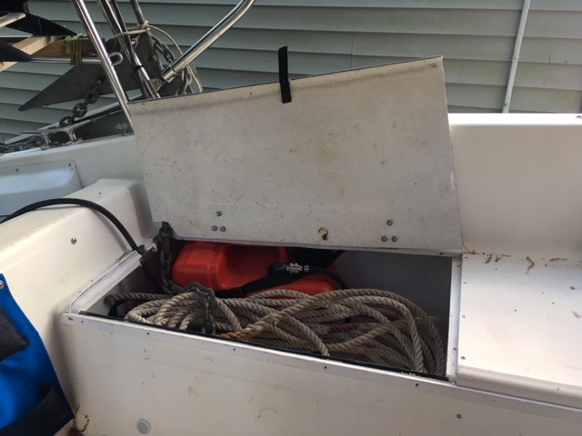

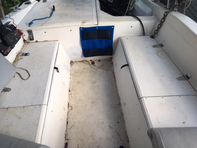

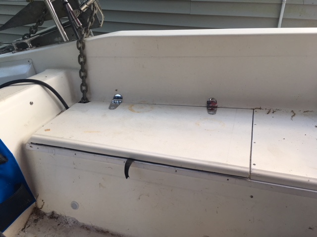

With this post, I guess I must join the 'don't need foam' club. I've added port and starboard cockpit lockers. They both have drains and are vented. I fiberglassed the inside to separate them from the cabin.
On the port side is the fuel tank and the aft anchor rode. Starboard is sunscreen, water bottles, spare pfd, etc.
I also added a bracket for the aft anchor. I've found the aft anchor very helpful in tight situations, and having to dredge it out of the bottom of the lazaret in an emergency doesn't work. Now it's ready to deploy quickly.
A few weeks ago we came to a marina to pick up a friend, but were caught off guard by the currents pulling us too fast in to the dock. I was barely able to get the aft anchor out of the laz, deployed and cleated before we hit, but now I can do that quickly.
