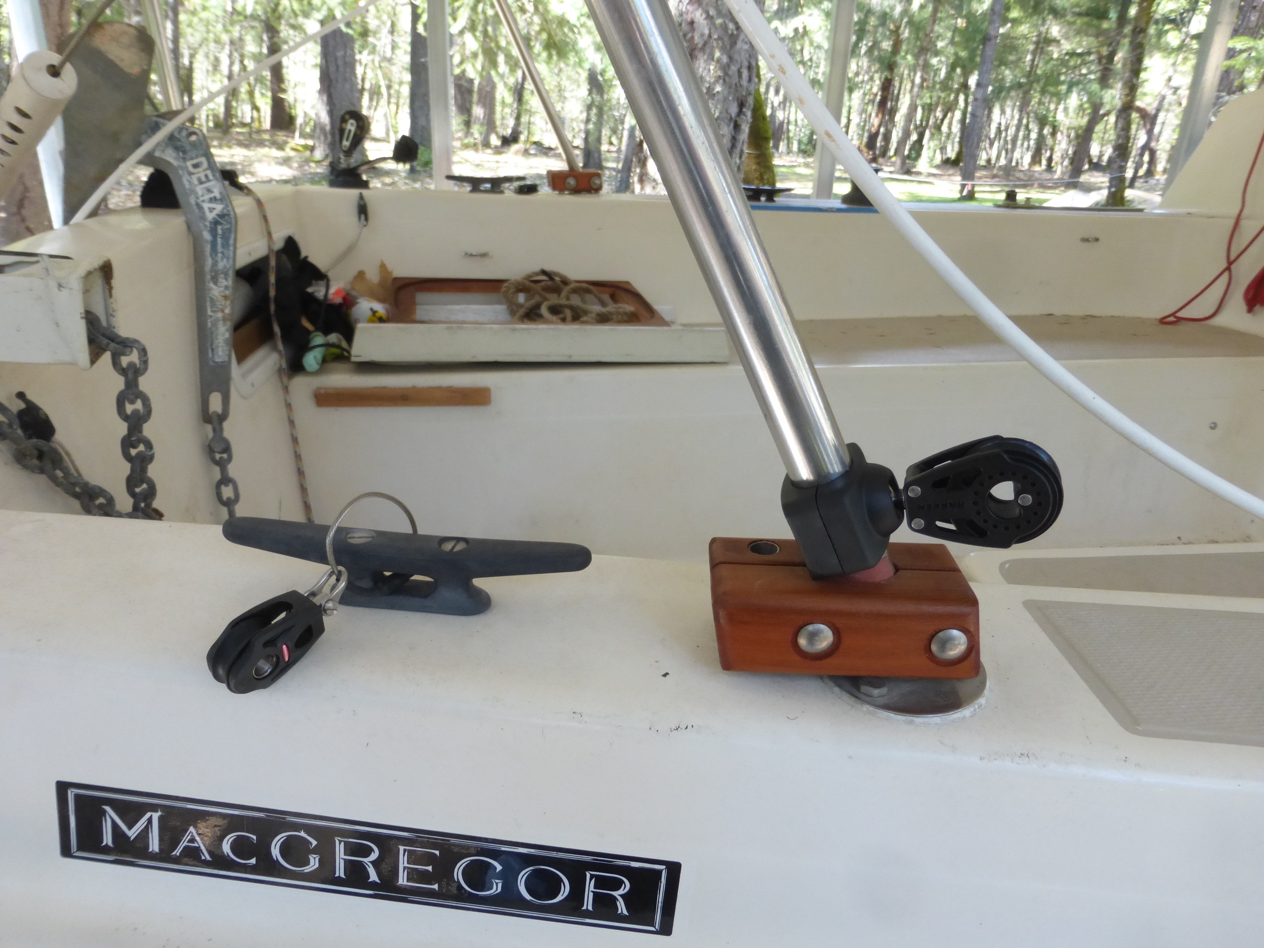

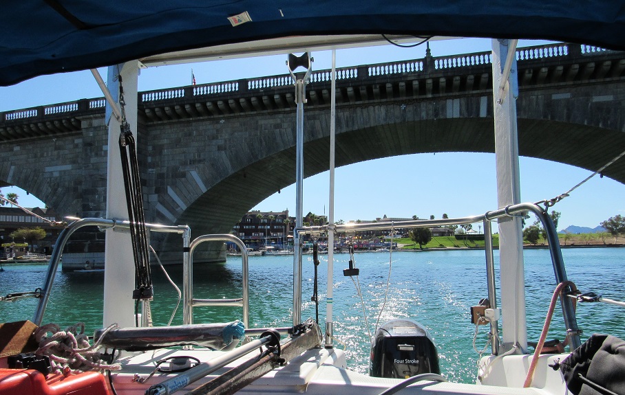

I love it when I dream "I wish they made a [xyb]" and then discover they actually do ;) . I wasn't thrilled with the "cable through the horn cleat" arrangement of my spinnaker sheet blocks, and found these very cool Harken stanchion mounted swivel blocks to replace them. After the photo, I cut the ones on the horn cleats off. I'm much happier now ;) .
Feb 20, 2011
8,062
I'm so much happier now
What's the block(s) of wood doing there at the pulpit base? The lower you can mount your turning blocks, the less force you'll apply to the tube and mounting fasteners.

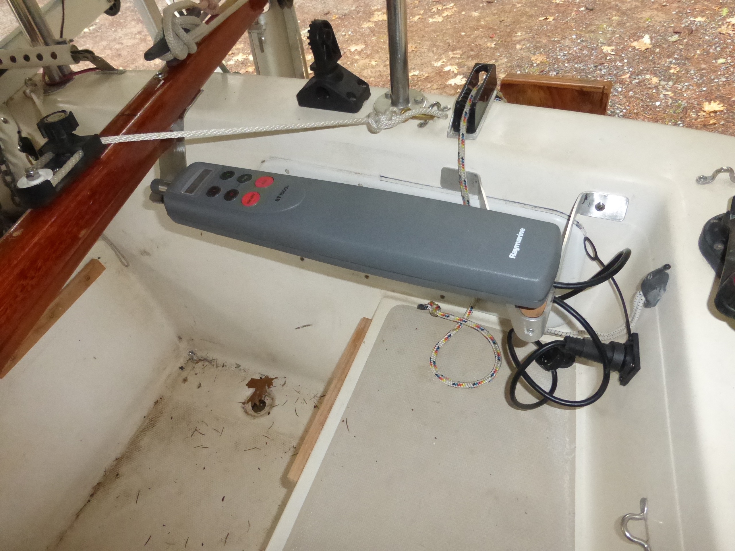

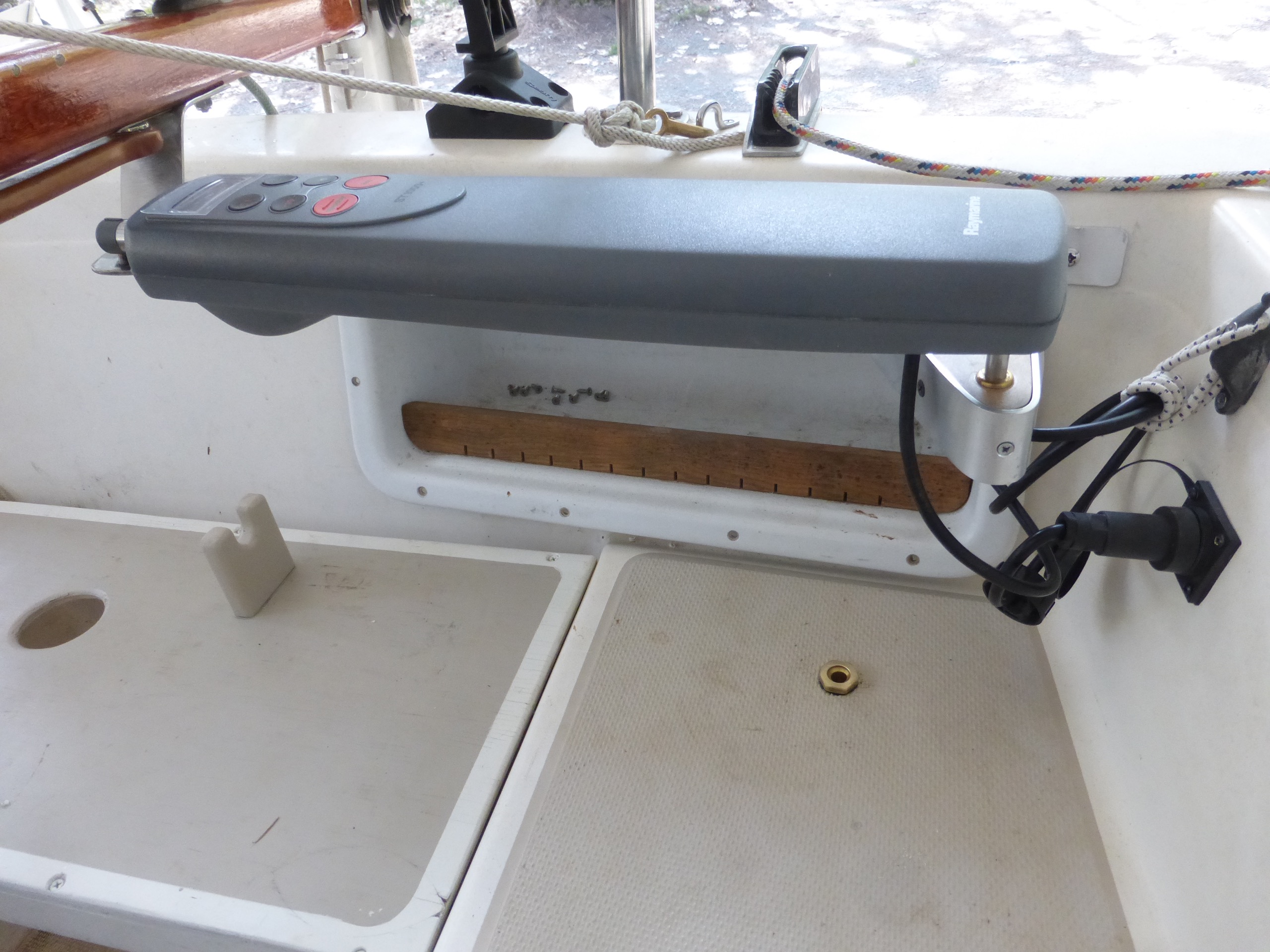

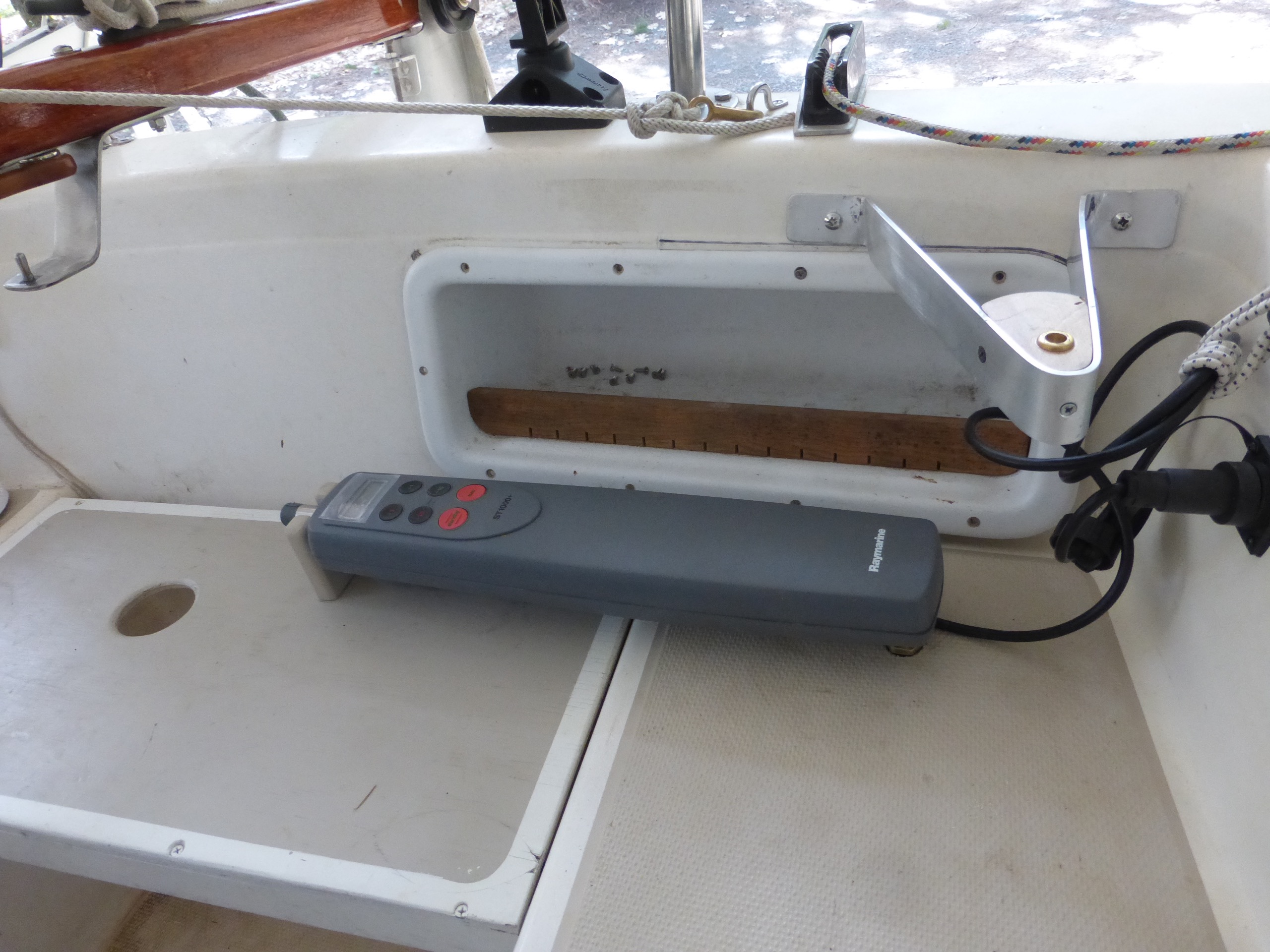

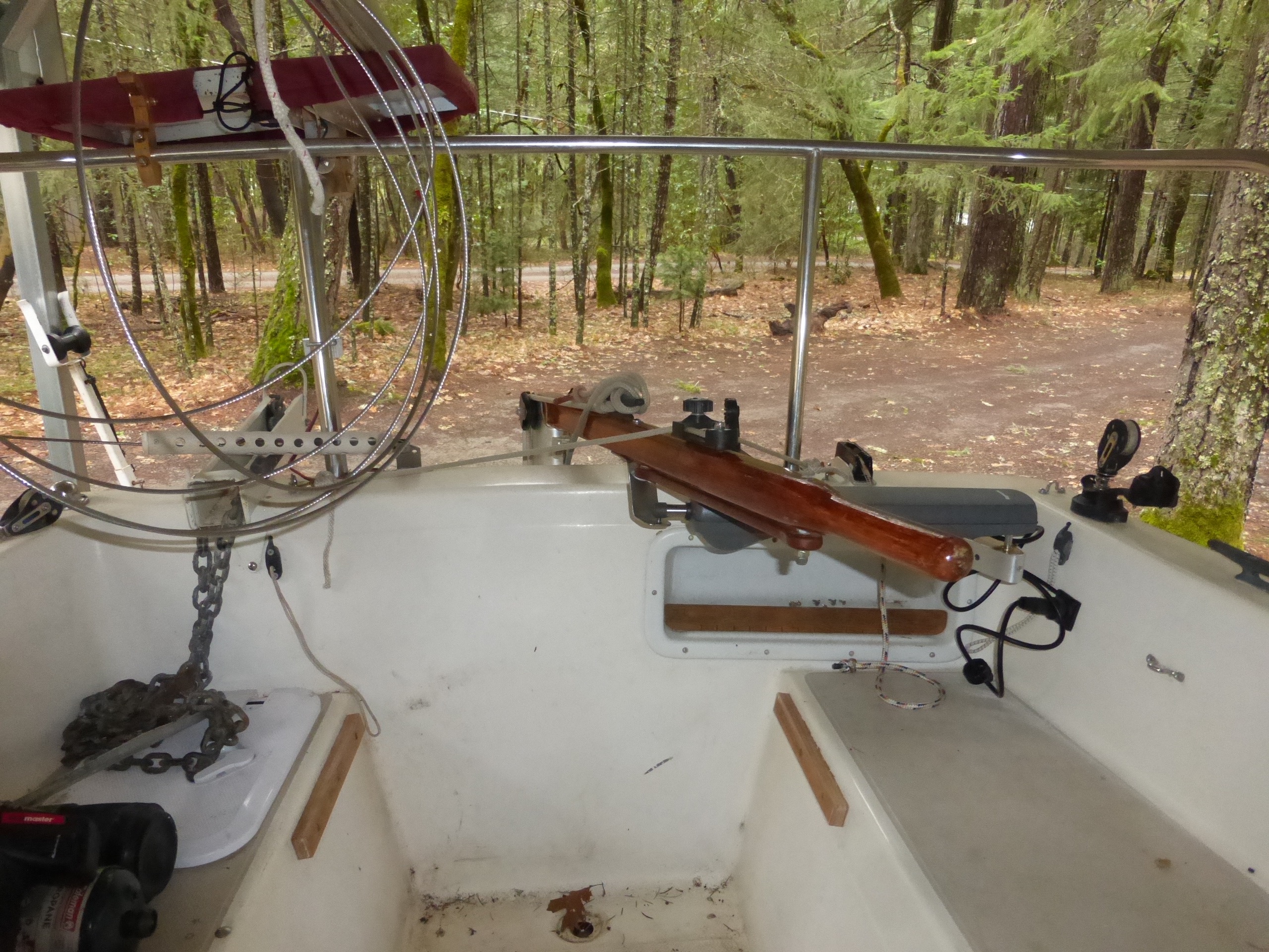

With the new Spinnaker, drone, and KAP to deal with this season, I may have more to do than I have hands, so I finally broke down and bought a tiller pilot (Raymarine ST1000+). I have mixed emotions about using one, but I'm sure there will be times when I'll be glad to have it available.
In typical project creep fashion, it also became obvious that I really need to spruce up the electrical system as well. it's quite a rats nest behind the switch panel. It's long overdue anyway, and I've been wanting to add some device charging ports in the cabin,....... Sooooo. I've ordered two complete switch/fuse panels, a couple charging ports, and misc wiring goodies to do a full rewire of the boat. oh joy, I can hardly wait ;) .

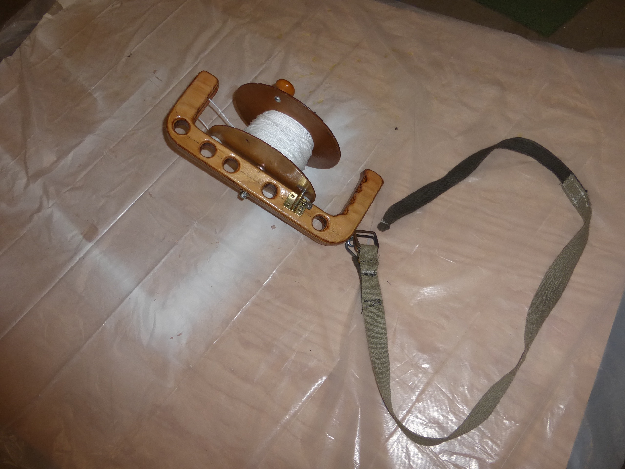

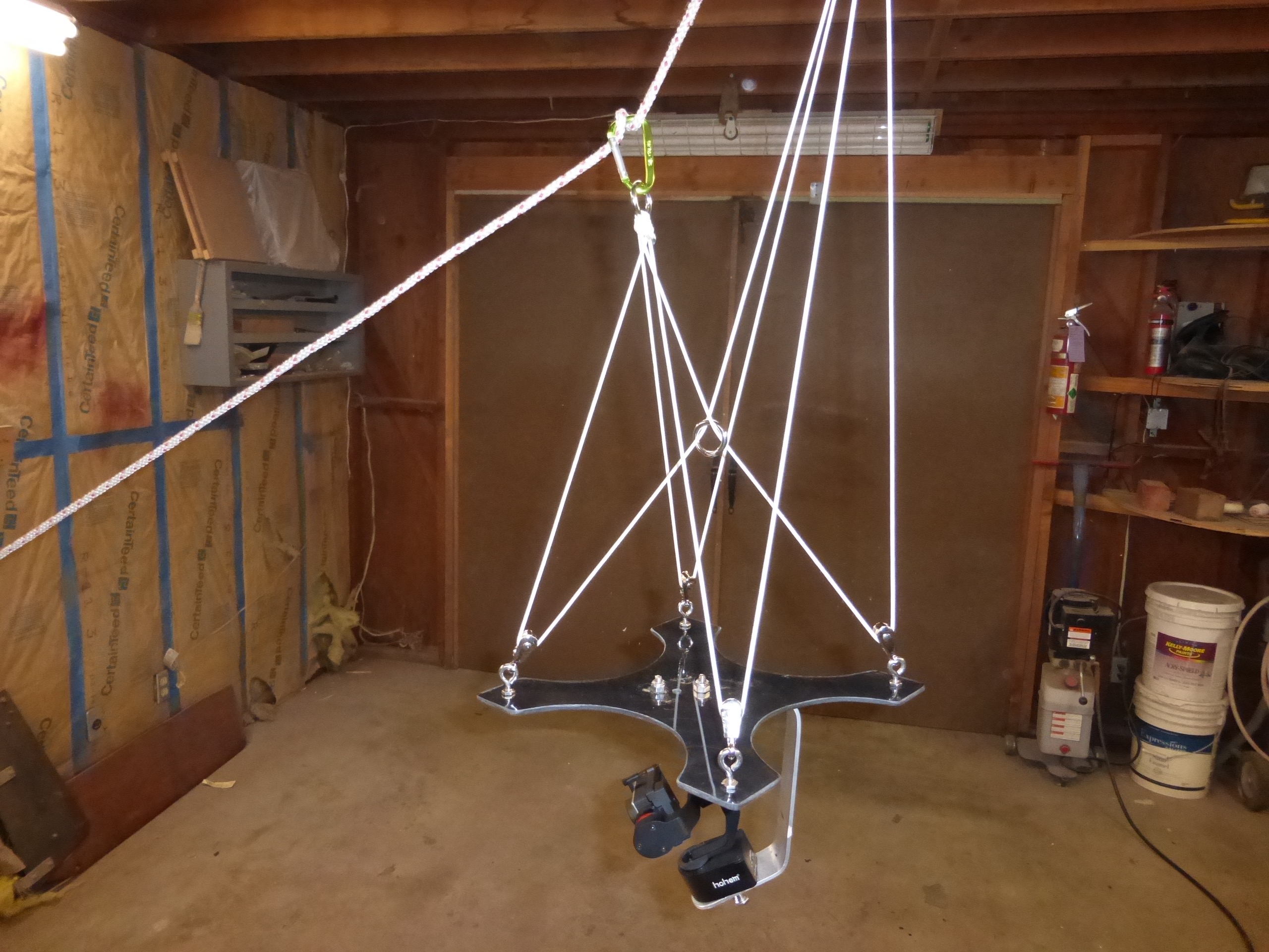

Another project I've been working on is a KAP (kite aerial photography) setup, which may prove to actually be more useful for sailing footage. it's a large kite (power sled 24) with a home made picovet camera stabilizer. I tried it out at the coast last week and found it to still be a bit shaky for good video, so I've added a 3 gimbal stabilizer (Hohem) to the picovet/Go-pro. I'm taking it tomorrow also for a test if there is decent sailing wind. I'm thinking the drone will be good for very light wind only, wile the kite can handle pretty much all I can handle ;) . There are two swim docks on one of our main lakes, so I plan to take off and land the drone from one of those. landing on the boat, or having my wife catch it, does not appeal to me (or her) at the moment.
Holy cow. Kindred spirits or what.....I too have built a picovet which I haul up with a gorgeous Ghost delta. The original plan was to launch it off the stern rail - just haven't done it yet. Tried it in the soccer field and like you, found it a bit wobbly for stills (time-lapse mode on GoPro). Video was okay though....still wiggly. I didn't go the gimbal route though - I shelved the picovet with intentions of replacing the eyelets where the line runs through with bicycle chain link (acts like a small bearing). Haven't done so yet.
A chain link might work pretty slick. good idea. I installed some cheep hardware store blocks and it did help smooth things out a great deal, but not enough to make what I consider "good" video. thus the gimbal. might be able to eliminate the picovet altogether, but I already had it so I used it. might prove simpler to launch without the picovet, but I'll try it this way first.

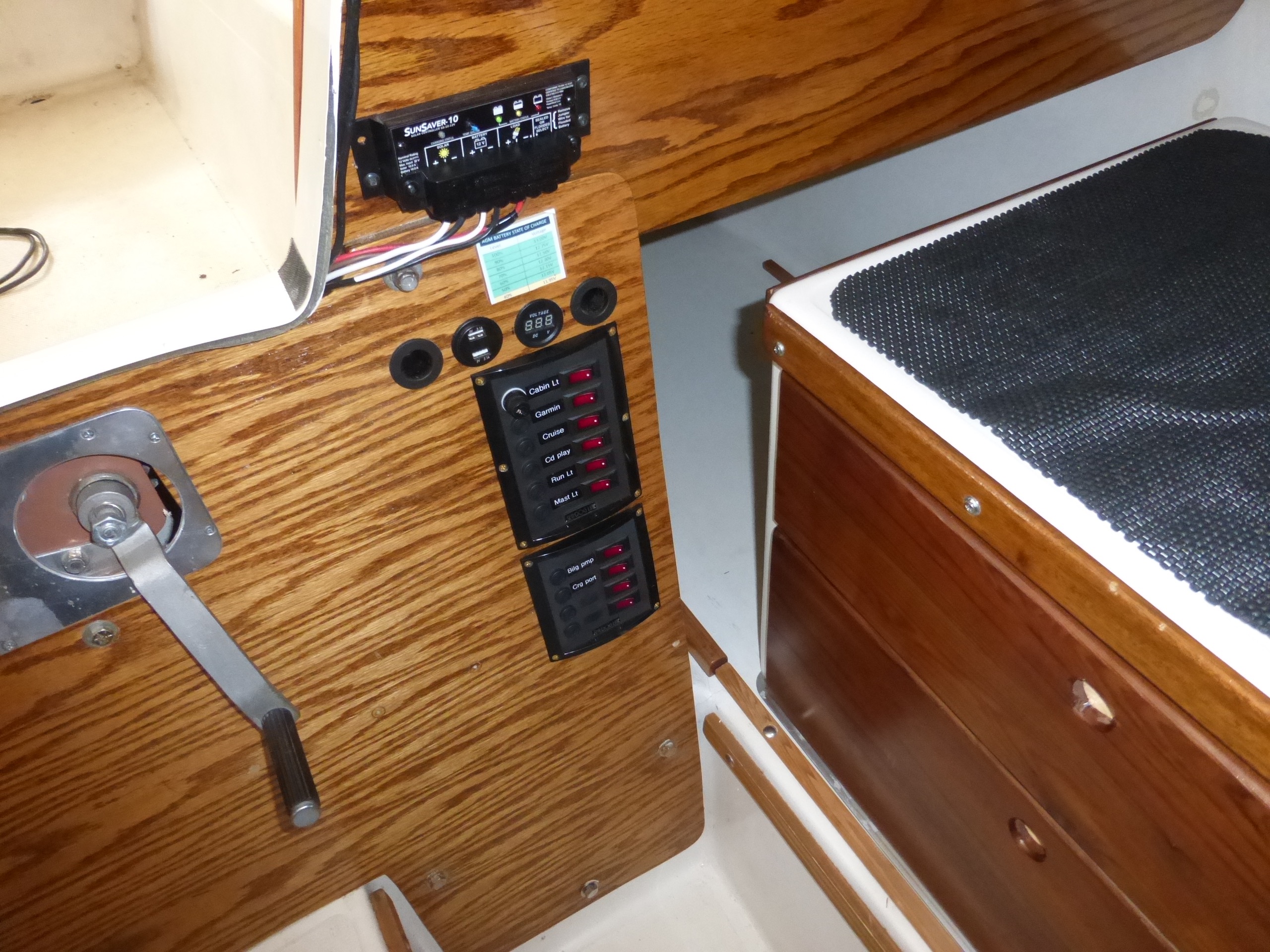

Got the new switch/fuse panels installed today and ALL the wiring replaced :confused: . there were basically two colors of wire in the entire old rats nest. red and black.... well, except for the sections where speaker cord or green/yellow trailer light wire was spliced into the middle of an area where they ran out of black or red :eek: .
I tried to use a unique color for each +circuit and black for all ground circuits. each wire is labeled where they terminate at the switch panel etc. a new main fuse is now located next to the bat+ and every circuit has it's own rated fuse as well. I also added (4) USB and cig lighter power plugs, along with a system volt gauge, above the new panels.
On a side note, I picked up a Brother label maker at Staples and was amazed at the low price of $24.95 . High marks for being very versatile and easy to use. all the wire labels and the switch/fuse panel labels were made with it. model P-touch PT-210

As long as the boat was a mess anyway, I also added a "storage rack" to hold the new Tiller pilot, below it's service location, when not being used.

On a side note, I picked up a Brother label maker at Staples and was amazed at the low price of $24.95 . High marks for being very versatile and easy to use. all the wire labels and the switch/fuse panel labels were made with it. model P-touch PT-210..
The work looks nice!! Like the compartment for the auto-pilot.
Having a label maker is nice. We bought the more expensive Brother's PT-2730 and love it. I just looked at current prices for it and know we didn't spend anywhere near what they are asking now.
