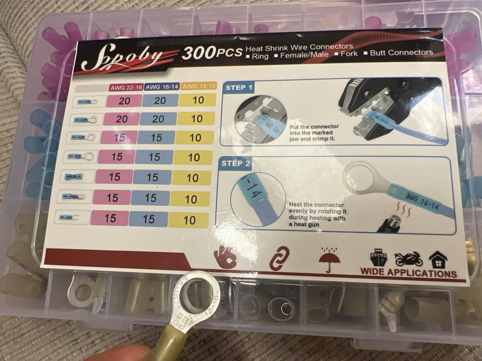

Would you use these on your boat?
Amazon purchase. I don’t want to create headaches down the road…
Mar 6, 2008
1,534
The bottom 3rd icon from right is a ship. I guess it can be used in marine environment. Is there a statement on the box that it is made out of stainless steel?
Feb 16, 2021
549
Hunter Legend 35.5 Bellingham
It is non magnetic. The product descriptions claims it is tinned red copper, but a light scrape of the surface with a sharp blade doesn’t expose copper…

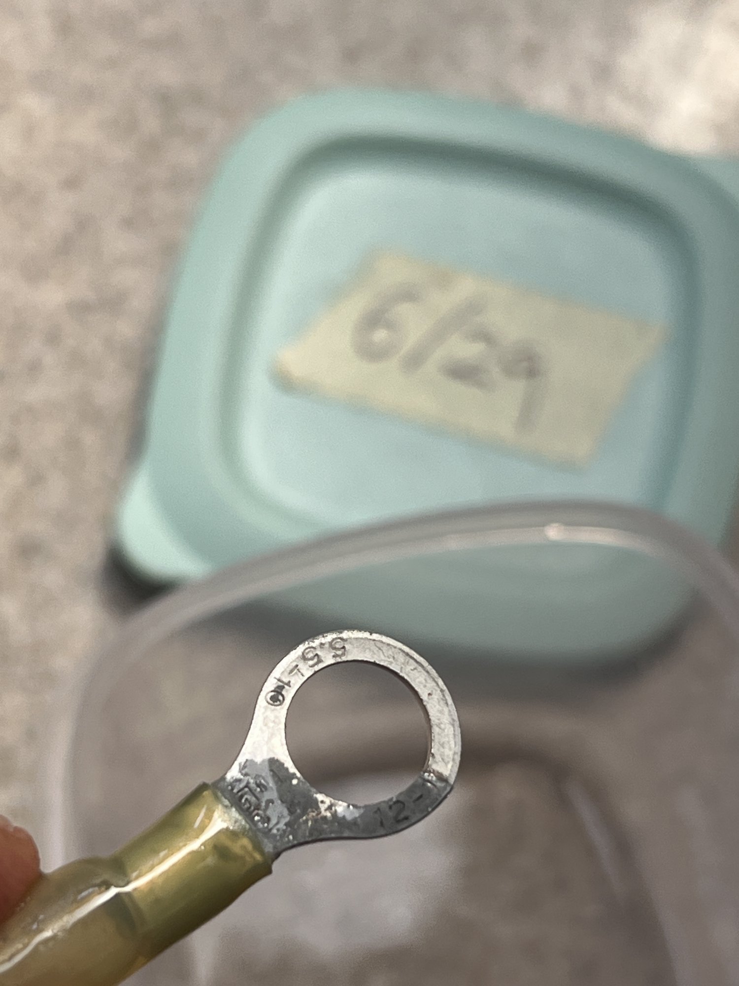

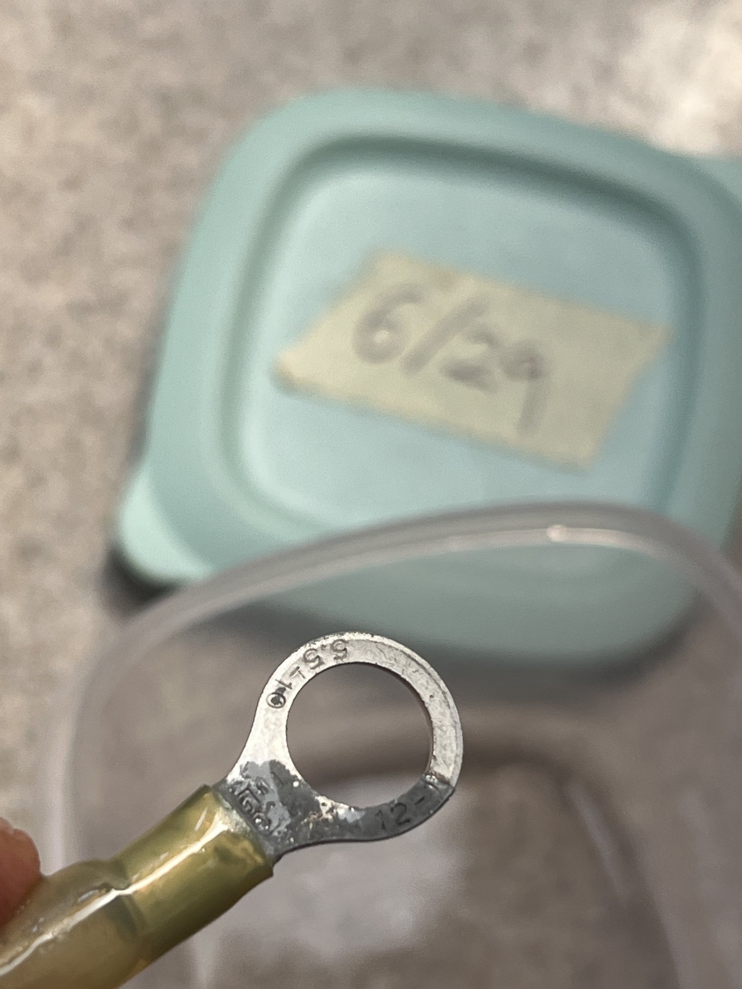

Here’s an image of one of these connectors after I cut it and submerged in salt water for 36 days. Do marine grade connectors typically hold up better? Or is this on par?
dLj
Mar 23, 2017
5,276
Was this a standardized test or just something you tried? If it was a standardized test - what was the test method? If it's just something you tried - no one can answer your question.
dj
24,951
You might want to experiment with some marine labeled connectors. I think pretty much all of them corrode when immersed in salt water.
Likes: BigEasy
14,302
Clearly the tin plating is eroding. The exposed metal does not look like copper. Cut the fitting so you can see a cross section to verify that is is copper.
