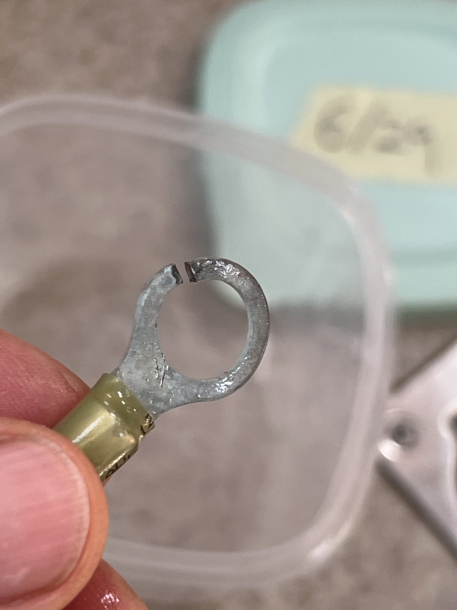

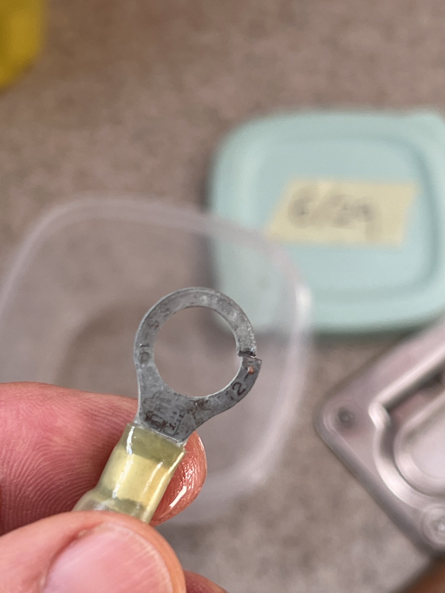

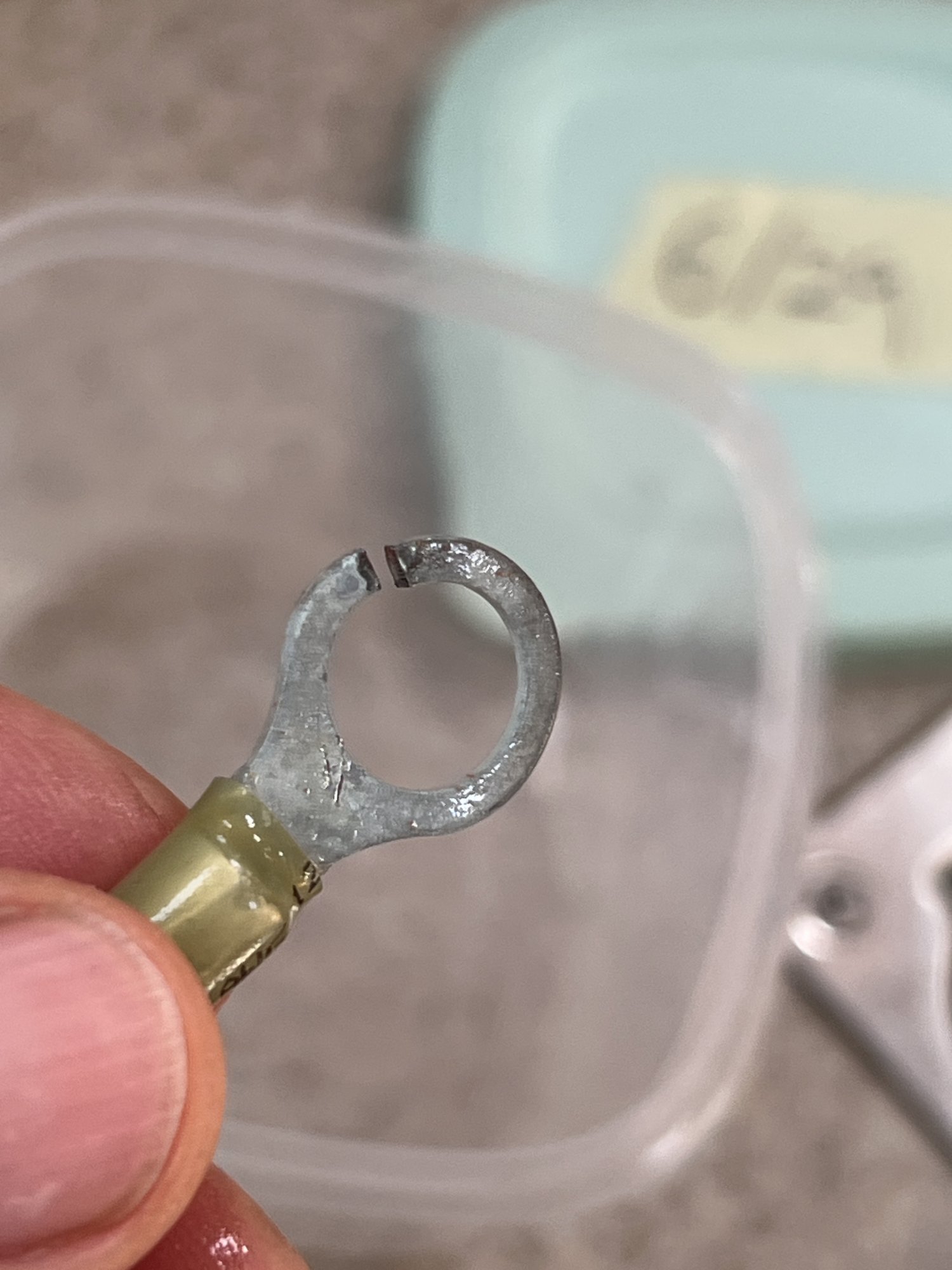

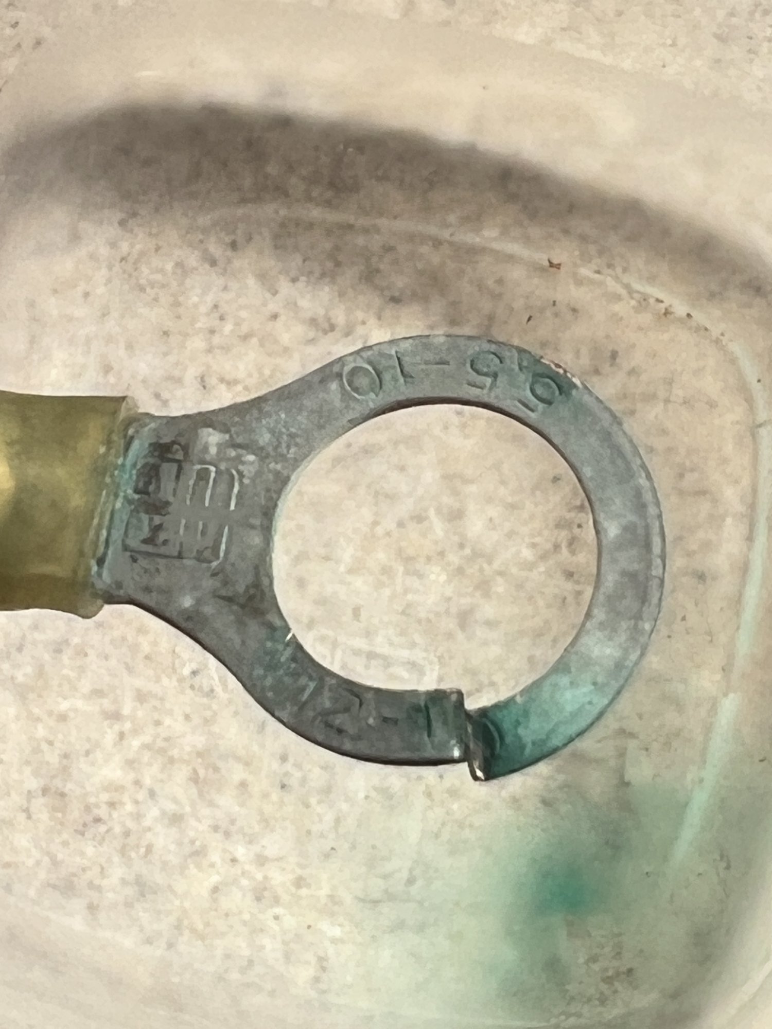

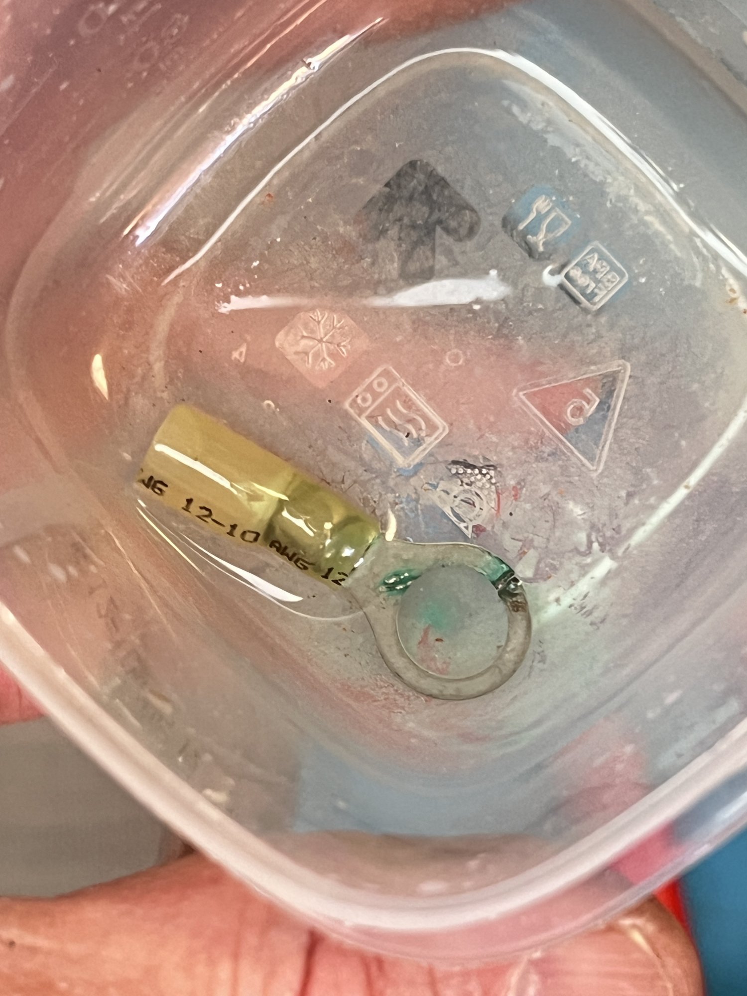

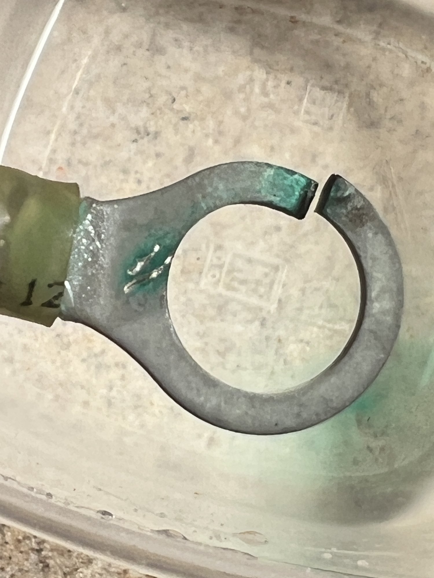

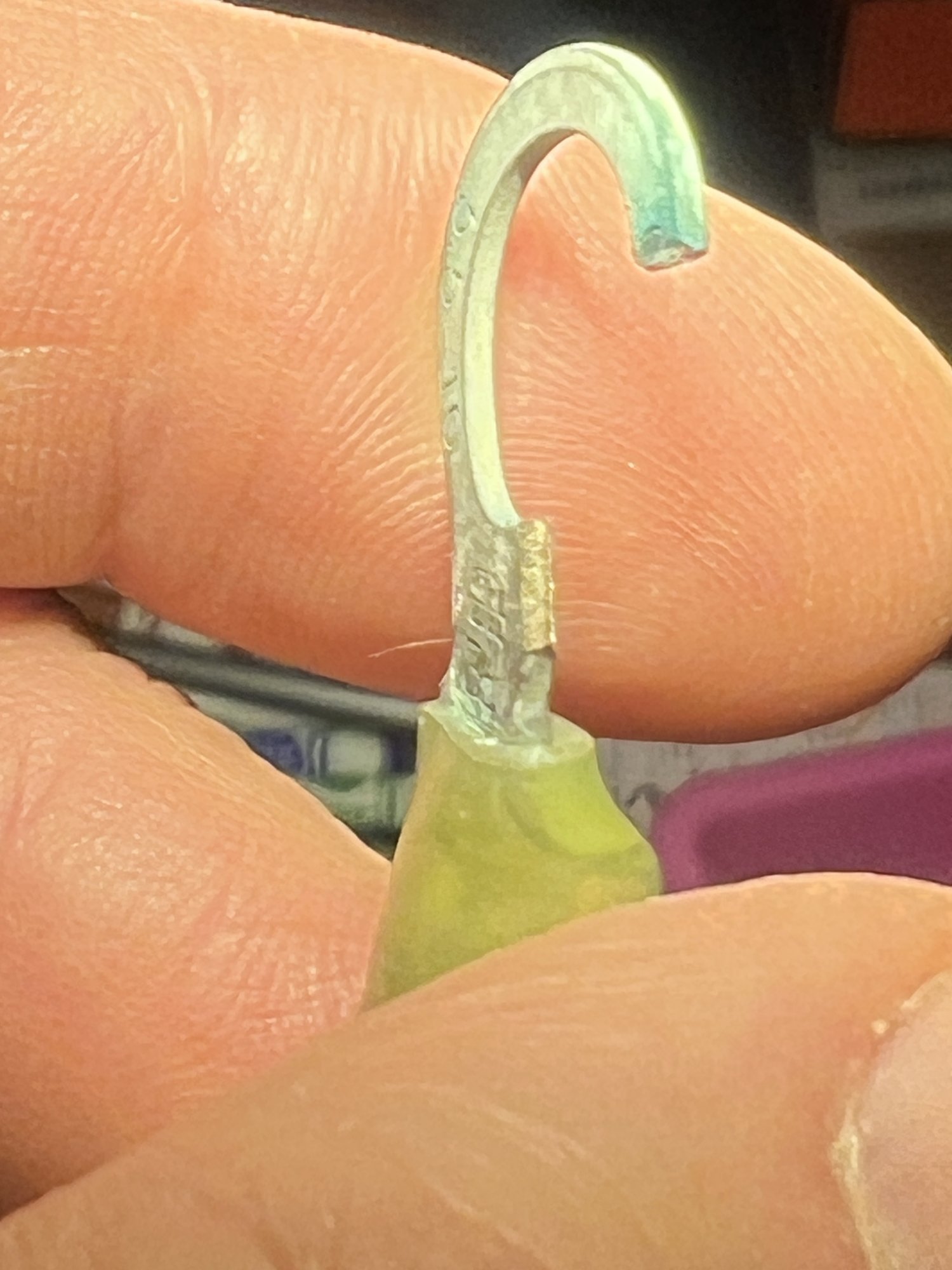

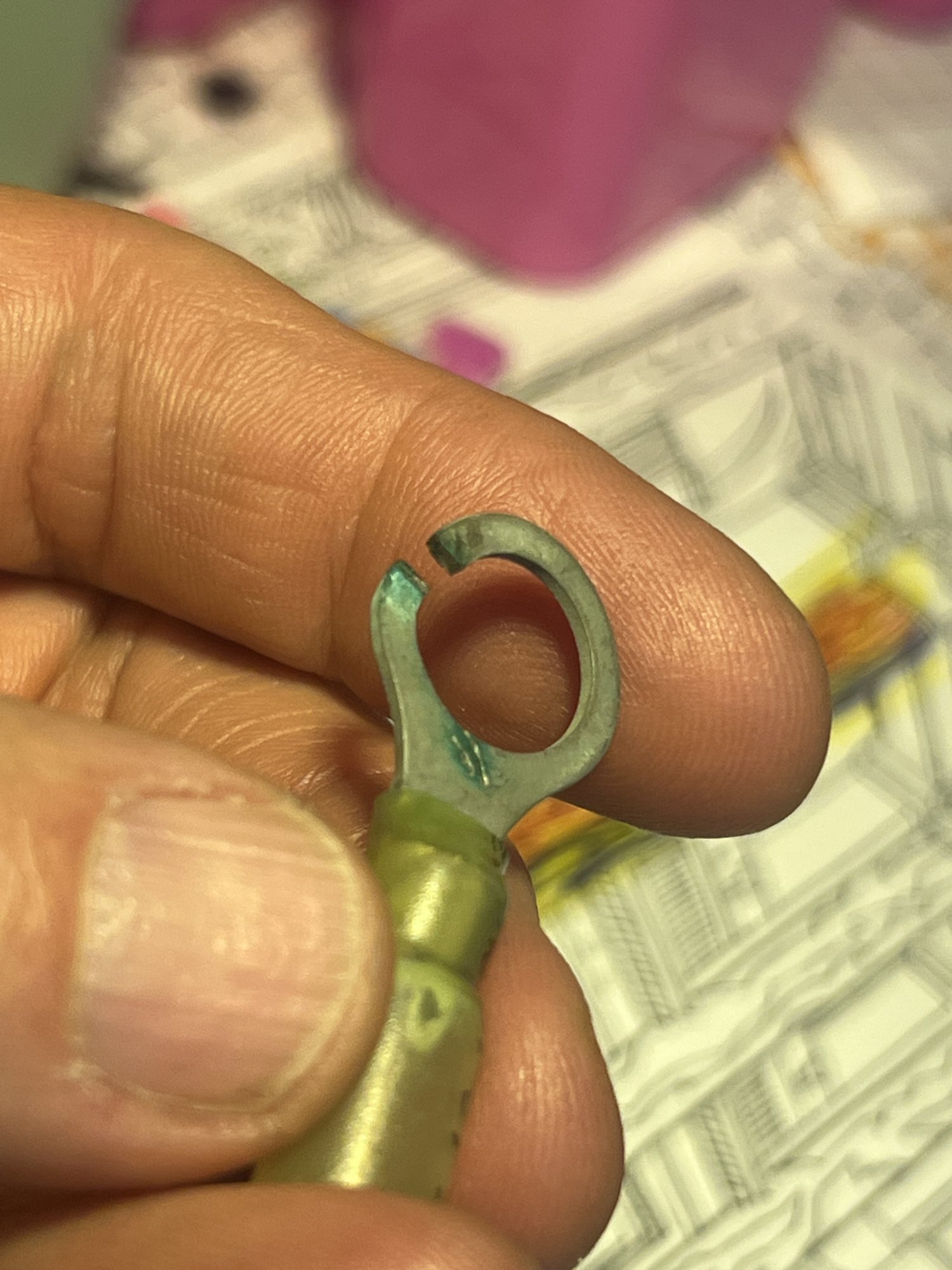

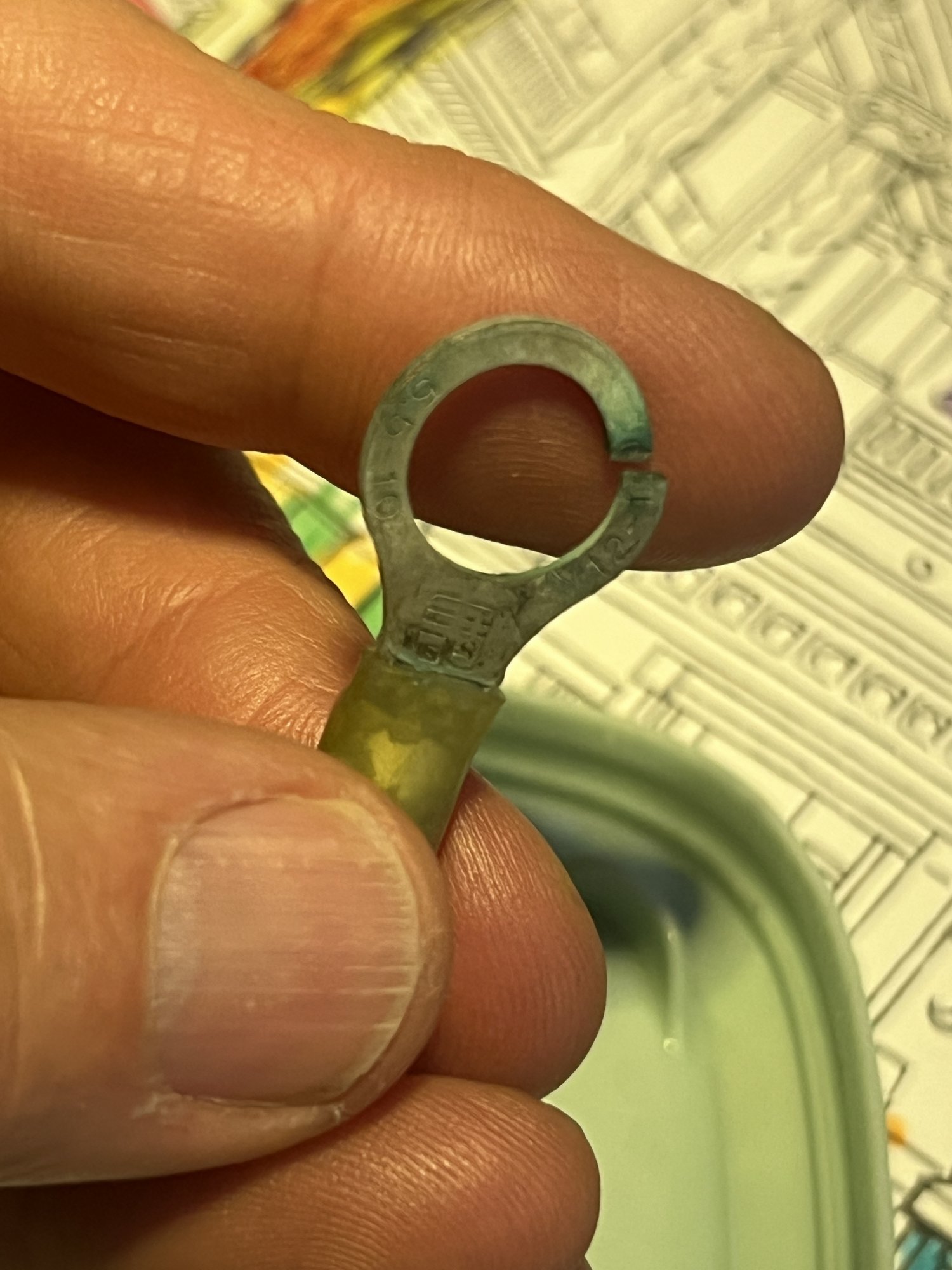

That is tin plated, and the black tin oxide is what happens when it has been exposed to salt water. So it is normal. Cut one and see if it has copper inside. If so, then it is tinned copper. Whether the crimp fits your die correctly and forms a tight crimp is another factor. If it does, then you have good terminals.

But I have used the cheap ones with no apparent failings. The cheap ones seem to use thinner metal and maybe the strength is less, but I never rely on the crimp for strain. Definitely look for tinned solid copper.

I was actually expecting more corrosion. I wonder if exposure to air vs total submersion has any impact on the rate of corrosion

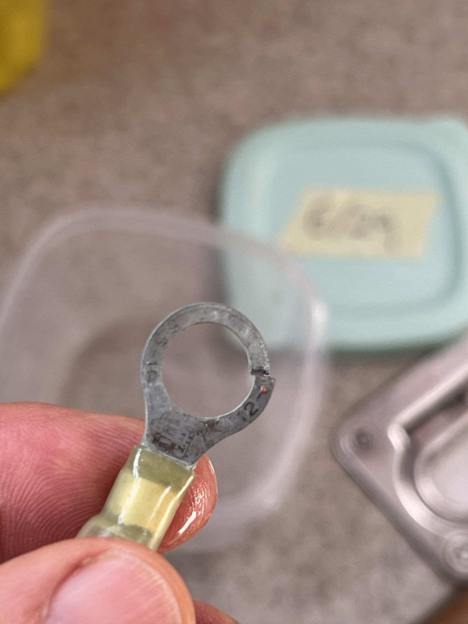

Here are the pic after 12+ months, and done. Copper core.
These are those connectors that are kind of no-name ones? Seems like they did pretty well - no?
