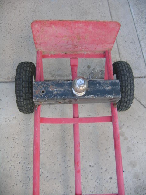

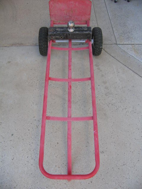

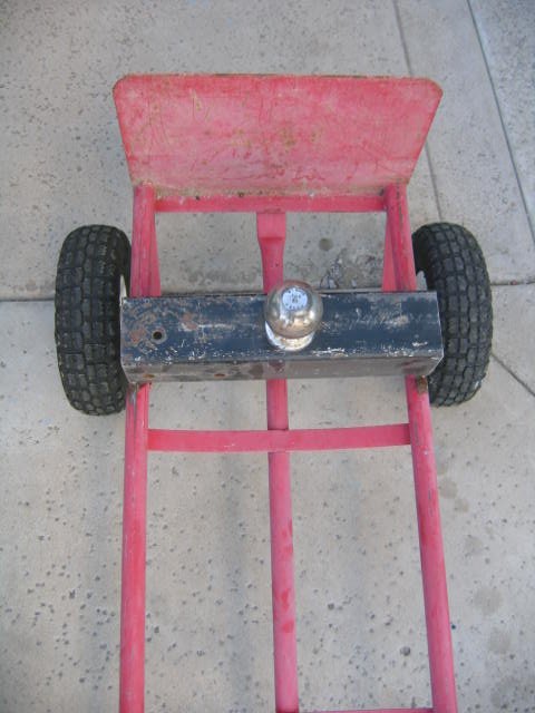

I have an 800# capacity hand truck with a 3x3 tube welded to it with a 2 5/16" ball mounted on it that I use for helping folks launch. They can then figure out the tongue extension length. Using chain to put the trailer in the water this truck still allows steering and with a couple of friends and lines to pull on the truck one can change the direction without getting wet.

Intresting, do you have a pic or drawing?
I use a 3x3 square tube to mount the ball. The ball is mounted up the handle above the wheels a few inches. This allows the plate to contact the bottom of the tongue when attached to a hitch and keeps the handle a few inches above the ground and adds friction to keep the truck from turning easily. Attach a chain or strap to the trailer frame and not the hand truck. To keep from getting wet attach a line to the handle that can be lead to both sides and pull the lines to make adjustments to the direction of the truck to keep the trailer going in the direction required. Or you can wade in and drive the truck. I've launched several boats with this thing.

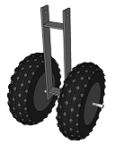

I'm visualizing a pair of tag wheels to sit under the trailer hitch, eliminating any deflection of the extension tongue
A pair of 10" wheels from Harbor Freight, a welded steel frame thru-bolted to the 3x3:
12,968
Well... I would take it to a ramp first and see if you have a problem floating the boat off the pads before I start modifying the trailer. :waycool:

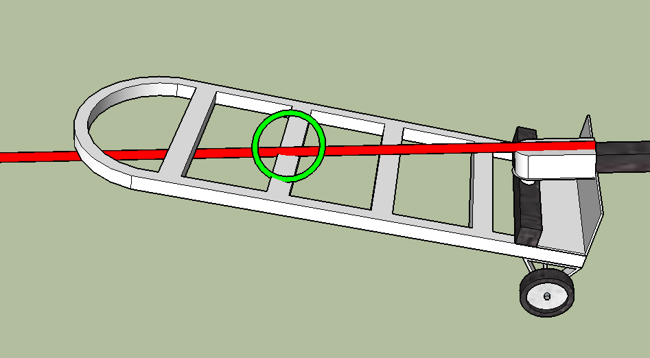

You might be able to gain some steerage by securing the line to the upright part of the hand truck (attachment point shown in green circle). When the tow vehicle moves the line follows and so does the direction of the hand truck handle
