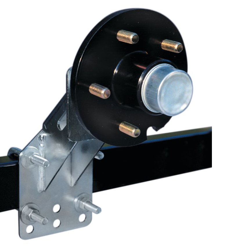

If you need to get out farther, this is better than an extension. spare tire launch I have had two trailers with extendable tongues and neither worked very well. With this, you back the trailer down to the edge of the water and block the tires on both sides. Then unhook and lower the jack down until the spare tire is supporting the tongue weight. Then attach a tow strap from the trailer to the hitch that is long enough to leave the truck high and dry.

Seeing the price of the spare tire carrier that Hayden posted I would give that a try first. I know I'm going to have trouble floating my boat off in the spring. @Hayden Watson To use this hub, I assume it gets mounted upside down and then the trailer is detached and tongue lowered until spare touches ground?
It can be mounted in four directions up, down, front or back. Find the orientation that will allow the spare to support the tongue and allow you to lift the tongue jack off the ground but still give you sufficient ground clearance for travel.

My tongue extension is very similar to what Sailme88 suggested. I was worried about slag and dents inside the tubing so I got the next size down and added some plastic slides on the end of extension and inside the end of the trailer tongue. The one disadvantage with this method is that you can't have anything that bolts through the tongue. In my case I had a support for the bow support that was through bolted. I used a kit that was made for mounting a spare tire mount. In other words, it clamps the outside of the tubing. I'd still go with the product Hayden mentioned before building a tongue extension. From what I can see it's cheaper and has some big advantages

I hadn't thought about sag, or deflection of this cantilevered tongue. I don't know the tongue weight, but I'm guessing there would be alarming deflection, if not tube buckling. I like the idea of having a tag wheel at the trailer. Could prevent an unpleasant situation. Maybe the tag wheel is one of those spare tire carriers?

The link (in blue) I provided in post #3 is the tag wheel using your spare tire. The tow strap I would use is a 4" wide nylon strap which would have enough capacity to lift your boat . (breaking strength 20,000lbs) tow strap
