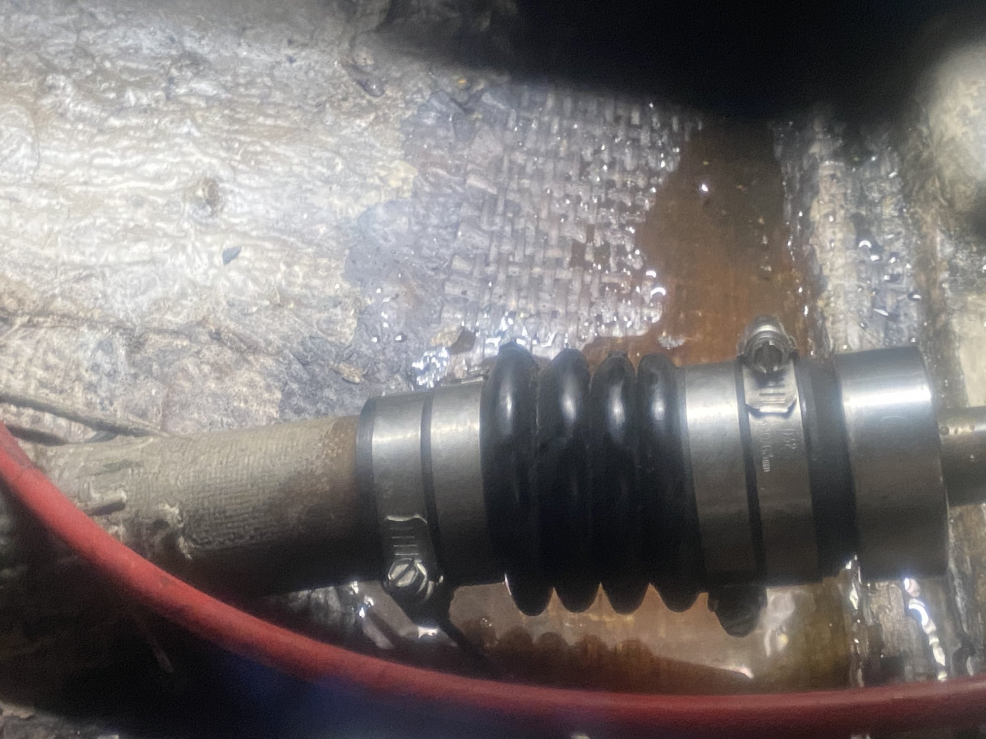

My beloved sailboat forum,
Time to point me in the right direction one more time:
Below is a picture of my stuffing box for my 1980 Oday 30. Always left a small pool of water in the engine room. Now when I touch the rubber portion, water sprays. If I engage the transmission, no leaks, only when I touch the rubber on the attachment. So I’m sure it needs some maintenance, new seals, or something. Two dumb questions:
Can I work on the stuffing box while the boat is in the water or will I have a major leak at the dock?
Where do I start with the maintenance? Are there kits I should order for a 1980 Oday 30?
Thanks for your help as always
Jim

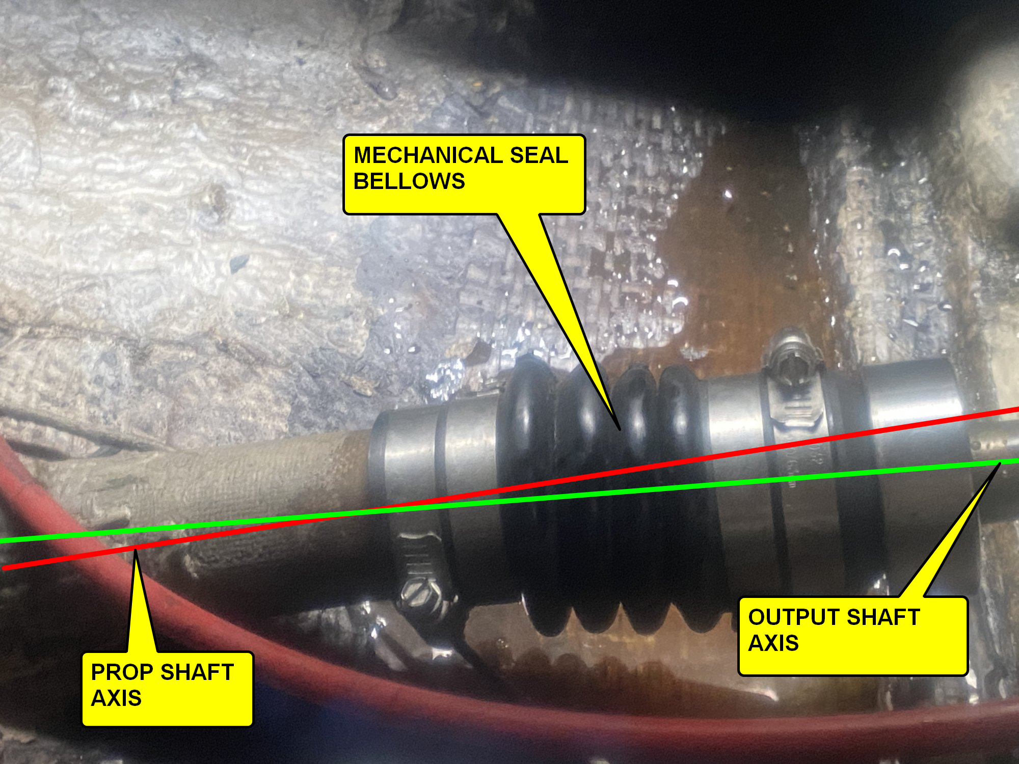

I don't even see how this is possible, but there it is :
The misalignment of your prop shaft and transmission is so bad, I don't see how the two can rotate without flying apart.
You have a major problem with your mechanical seal and alignment and you're obviously not familiar enough with this part of your boat to attempt any repairs on it. This is not a problem as we all had to learn early on in the game.
I would suggest not running the boat again under ANY CIRCUMSTANCES and to immediately bring in a licensed mechanic to repair the problems. Don't hesitate to ask to see a license as any loose dock rat will be able to screw this up enough to sink your boat in a heartbeat.

As others have noted, you have a PSS Shaft Seal. PYI recommends changing the bellows, the black rubber part, every 6 or 7 years to prevent its failure. This is probably over due. In order to replace the bellows, it is necessary to detach the shaft and coupler from the transmission. This can not be done in the water, the boat will flood.
The shaft is way out of alignment which is a separate problem. Check your motor mounts as one or more might have broken. The misalignment can cause the shaft seal to leak, which may be the cause of the water you find beneath it. More important is finding the cause of the misalignment and correcting it. Also check for damage on the strut and shaft.
Consider replacing the entire shaft seal instead of just the bellows. The cost difference is minimal. The old style seal required the seal to be burped at launch otherwise air would get trapped in the bellows preventing water from entering and cooling the seal. This can lead to deterioration of the seal. Burping can also damage the graphite bearing at the end of the seal. Some people use a screwdriver to pry the bellows back to burp it scratching the graphite disk. The new version of the Shaft Seal has a vent which allows the air to escape. See the link below for more information.
So, get the boat hauled and get the shaft issues straightened out and replace the Shaft Seal before any more damage occurs to the drive train.
  1. Always left a small pool of water in the engine room. Now when I touch the rubber portion, water sprays. If I engage the transmission, no leaks, only when I touch the rubber on the attachment. So I’m sure it needs some maintenance, new seals, or something.
  2. Can I work on the stuffing box while the boat is in the water or will I have a major leak at the dock?
  3. Where do I start with the maintenance?
  4. Are there kits I should order for a 1980 Oday 30?

Continued. #2. @Ralph Johnstone Provides a great graphic. It looks like your Transmission to Shaft alignment is not to spec. While the PYI Dripless seal is forgiving, a misaligned shaft will prematurely wear the parts on the Dripless Seal, causing them to drip. I would address this with the boat out of the water. I would check the wear on the graphite seal face. It may need to be replaced. Based upon inspection, I would contact PYI with what is observed and get their advice.

There definitely is misalignment, but the left side of the picture is the shaft log, not necessarily the prop shaft axis. The prop shaft runs continuously from off the right of the frame all the way through the PSS, out the log, and through the cutless. The log has tolerance for quite a bit of misalignment (as we're seeing). What's more important is the alignment of the shaft through the cutless and into the transmission coupling, which we can't really see from the picture (though the misalignment with the log is not a good sign).
14,018
I've had a PSS for 20 years, the bellows should be straight, there should not be a bend in it. The log probably has a diameter of about twice that of the prop shaft, so there is lots of wiggle room. The bellows is flexible to accommodate some miss alignment between the shaft log and the line between the center of the strut and the center of the transmission, however, this amount of bend is pretty extreme. The cutless bearing may also be worn which would allow more play in the shaft alignment.
The bend in the bellows is problematic beyond being an indicator of the shaft misalignment. It is being stressed in a way that is inconsistent with its design. The bellows serves 2 functions, keeping the water out and providing compression for the mating surfaces of the graphite bearing and the SS collar. Because of the angles, some parts of the bellows are in tension when they should be in compression. I would suspect this has a weakening effect on the bellows and could accelerate the normal decay of the material. Regardless, because it is of unknown age and it is installed incorrectly, it begs for replacement.

That looks really off-line for some reason.
If it was me, I would haul the boat, remove the coupling and the PSS so you can see the shaft in the shaft log. It should be centered in the middle of the stern tube.
Of course the prop shaft can't possibly make a bend like that in it's travel up to the prop shaft/Xmission coupling as it's one continuous, solid piece of shaft.
Buuuuuuuuuuut, on the other hand, how can the shaft travel through the shaft log at that crazy angle and not wear through the side of the log shaft and into the FG hull ? It was about that time I went cross eyed and any further ideas I may have had evaporated. What the hell happened back there we may never know ? Remember, the strut, cutlass bearing, shaft log and shaft were installed first. The engine came second and had to line up to this pre-existing mess. Unless "something" happened somewhere down the road.
Rather than an experienced mechanic, perhaps what the OP needs is a sorcerer to explain what happened here.

Yes, I agree, definitely something wonky and in need of further insertion. @dlochner also made a very good point that the misalignment could be putting the bellows in some kind of tension, which could be part of the problem too. In any case I don’t see any way out other than a haul out to check/fix it all.
