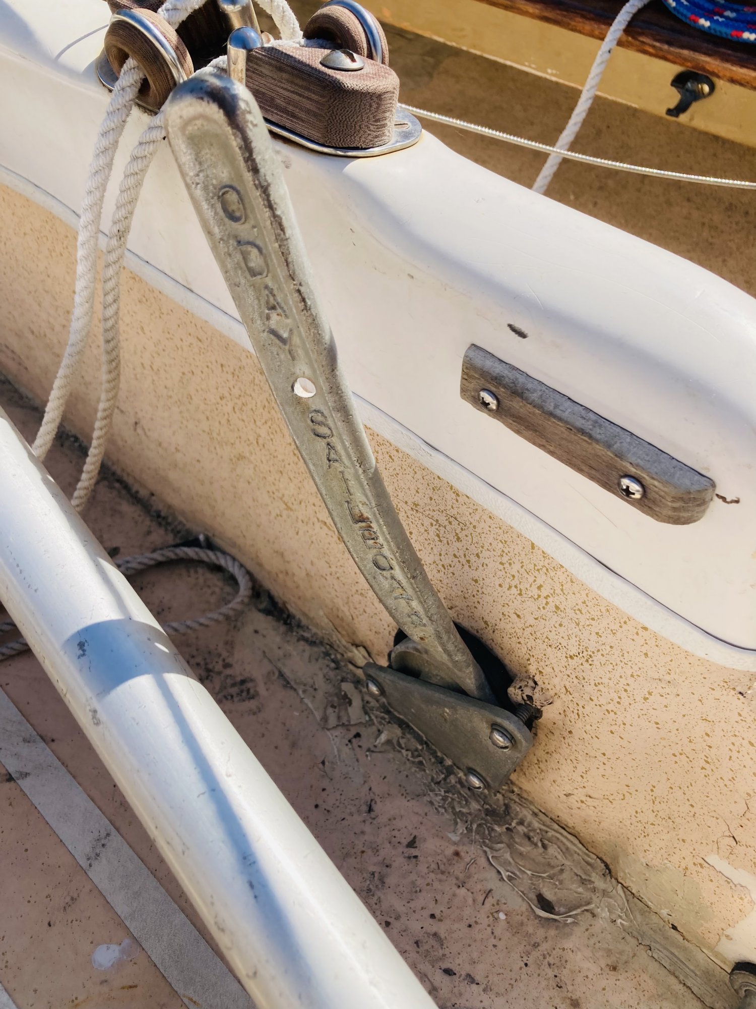

Hello all!
I bought a widgeon this spring, and have used it several times. The centerboard gets jammed in the case if it is pulled up all the way. The only way to get it back down, is to try and stomp on the handle several times, to dislodge it and drop it again. How do I fix this problem? I already climbed underneath and check up in the case with a flashlight; all I found was some mini barnacles on the lower part of the CB. It looks clear all around it.
Any ideas on what could be causing this? Or how to fix it?
Thanks in advance!

Thanks @dLj . Yeah, the lever I’m talking about is metal and attached to the centerboard case. How would I go about taking it apart? There is another forum post on here asking about taking the top piece of the Widgeon CB case off, but the answer was pretty much “impossible”.

8,189
It looks like the triangular piece with the three fasteners is dislodged. And there are cracks between the centerboard housing and the hull which were repaired with some kind of goop. If the boat is dry, getting into that may be more of a project than you wish to undertake.
Do you really need to pull the centerboard all the way up? Maybe you can manage the disfunction.
Otherwise I would remove that piece - carefully - and see what it covers. My guess that piece has an inner bearing surface for the lever and centerboard pin (Axle?) to rotate on. That may be the key to removing the board.
