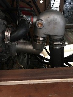

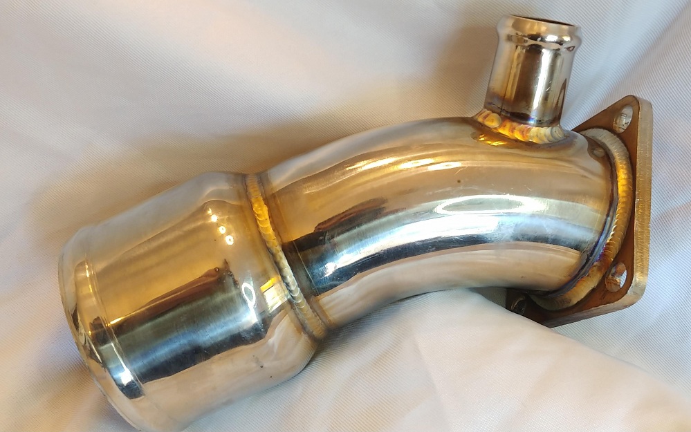

Hello everyone, before buying my Hunter 380 I had read the mechanic's report indicating that we had to think about changing the exhaust elbow. I looked at the engine model and ordered on the exhaustelbow website. But ... It is not the right product now that I saw the engine in "real". It could be mounted on it, but if such an elbow was planned there must be quite a lot of reason. What do you think? Can I mount it anyway? I have some doubts, because the water outlet will be lower by at least 10 cm per intake before.
With only your boat model it is an impossible question to answer. We are going to need more information in order to attempt to give you an answer that might help address your boat problem.
You discovered a very important issue in refitting a sail boat.
lets start with:
  1. what is the engine model
  2. Can you provide pictures of the engine especially of the exhaust system
  3. picture of current exhaust elbow
Perhaps the we might be able to share some ideas on solving your challenge.

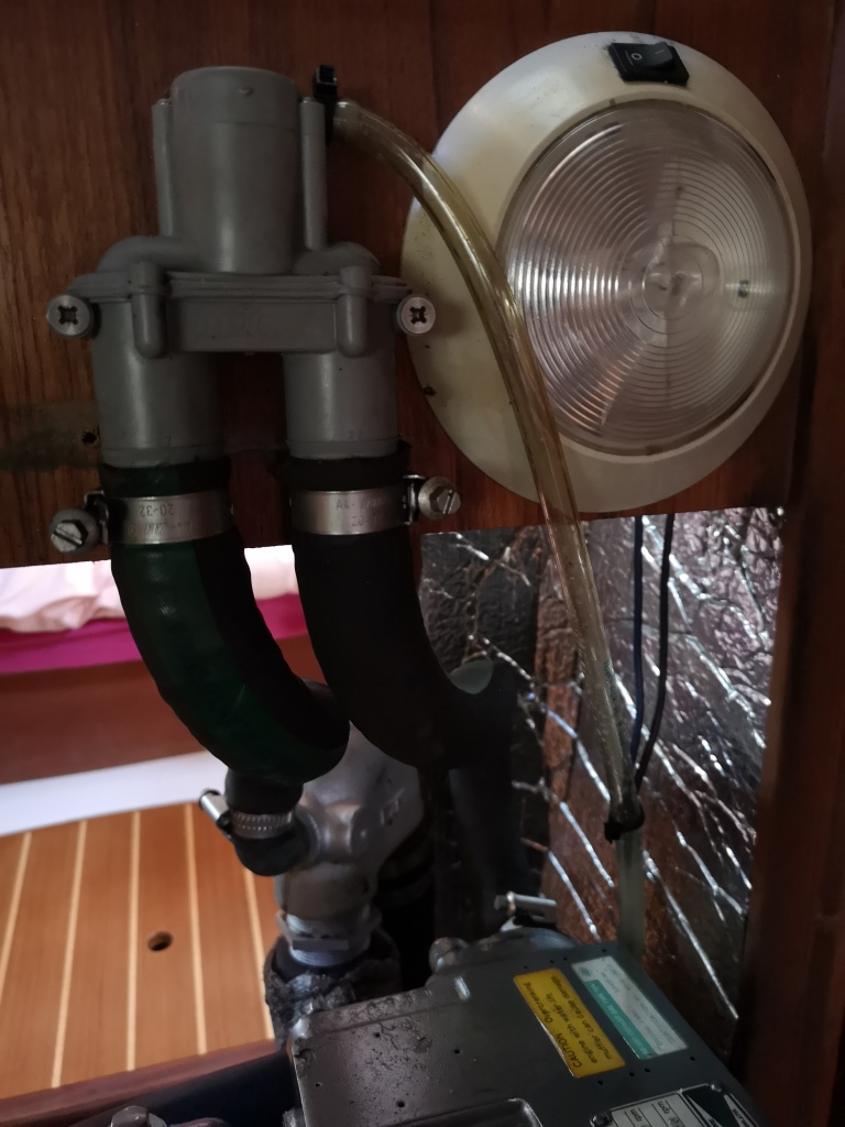

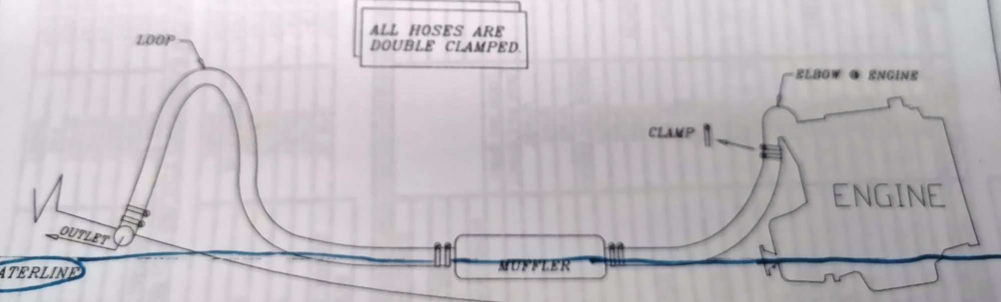

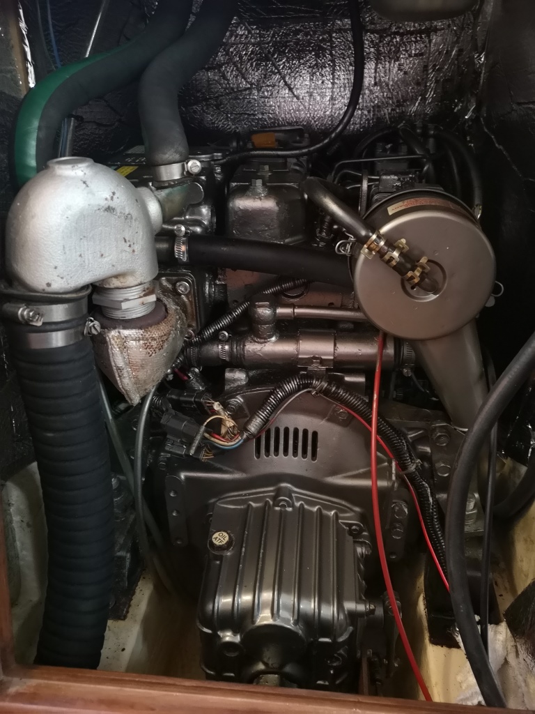

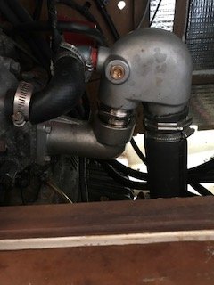

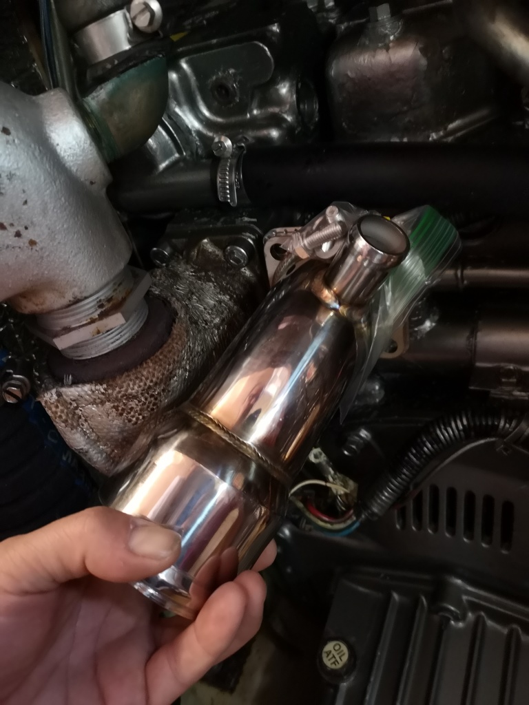

Bonjour, pour le modèle moteur c'est un yanmar 3JH2E, comme sur tous les H380 je pense. Pour les photos, elles sont ci-dessous. J'ai essayé de montrer le coude et sa sortie et aussi avec le nouveau à côté.
Le nouveau peut atterrir sur le site sans problème. Mais ... Soudain, sans ce virage, s'arrêtera plus bas. J'ai mis la photo du manuel du 380 schématisant le tout. Même si je ne peux pas confirmer que la ligne de flottaison est bien celle montrée sur ce schéma.

Hello, for the engine model it is a yanmar 3JH2E, like on all H380 I think. For the photos, they are below. I tried to show the elbow and its exit and also with the new one next to it. The new one can land on the site without problem. But ... Suddenly, without this turn, will stop lower. I put the photo of the manual of the 380 schematizing the whole. Even if I cannot confirm that the waterline is the one shown in this diagram. Thank you in advance!!!

I would think that maintaining the existing elbow would be easier than putting in the new one.
As for the elevation above the water line, you are ok, even with the new one installed.
That drawing is the same for my Hunter 430 and I have a different engine.

Ok! Thnaks a lot! I want to use the new one because i buy it lol, and it's cheaper than the original and more simple to install.

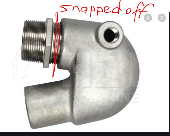

of interest, my SS Mixing elbow on my 2GM is great but the joint fitting just snapped today filling the boat with exhaust water and diesel smoke
I managed to get it back to my mooring (fresh water cooled so turned the sea cock off).
Took me a while to work out what when wrong as it was still sitting nicely over the broken joiner .
It was fitted around 4 years ago and I suspect the joiner just gave up the ghost with the exhaust temp changes.
