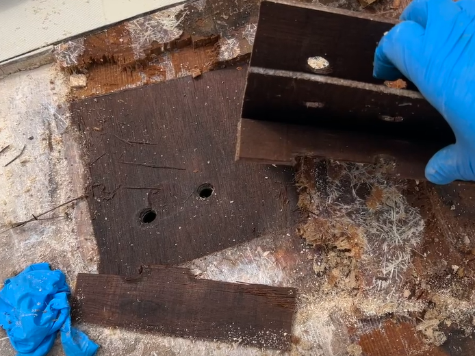

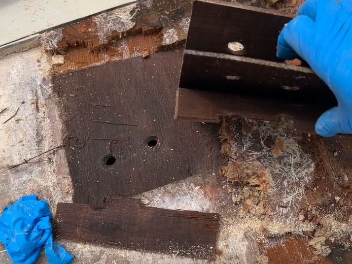

WOW!! Karma was a b!tch! She looks GREAT now!
Questions; how were the genoa tracks sealed originally? (were they sealed originally??) What was there core in this area made of (balsa or plywood)? How badly was the core in this area rotted??
May 30, 2006
370
Oday 34 Chesapeake Bay
Thanks. The track was sealed with some type of sealant (butyl?) which was still quite tacky. It was only applied around the mounting screws and not the length of the track, I did the same using butyl tape. The mounting holes were not beveled and not drilled/epoxied/drilled. I used the drill/epoxy/drill procedure and beveled the holes to mount them. Hopefully it will be good for another 40 years.
The core under the tracks and the cap shroud u-bolts was plywood, not balsa. I wouldn't say that it was rotted. In both areas the adhesive for the ply was gone, however the veneers had not dissolved as had much of the balsa core that had been wet. I had planned on using coosa as the core for every deck penetration, however after comparing marine plywood specs with coosa and alternatives, decided that ply was the better choice.
