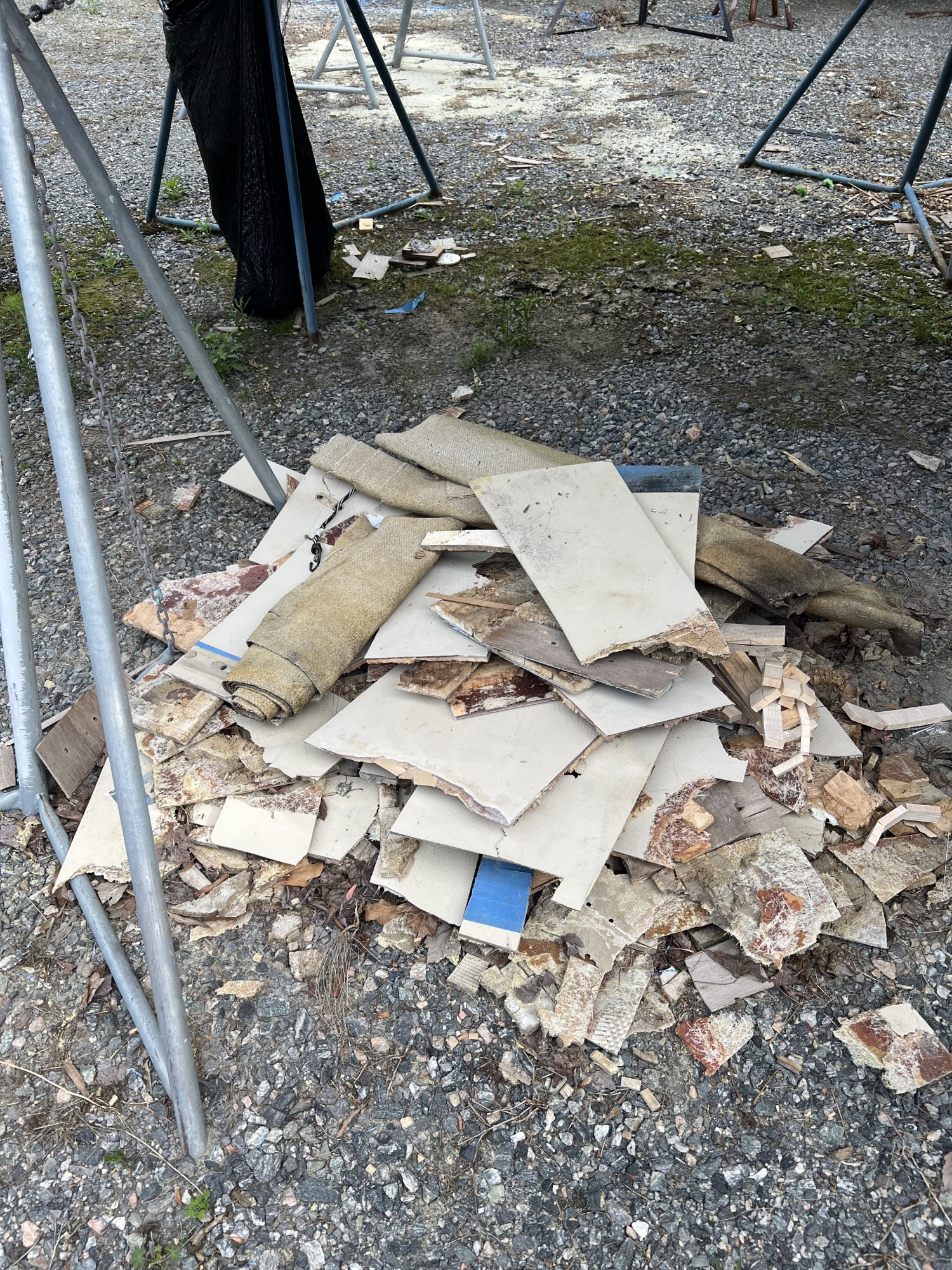

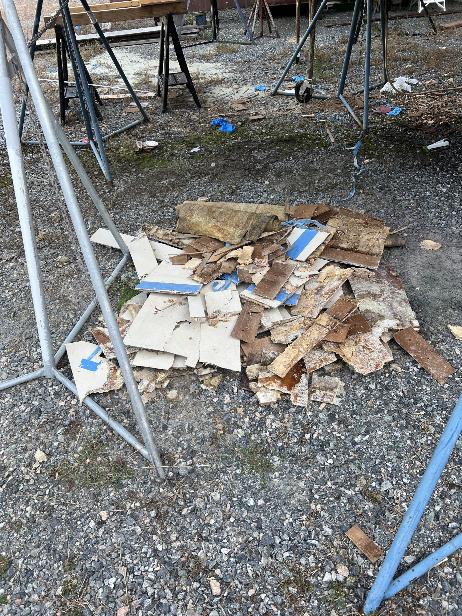

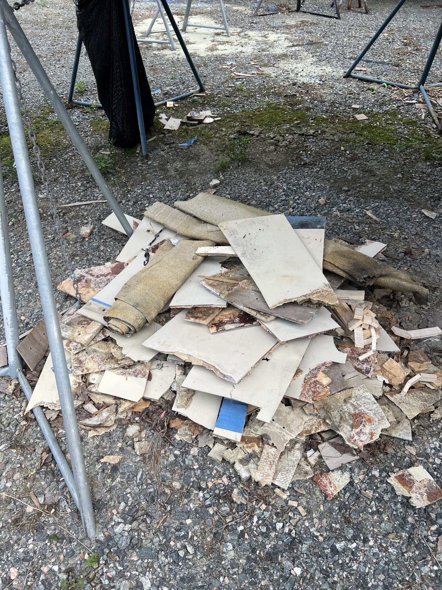

Thanks nramsey. Small sections may be easier to do that way particularly if you’re planning to replicate the existing pattern. Karma’s deck had so many stress cracks that I went for wholesale removal.
If you look closely at the “gut” pile, you’ll see that many of the sections shattered upon removal. Where the core was saturated removal was easy, but not so easy where the core was only wet. It’s amazing how tenacious even a wet core is.

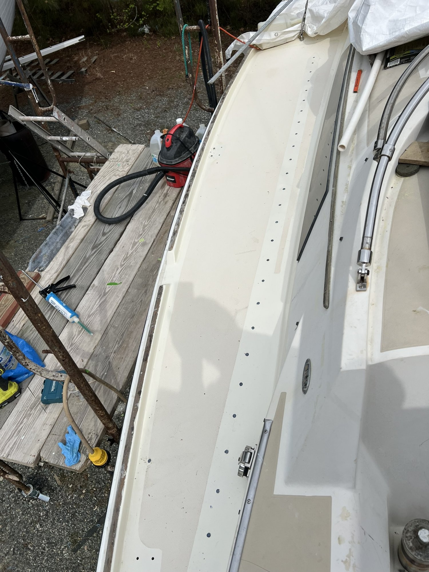

Greetings, it's been awhile. The weather got colder quicker than I planned, so turned my attention west to ski as well as helped a friend get his boat down the ICW on his way to FL. I was able to finish fiber glassing and fairing the last section of the aft port side. It got too cold however to prime and paint. I did order some accelerator (AwlGrip M-3066) so was able to prime during marginal temps... that stuff works really fast.
To date I've got the first two layers of topcoat down. Next up will be applying the nonskid once I've masked off the non-nonskid sections.
I believe that I'll be finished in another 8 weeks, weather willin' :)

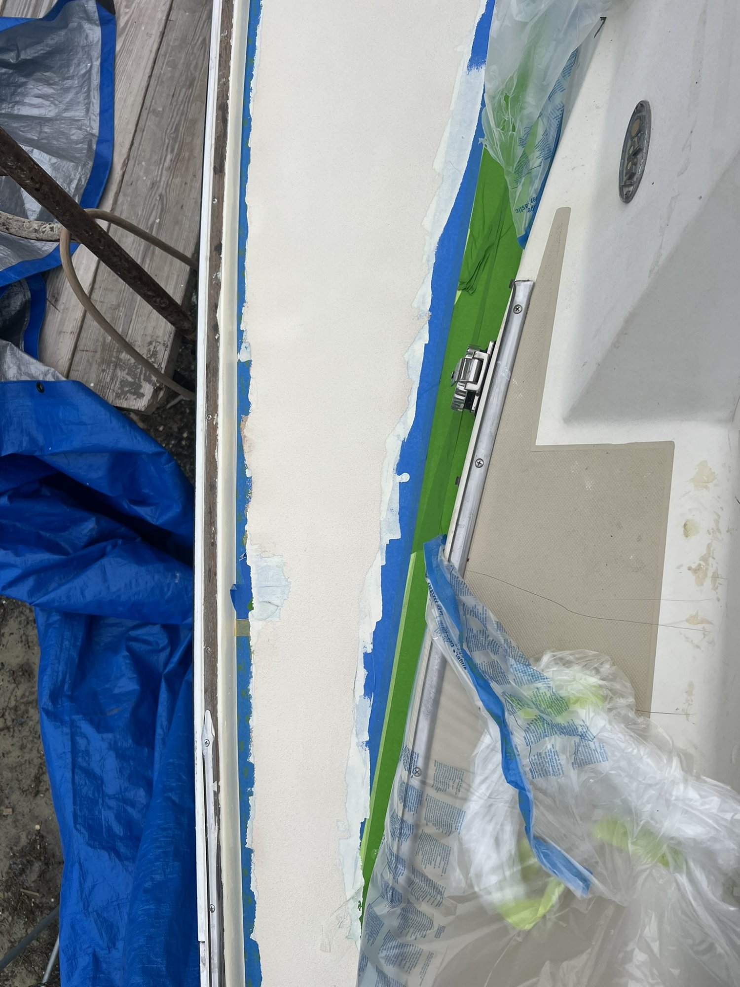

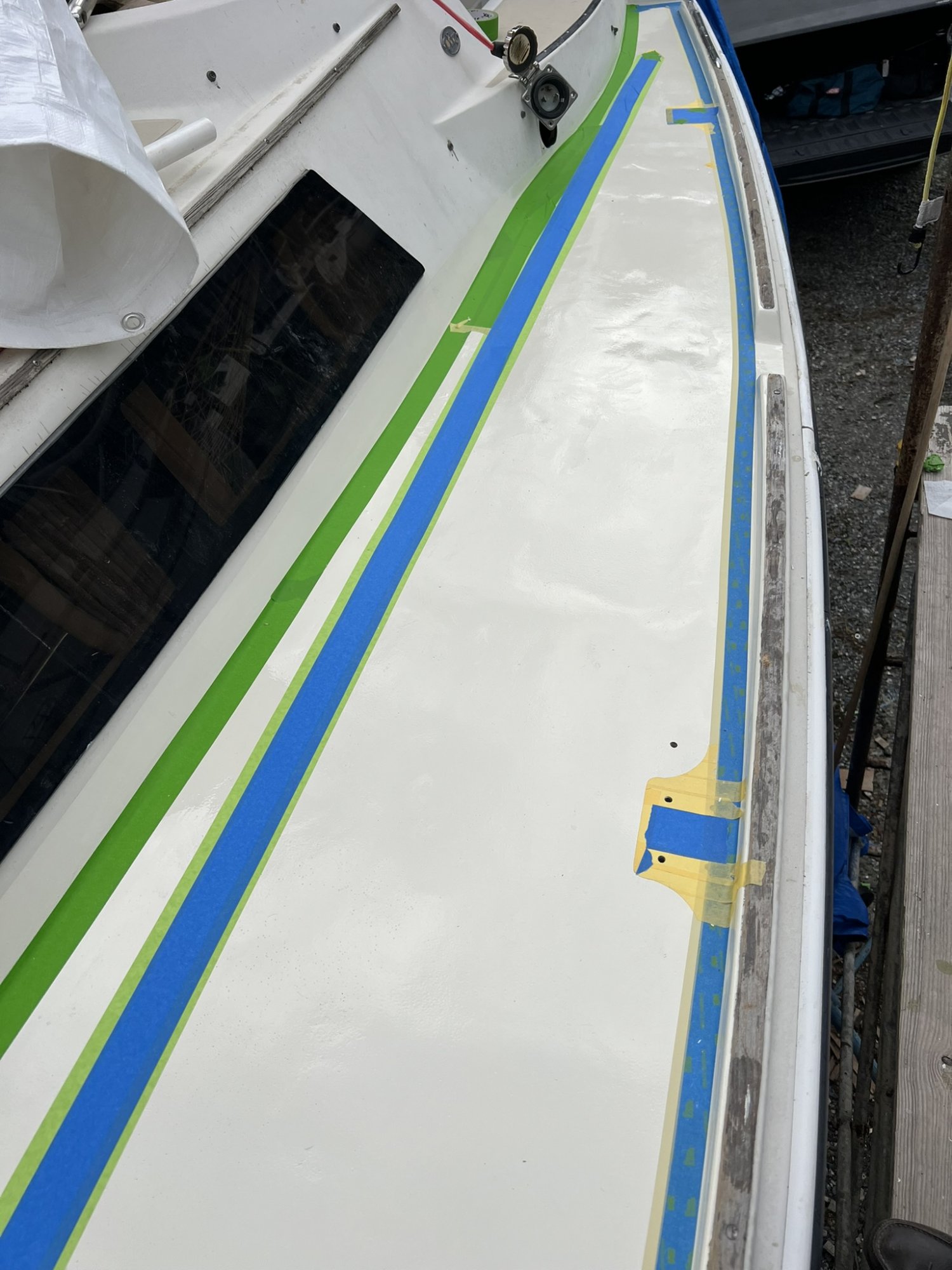

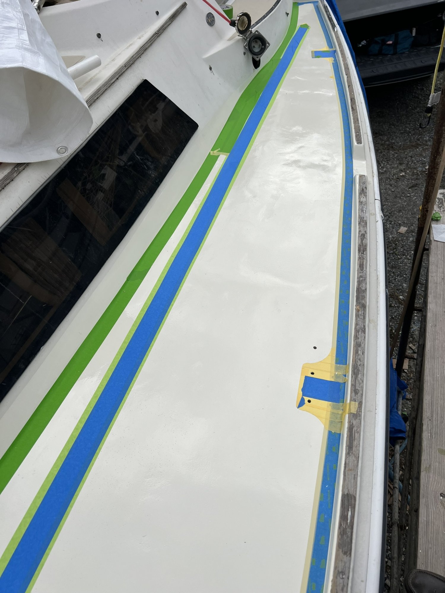

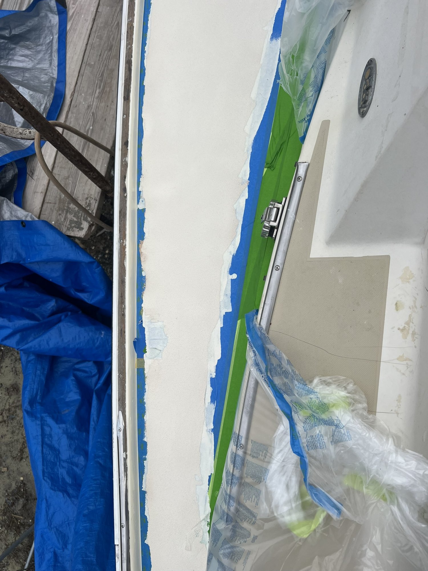

The saga continues. Last section of the portside masked off and ready to apply the SoftSand non-skid.
... note the unmasked hole. Had a bit of a oopsie when trying to locate the stanchion mount location :facepalm:
Non-skid down, prior to removing the masking tape. I find that Scotch Fine Line Tape 218 keeps the edges crisp. It's expensive so I use a combination of it and 3M Automotive Refinish Masking Tape. Not so pleased with the green and blue stuff, so use it for filler.

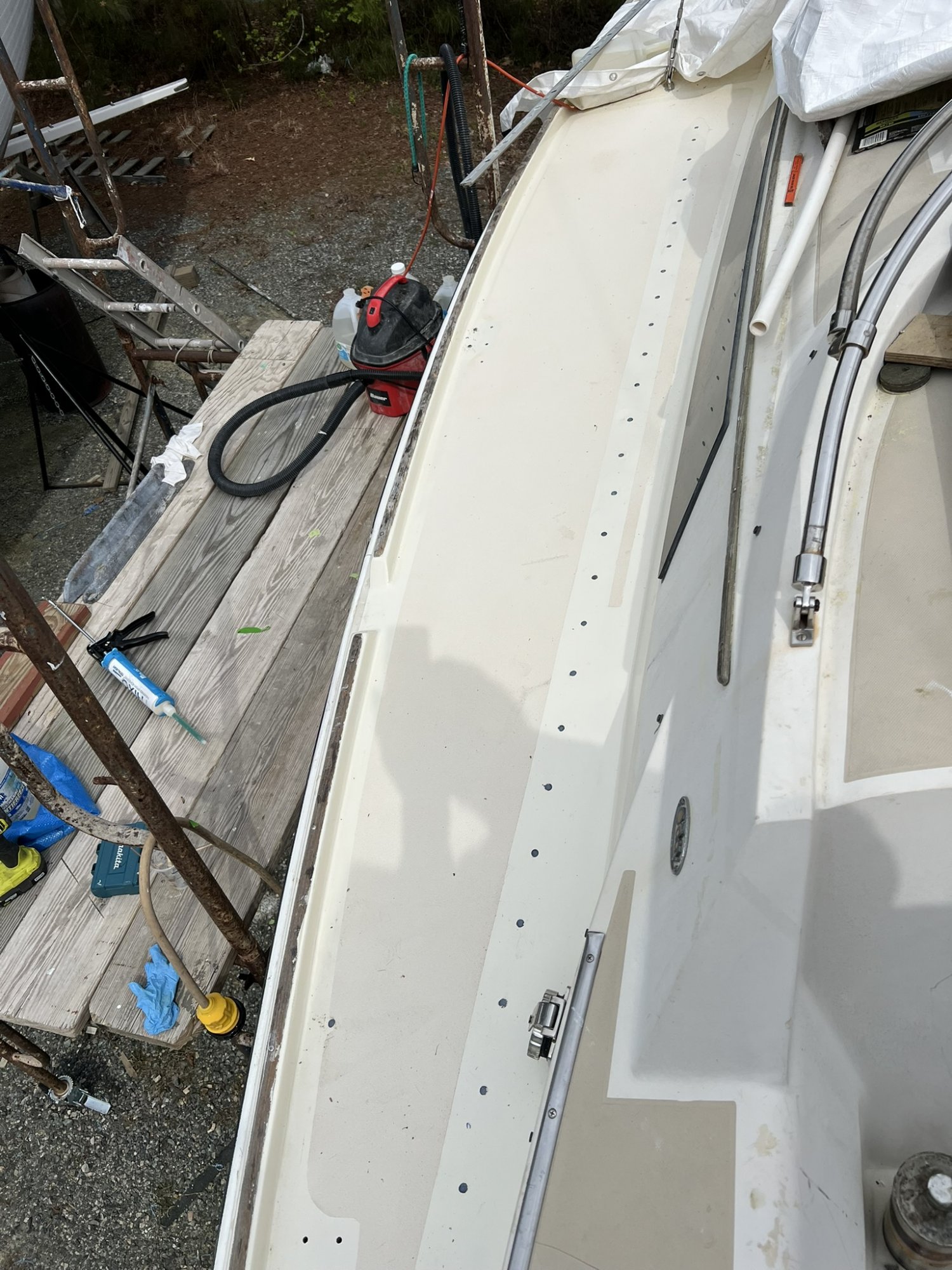

The hard part was drilling the 30 some holes for the jib car track and other hardware, in the pristine deck.
Studying Bedding Deck Hardware With Bed-IT Tape - Marine How To want to make sure that it's done right. So far everything that I've used butyl on has been leak free. I've even been using it to plug exposed holes whilst wait to install other deck hardware.

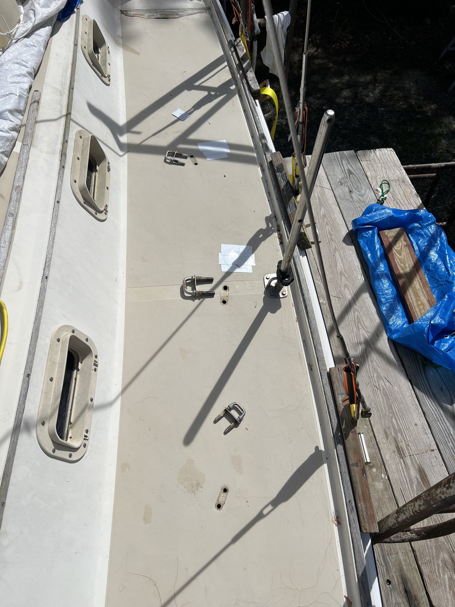

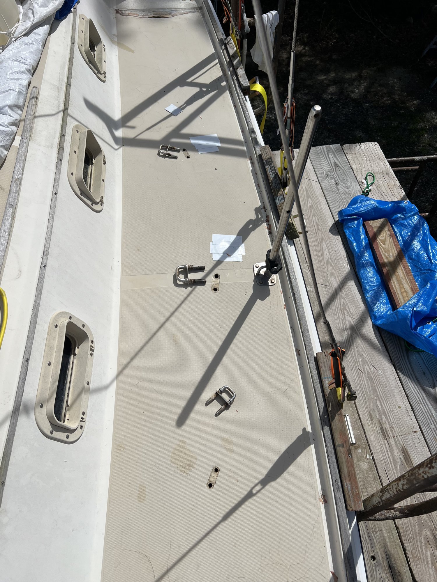

Got the shroud U-bolts and deck fills (water and waste). There was no protection for the balsa core, the U-bolts didn’t show any signs of water infiltration, the deck fills however did.
The gut pile grows.

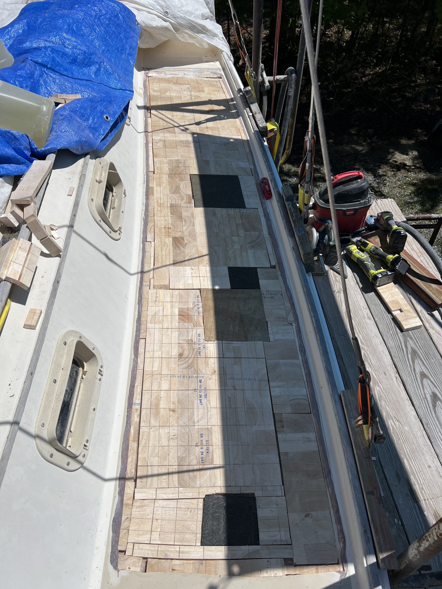

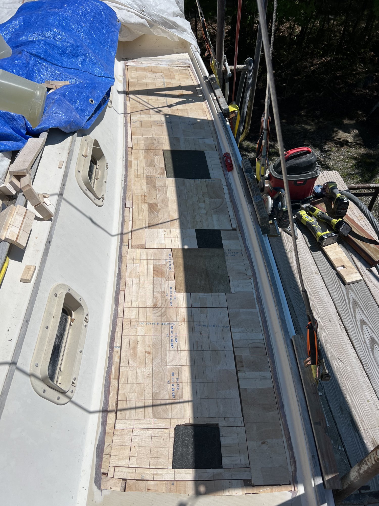

This is the deck with new balsa core and coosa placed where deck penetrations are. I replaced the marine plywood at the cap shroud penetration.
Was able to glass the core as well. I learned the hard way to cover the core ASAP to prevent moisture intrusion into the exposed core from dew and/or rain.

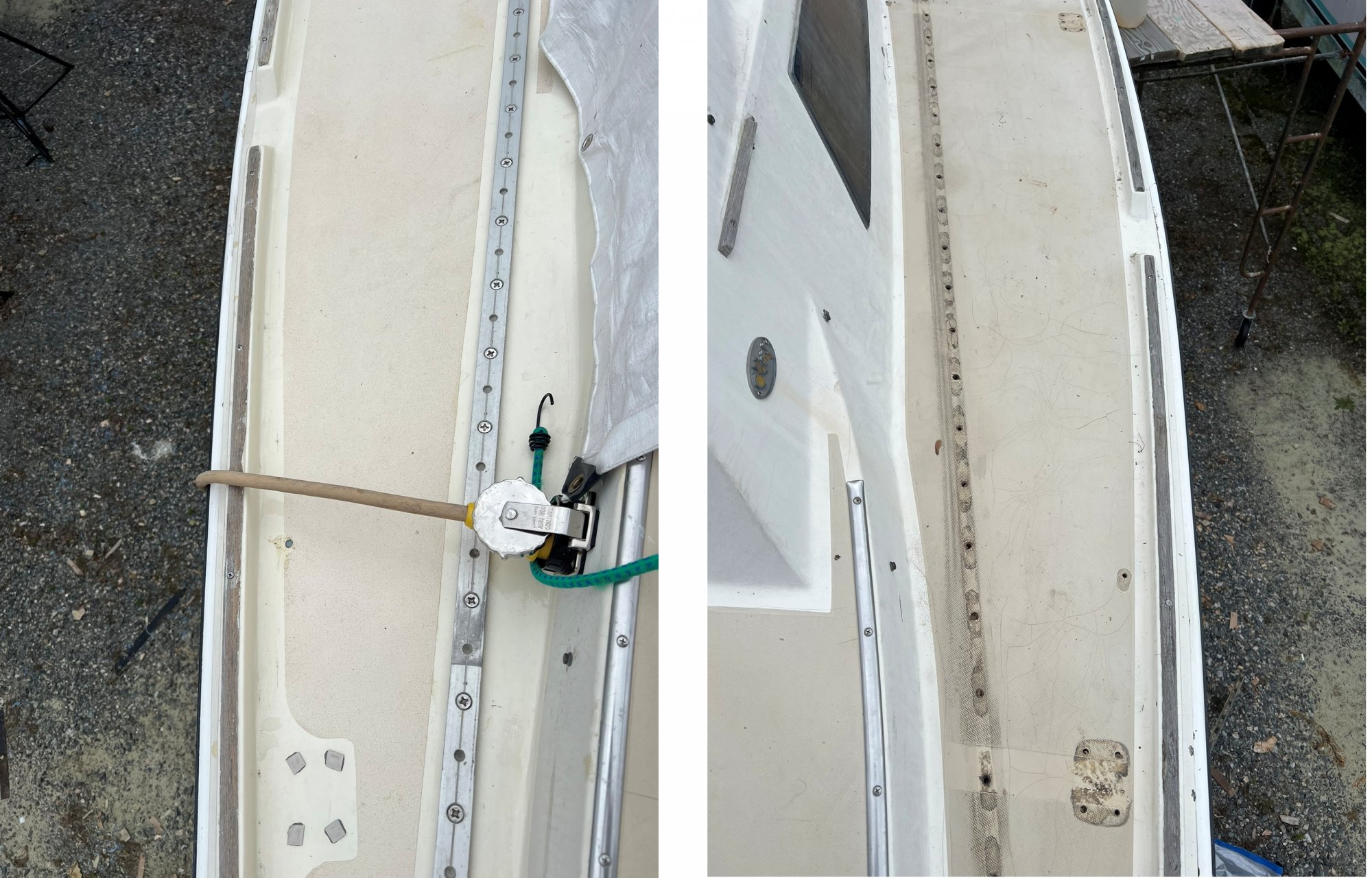

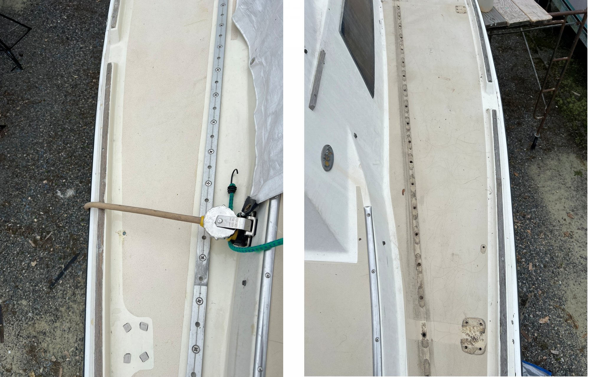

I must commend you on your hard work and dedication to accomplishing this task!!!! I have hired a fiberglass contractor to do this job for me, however, he did not remove and rebed our jib track (which is where we found water intrusion) so I am going to do this part myself. I am in need of guidance as to how to lay out where my jib track holes will lay…. my thought is to race out a template before removal that I will tape down after removing the screws. Any better solutions would be greatly appreciated….
Aug 11, 2011
1,017
O'day 30 313 Georgetown MD
@Faster Horses I assume the way your track bolts were fastened is the same as any other larger O'day. Therefore there will be holes inside the the cabin where the washers and nuts would have been, unless that too was repaired. It would be easy enough to pilot drill from the inside through the newly laid filler material and come out top side. Then drill oversized, do the usual fill and re drill. Am I thinking this out wrong?
Yes that's the way to do it. However, when I reinstalled the port jib car track (haven't finished the starboard side at this time) I simply drilled the first and last holes from the inside, then mounted the track and drilled thru the remaining holes from the top down. There's about a 10' span so the track can shift somewhat during the top down drilling. Using this method, I was off between the liner (where the larger holes are for the washer) and the bottom layer of laminate less than 1/16" on some holes in the middle, but nothing that prevented the install.
Thanks for the encouragement :)
On Karma I found that the core under the jib track was plywood (presumably marine grade) however the adhesive between the plies had long since succumbed to the constant water intrusion. Structurally, the wood hadn't turned to mush (as the balsa core did), however IMHO the plywood core was compromised. I used my jib track as the template and drilled top down once I established a start and end point from below.

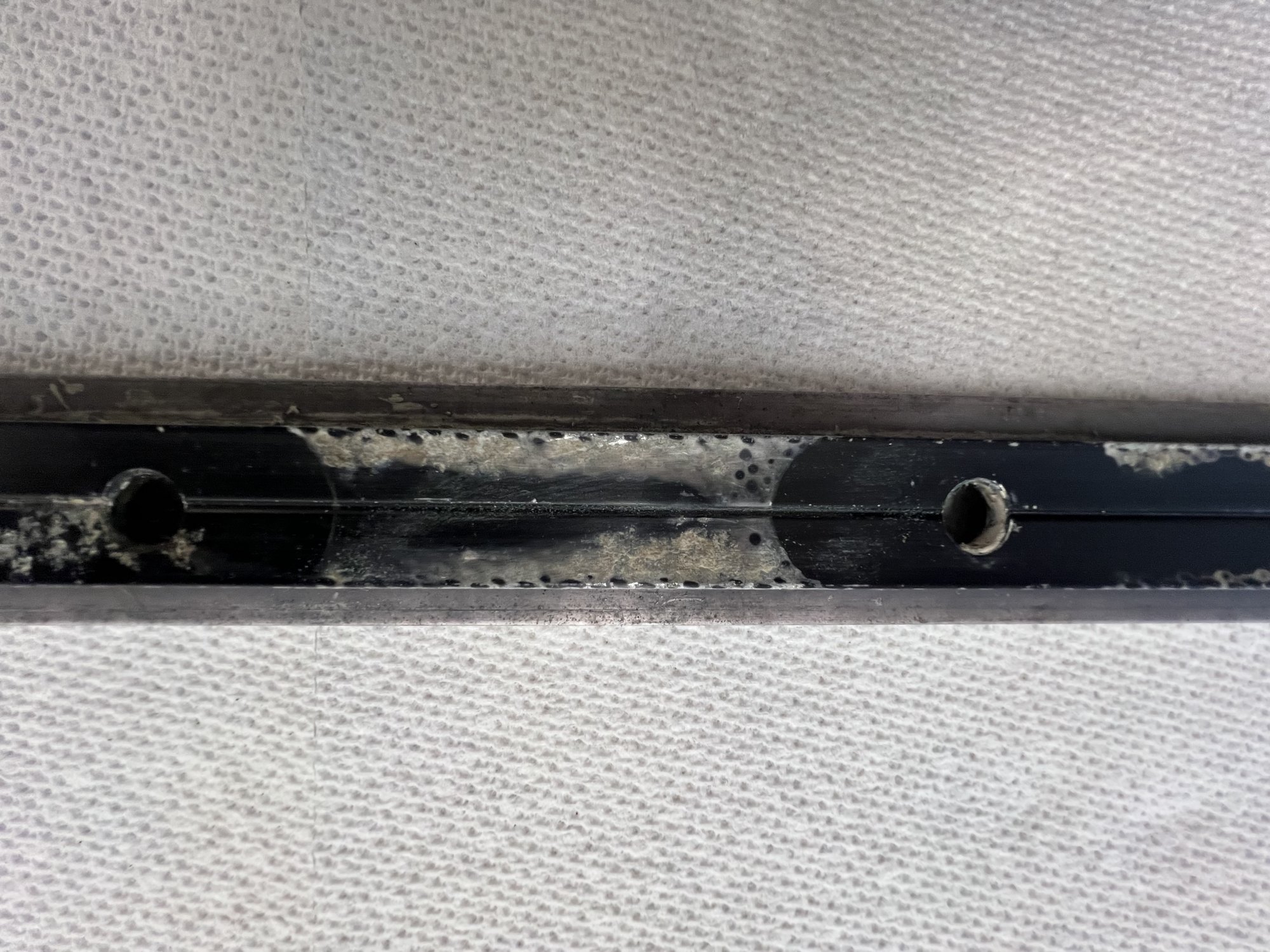

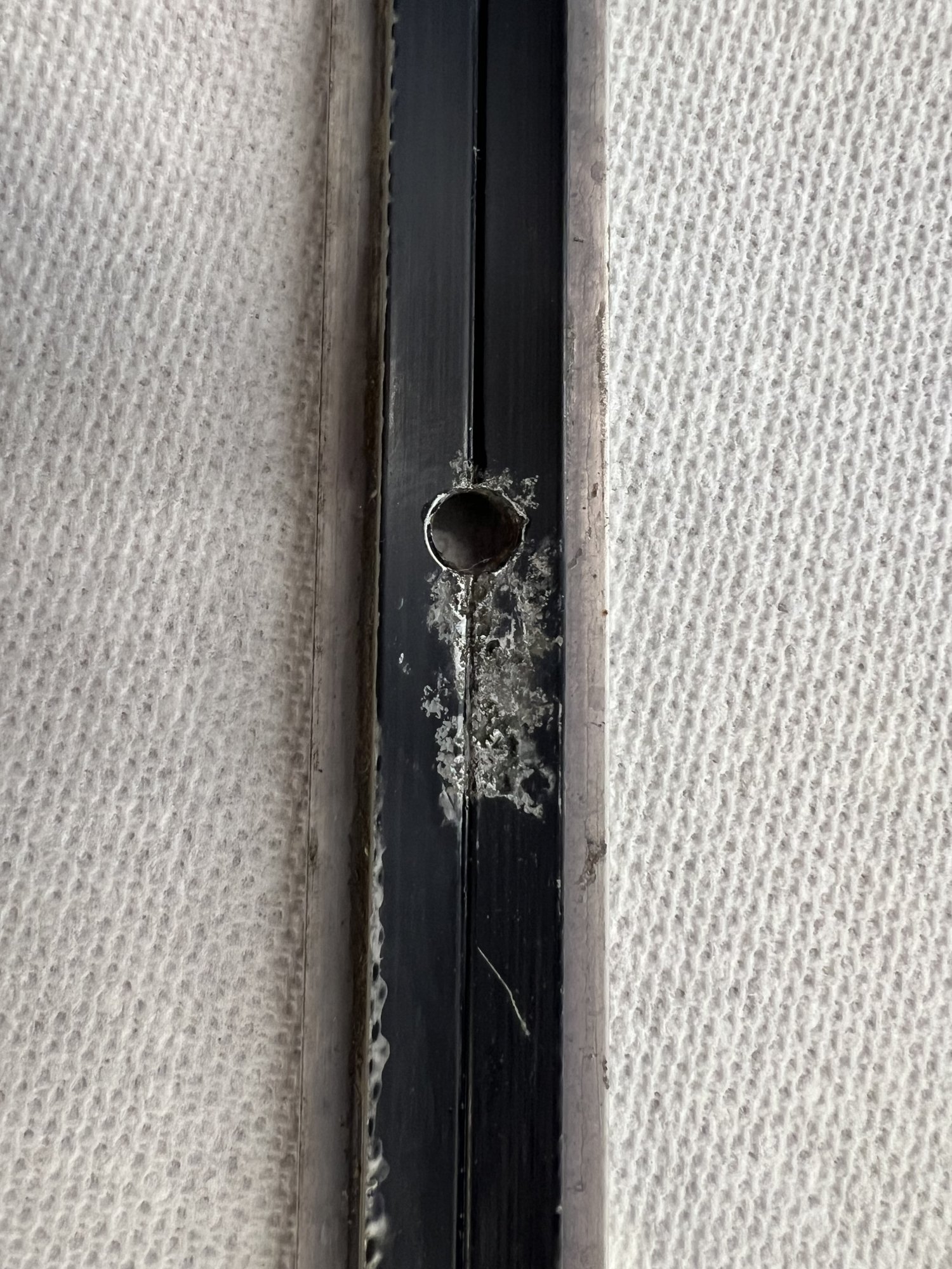

Cleaned up the starboard jib track. Most of the underside as well as the screw holes are painted black. Definitely signs of crevice corrosion on some bare spots.
Ideas on prepping the bare aluminum prior to a coupla coats of black enamel. Or would a coupla coats of 545 Primer be better?

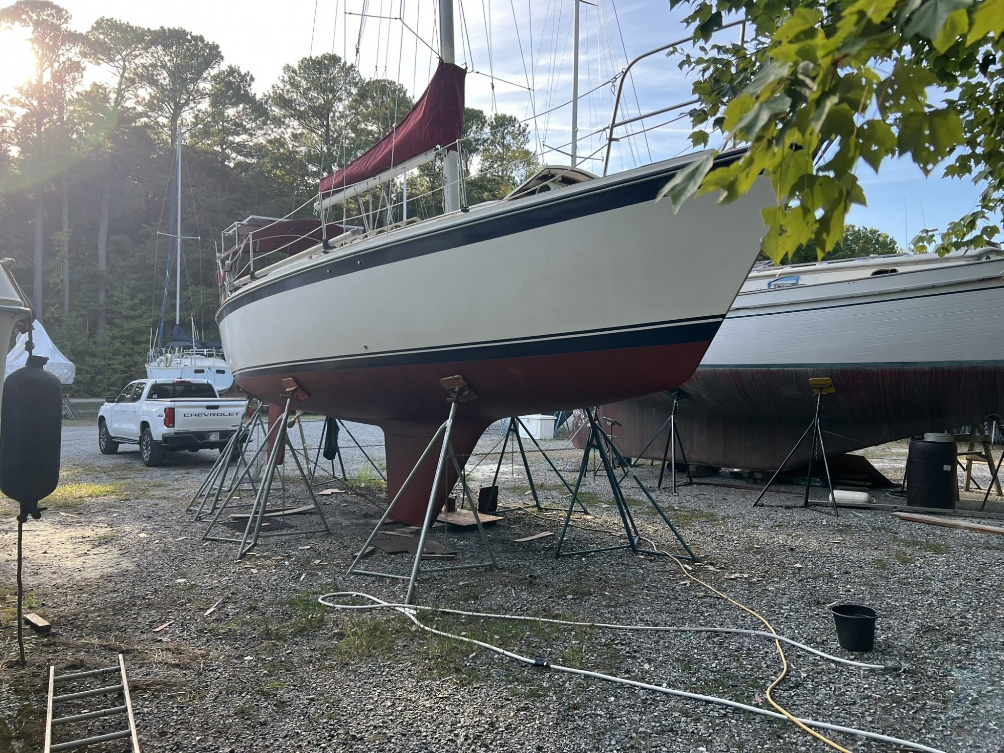

Project completed! :dancing:
Project start May 5th 2024
Completion September 7th 2025
Cost of materials: $5k-ish. Being an amateur, I figure that I wasted a good bit (25% ?) of the paint, primer and epoxy.
I figured that the project would take 9 months, in fact it took 15 months... less than twice as long, so I call that a win! I lost a few months due to excessive heat and cold temperatures.
Also, the project would have taken less time had I used other materials, I spent a good bit of time watching paint dry (roughly 16 hours between coats). Had I used other non-skid/paint/primer systems those steps would not have taken so long, however as much of a PITA the AwlGrip system was, I have complete faith that it will outlast me.
