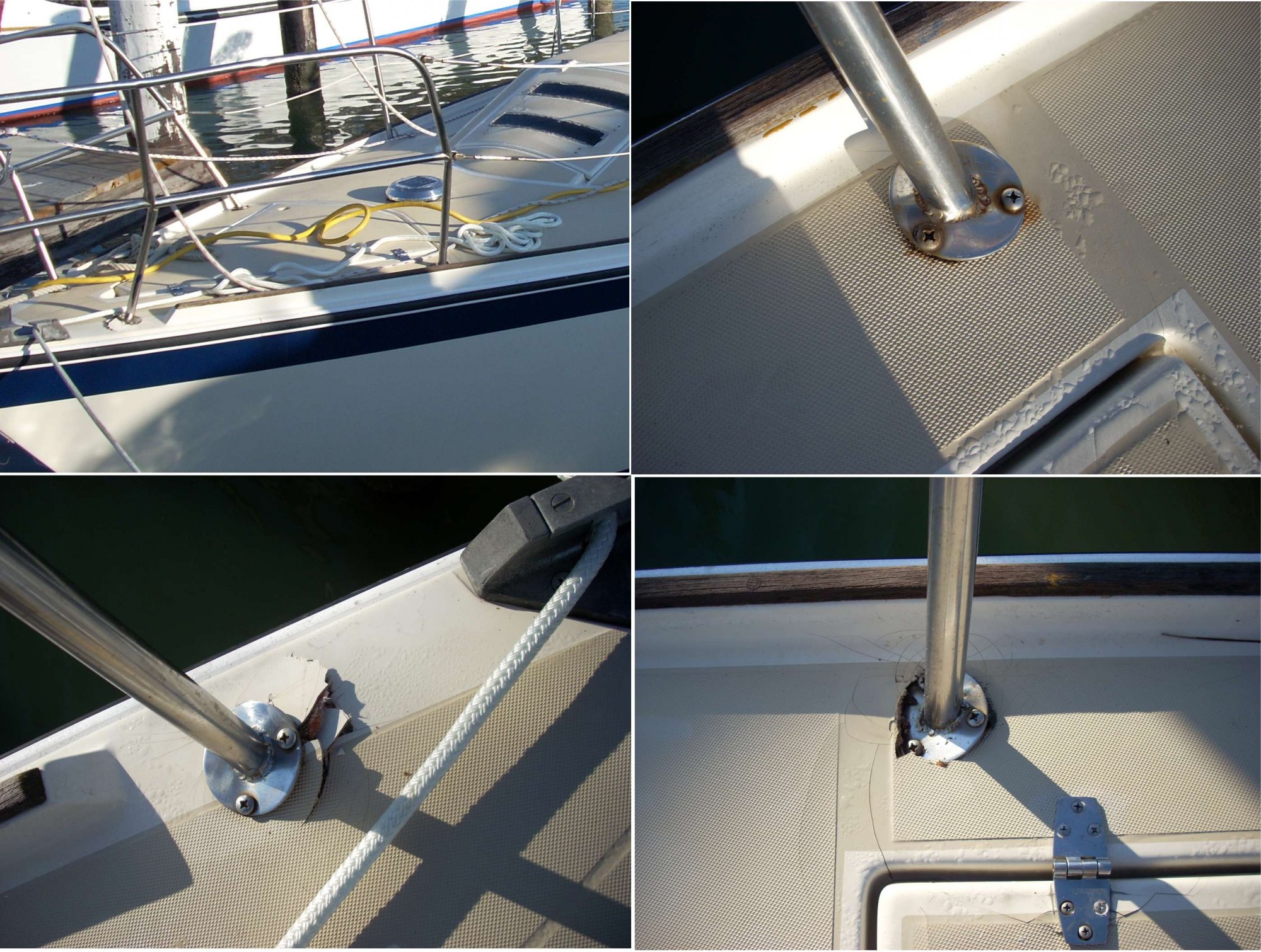

Here's some of the self inflicted damage:
Crashed into a pilon:

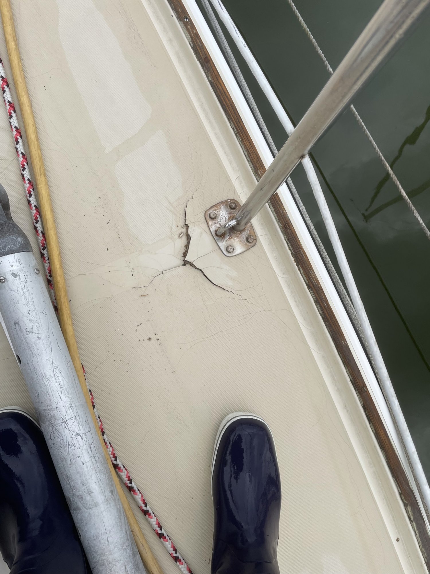

This isn't self inflicted, however as captain I take responsibility. During a weather incident the spring line got over a stanchion and put a strain on it plus the obviously already wet cored deck.

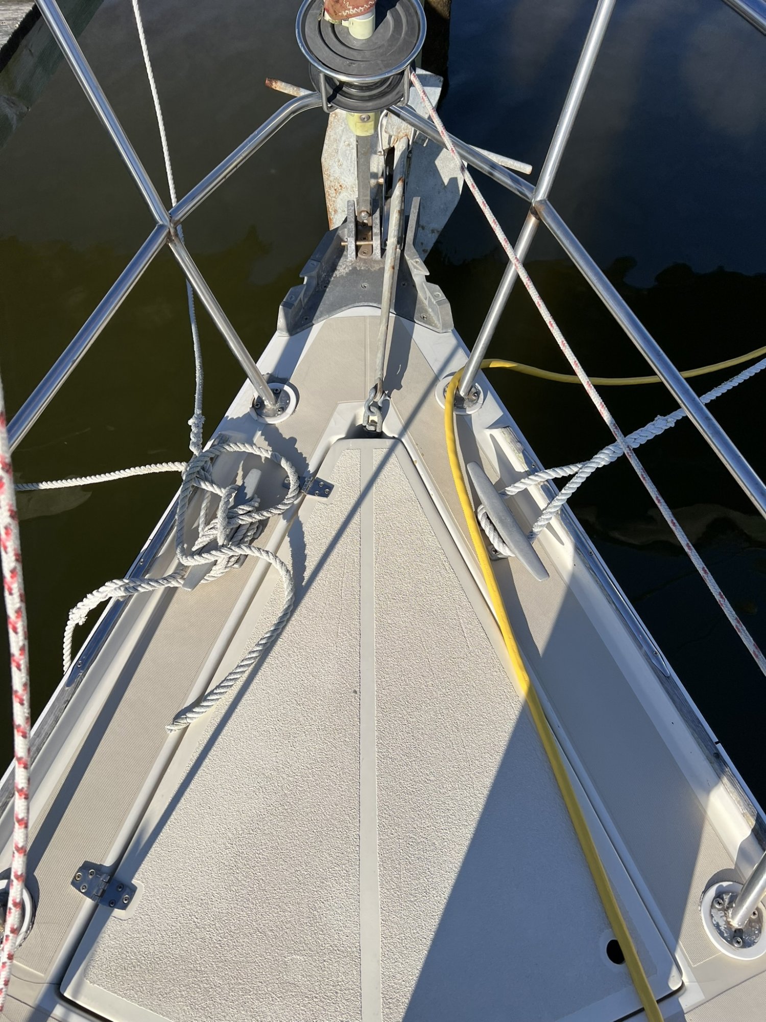

Thanks for everyone's support. I have previously built a new anchor locker cover using epoxy, EZ Fair, and Awlgrip. The non-skid was applied using the method from Andy's Boatworks Today channel
. I was pretty satified with the result. Plus gained a lot of experience working with Awlgrip. Sanded off a lot of bugs and fisheyes before I got the hang of it.
In this pic you can also see the crappy bow pulpit repair which is being corrected. JSS you're correct, I'm not shooting for perfect, just functional. As long as it passes the 10 foot test I'm ok :)

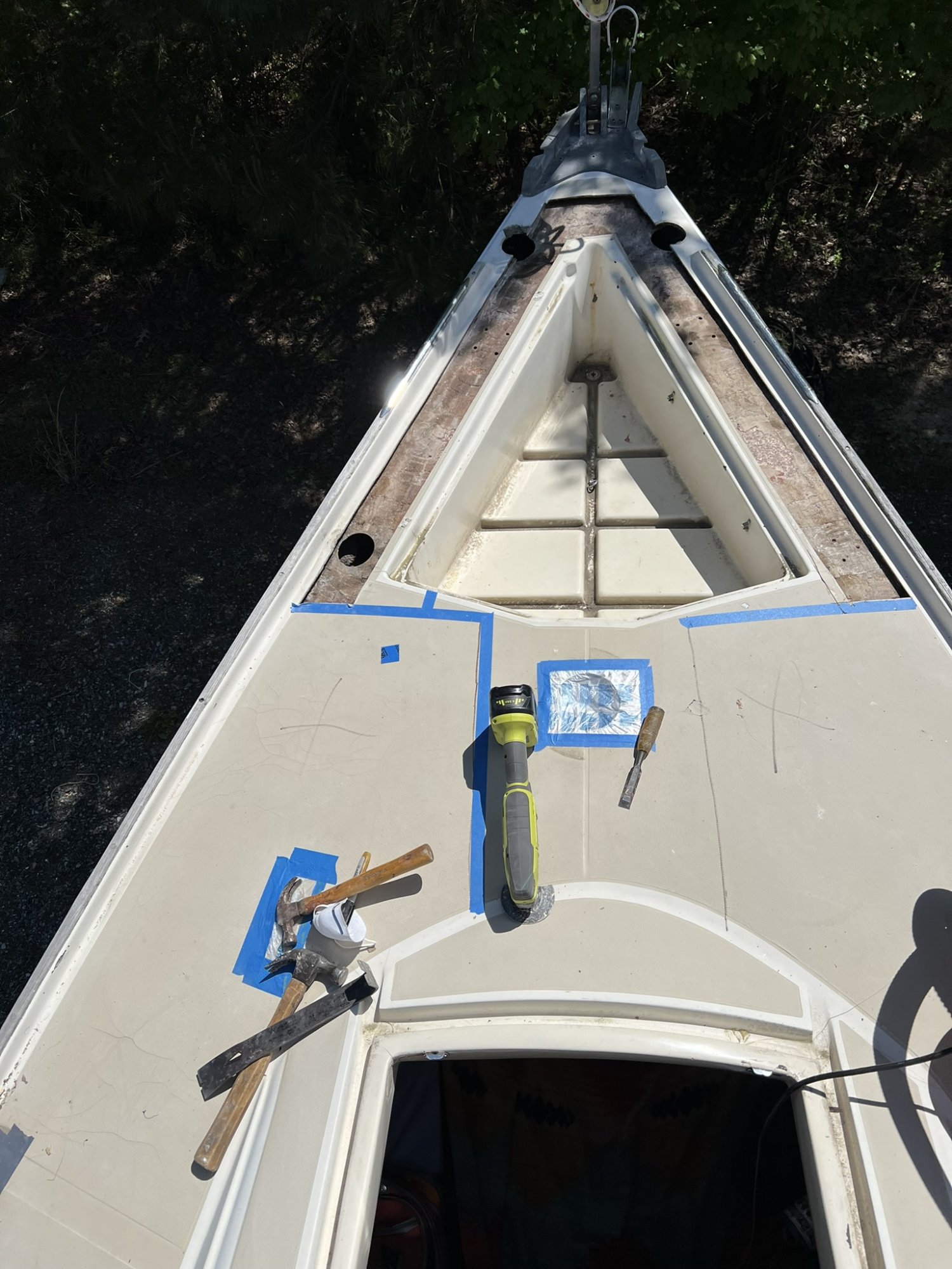

The plan is to cut out sections of the bow and the port side first as I'm working in a yard and not under a shelter. By mostly completing small sections at a time I have the opportunity to adjust my process as needed.
I'm planning on using balsa core with coosa bluewater 20 under penetrations such as stanchions, jib car track and bow pulpit. I'm figuring that way I don't have to deal with the over-drill/fill/drill again process. Should (when) and leak develops it shouldn't lead to balsa core rot... at least that's the plan.
Here's a picture of the bow work, plus some of my new favorite tools. The bow is like a bathroom, lots of edges and corners to deal with, but not a lot of area.

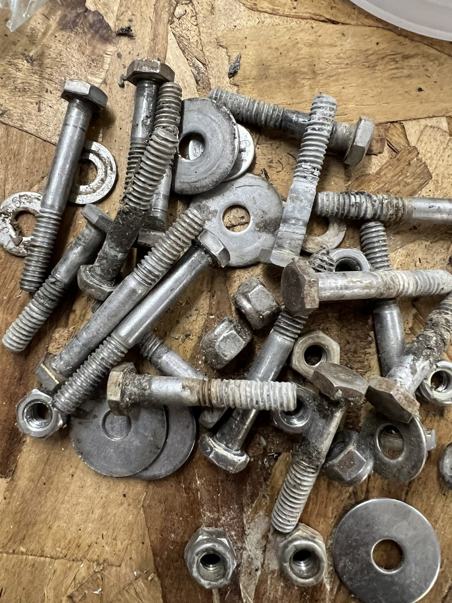

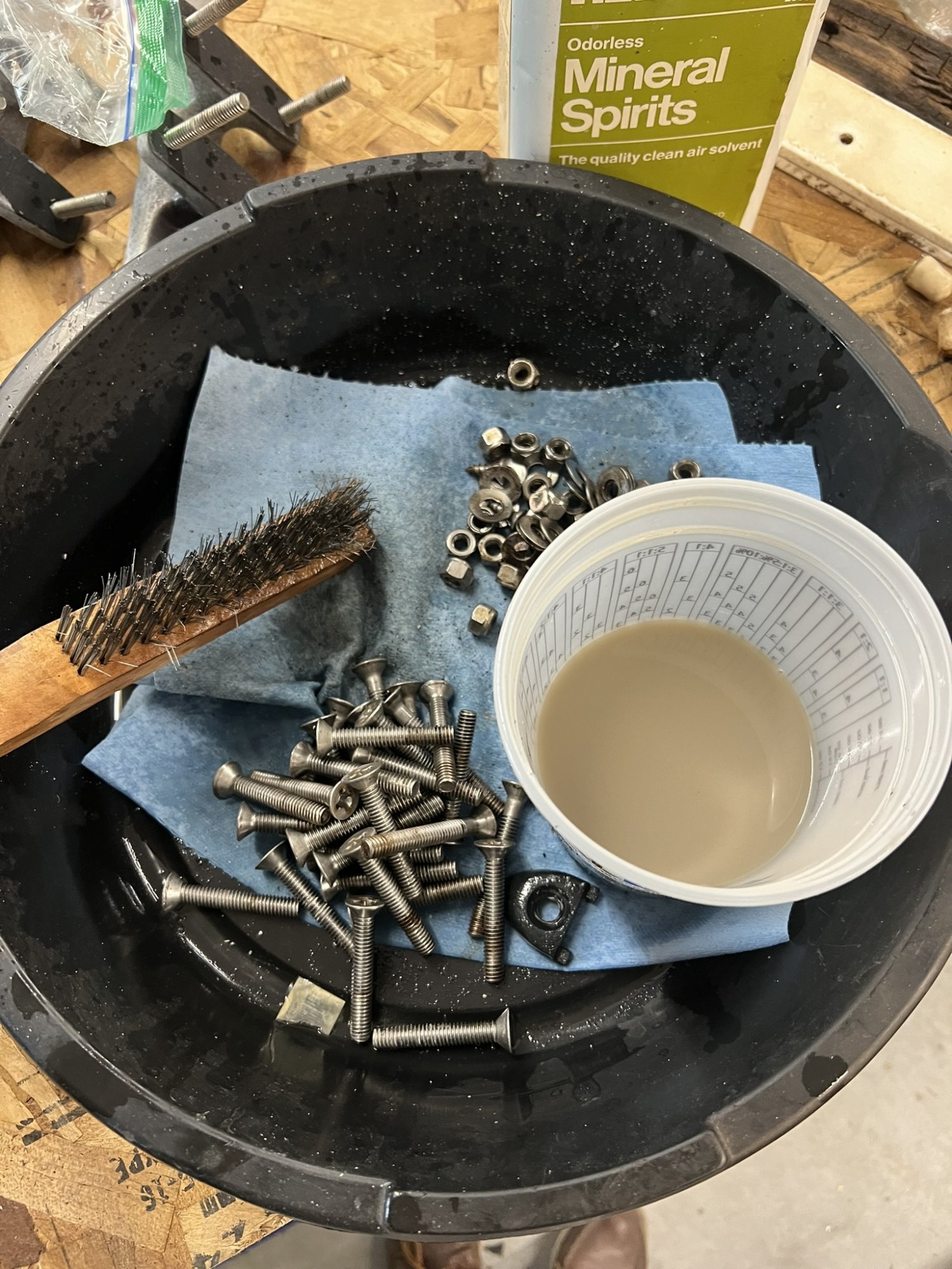

Salvaged most of the fastening hardware. Lost some nuts and washers to the nether regions of the boat along with a wrench ;) The sealant (butyl?) on the fasteners was still tenacious leading to a sticky mass of screws, bolts, nuts and washers. Cleaned them by soaking overnight in mineral spirits and wire brushing the residue off which worked well.
Searched after the fact :banghead:and found that adhesive removers are effective. Will try xylene, toluene and goof off for round two.

Here's a few random tips:
  • I soaked my bolts in acetone and I totally agree that using solvents is a great way to eliminate a lot of the crud. For rebedding I like to use a Scotchbright sanding wheel on a drill. I use it to quickly clean up bolts and on fiberglass. Most of the fiberglass is covered by hardware so if it does some very minor damage it's not a big deal. Big time saver
  • It's easier, faster and better to countersink a hole than to try to clean it
  • An impact driver will allow you to get 90% of the fasteners without help from a second person. The genoa track and traveler were the most difficult on my O'Day 25
  • I can't imagine trying to remove all this hardware without wobble extensions
  • I picked up some E-Bond epoxy because it was less than half the cost of West and Totalboat. Aside from a very slight difference in viscosity, it's nearly identical. Buy a TotalBoat pump set, drill a hole in the cap of the ebond bottles, take apart the pumps and install them onto the caps

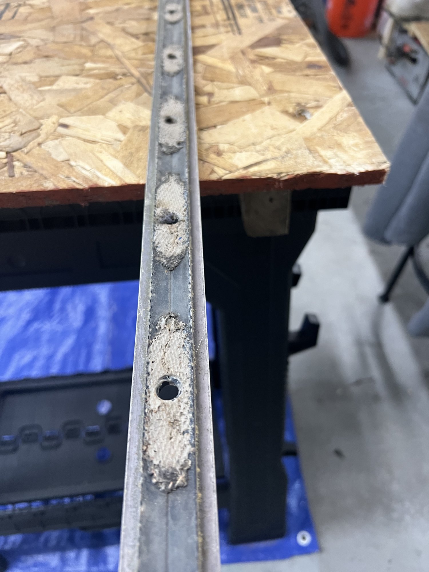

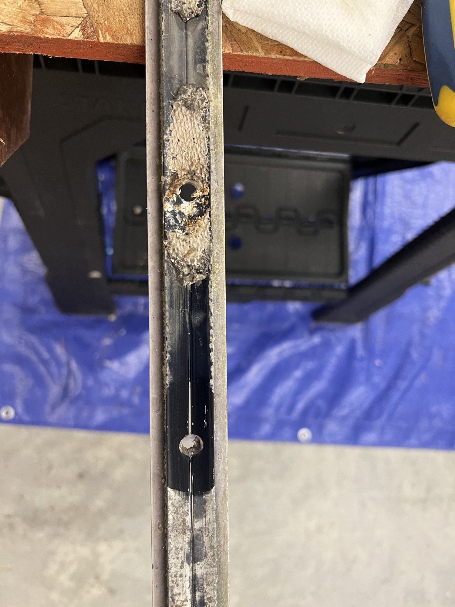

Perhaps I didn’t give acetone enough time to dissolve the sealant, an overnight soak in mineral spirits did the trick.

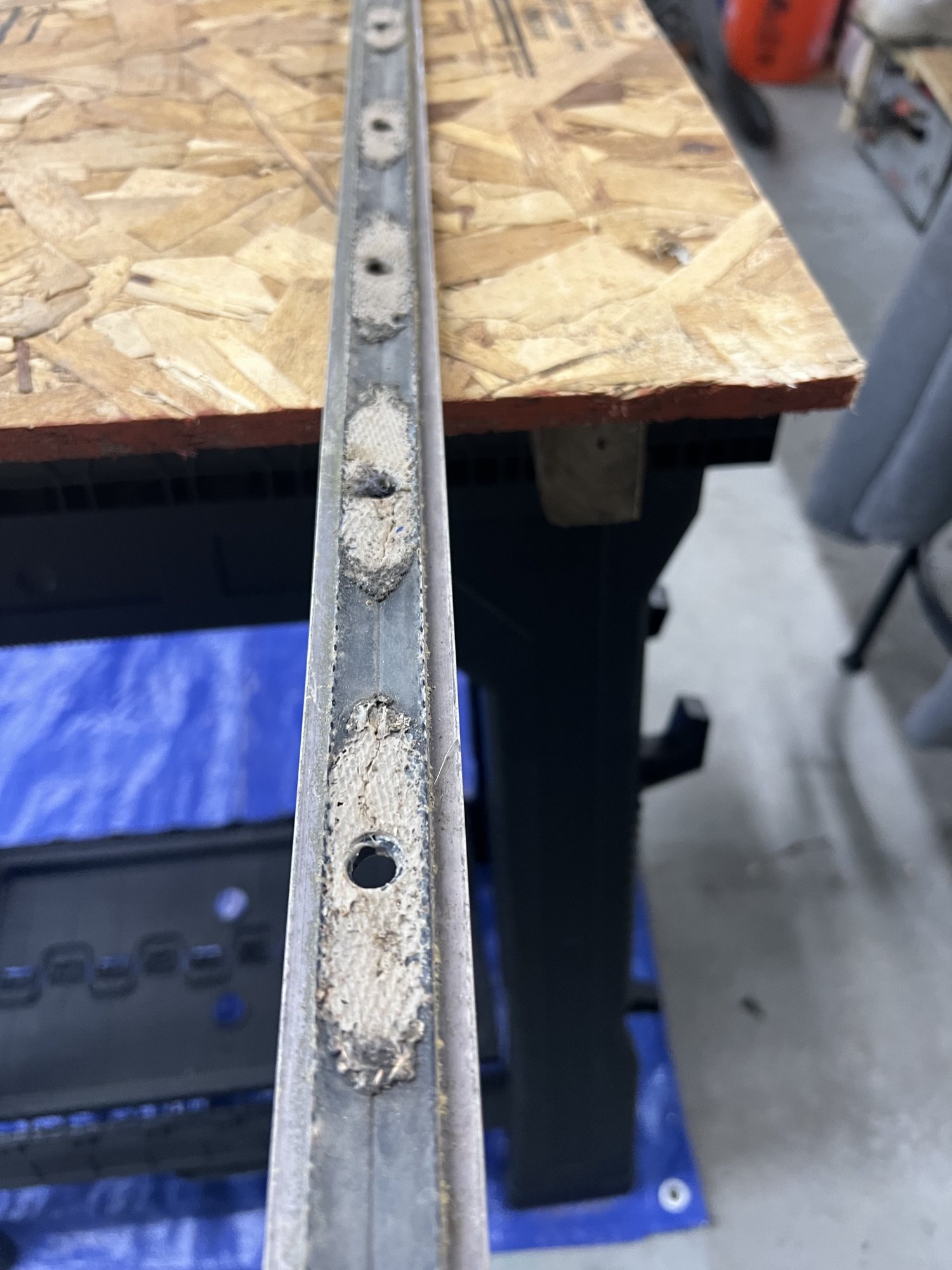

Didn’t have a big enough vessel to soak the 10 foot sail track so used a heat gun and spatula ti remove the bulk and mineral spirits for final cleanup.
The underside of the sail track is concave with what looks like a black enamel ? Note that the sealant wasn’t run the entire length of the track. I’m thinking that led to the leaks. I’m planning on rebedding using bully tape the entire length of the track and putting coosa under the track instead of balsa.

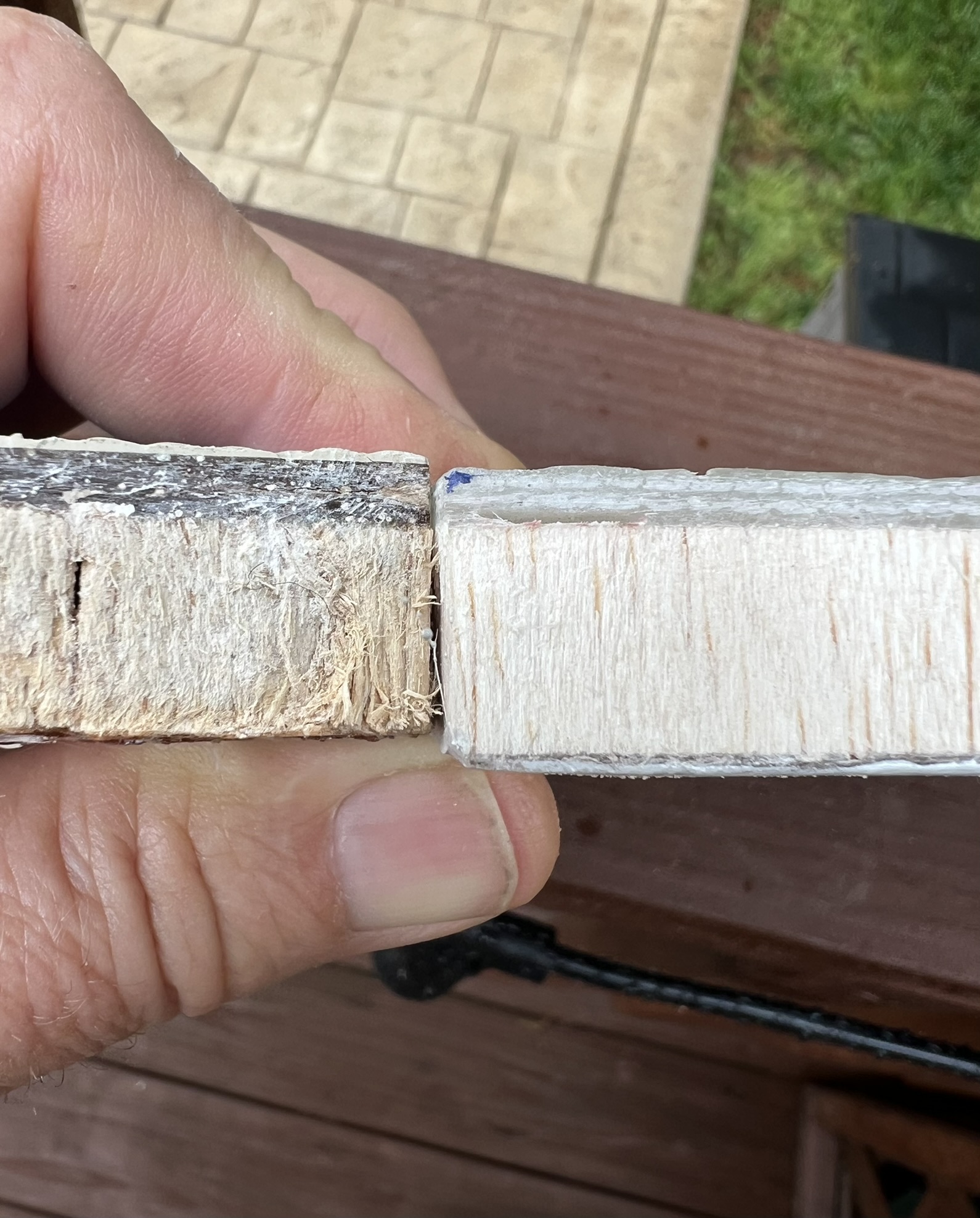

Took a plug from a deck area that was wet, but not soft in order to compare to what I practiced laying up in the garage this winter. The plug is on the left, the practice one on the right. My laminate schedule for the practice sample:
Top: 2 layers of 1708
Middle: 1/2" balsa core
Bottom: single layer of 1708
View attachment 224814The underside of the sail track is concave with what looks like a black enamel ? Note that the sealant wasn’t run the entire length of the track. I’m thinking that led to the leaks. I’m planning on rebedding using bully tape the entire length of the track and putting coosa under the track instead of balsa.
I use a Scotchbright wheel on a 120v drill to remove sealant from hardware. It's one of the fastest methods. Some marks on the bottom of a piece of hardware isn't a big deal since it wont be seen and the gaps are filled with sealant. Three years later and I dont have any leaks!
