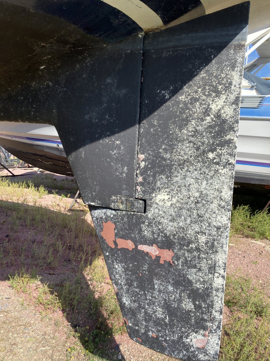

Looking at a 1984 Kirie Elite 32 and need some advice. In good condition, needs a little maintenance but on only major concern is the movement of the skeg. As shown in the video, there is about a 3/8-1/2 of movement if you manually push on the skeg. This does not seem right. Looks like a hybrid, spade supported rudder. The questions are:
1. Is the amount of movement normal for this kind of rudder?
2. Is a repair in order?
3. Can it be repaired as a DIY project if necessary? If so, what is the recommendations?
Any help is appreciated. I will try to post a video.

Doesn't look very good to me, but I've never encountered anything like that before.
24,926
questions are:
Unknown. Would want to have look on the inside. Is the flex due to inner lack of support for the hull where the skeg attaches.
Could be. Two possible issues come to mind. The inner bracing of the hull may have been weakened. ie: tabbing broken loose or never properly secured. Hull is thin in the area of the skeg and what you see is hull flex. You may be able to add supports to eliminate hull flex.
On the other hand the internal connections in the skeg may have broken. To find answer would need to inspect inside of hull.
Answer may depend on way you plan to use the boat. Racing in open Ocean Most definitely repair required.
Ha. Anything can be repaired based on skills, patience, and money.
How to go about it would depend on examination of the internal area structure where the skeg is attached. I suspect the inner bracings are not adequate to support the skeg and rudder.
Best of luck.

Mostly what @jssailem said.
There are a couple of issues, the skeg supports the rudder, so lateral movement is not good, there is a lot of pressure on the skeg. The rudder bearings may also need replacing. Together the skeg and rudder should not have any play in them.
Yes, it should be repaired.
Anything can be DIY if you have the skills and tools. How big a job this might be won't be known until the bottom paint is removed and the hull inspected. One thing you can do is to sound the hull with a hammer or screwdriver handle. As you tap along the skeg, the sound should be sharp and clear. If you get dull sounds or thuds, the glass may be delaminated or cracked. Inspection from inside the boat is also warranted.
This is probably a boat you'll want to walk away from unless you are looking for a potentially large project with unknown costs.

Flexing of the hull due to inadequate interior support makes sense as there are no visible exterior cracks that are noticeable while moving the skeg. One of the things I am trying to understand is the anatomy and structure of the skeg and skeg design in general. Is it solid fiberglass or fiberglass over a core like a rudder? Is it bolted to the hull similar to the keel? What should the interior of the hull at the skeg location look like? We did not get to see the interior of the hull but we did locate the access panel. Need to see this area next.
Also, the design looks to be a hybrid. Perhaps it’s a spade rudder that also attaches to a skeg. It’s not structurally hung off the skeg like some I’ve seen. Wondering if the post takes most of the load like a spade rudder and the skeg connection is secondary.
Is there normally lateral movement with spade rudders? Could be play in the post bearings/bushings? The boat is in South Dakota and finding local expert advice is not happening. Any help in understanding this issue is appreciated.

The skeg was likely part of the mold when the hull was laid up and not bolted or glassed in later. Taking a look through the inspection port will give you a better idea.
It is likely constructed in the same manner as the hull, so if the hull is cored, that will cored too. However, the space is pretty tight, so I'm guessing it is only fiberglass.
The semi-spade rudder on this boat is mid way in the rudder design evolution from full rudders hung of off full keels to the modern spade rudder. The skeg provides lateral support and helps to improve tracking by sort of extending the keel. Having the rudder supported in three places, upper bearing, lower bearing and the skeg distributes the load over a larger area and probably allows for a smaller lighter (less costly) rudder post.
There should not be any lateral movement with a spade rudder. If there is lateral movement, the rudder bearings are worn and need replacement.
I seem to recall a series of articles in either Sailing Magazine or Good Old Boat Magazine about rudder design and keel design. finding them might be helpful.

It’s a short video but it looked to me that the play in the rudder is in the bearing. As you pull on it you’re moving the whole boat, can see the hull moving as you pull/push, so at first glance it looks like movement in the keg. Looking closer you can see the rudder moving about 1/8” in relation to the keg right at the bottom bearing.

The Skeg should not be moving - as stated above.
How big a job? Well, can you look inside the boat where the skeg is hung and take another video in there showing where that movement translates inside? That may help figure that out.
My first impression is it's a big job. Drop rudder, cut out existing skeg connection to hull, see where the structural inadequacy lies, rebuild so there is no structural inadequacy. There may be other ways around it depending upon what you see inside, but my first guess is you have a lot of structural glass work to do. Are you prepared to do that?

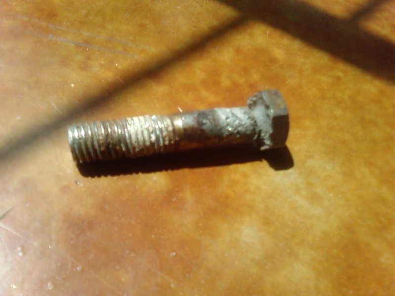

JDE, In your movie, it looks like the skeg is flexing along a 45 degree (up and aft) line..from the skeg cusp line.. some discoloration can be seen along that line (dampness?); they look like filler that hasn't cracked (yet) from the flex.. The inspection port should give you a good idea .. if you see bolts, kinda like keel bolts but smaller, ya may have some crevice corrosion on the bolts (replace, big job) or simply loose nuts that need to be tightened.. Because the rudder is "balanced", there is a good bit of lateral force on that bottom skeg bearing.. Investigate carefully.. get a quote on the repair..
EDIT: attached is a picture of a bottom skeg bolt from my buddy's Tartan 37.. You can see that the crevice corrosion has eaten half way through the shank right under the head.. It was loose, but until we removed it, it was a mystery why..

Yes I’ve noticed a similar line of weakness in the skeg and suspected some repair work had been performed. When the light hits it just right you can see an arc. That would seem to be the natural place for stress cracking to occur.
We do have a copy of a marine survey from 2012 and there was no indication or mention of the skeg only some slight delamination on the rudder which was subsequently addressed but needs further attention. This survey is by no means conclusive but an interesting data point.
So it’s possible there are skeg bolts. Really need to see the inside.

If you do have bolts that need replacing, I'd recommend bolts made from 17-4 PH stainless steel. Here's a link to McMaster Carr where they carry them. You may be able to find other sources.
This is a better material for bolts in this area than the 316 bolts often used.
