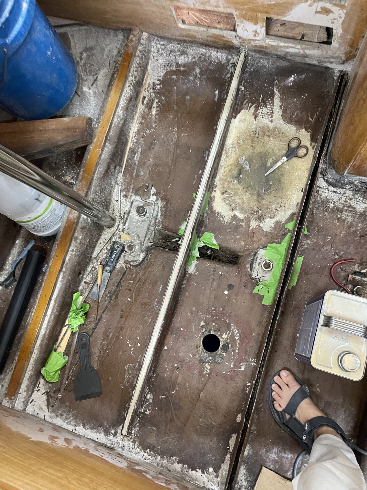

Hey! Can't believe I just saw this. My wife and I purchased this exact sailboat around December 2020, just 3 months after this posting.

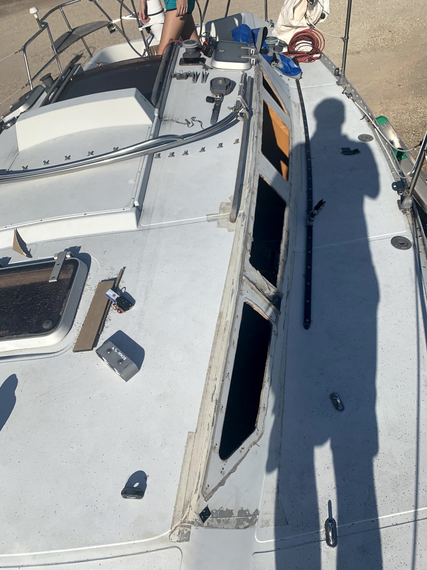

We were in GA so had an inspector come out. Main issue was the acrylic long windows on both sides of deck cracked and damaged the interior wood trim around the windows, and caused some of the elm to get damaged below the floor boards. So we were able to get the price down quite a bit, shipped it over to the gulf coast in Alabama and moved down here! Originally we drove from Atlanta every weekend working on it but that didn't work
So, about the rudder. The skeg was perfectly fine, but since you mention it, I'll double check it but I did examine it and it was fine. The issue was the rudder and gundgeon. The rudder was made of wood and fiberglassed over. So it was completely rotted inside. Also the gundgeon was pitted and deteriorated. As well as the bearing that goes on the rudder shaft and into the gundgeon was chipped and worn.

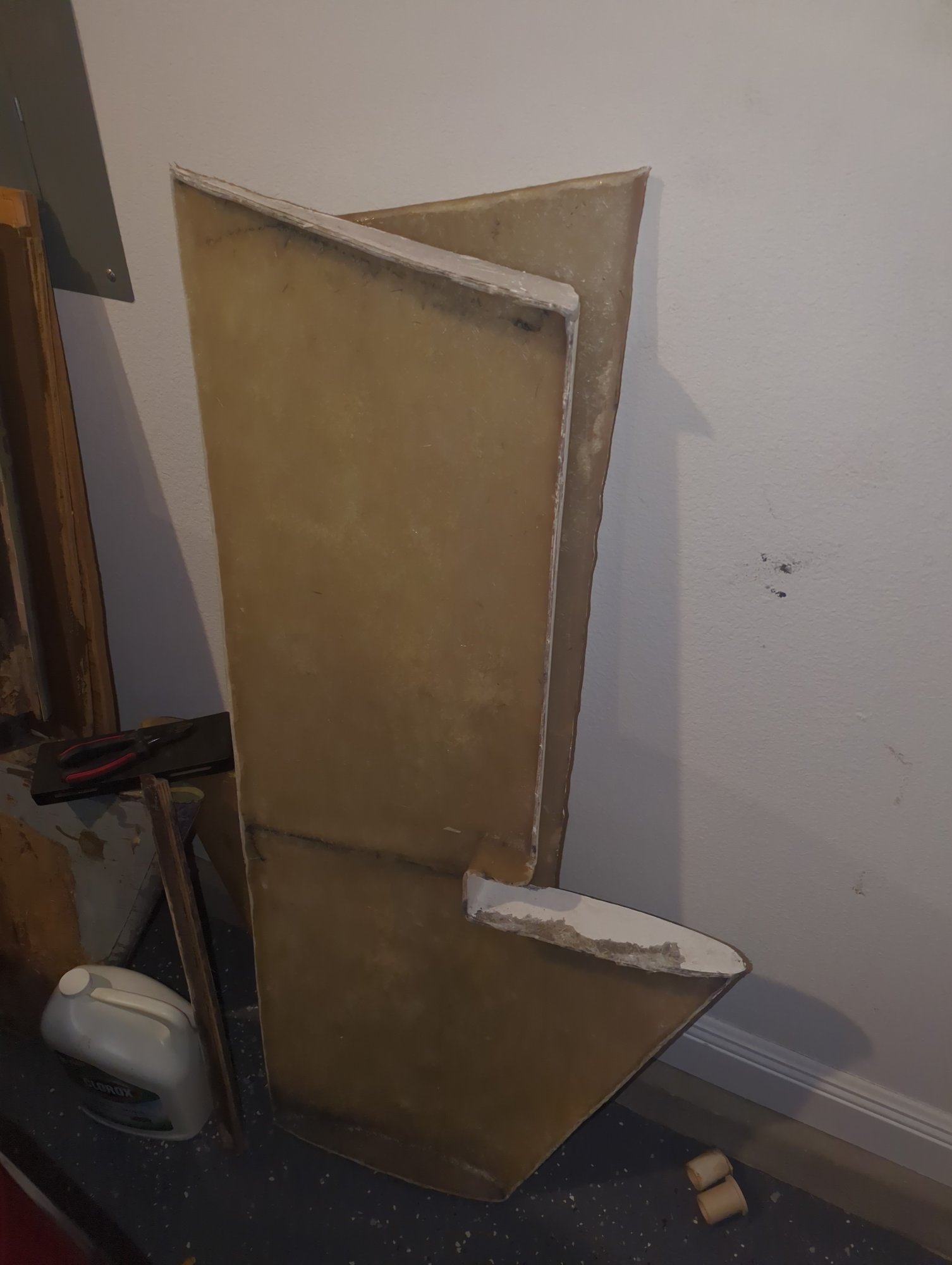

So after dropping the rudder and discovering that, my wife made a mold of one side of the rudder (after fairing it and making it smooth), and then fiberglassed a new side of the rudder. Also had a shop make a new bearing from some better material. We have the pour foam that we will use and glass over it. Just waiting on the machinist to make a new gundgeon since that fits on the shaft and then glassed around it.
We knew we wanted a boat to refit since no boat had what we wanted. We checked out a Kirie in SC, and price was over the top and wouldn't budge, but my wife fell in love with the interior design Kirie has so when she saw that she wanted it.

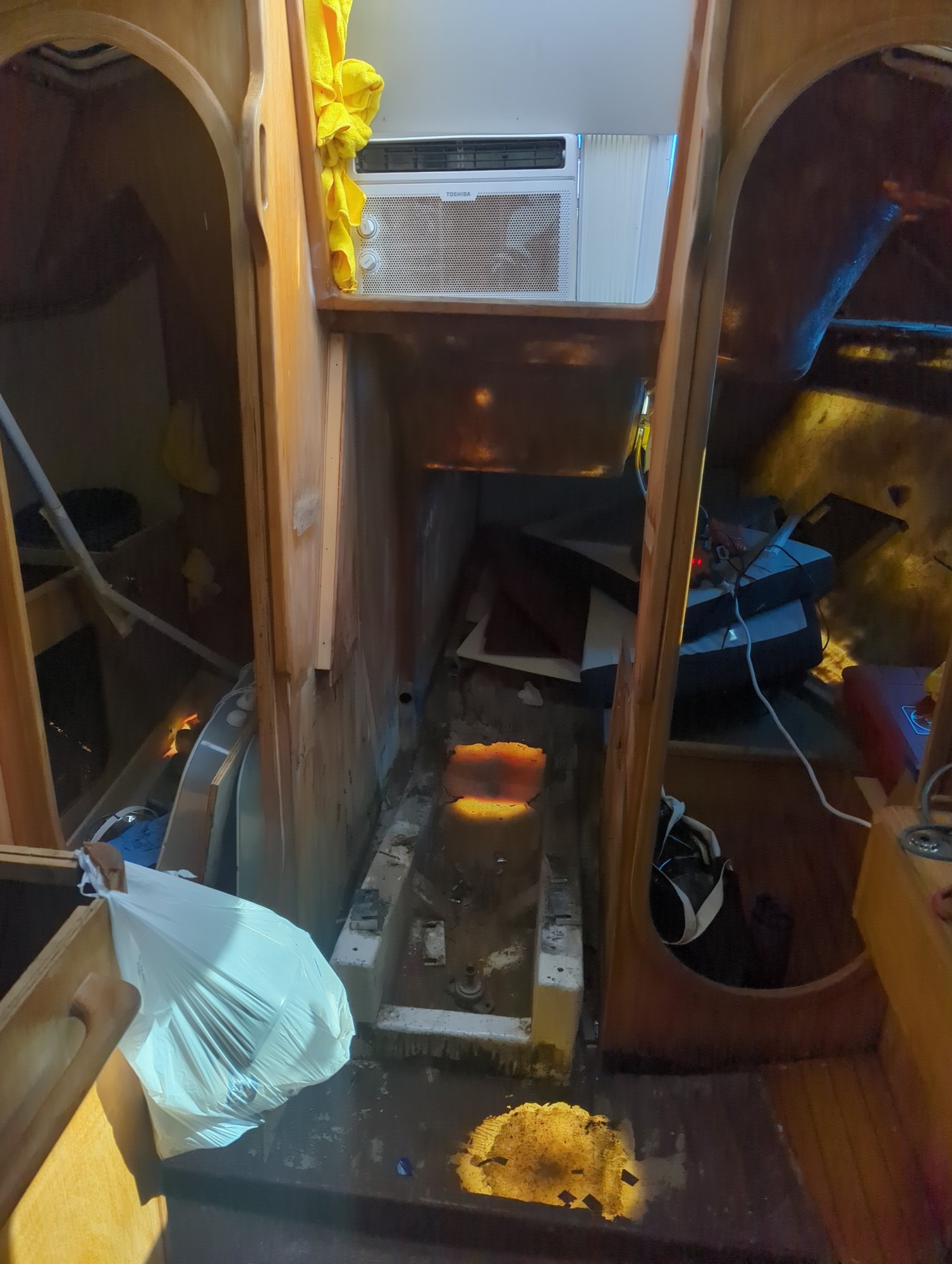

We've gutted that entire boat, looking at past photos I can't believe it looked that bad in some areas compared to now ahaha.

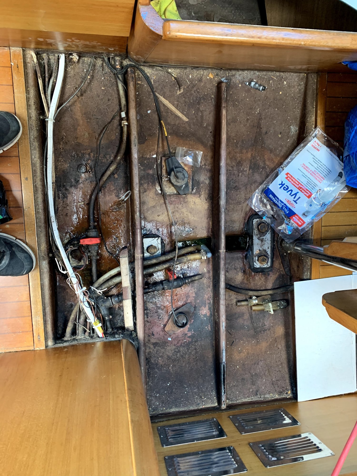

Previous owner ran ac drain, shower drain, wet locker drain, all to the bilge. Can imagine how nasty it was. And electrical, HVAC, he did was horrendous.
Headliner was carpet, had to grind the glue after ripping that off. Varnished all the floorboards but haven't put them back in until we take off cause don't wanna damage them yet.

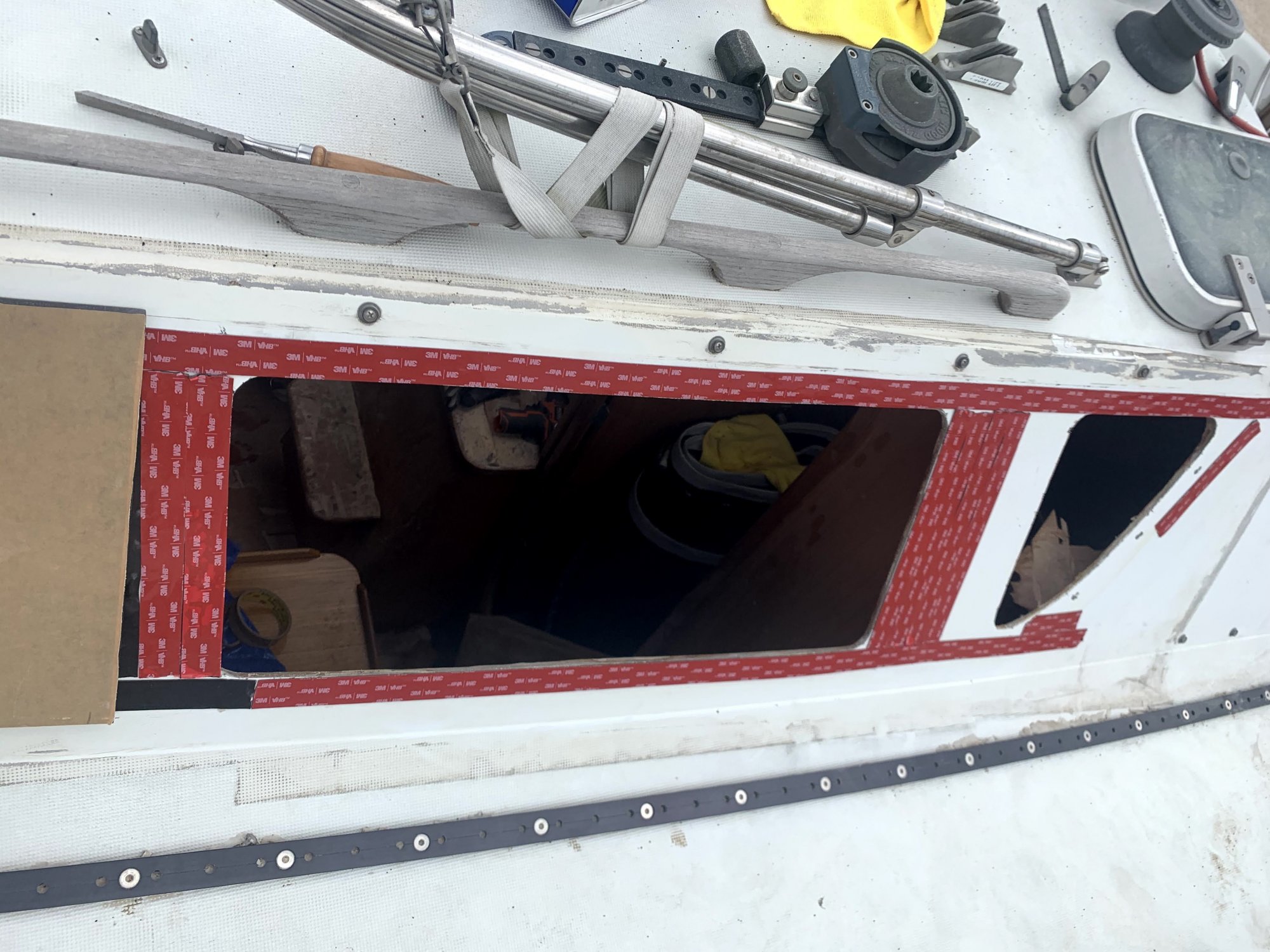

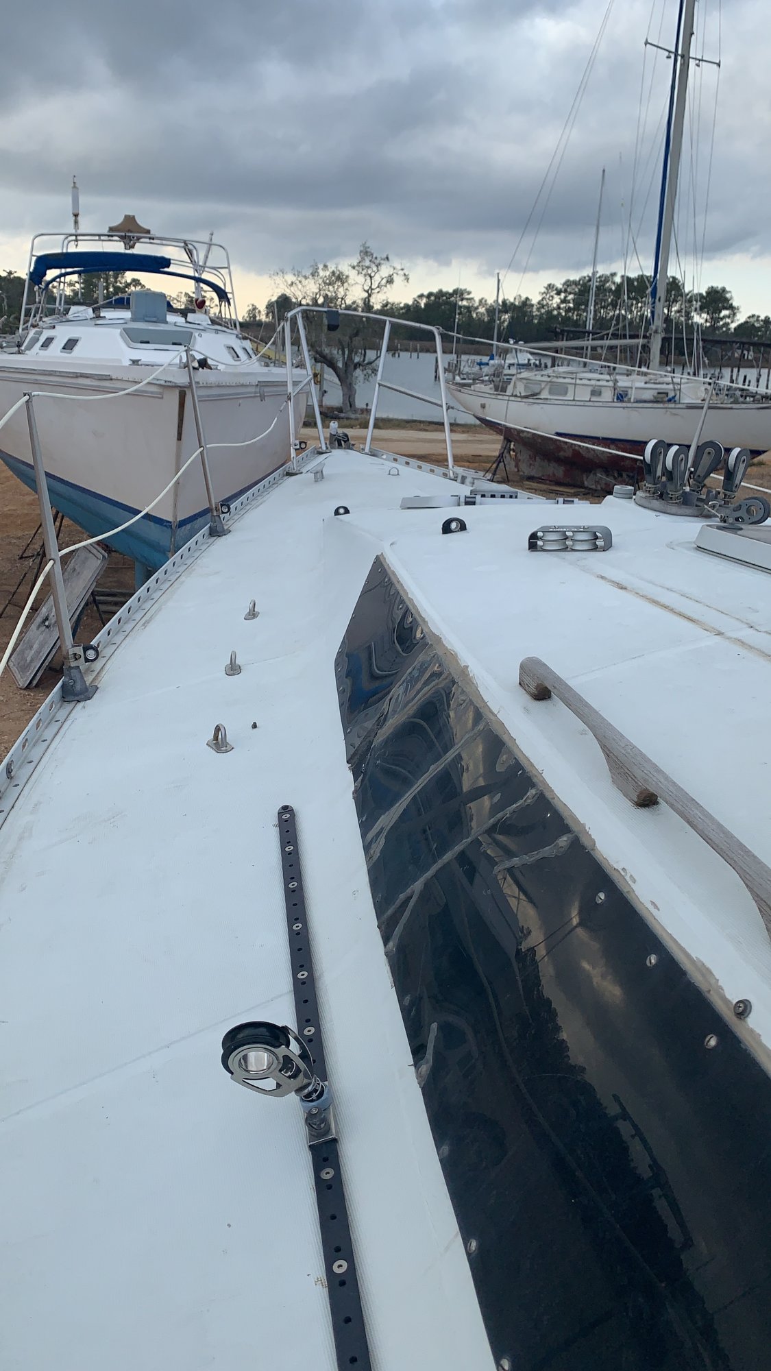

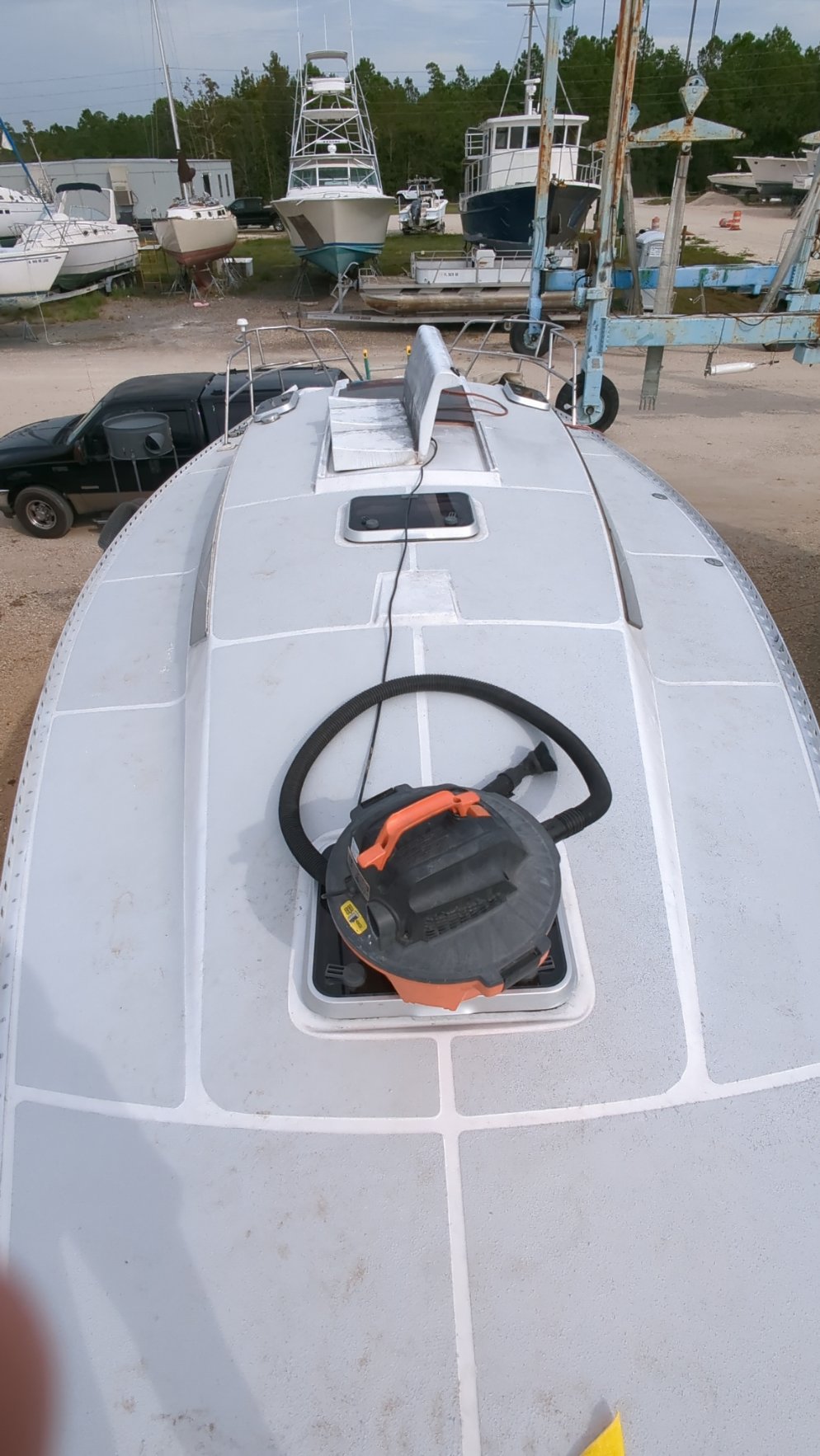

* Cut new acrylic windows for top deck on both sides, and the port aft cabin window.

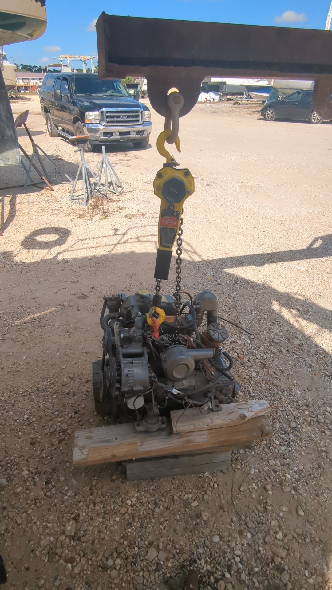

* removed engine and fiberglassed engine thruhulls and throttle in cockpit. Plan on going engineless. Plus engine bay is now perfect for installing lithium batteries and to have entire electrical panel and wiring based in there.

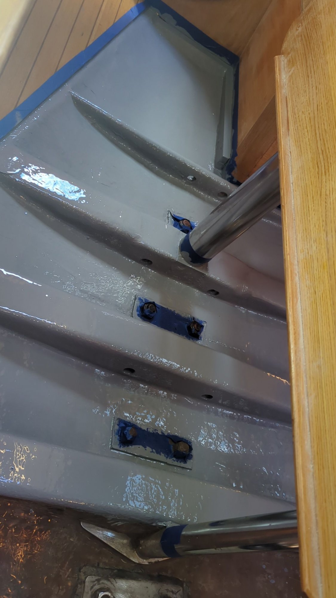

*Retabbed much of the bulkhead areas. Water damage, I assume, delaminated some.
*Repainted entire lockers and bilge from the ugly brown to interlux bilgekot grey.

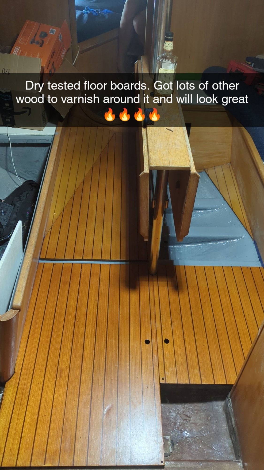

Posted some photos if anyone was curious. IMG_20231022_195126.jpgSnapchat-355920334.jpgSnapchat-799227179.jpg5BB5C046-ACE6-4290-BB55-FBDB77BA5A24.jpgIMG_6408.jpgIMG_4437.jpgIMG_4424.jpgSnapchat-1799501654.jpgIMG_20231104_113602.jpgSnapchat-703015075.jpg

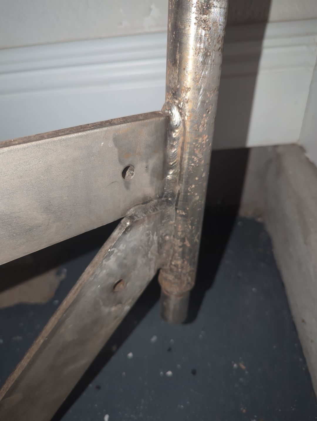

How are you reinforcing the internal structure of the rudder? Most (all?) foam rudders have a SS web inside to support the forces on the rudder, foam just isn't strong enough.
When the acrylic was installed did you drill over sized holes for the screws? If not, the acrylic will crack around the screw holes due to thermal expansion.

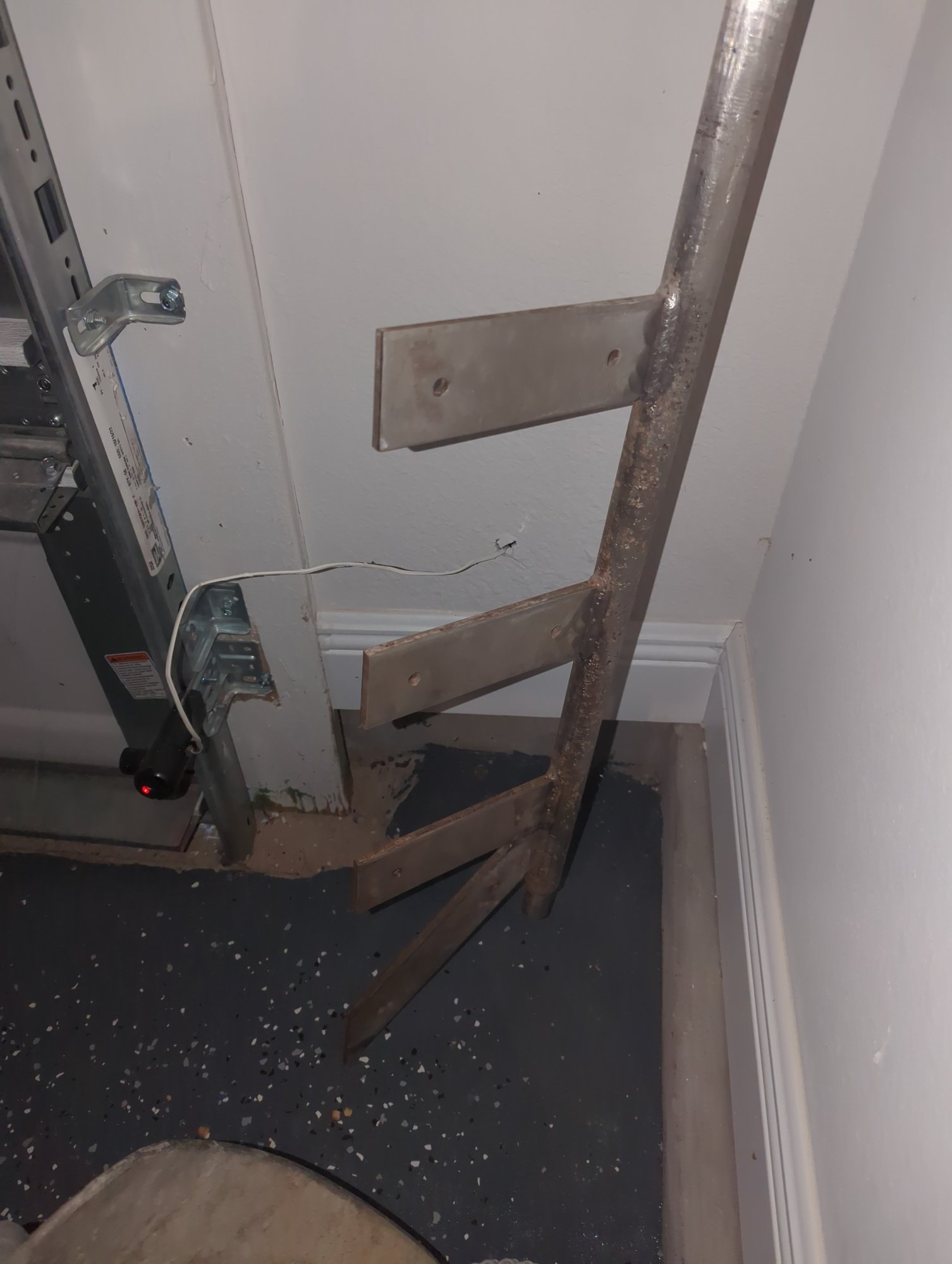

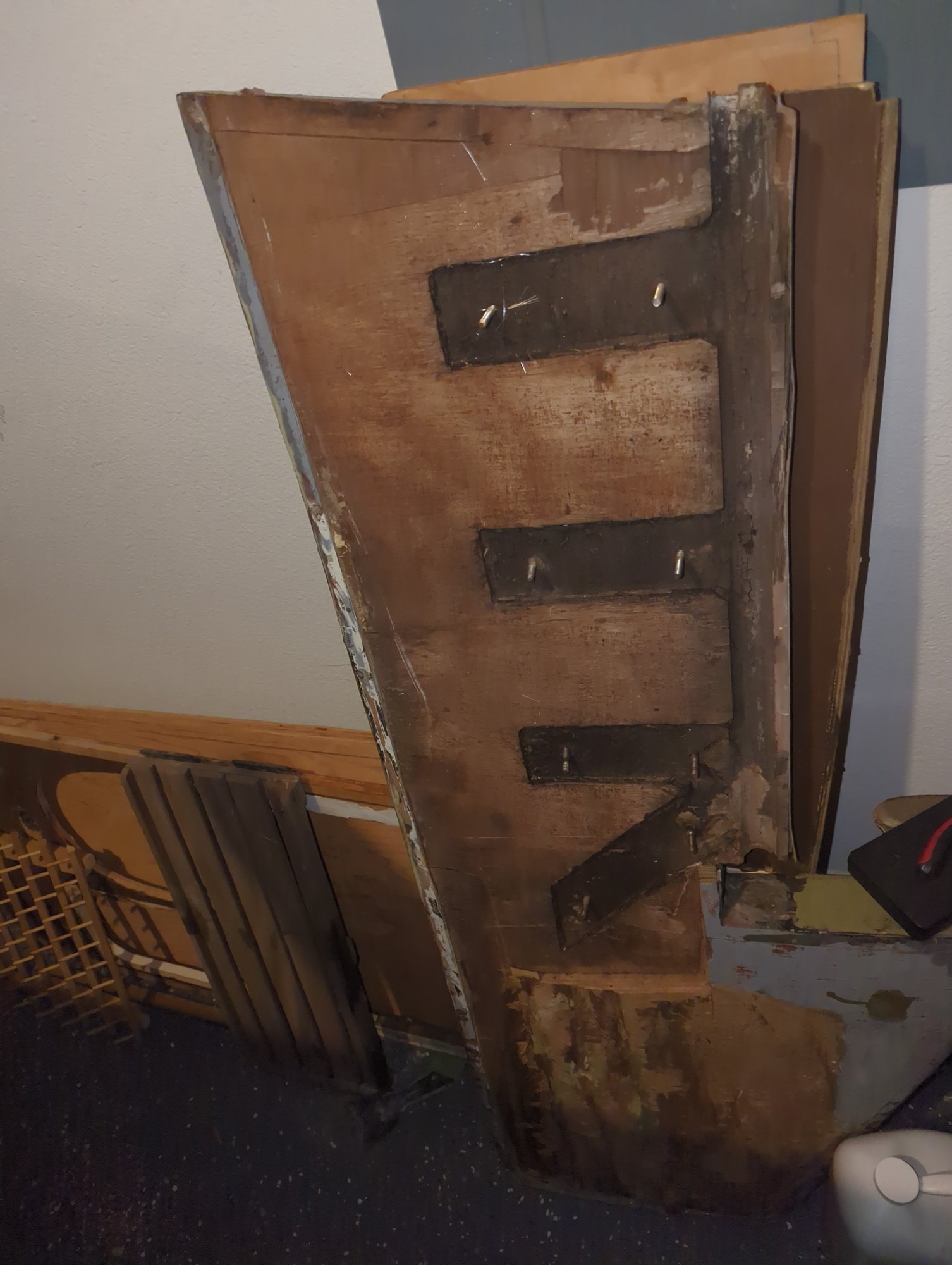

Yes I was a wondering about that. We've built it following how the guy from boatworkstoday on YouTube rebuilt a rudder and he didn't add anything extra, but that was a small rudder and it was just a straight shaft.
Ours has these welded on pieces that point outward. Between that, and 16ft pound foam, do you think that would be enough?
The old wooden one was throughbolted between the wood and then fiberglassed over.

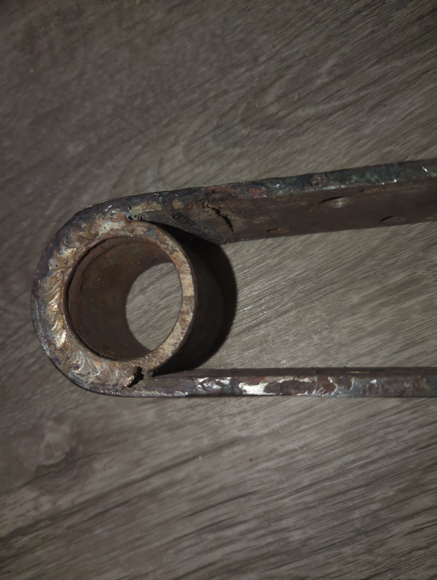

I've attached some photos of the old rudder half, the new side we made from a mold of it, and the shaft itself also with the gundgeon and bushing.
As for the acrylic windows, we followed what the guy from boatworkstoday on YouTube did (haha learned a lot from watching that guy) and we did 3m double backed tape, and then sealed the edes with Dow corning 795 sealant. Didn't want to drill any new holes since that's what caused the previous cracks and water leaks. IMG_20231107_081829.jpgIMG_20231107_082230.jpgIMG_20231107_082258.jpgIMG_20231107_082328.jpgIMG_20231107_082548.jpg

Andy from Boat Works is good reliable source. I've been a follower for years.
As for the rudder, the last picture in the above post is the part I was wondering about. So long as the welds are still good and there is not crevice corrosion you'll be fine. The old gudgeon does not look all that healthy.
So the photo of the acrylic is the old stuff, not what you installed? If so, the PO did it wrong as you now know.

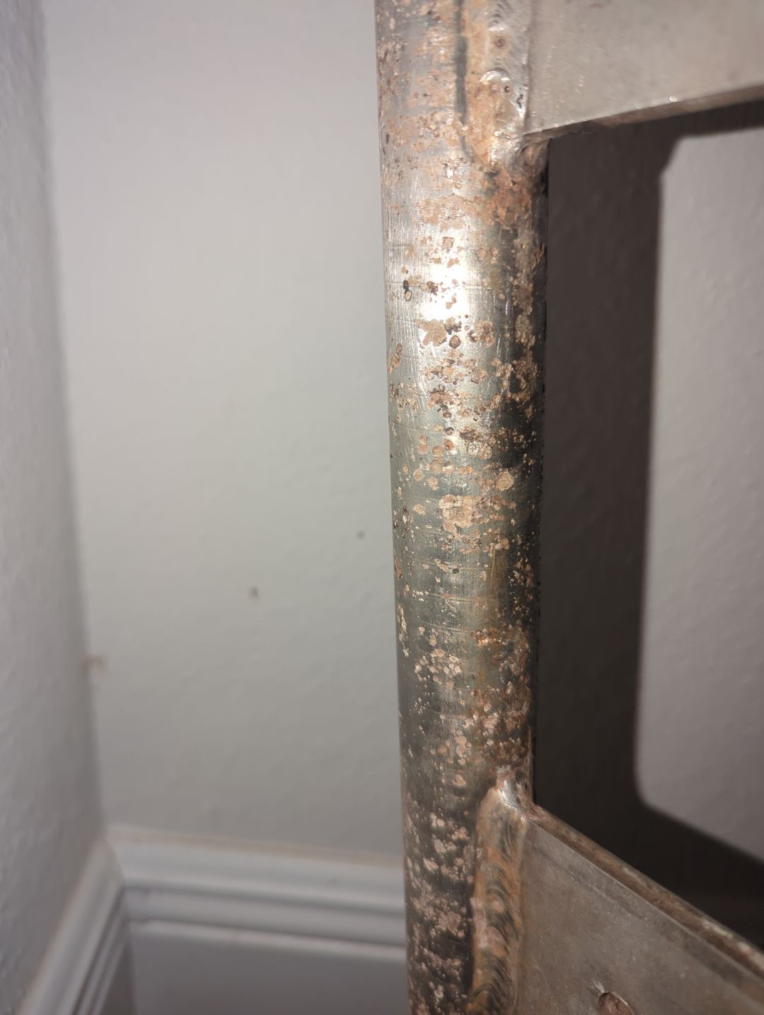

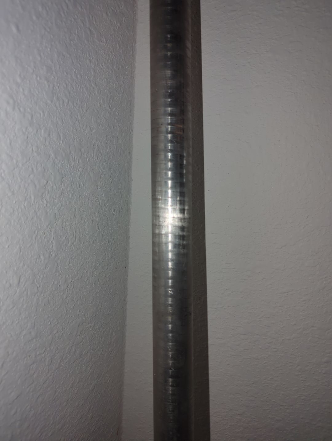

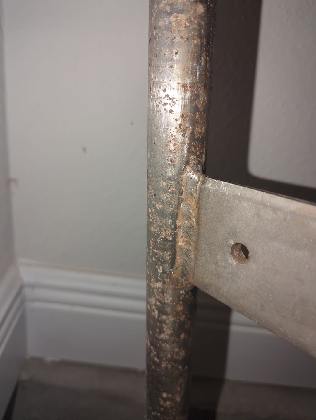

Yes I was wondering too. Welds look good, but there's some tiny pin holes throughout the lower shaft. When the welder/machinist checks it out I'll ask and see what he thinks. I'm not welder so not sure if its really good or bad.

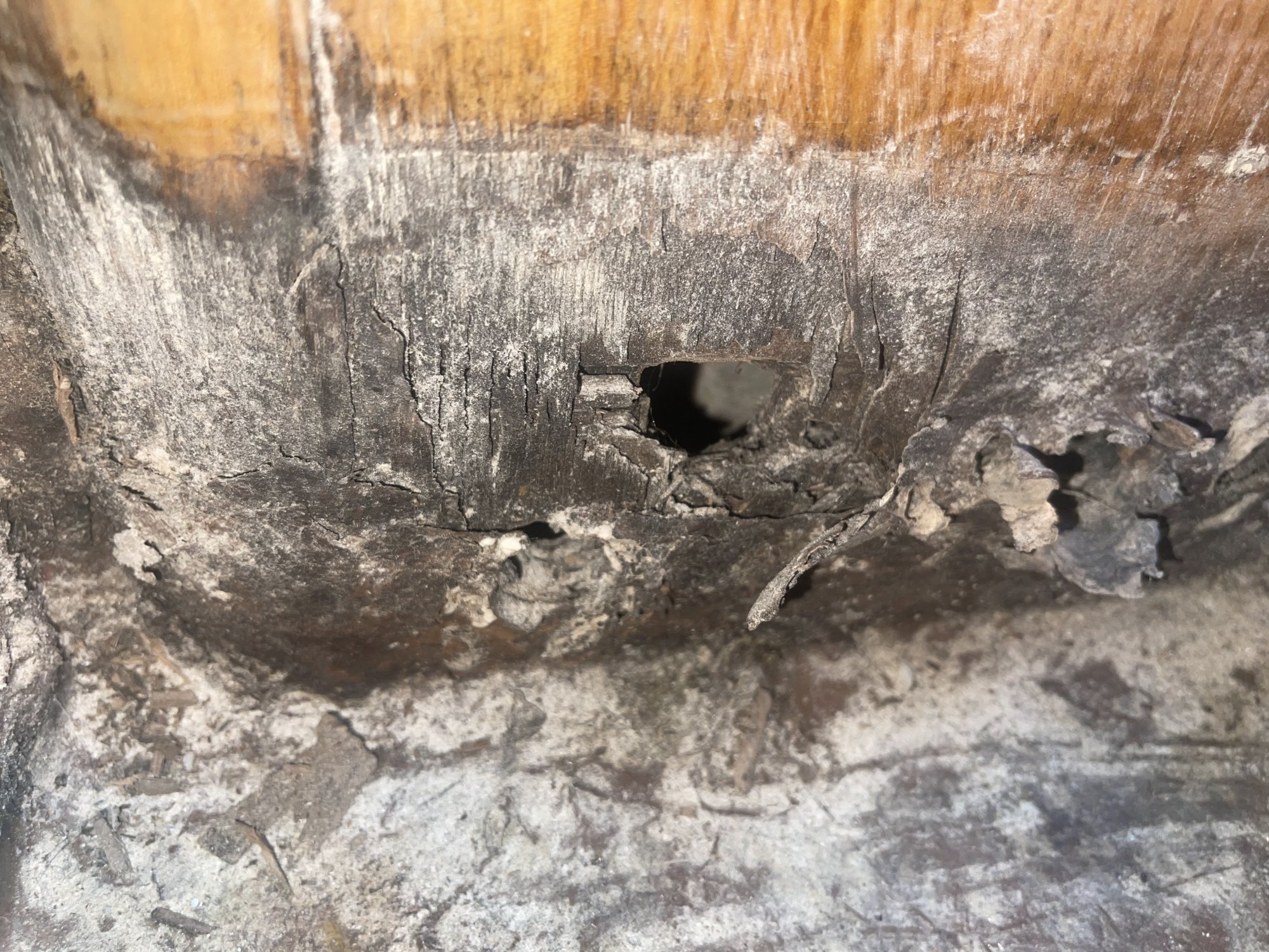

And oh yeah. That gudgeon has a pitting hole that goes very deep inside of it. Previous owners were just filling it with silicone/epoxy or something cause had get all that out to even see it.
Yes the photo of the acrylic is what the manufacturer did originally. Through bolted so many screws. So we filled them with epoxy, and cut new ones. Let me see if I can find a photo of what the new one looks like, wasn't able to last night.
Really? It doesn't show duplicates on my end. Wonder how to check? And thanks for the advice on thumbnails! Never really post on forum, just a reader so thanks! Will mark them as them as thumbnails then!
Couldn't find a picture of what it looks like now with the acrylic but found found one when putting the 3m tape. Also showed some of the rot we had to cut those braces throughout the floors the floorboards sit on. Gutted it, filled with a thickened polyester resin and fiberglassed it over. Don't have photos of the cabinetry coosaboard we cut and fiberglassed in but when I'm at the boat can take some. IMG_6420.jpgIMG_7926.jpgIMG_5897.jpgIMG_5588.jpgIMG_6420.jpg
That sounds like the beginning of crevice corrosion. This happens when SS is in a wet oxygen deprived environment. Consider having a new shaft built, a rudder failure is high on the list of things you don't want to happen on your boat.
The Gudgeon is toast. You can try Buck-Algonquin or Spartan to see if they have a replacement, otherwise a machine shop can make a new one.
I've attached some close up photos of the shaft. The part never inside the rudder looks great, but lots of tiny imperfections below it. Have finally had a welder/machinist contact us back and able to bring it in to check it out.
Since converting to tiller we purchased and extra foot of stainless steel shaft that is already keyed for tiller attachment. But diameter is smaller than our shaft, so not sure if that's a safe idea to have ruder decrease in diameter at the top.
Thanks for the places to check out! I searched online and couldn't find anything similar so was going to have a new one fabricated but I'll check those first. Snapchat-1085044034.jpgSnapchat-1373393862.jpgSnapchat-238148768.jpgSnapchat-1894841184.jpg
