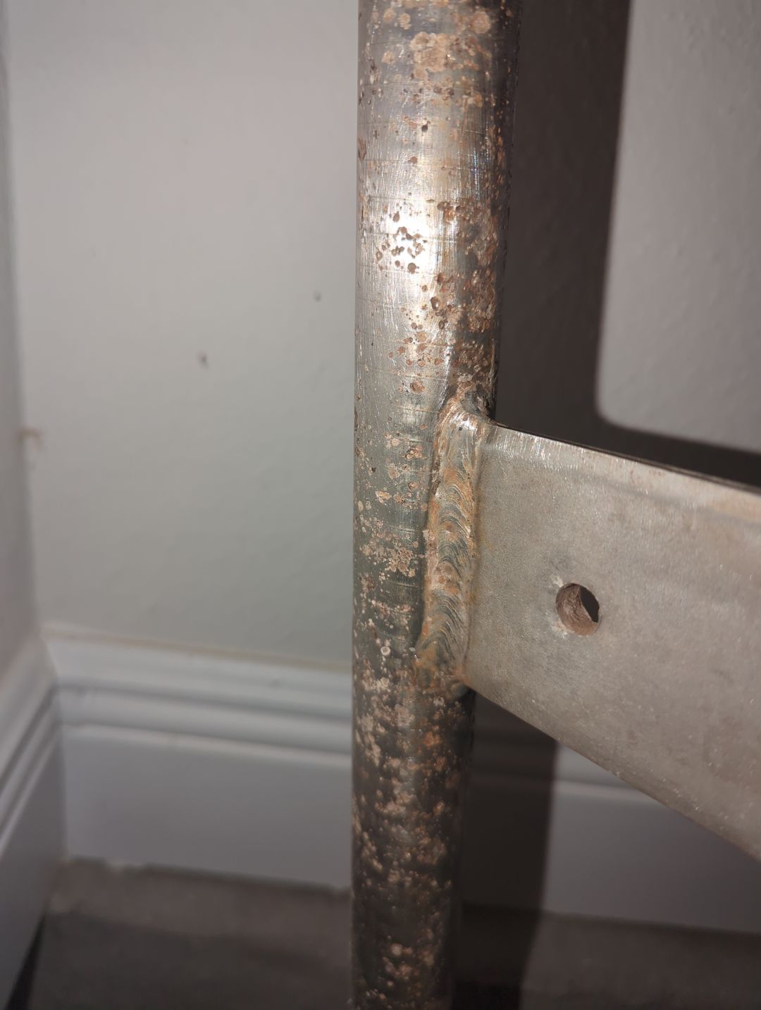

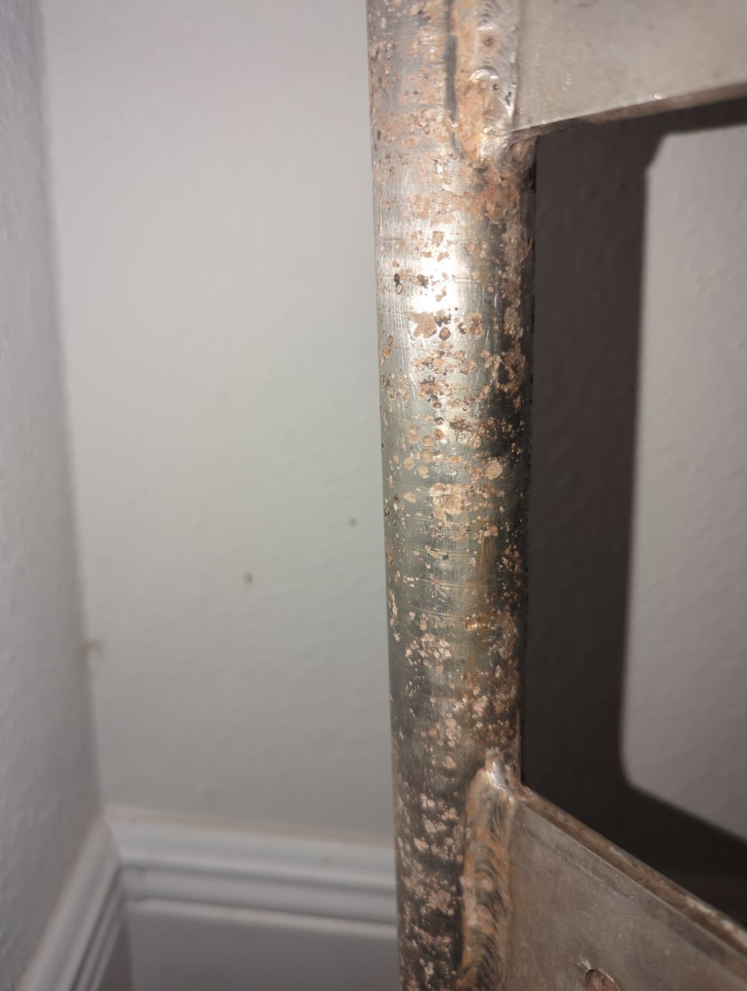

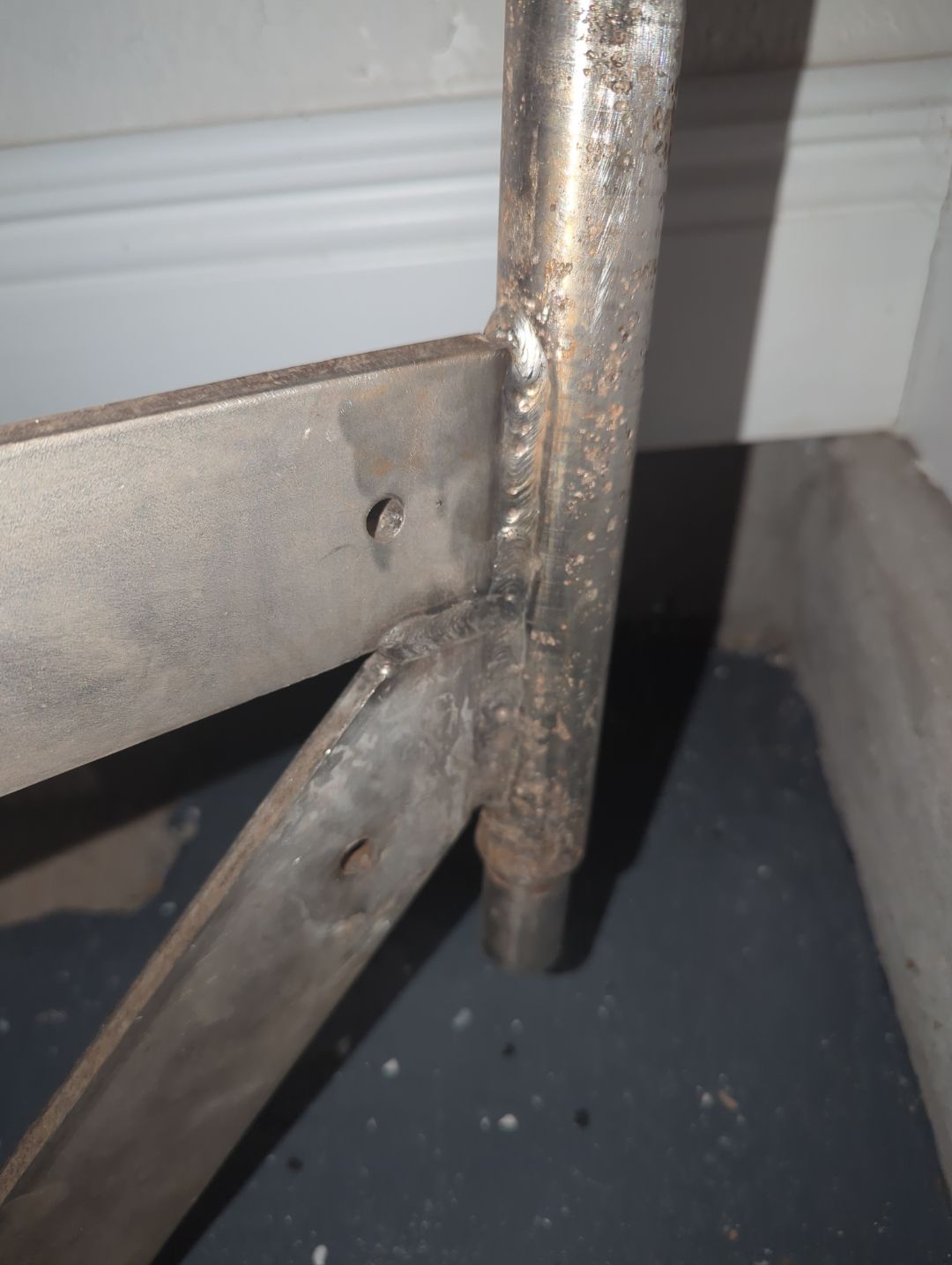

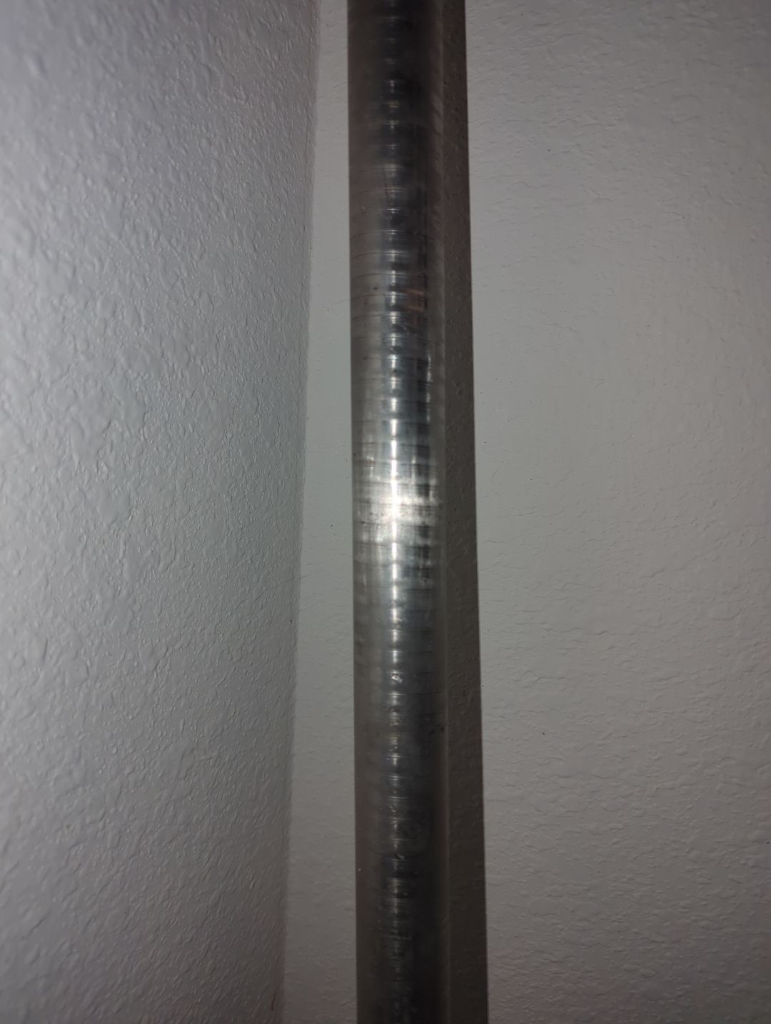

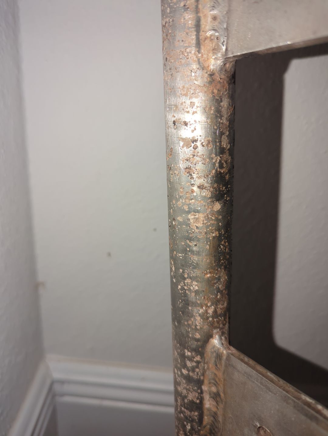

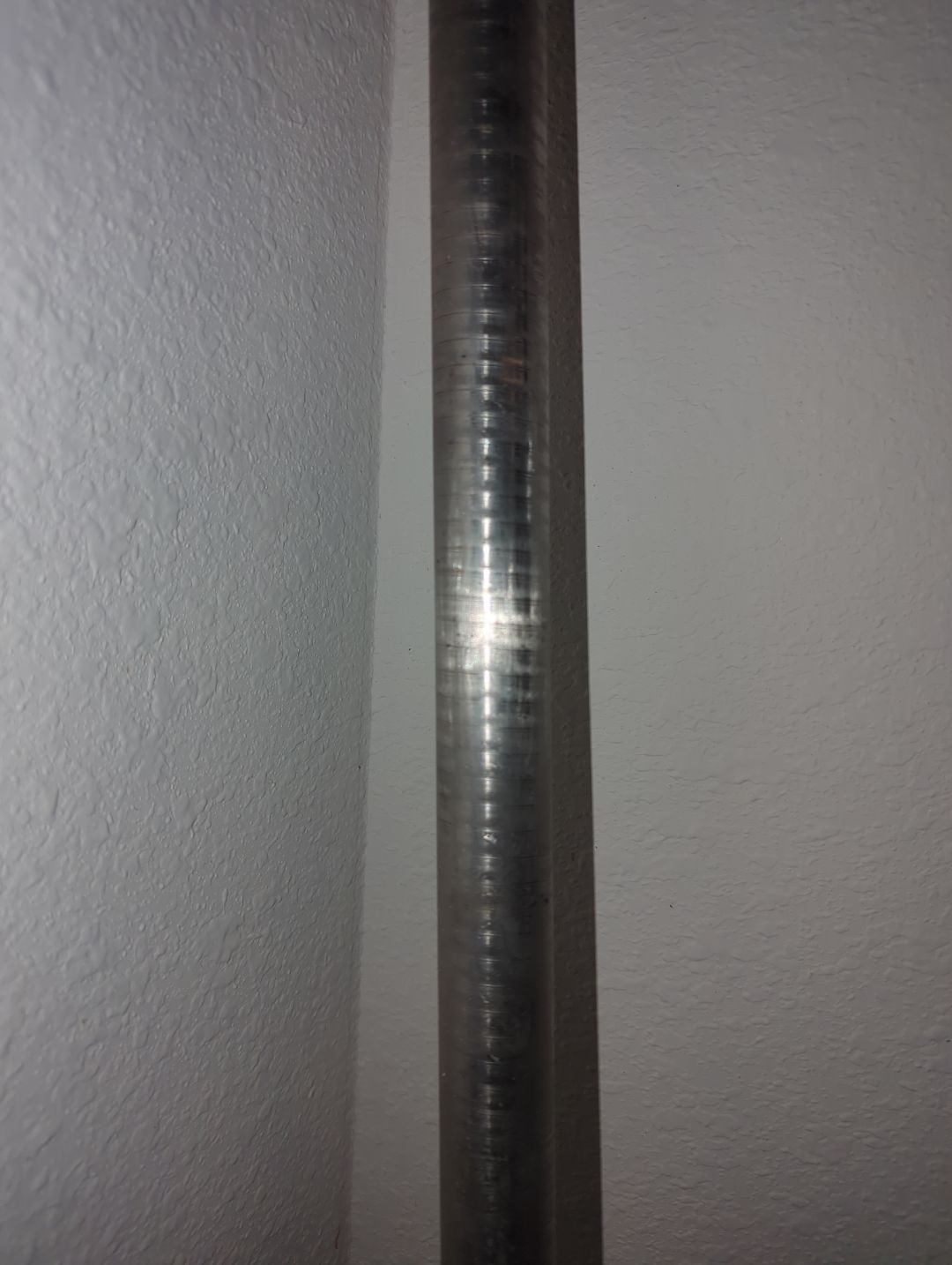

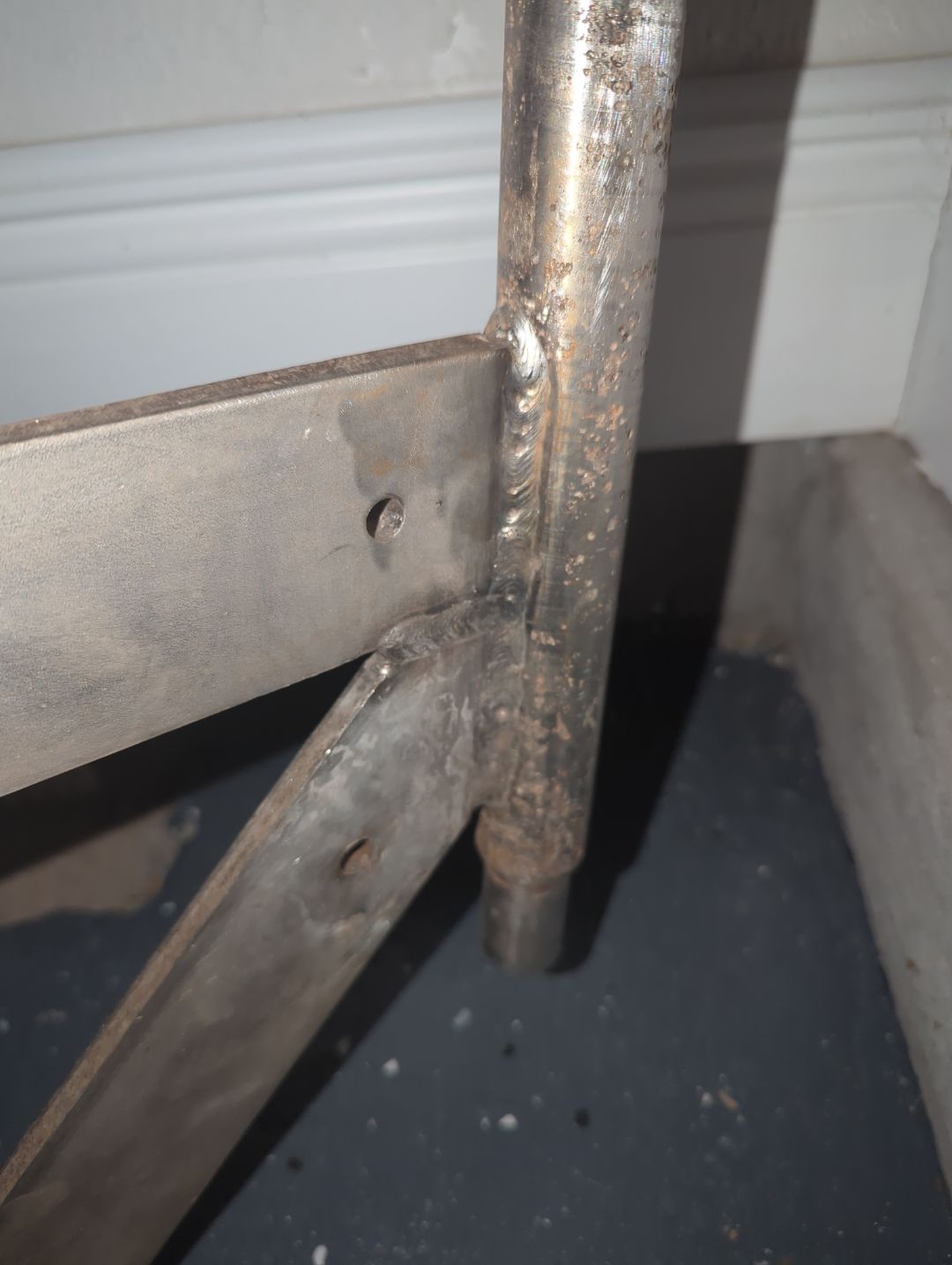

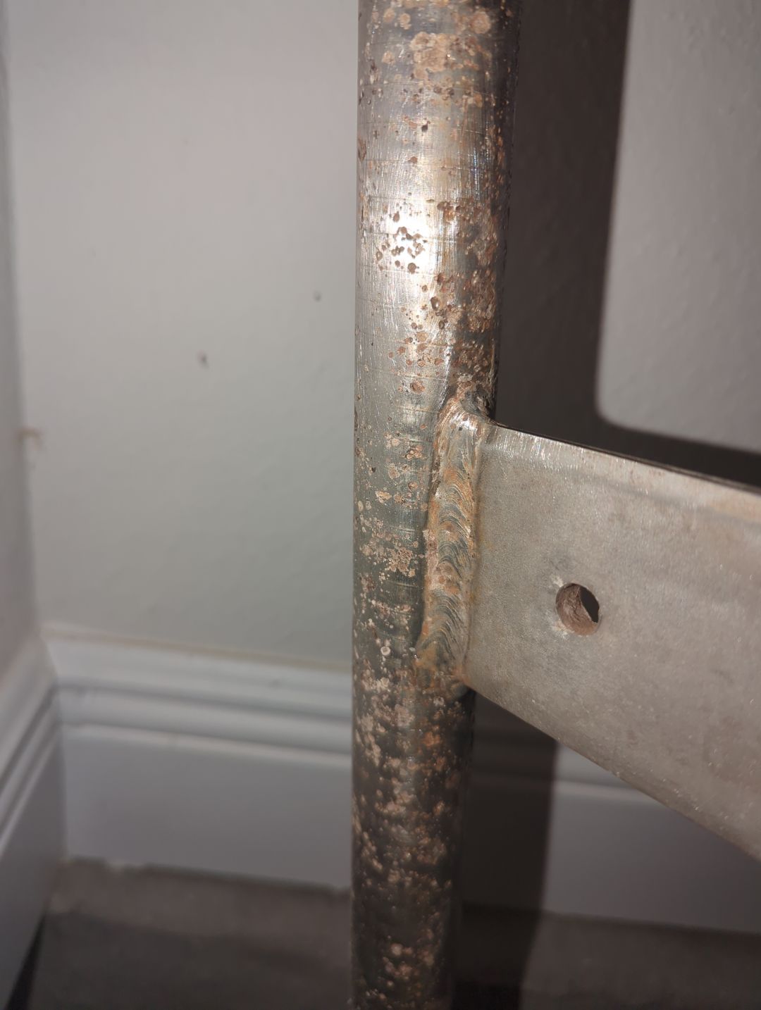

I've attached some close up photos of the shaft. The part never inside the rudder looks great, but lots of tiny imperfections below it. Have finally had a welder/machinist contact us back and able to bring it in to check it out.
Since converting to tiller we purchased and extra foot of stainless steel shaft that is already keyed for tiller attachment. But diameter is smaller than our shaft, so not sure if that's a safe idea to have ruder decrease in diameter at the top.
Thanks for the places to check out! I searched online and couldn't find anything similar so was going to have a new one fabricated but I'll check those first. View attachment 221246View attachment 221247View attachment 221248View attachment 221249
I would strongly suggest you replace that entire shaft. So that piece you got isn't going to serve you anyway. I would not put in smaller diameter shaft material. I'd have to see the whole design, but as a seat of the pants that would be my take.
Looking at the welds holding the tabs on, I would not approve those welds for my rudder replacement if I were doing what you are doing. You should have no putting or crevices in those welds. I personally would require those welds to be ground smooth or even close to polished.
That is serious crevice corrosion. Time for a new shaft and wings.
With all due respect, it does not look like crevice corrosion, it looks like general corrosion. It's serious corrosion, that's for sure.
Apologies but it's rather a pet peeve of mine that everytime someone sees corrosion on stainless steel in the marine environment, they immediately call it crevice corrosion. It seems to be a fad of some sort that has gone way out of reality. If you are bothered by this comment, I'd be happy to have a serious in-depth metallurgical discussion about it.
This is not meant to be anything more than informative.
For the purposes of the OP - for sure that shaft is not safe for reuse. In my opinion in any case.
dj
Regardless of what name we give the corrosion, the cause of crevice corrosion and this shaft corrosion is immersion in deoxygenated water.
Kind of off topic for this thread. If you'd like a more detailed conversation I'd be happy to do so. But I don't think this is the time and place. Up to you. Your statement above may or may not be correct. One would have to actually examine the corrosion and corrosion products to make an accurate assessment.

Looking at the corrosion on the shaft-unless you have it surveyed be a metallurgist you really can’t tell if the corrosion is surface or if the Integrity of the shaft had been compromised.
A rudder is a critical safety system on your boat. If as you indicate you plan on crossing an ocean you want everything to be life saving quality. The ocean will test your preparation. If any is wanting the ocean will punish you for your negligence.
Just as a depressing note; a metallurgist would have to perform destructive testing on this piece to actually determine the full extent of the corrosion damage.
As @dlochner had implicated "crevice corrosion" - which I objected to that diagnosis based on your photos - there very well could be crevice corrosion in locations not visible in your photos - most notably initiating at the root of some of your corrosion pits.
There is no NDE test that can detect with sufficient accuracy the extent of the damages due to corrosion on that shaft. So since you would have to destroy the shaft to properly examine/test it - there is no reason, other than academic, to do anything further other than replace that structure.
