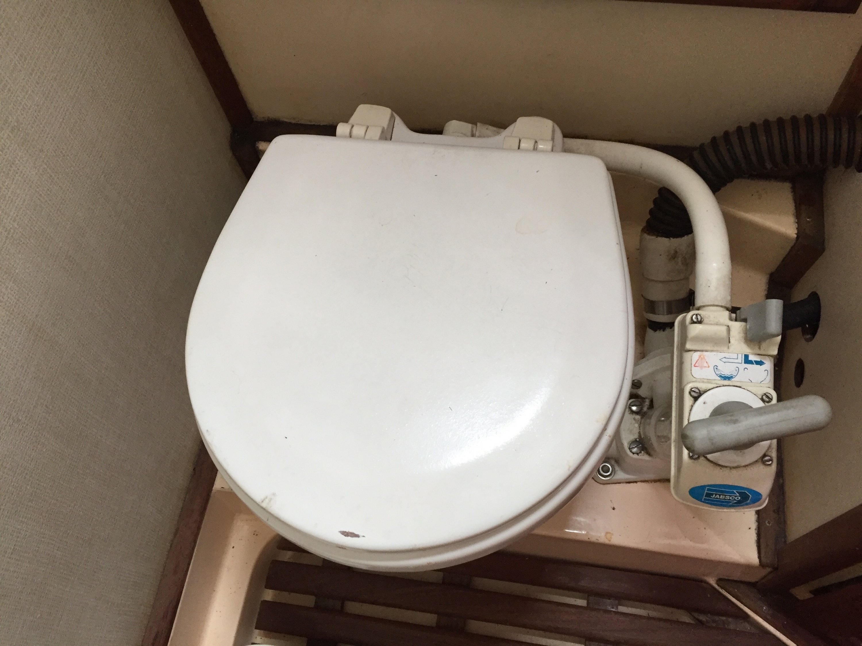

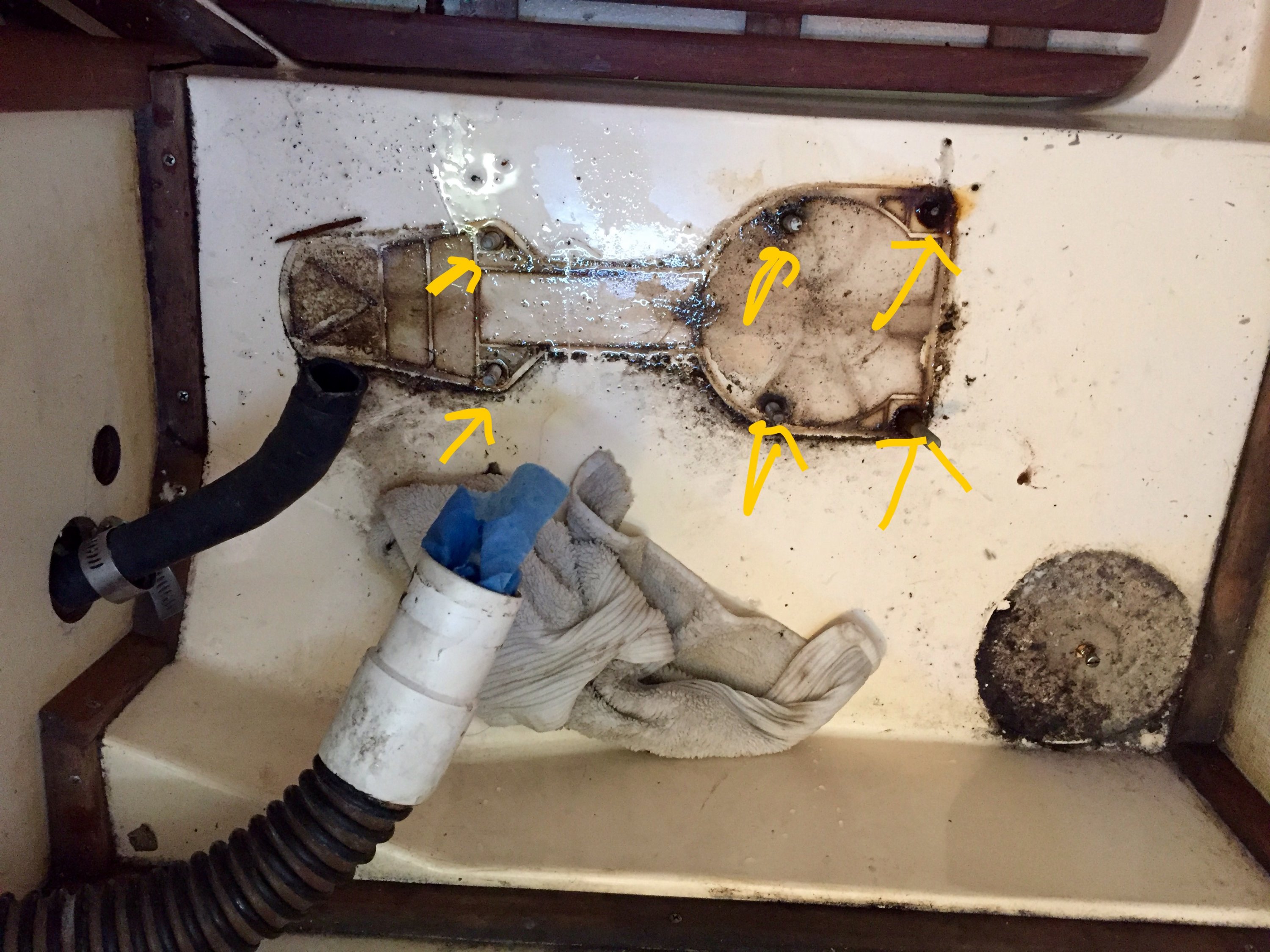

I've removed the toilet. I see that there are bolts that come up from the floor to attach to the toilet.
I haven't got my new toilet yet but likely the footprint of the new one won't be like the old one...and anyway one of the bolts broke (rusted). The problem is that I can't get under the floor to inset new bolts. Any suggestions?

The mounting bolts don't come UP from anywhere...all toilets are installed using lag bolts...no nuts needed. Drill the right size holes where you need them, set the toilet down and insert the bolts through the holes in the toilet base.
If you can't get the rusted bolt out leave it where it is...put a fiberglass or other filler patch over it to keep water out. If it shows, a little touch up paint on it...if you're lucky the new toilet will cover it.

Well that's excellent news!
I guess the procedure fortunately changed since 1982 :) because the bolts came up and I had to take the nuts off to remove the toilet.
Thx

They make a "screw" that looks like a lag bolt thread on one end and a stud on the other end. Is it possible these were used on your boat? Put two nuts on the stud and tighten them hard together. Then put a wrench on just the bottom nut and see if it will unscrew. If yes and it is what I mention you should be in good shape to replace them. If not you will need a different approach. It seems odd that it would be a standard bolt as what stops the bolt from turning underneath when you are trying to remove the nut on the top of the toilet flange or from the bolt falling out once the nuts are removed?

I'm guessing that the bolts' heads were epoxied in under the floor (?) However it's moot now...the holes for the new toilet are in different locations. So the old bolts were cut and grinded off. I will be using lag bolts as previously suggested. Right now I'm wrestling with the Titan 101 hose...stiff compared to the old hose. Holes need to be made slightly larger to get the new hose through. Also I thought I was being smart by laying the old hose next to the new hose when cutting it to length only to find it was too short. I think the difference is that the old hose could make turns at a sharper radius. At $15 CDN a foot (here in Ontario Canada) it can be an expensive mistake. FYI I priced the Ranitan SaniFlex...$25 CDN a foot...too rich for my blood but likely would have made the job easier.
