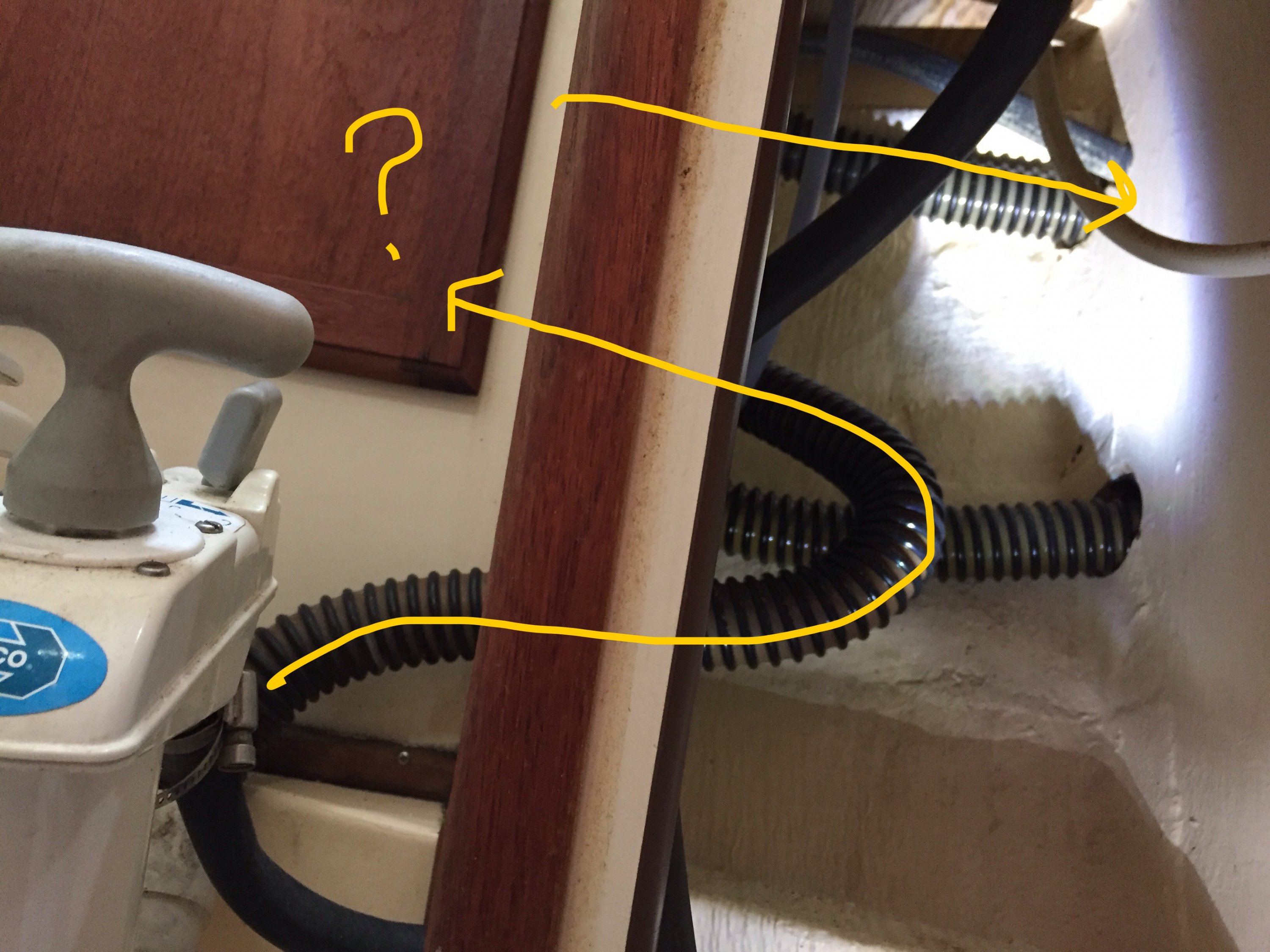

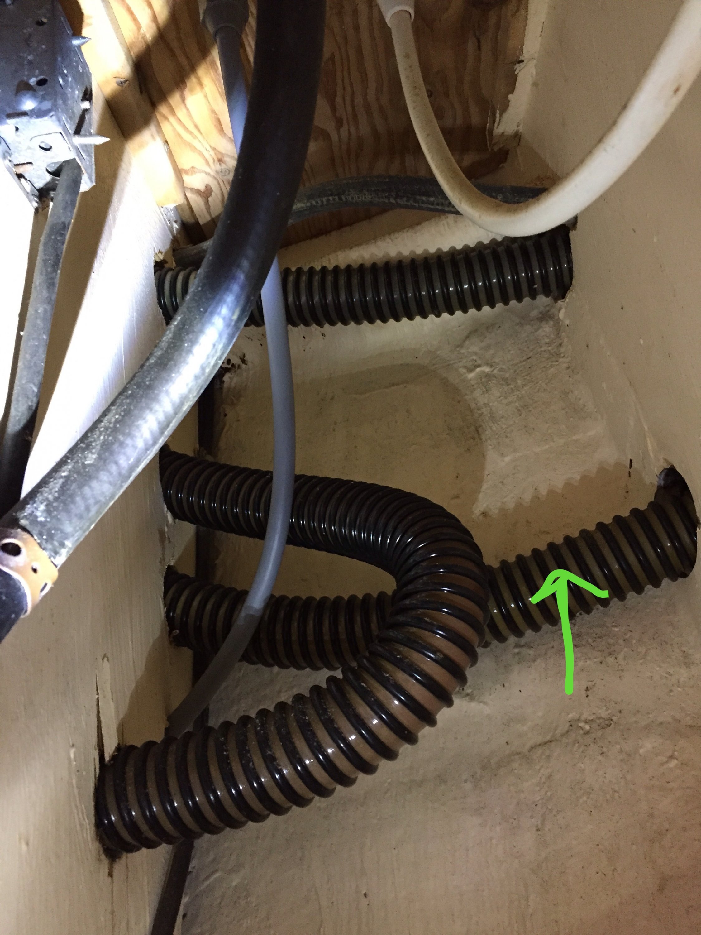

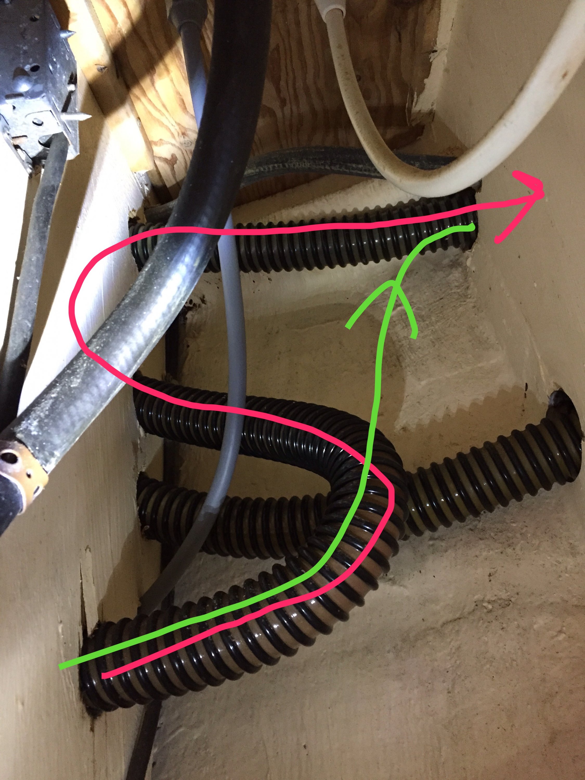

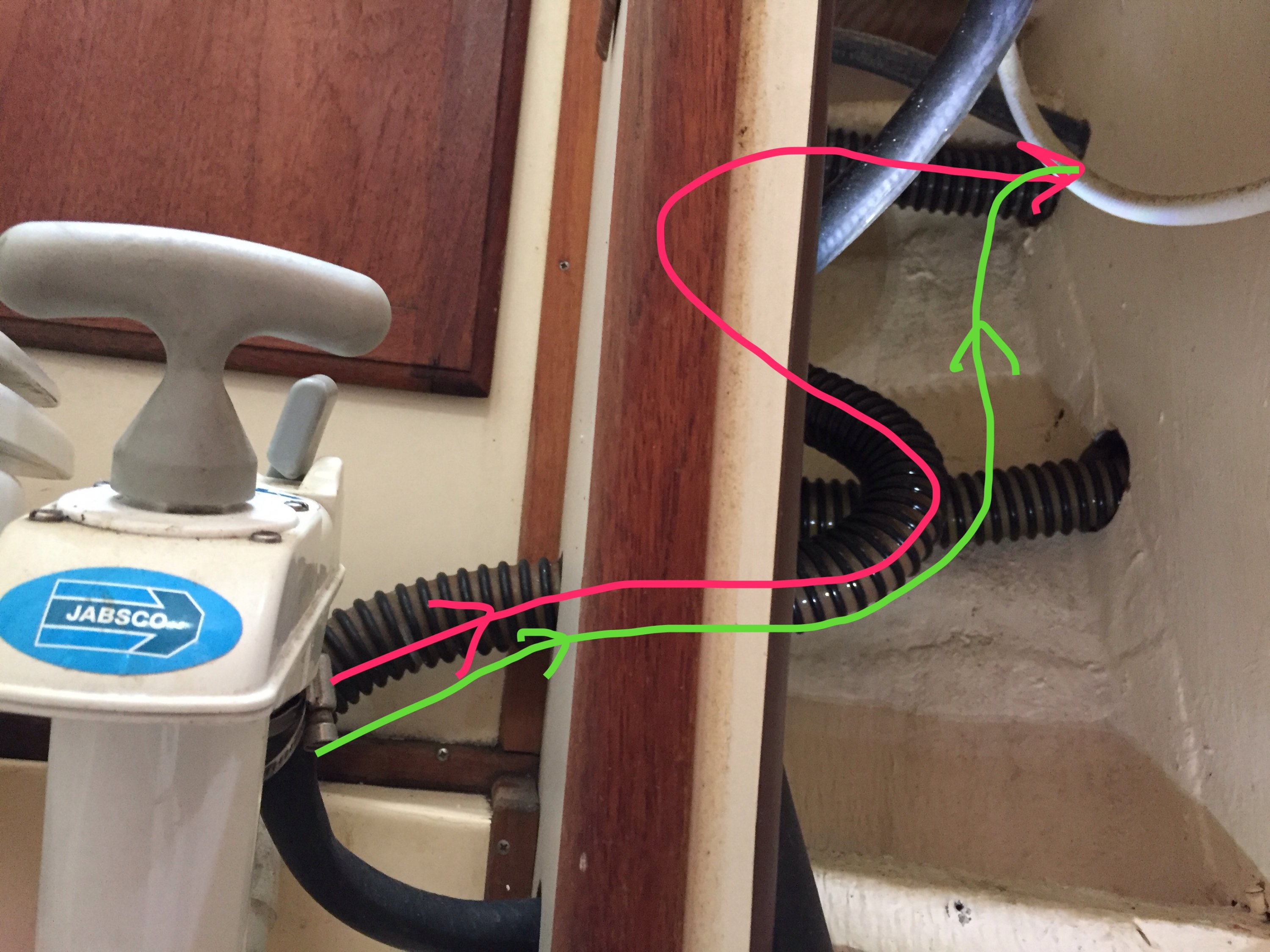

i just acquired a 1982 Hughes Columbia 8.7. Love the boat but it has odour issues. (Yes I've read Peggy's book.) My problem is with the route that the sanitation hose takes from the head to the holding tank. It goes from the head, right through the side of the sink cabinet...then winds up and back (left), then out of the cabinet only to return again farther up and out the bulkhead to the holding tank (red path). Is there any reason for this winding back? Can I just route it through the cabinet then up and through the bulkhead (green path)?
(In the photo you can also see the pump-out hose passing through the bulkhead and through the cabinet which may make the photo a bit confusing)

The only possible reason I can think of for the twists was the installer was trying to honor some sort of minimum bend radius rule. But it still makes no sense to me. I would replace it and run it directly. Also the ribbed hose you have does not look like the stuff you are supposed to use for sanitation hose. I'll bet replacing all of those hoses with Trident 101 or 102 will solve most if not all of your problem. It did from me. There are also folks much smarter than I on this subject and I am sure more wisdom will follow.
14,207
When the hoses are routed there are 2 main considerations.
First make sure that any right angle turns are gentle and sweep. A sweep will have a larger radius than an el. If you go to a Big Box store and look in the plumbing department you will see the difference. A 90* sweep elbow will not impede fluid flow as much as a 90* elbow.
Second issue is making sure that there are no sags or low spots in the hose. This is were effluent can collect and eventually permeate the hose causing odor. Best to route the hose as high as it needs to go as close to the head as you can with a downhill run to the holding tank.
It will also be necessary to provide adequate support for the hose or a sag will develop and you really don't want that.

The only thing I can think of is that their is a vented loop where the hose disappears. I'd have to dismantle a cupboard to check.
14,207
If there is a vented loop, it should be between the Y valve and the through hull. If that is the case, it is not necessary since overboard discharge is not legal on the Great Lakes.
What is the hose at the bottom of the photo?
14,207
I'm a little confused. Where is the holding tank?
The manual image didn't come through.
Also, what is in that metal junction box? Those are generally not a good idea on boats, especially if the wire is household romex, i.e., solid wire and not stranded wire.

Yes that's exactly what I was hoping...that I could use the better quality hose which is stiffer but would only work with the altered path of the hose. Thx

Yeah, it looks weird going in and out of the cabinet. Are you sure there is not some other (Y) valve inside that cabinet?

No Im unsure about what's going on when the hose disappears to the left. I'll look further. Thx
14,207
It may just be a simple loop to prevent holding tank contents from flowing back into the head when the boat heels. Time to open up the cabinet to see what's there.

Y'all have already said just about everything I'd say, but I do have a couple of comments and questions, starting with:
Who installed this system???
Why does the pumpout hose come all the way back to the head (can't tell where it goes from there)? It should go straight up (at least as straight as possible) to the deck pumpout.
The route TO the tank should go up immediately after the toilet and then to to the tank.
If both of those are impossible, is there any chance you can relocate the tank, even if it has to mean replacing it?
Trident 101/102 sanitation hose is an excellent choice UNLESS there are more than a couple of bends in the route that are tighter the hose wants to bend willingly...'cuz it's so stiff that you'd have to cut it and install inline radius fittings. Raritan SaniFlex hose is proving to be equally as resistant to odor permeation as 101/102, and has the added advantage of being so flexible it can bend as tight as a hairpin without kinking.

The 1982 boat is new to me...who knows who installed what where :)
The pump out is next to the head. I'm thinking that the pump out hose was easier hidden behind the cabinet (than going up at the V-berth where the holding tank is) then goes up to the deck from there.
I'll, hopefully, soon find out as I'm trying to take the cabinet apart...was also hoping just to take out screws but have to find my heat gun for the glued shelves!

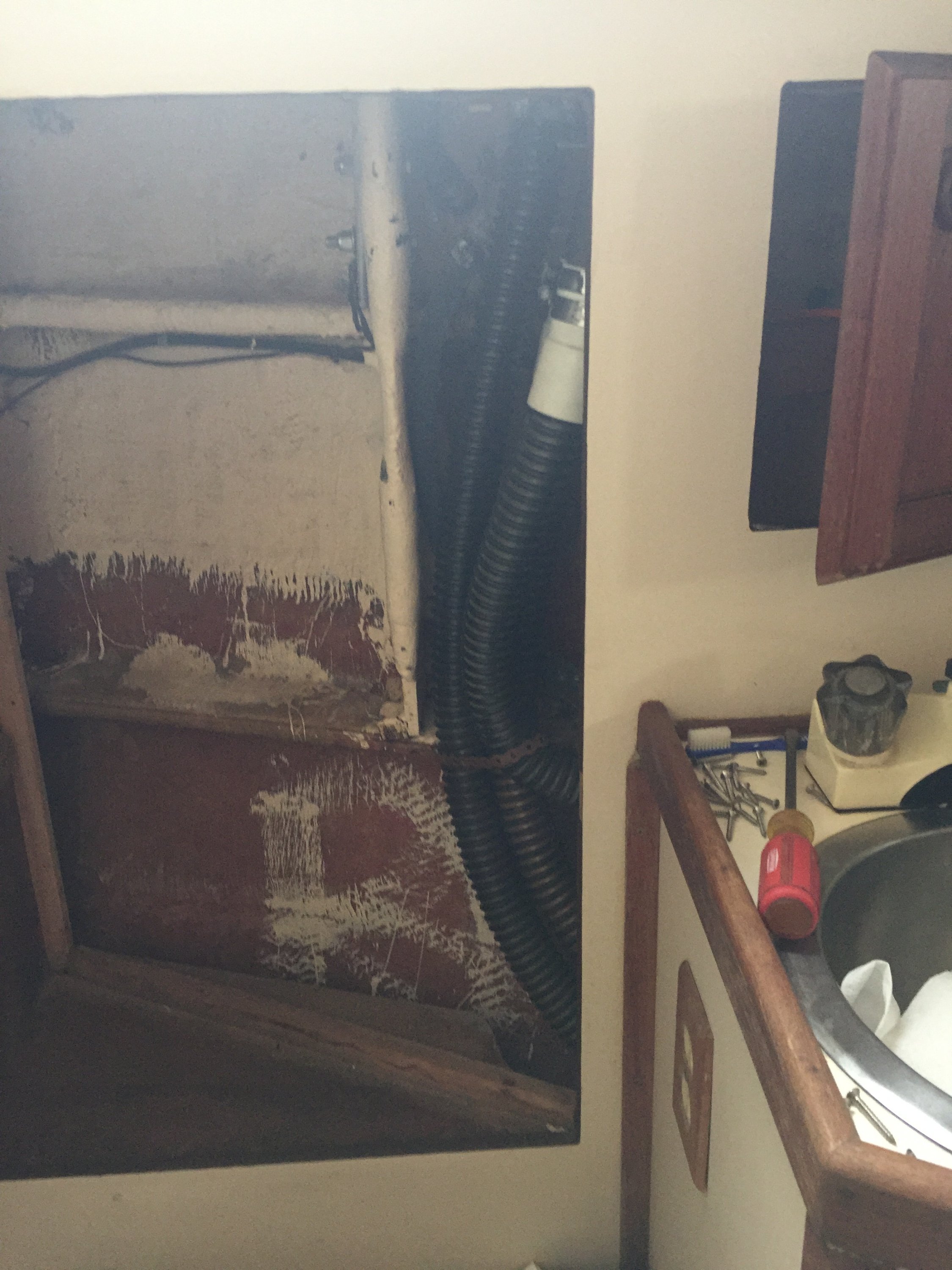

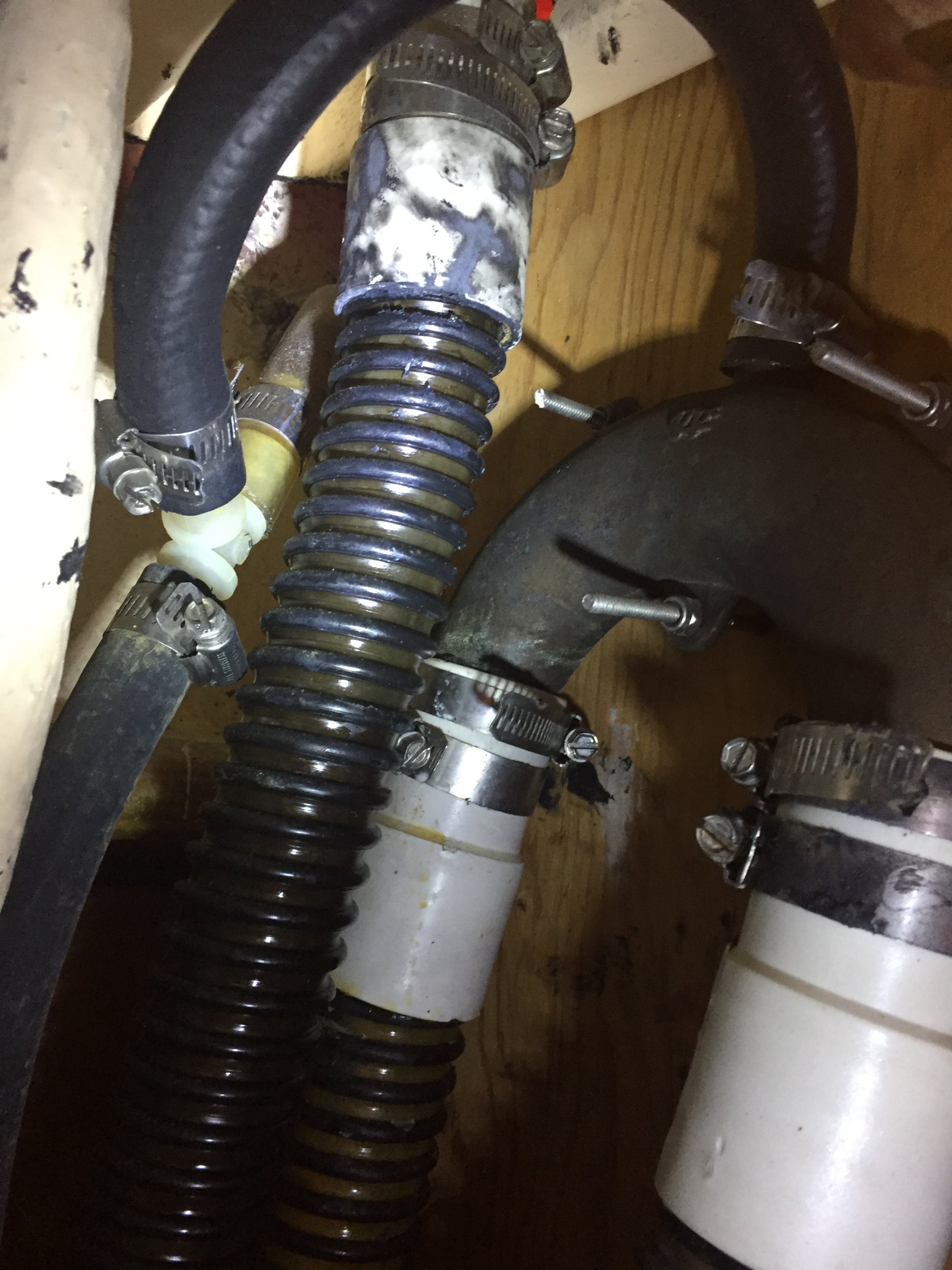

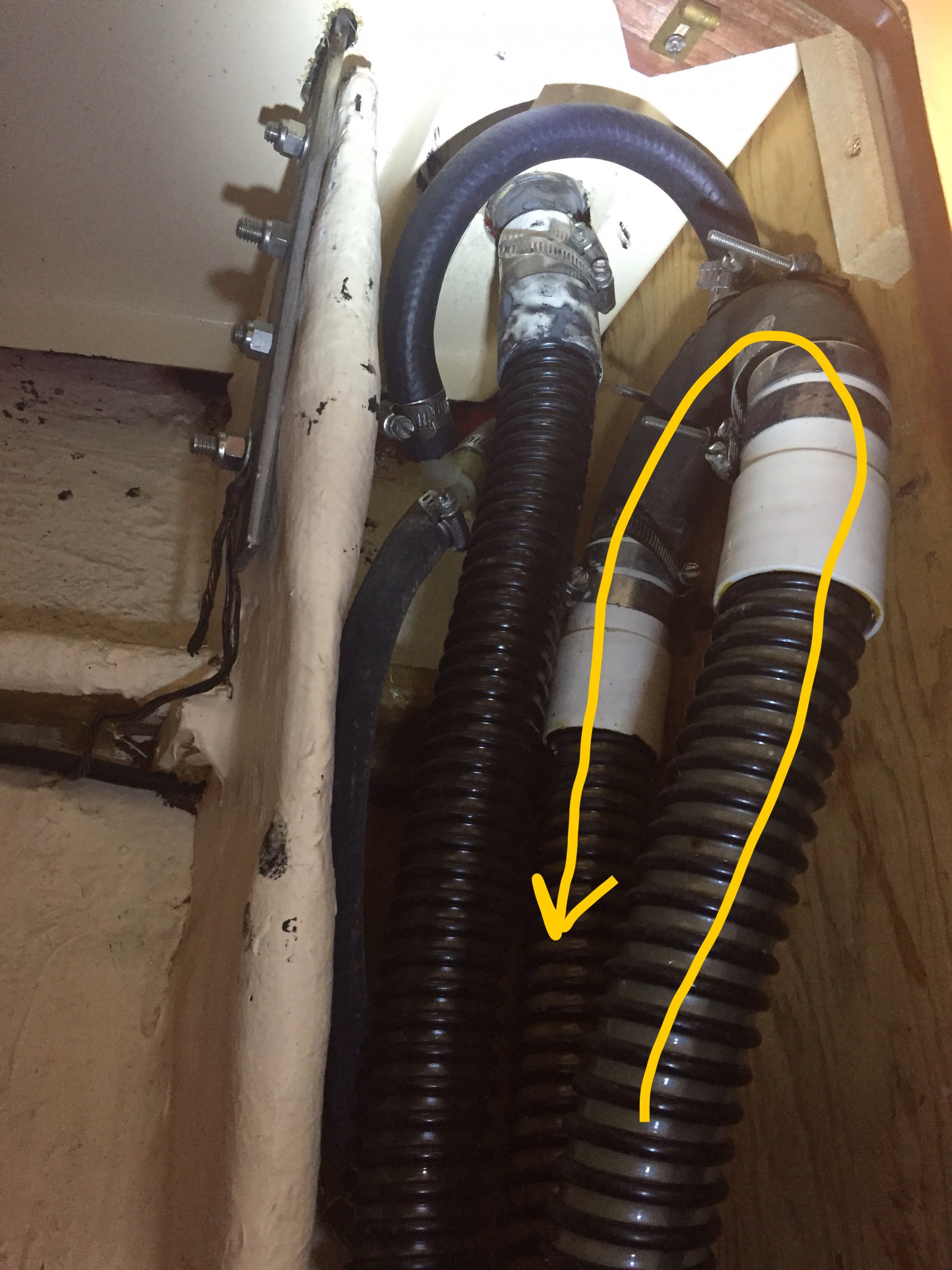

I was successful with removing the cabinet. I found that the toilet-to-holding tank hose did go up behind the cabinet with a vent loop, which was attached to the holding tank vent hose, then descended going back through the cabinet, through the sink cabinet, through the bulkhead to the holding tank. The photos also show the pump out hose.
Do I need to copy this path or just can I just have the hose go from the toilet directly to the holding tank?
14,207
On the Sabre 30 I used to own, there was an unvented loop in the hose between the head and holding tank. When I replaced the hose and rerouted the inlet, I did not put the loop in nor add a vented loop. The inlet was located in a position that would minimize the chances of waste flowing back into the hose when heeled.
There were no issues that I found with this arrangement. The key is to limit the chances of the waste flowing back into the hose and then siphoning into the head. The vented loop breaks the siphon. Depending on your boat this may or may not be an option. The advantage to the shorter hose is less water is necessary to flush.
