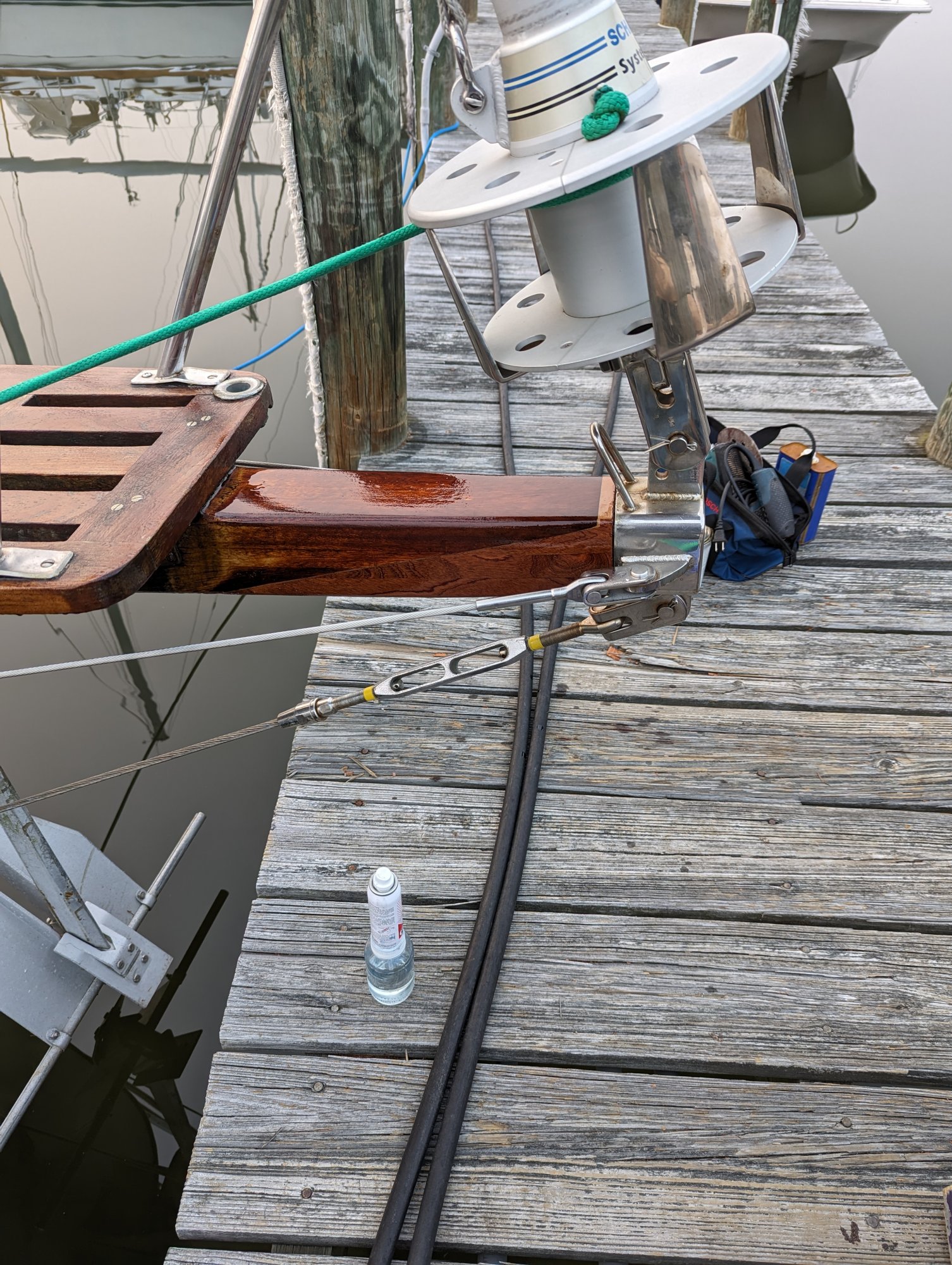

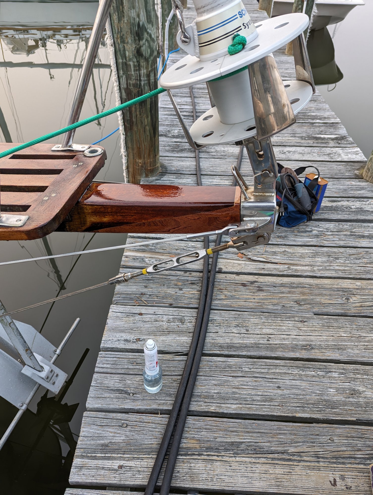

The sail I wish I had, but it is simply not in the budget is an asymmetrical spinnaker on furler. It would be perfect for those days when the wind is at 160-170° and at 12 knots or less. On our trip down the east coast we had many of those days and we needed to make miles. In those conditions a 135° genoa and main ain't gonna cut it. You have the bowsprit already, it would be a great addition to your inventory. (I like spending other people's money. ;))

Did you see the photo of my bow sprit? I don't see any way to put another stay or any kind of additional attachment there. I'm not seeing how I could put an additional asym furler there...

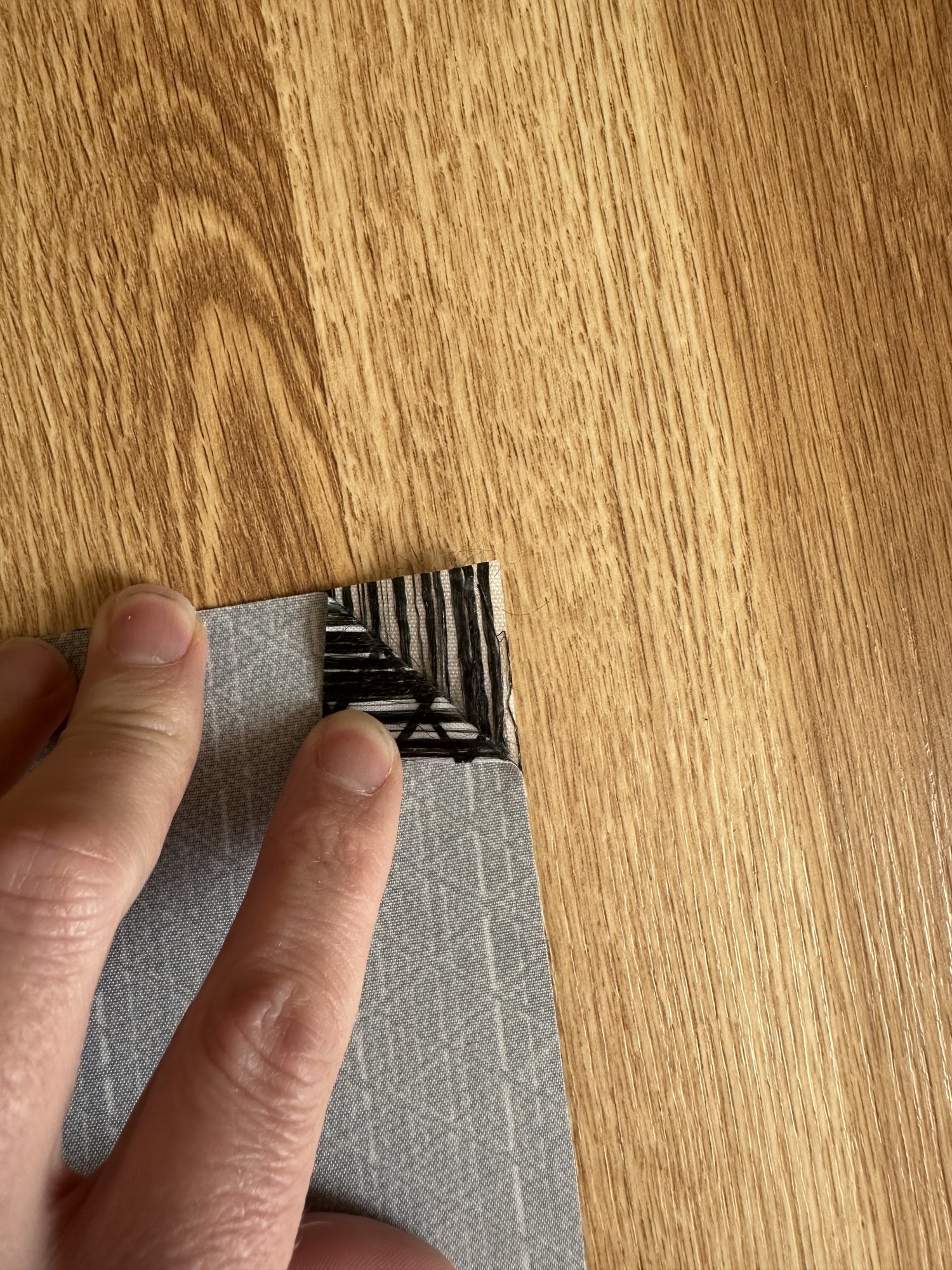

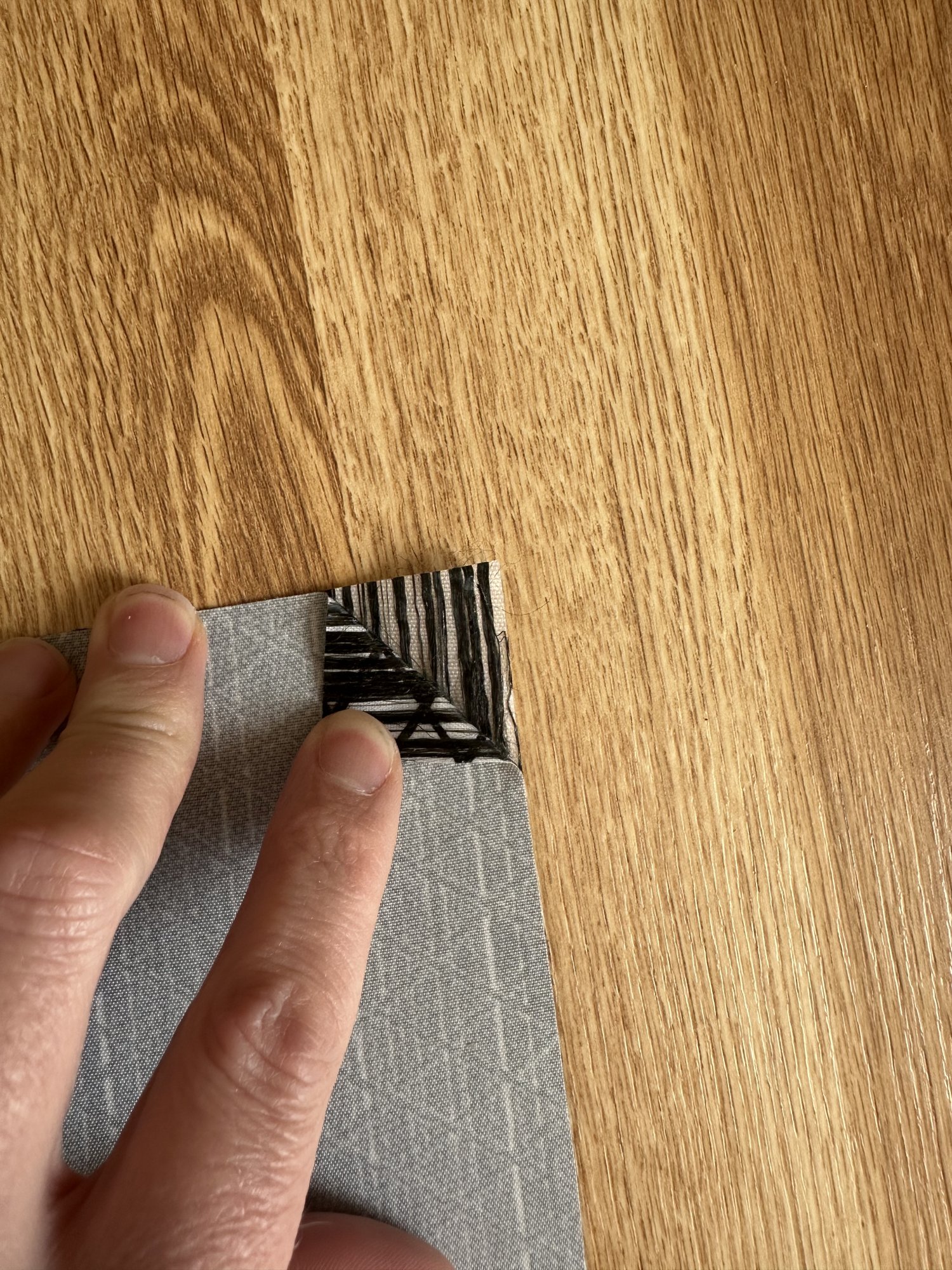

We have had 3Di Endurance sails (dyneema and kevlar) for the past 5yrs. 3Di is really only the manufacturing process and type of sail, and doesn't fully describe any individual sail itself. It incorporates different materials in the different versions. They make versions from 100% dacron, dacron mixed with dyneema, dyneema mixed with kevlar, and several versions with carbon/dyneema/kevlar.
In addition to the above, the different fiber ratios (except pure dacron), and the dpi of the fiber content varies depending on sail size and expected usage. Also, they come with and without an outer "scrim" for further sun and abrasion protection (racing vs cruising).
Any reviews would need to take into account the specific version of 3Di.
The takeaway for your initial questions is that 3Di is not a laminate and won't delaminate or fail in the way a laminate will. Laminates will fail, but will hold their shape right up to the point of failure. They often give no indication of approaching EOL until it occurs. The overall lifespan of a laminate will be a lot shorter than what is considered normal for woven dacron, but I don't understand people's logic with woven dacron. They will tell me their sail is old but still good with lots of life, when I see a totally bagged out dishcloth on a stick. There is a reason that when people replace their laminate sails with new ones, they aren't very excited, just happy to be sailing again, while people who replace their dacron sails are jumping around saying "holy cow this is a brand new boat now!". It's because they don't realize their dacron sail became a bedsheet 10yrs ago (and likely 2yrs after new), and its "long life" was an illusion caused by lack of material failure.
Laminates and 3Di are great. If one is going cruising, or has a boat that sails well and responds to its sails and will be using it often, I don't see any purpose of woven dacron anymore. Smaller boats, sails that don't experience high forces, and less used boats should probably be the only ones considering woven dacron anymore.
Putting lifetime in terms of sail shape and material failure, dacron will have the shortest in shape and tied with 3Di for longest in material. Laminates will tie with 3Di for longest in shape but shortest in material. 3Di will tie for longest in shape and longest in material.
Of course, there are price considerations for all of the above.
Mark

Hmm, I wonder what Jenkins uses. But he's been in business a long time. I'm sure he knows the best ways to go...

3Di starts stiff, but quickly becomes softer. The stiffness is in folding into flakes, as they are very pliable when rolled. I've got some high DPI count 3Di material on a 1" cardboard roll, and it could be rolled around a 1/2" dowel with no problem. A stiff sail is actually better for a boom furler than a soft sail.
Contender and Dimension-Polyant make radial dacron now with a crimpless warp. There may be others. This allows a tri-radial design with the uncrimped fibers oriented correctly. If going with dacron, this type would be my choice.
North also makes 3Di in a pure dacron version with fibers oriented on load paths and fiber density varied as needed, but no mylar holding it all together. It is 70% fiber content.
Mark
