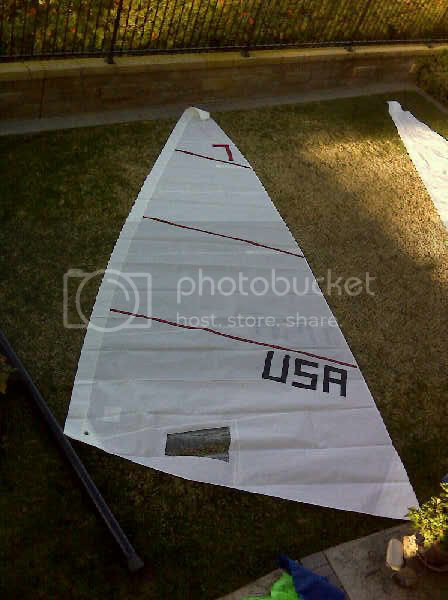

A usually black stripe of cloth between the luff and the leech. It helps to see the shape of the sail. in this case red stripes.a

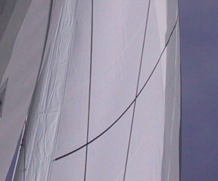

Here's another example.
Regardless of the cloth you get on your next sail, get draft stripes!

He means something that runs perpendicular to the luff so you can tell its shape, like seams or colored panels.

Do you use these along with tell tails? Are they an additional way to check sail set?
I have multiple levels of tell tails..
dj
p.s. would you also put them in the main sail?

Tell tales show how the air is flowing over the sails. Draft stripes show you the shape of the sail. The two allow you to fine tune the sail trim. In some conditions the boat will sail best with very flat sails, in other conditions the sail needs to be fuller. On the jib this is controlled by car position, sheet tension, and halyard tension.
The wind at the mast head is at a different angle from the wind at the boom. The tell tales at different levels show this and help tune the twist of the sail and the wind over that twist.
Yes, put them on the main too.
