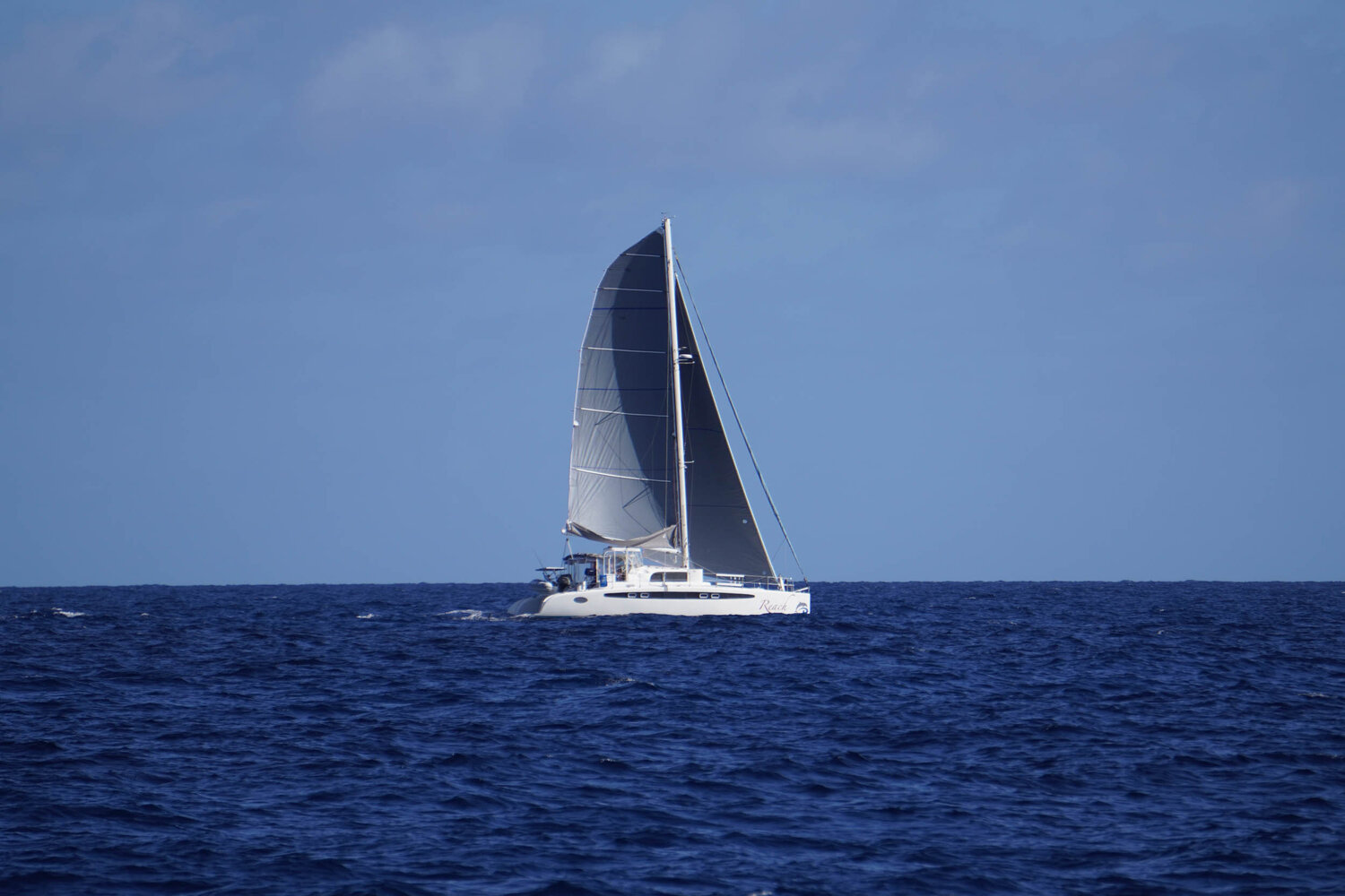

Catamaran with a large roach elliptical head non-furling sail.
Laminates or 3Di will be the best type of sailcloth for a boom furler.

Love that photo! I definitely do not have laminate sails... Are you up north on the Chesapeake?
