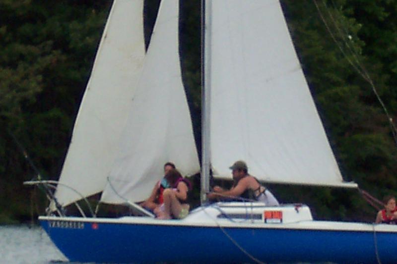

Mine was set up the same way...(see pic)
And I flew both sails a few times to see how it goes. I don't think my V21 sailed any better with both headsails flying. I think the inner forestay is for flying in heavy conditions (it is called a solent stay)
In heavy air you put the genoa away and fly a much smaller jib on the "baby stay" and put a reef in the main. (Keep the forestay in place but without a sail flying) That keeps the boat balanced and allows you to plow through the chop instead of being hammered by it.
In light air, you disconnect the inner stay and bunge it up to the mast.
I like that suggestiont - disconnecting the inner stay and bungee it to the mast. May give that a try. There is only one back stay - so I assume I should be ok with only one forestay.
