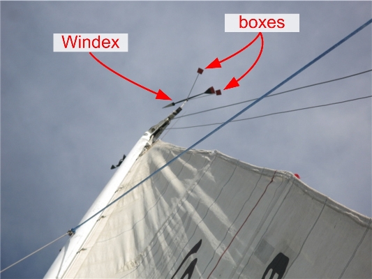

Do you have a windex? It is a great tool for learning about apparent wind. As the boat comes up to close hauled, the fly will align with the boxes. After a while, you can do this by feel alone.
Sailing close hauled takes some practice and work; turning up slightly more and more into the wind, while trimming in the sails. When fully close hauled, the leeches (back end) of the sails should be parallel. That a good way to know when your headsail is trimmed enough.

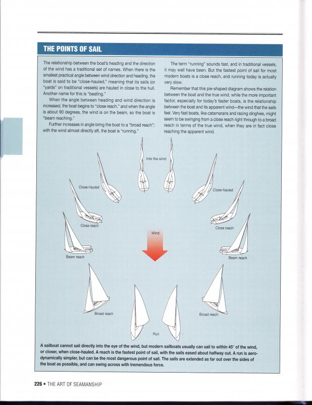

I occasionally take new-to-sailing folks for lessons. The first handout I give them is from Chapman's Piloting. I have it in a protective plastic sleeve & ask that they keep it within close reach(no pun intended) for quick reference. The feedback I get with this has been that this is a real help in honing their sail sets.
It's a simple quick-visual reference on sail sets for 360° point headings. Although, all sail plans differ, it gives a starting point picture. From here, you can hone your sail tweaking to fit your boat's design & sail plan.
