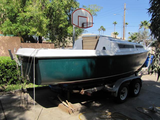

If you look at the sides of the cockpit on the boat that capsized, you can see that they are higher and slope slightly to the rear as compared to my Mac/Venture 25 where the sides are flat and lower. My 25 had an iron keel and the 26 (either S or D model) is waterballasted.
