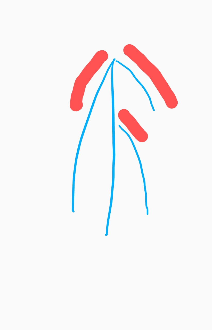

Lots of questions here!
With three sails, each one will be trimmed tighter than the one in front of it. Your picture shows them in equal trim.
Your picture of upwind trim shows the boom really far off the centerline. That’s never the case for optimal trim.
Yes, when Reaching with the jib clew has to move outboard for proper trim. Most modern boats now have a mechanism to allow this, either with out haulers or with three-dimensional clew rings.
Yes the Volvo boats use reaching poles to Hold the spin sheet outboard, to allow the clew to stay outboard. Greatly improves sail shape with the code 0.
Was watching some mini transat and vendee globe videos. I suspect the clews pull in tighter due to attachent points back to the hull, but ill never be able to test that. Turbofans in jets seem to be parallel.
Its hard to get that boom over centerline
Ive got to find a way to pole out the jib on my 170. Like i said earlier the jib is cut so that the foot is a full naca. For exaple the chord is based on "j" the jib foot, but i would like to maybe recut as if j was jib plus boom. But stop the chord at j. If that make any sense.

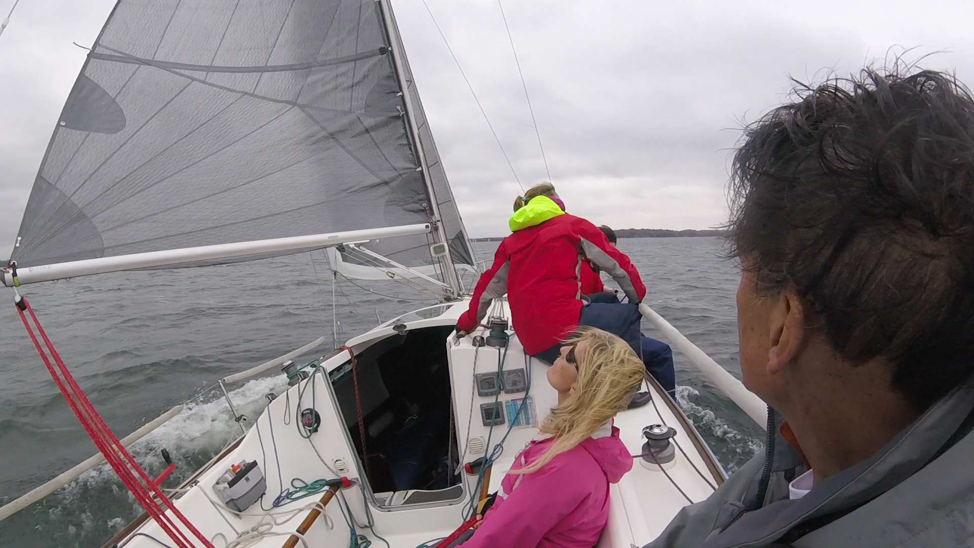

Indeed. I think I mentioned this earlier, but boats with non-overlapping rigs HAVE to have a way to move the clew outboard once you start reaching. If you don't, the great sheeting angle that makes for good upwind sailing destroys your sail shape. On BlueJ we use an outhauler, mounted 2 feet outboard from the track on the gunnel (near the shrouds) to allow up to pull the sheet (thereby the clew and leech of the sail) outward when jib reaching. Good for at least an extra 1/2 a knot. Here we go, 7.9 knots on a jib reach!
