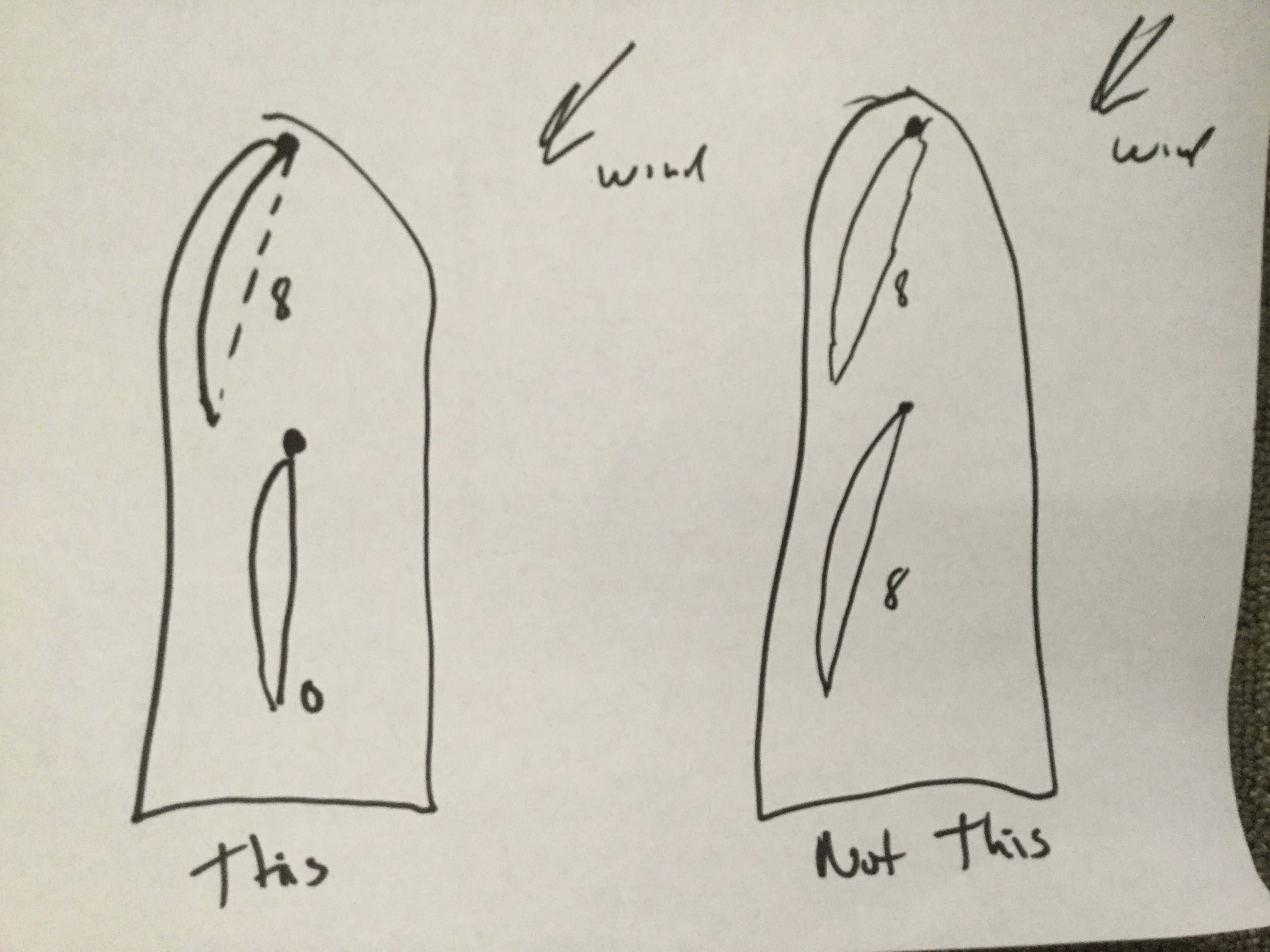

We all know that when sailing upwind in optimal conditions, the boom should be on the center-line of the boat, which creates a chord line for the mainsail (tack to clew) of 0 degrees. The headsail however, is much wider, at typically 8 degree of chord angle. OK, See drawing in comment #6. OK Why? What are some possible ramifications?

Just to be clear, why is the boat on the left the ideal upwind configuration, and not the boat on the right?

The one on the right is going to close the slot and cause the main to backwind while the one on the left gets more work done from the main because of the airflow coming off the jib which will smoothly move across the main.
JRT
Feb 14, 2017
2,059
Does it have anything to do with potential air flow turbulence across the main from the headsail?

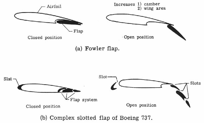

Im in the there can be many sails, but there is only one wing camp.
The jib is the wing, the main is a flap. The jib should have the best trim in the wind and the main should continue the jibs shape right? If they are parallel then the main is not completing the upper lift curve, but contributing to turbulance.
8,129
The main is sailing in a lift with respect to the jib. Without the jib up the main would be stalled trimmed like that.
Think you meant KNOCK. ;^)
But otherwise correct!
Nov 8, 2010
11,386
Bunch of people closing in or outright getting it right.
The main sails in a relative knock (header) with respect to the jib, and has to be trimmed with a higher AOA because of it.

A commonly held view is that the headsail (especially an overlapping one) and the mainsail end up working together, more like a single foil. Looking at it that way, its like the headsail is the leading part of the foil and the main is the trailing part so it makes some sense that they aren't at the same angle of attack. Another way of looking at it is that the headsail has already accelerated the flow on the leeward side so it carries on along the tightly sheeted main without separating (the main doesn't "stall" because the headsail is fanning it in a sense). Either way I think the bottom line is that they are not two independent foils, but a coupled system of foils. There always seem to be many differences of opinion on these fluid dynamics questions, so I'm interested to hear them.

So I would trim the headsail first for the right angle of attack and then the mainsail for good flow off the leech.

Yes, but the main is sailing in higher wind speed on the leeward side due to the Bernoulli acceleration effect of the slot. If the main is over trimmed, the flow will separate and stall. The main must be trimmed to maximize the slot effect. Sooo, what we do is place tell tales on both sides of the main and trim so that the tell tales closest to the mast signal lift, i.e. lay down. So it is difficult to look at the drawings and answer the question asked because so much depends on the particular configuration. For instance, in the drawings the jibs are shown as 100% or less, rather than overlapping genoas. In every boat I have either sailed or observed which does not set an overlapping jib, Shields, Ensigns, Etchells, 420s, the main is always carried off the centerline to maintain flow over the leeward side and maximize lift on the main.

I gonna throw some broscience out there and say when many headsails are used together the benifit is from the correction for turbulance. When fluid goes through a wind tunnel its all fd up due to the massive fans. The air passes tbrough a grid first so that the flow is straight again.
Or. If slot affect is good why not the slotter effect
