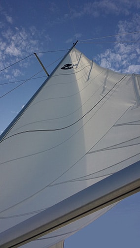

OK, another follow-up for you. When close-hauled and overpowered, one technique is to ease the main and let the luff of the main soften while keeping the trailing edge flat. How does this fit with that single jib/mail foil model?
Not just soften but get backwinded, as in this photo.
For sure, the time-honored 'sailing the back half of the main' model. Speed bubble and a trimmed leech. The key here is that you are over-powered. All sail trim models are designed for fully powered up scenarios. Once you get more pressure than that, your job is to deal with it without creating more drag. Sailing the back half does that.

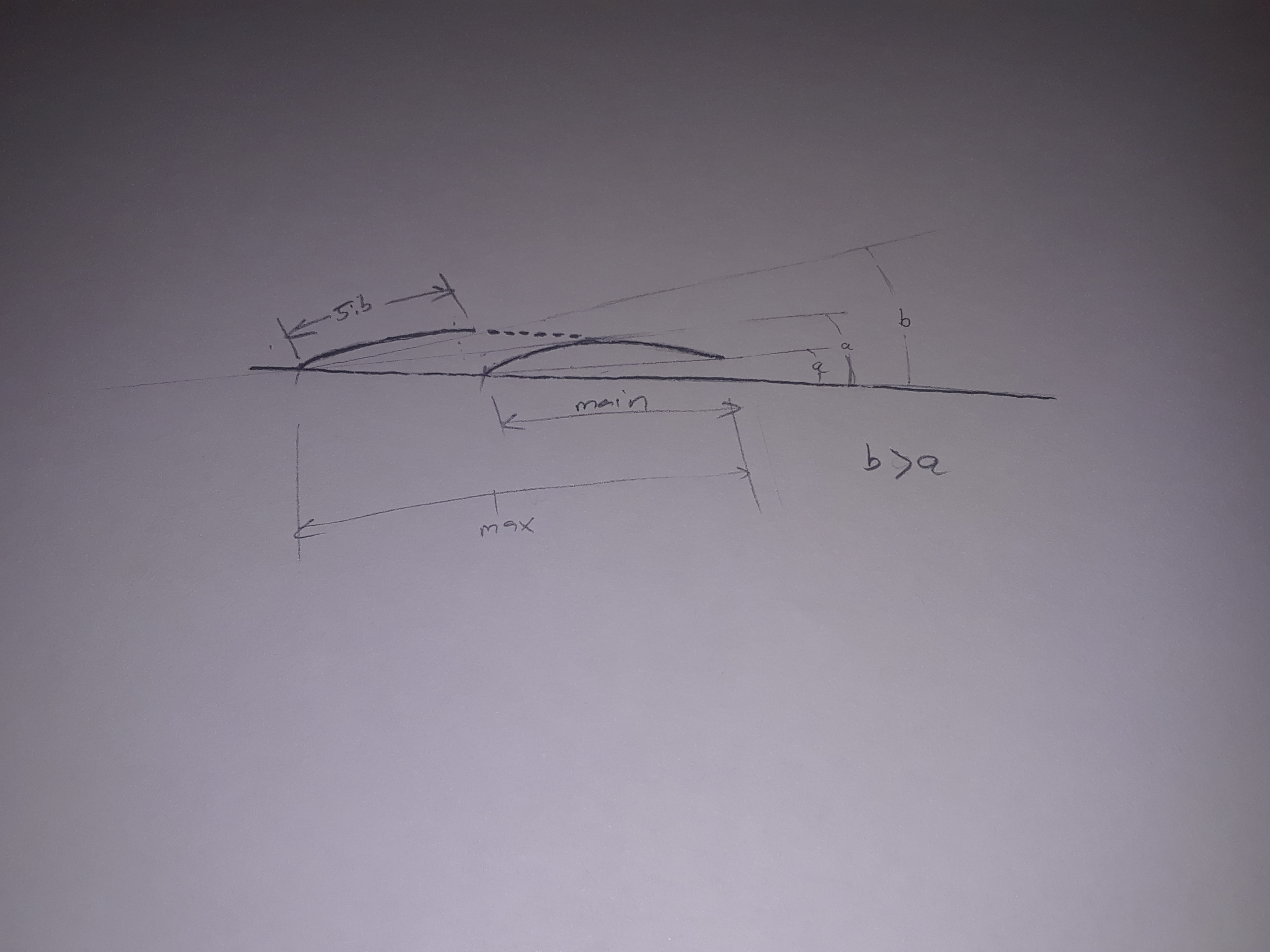

What do you think of this sketch?
The jib if you connect from tack to clew it makes a line with an angle, and if you look at the main and connect the tack and clew it makes a different angle. I propose this...
If you imagine the jib as a single sail that extends until it touches the max depth of the main tangent you have a line from the jib tack and main tangent that is pretty close to parallel to the main tack to clew(boom).
The jib stops before the mast so the angle looks different, but the angle of attack might actually be tbe same for both sails. The jib just has a larger camber.
