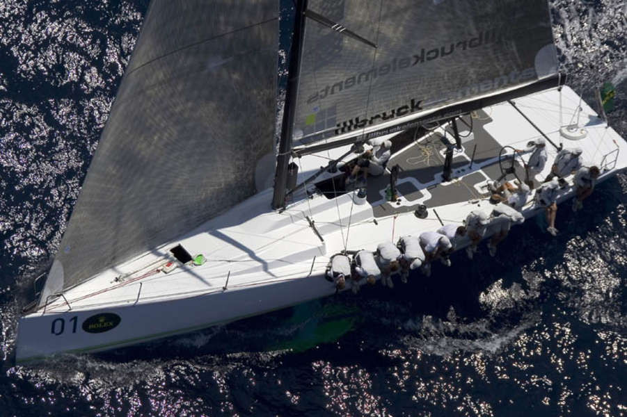

Follow on to that last point, look at the trim on a TP52 raceboat going upwind in optimal conditions. The jib chord angle is about 6 degrees, and the main is on centerline. Notice that the jib tracks run athwartships! The boat is probably sailing into 25 degrees of true wind. The apparent feels like it is on the nose.
And, it would appear that the crew is all puking over the side. :laugh:
Hero hiking. Whenever we get pictures like that, the crew examines to see who is hiking hard, and who's sitting on the rail taking a ride. You don't want to be seen just taking a ride.

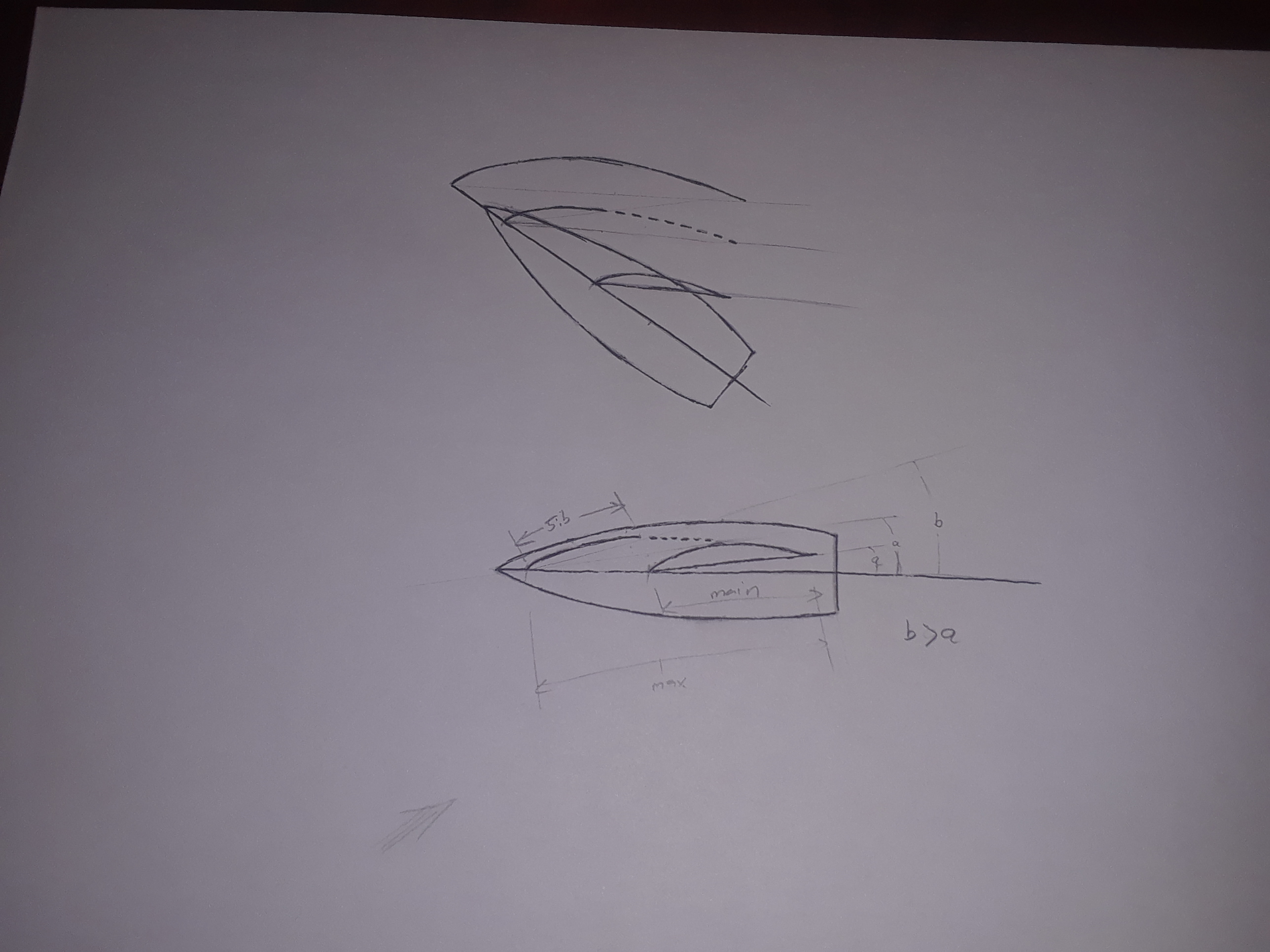

Looking at the samples from everyone and thinking about the jib as if it always should be trimmed as if the jib ended by the main clew got me thinking.
The jibs shouldn't be cut as a complete naca profile. The jib depending on how far back it goes should be cut so that from tack to clew is a part of naca profile of the entire sail plan.
That would almost entirly eliminate the back winding on the main and certainly improve the slot.
The jib on the hunter170 is a complete naca profile. Its very hard to get rid of backwinding.
I made some jibs for my rc boat and they too were modeled on complete naca profiles. Looking forward to testing these ideas out.

Heres another sketch only now the boat is closer to a reach.
Ive added an asymetric. Does this fit with your experiences?
Note the jib angle is still
different than the asymetric and the main, but if the line extends to the full sailplan the angles are parallel. This looks like a couple VOR images.
Note the short jib is a mess to sheet. The ideal attachment point is over water. Any sheet trailing off the jib has to terminate over water or pull the clew closer to centerline. That ruins tbe shape and begins main backwashing. Thought i saw some raceboats with outriggers for jibs, no?
Note the jib angle is still View attachment 144116 different than the asymetric and the main, but if the line extends to the full sailplan the angles are parallel. This looks like a couple VOR images.
Lots of questions here!
With three sails, each one will be trimmed tighter than the one in front of it. Your picture shows them in equal trim.
Your picture of upwind trim shows the boom really far off the centerline. That’s never the case for optimal trim.
Yes, when Reaching with the jib clew has to move outboard for proper trim. Most modern boats now have a mechanism to allow this, either with out haulers or with three-dimensional clew rings.
Yes the Volvo boats use reaching poles to Hold the spin sheet outboard, to allow the clew to stay outboard. Greatly improves sail shape with the code 0.
