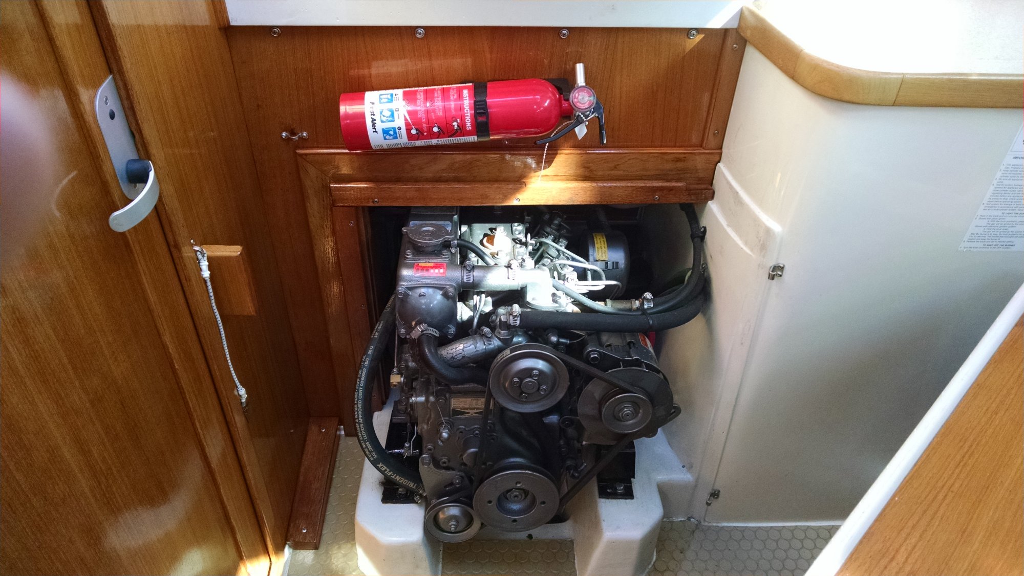

I always hate when Ralph posts pictures of his engine compartment because I have the same engine and even after I cleaned/repainted it and varnished surrounding wood it looks like crap next to his. Oh, And it's warmer in Chicago than San Diego in February WTF ????
Hey, psssst, buddy, want to keep your engine looking like brand new ?
Cover the gear clamp meat hooks with these neat little covers and no one will know the engine is actually 1997 vintage.
My big advantage here is that I've had the boat and engine from brand new and was able to keep up the appearance.
And truthfully, the meat hook covers have kept the blood and guts off the engine from each time I worked on it. The SS strap ends were a magnet to my hands.
Looks like the price has multiplied since I bought mine a couple of years ago so best to shop around if interested.
