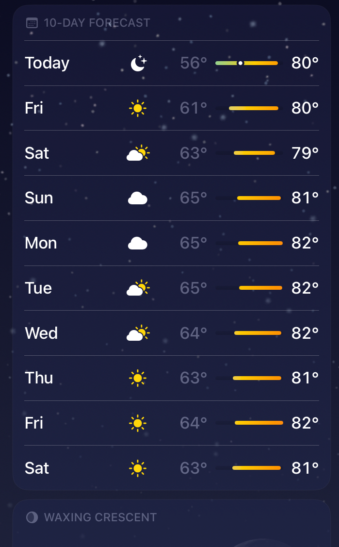

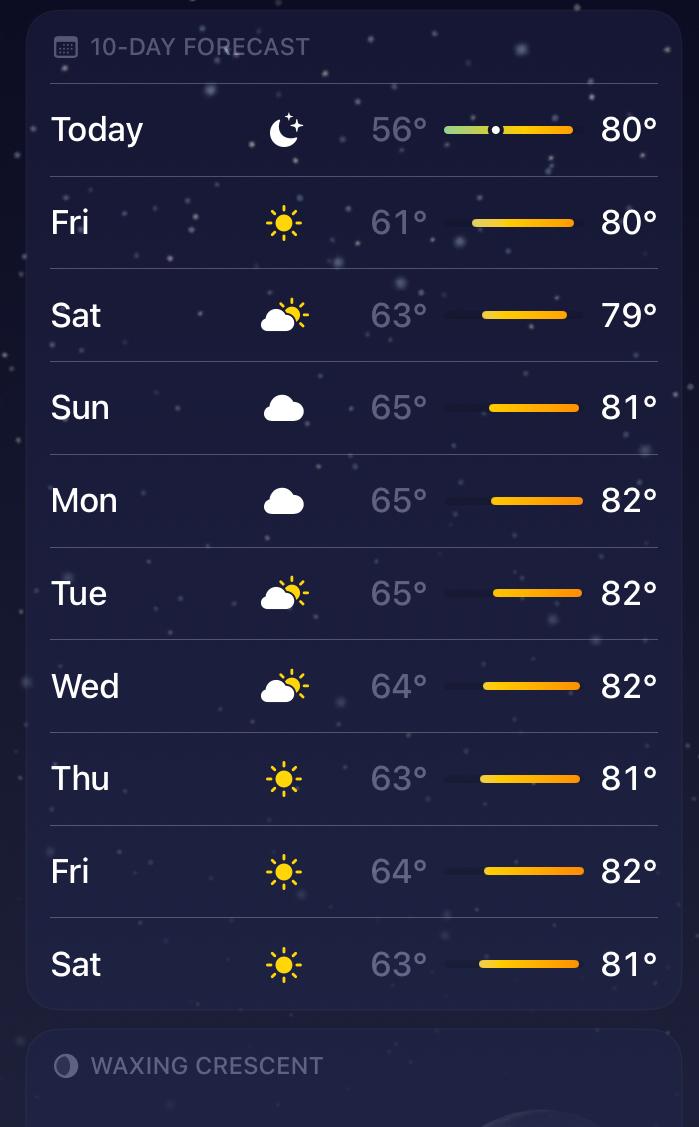

I'll photo everything in little pieces and post when we get out of our present deep freeze here (it's almost down to 34° F here at times) and I can work in something less than hypothermia.
Bummer:cool:
We are out of our “deep freeze” and are back to beautiful weather in SW Florida…
