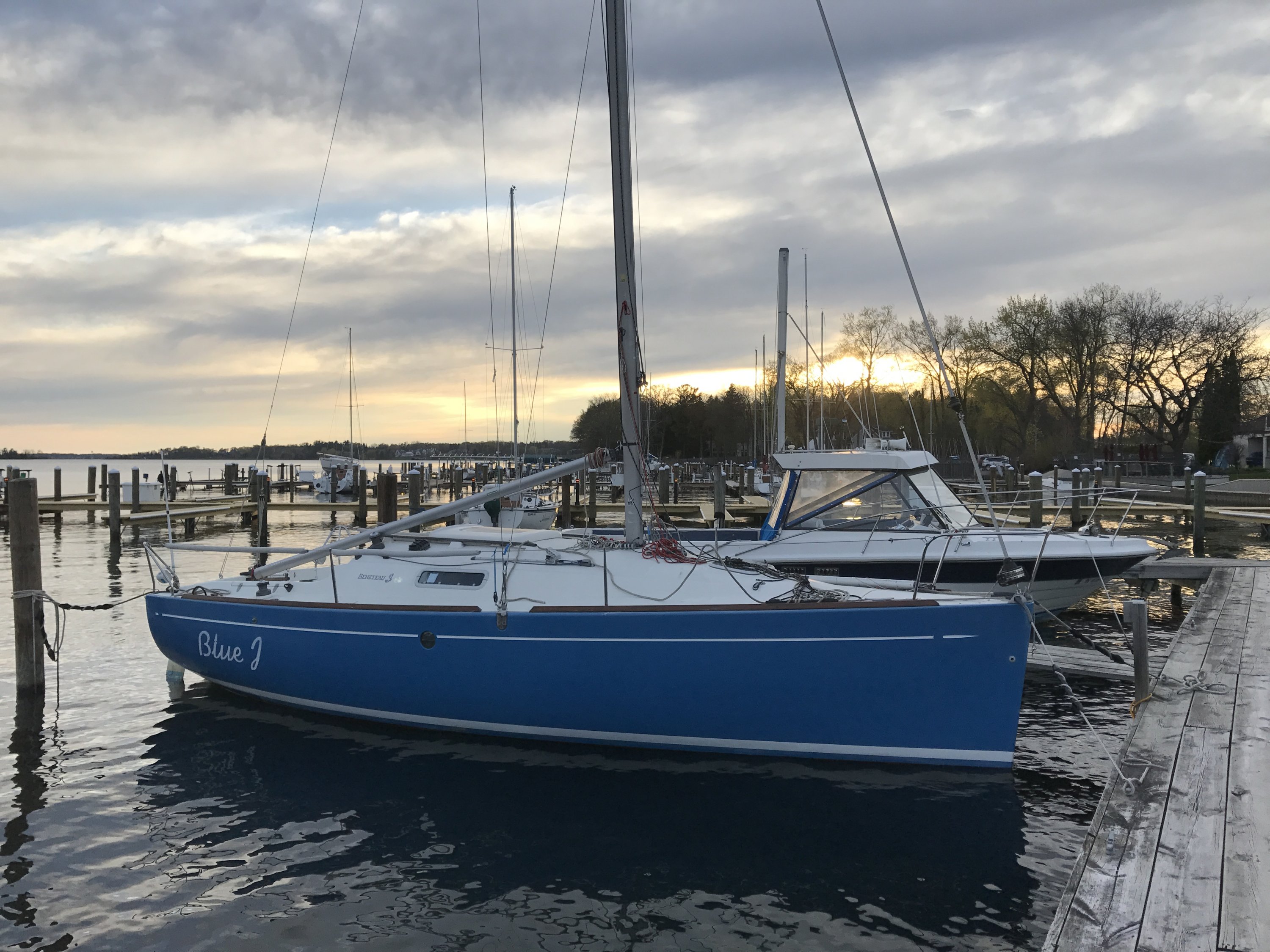

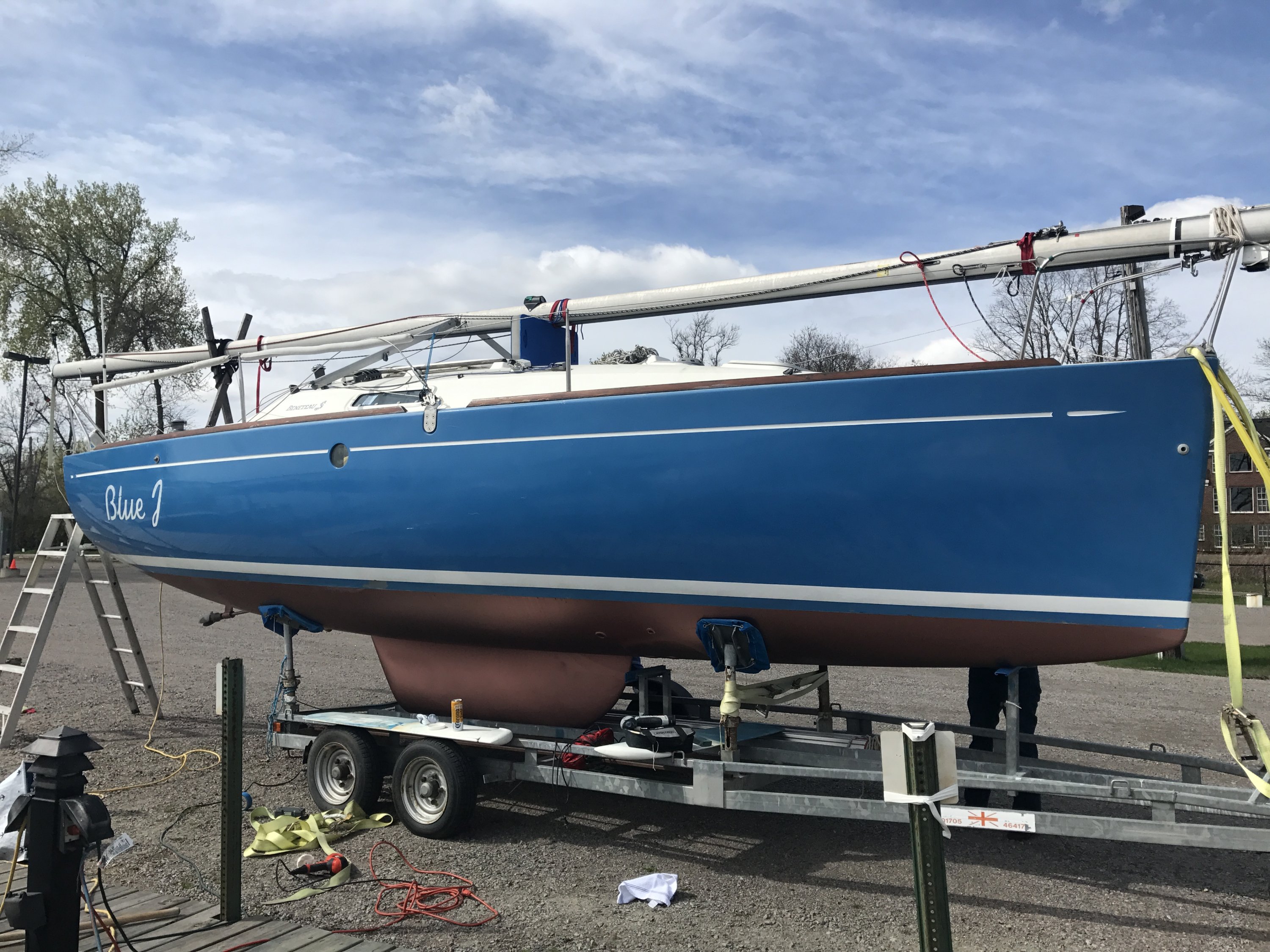

Update: I ended up going with Shurhold BuffMagic and the their wax. While a mixup with a crew member having the wrong polisher (not a DA VS unit) might have cost us some, we are very happy with results, both in the deepening of the color, and the shine. This kinda captures it.

Glad you went with the buff magic option too. I think she looks great, an old boat is not supposed to shine like a new Mercedes in my opinion.
On the water
Nice color. Now let's see if it lasts.

That looks pretty good! You get another shot at it next spring. In fact working up the shine over several spring commissionings will show improving results, and get progressively easier.
How did you like the Buff Magic? I am considering for my next haul out.
For sure. Next year the pre-launch list will be WAY shorter than this year, and we'll hit it again.
Nov 8, 2010
11,386
Its pretty awesome stuff. BlueJ probably had not been done for 10 years (I'm not kidding) except for some wipe on/wipe off stuff. Its really straightened her out.
