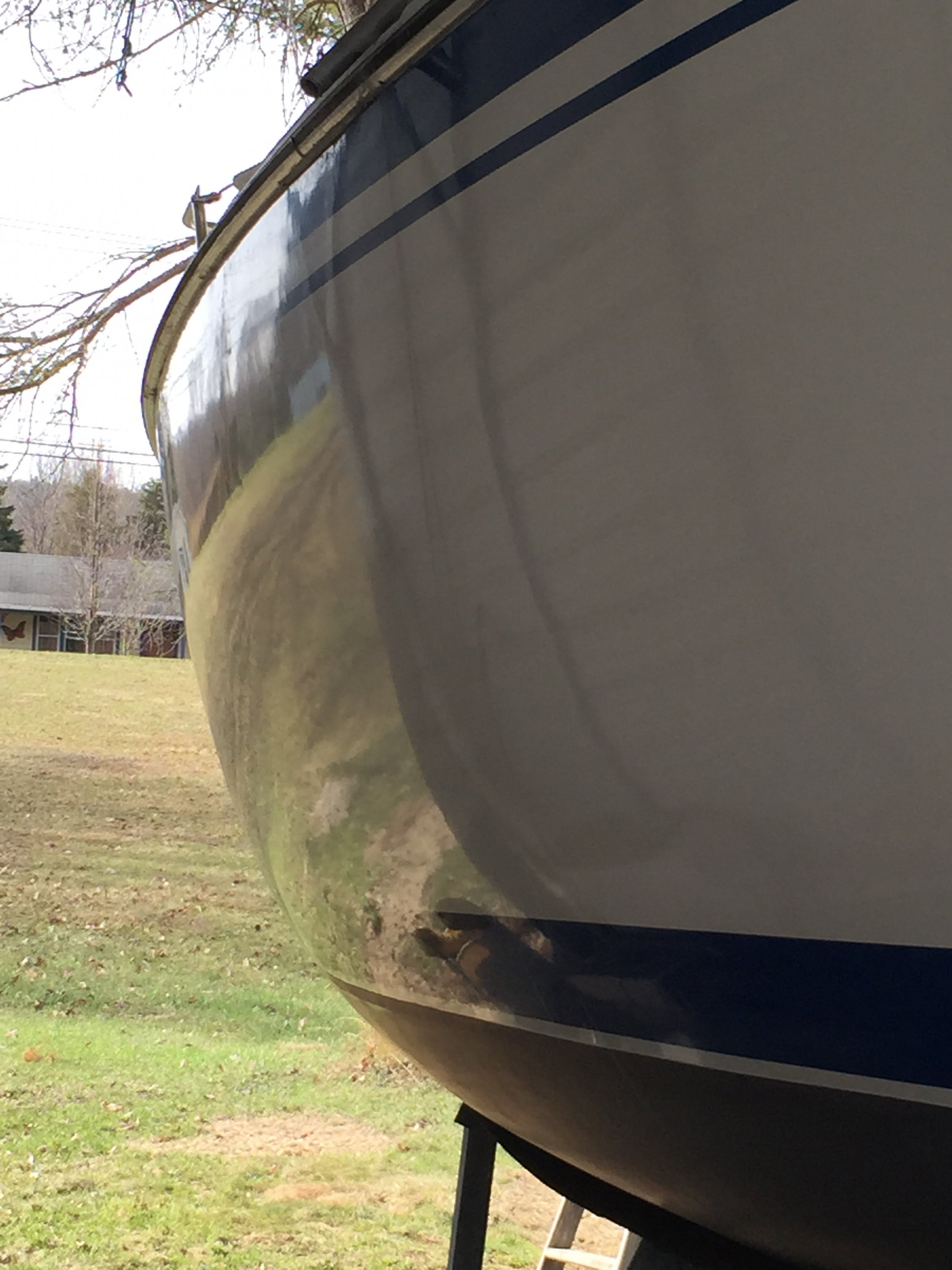

Oct 29, 2016
1,929
Hunter 41 DS Port Huron
Two people, one day, one Makita 9227C 7" polisher, one heavy cut wool compounding velcro bonnet, one wool polishing velcro bonnet, one bottle of Presta Gel Coat Compounding, one bottle of Presta Ultra-polish, 6 ultra-fiber clothes, bucket of clean water. You will have her at full gloss! Spend another 1/2 day with a can of Collinite wax and seal the shine in..or not.

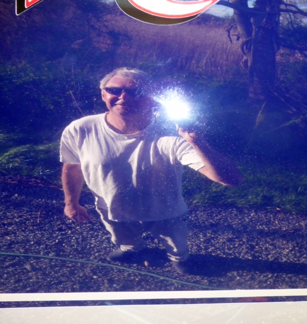

I have obtained excellent results using 3M 3000grid Trizact wet sanding pad attached to orbital polisher + sprayer with some soapy water. It took just over an hour to do my entire hull and the "wet deep gloss" effect was achieved. Applying some marine wax once every 1.5mo keeps gelcoat shiny and greatly stops re-occuring oxidation. The 3M pad is very flexible and can be used to obtain same results on the topside. I found this method much faster than using any creames/cutting pastes I tried in the past.
PS: Yes, you do need new boat name decals ;-) That alone is worth at least 0.0003kt top speed ;-)

I've gone full-on MainseSail on three boats. Current boat is a 1996 Catalina 28, and the topsides look new. Those who say that the shine achieved with compounding and polishing doesn't last, have most likely not done the job properly.
If I was going to do an abbreviated job on your boat, I'd use the type of grinder/polisher MS recommends, and give it a thorough compounding with Presta Ultra Cutting Compound. Followed by a coat or two of Collinite Fleet Wax. There's no need to use power tools to apply the Collinite. Just wipe it on and hand polish with microfiber cloths. Oh, and prior to compounding, a very thorough cleaning with something like Dawn dish soap. A really proper cleaning would include putting on a bunny suit and cleaning the topsides with MaryKate On Off, but that may be more than you want to do.
If I was going to do your boat correctly, I'd probably start with 800 grit hand wet sanding and work my way through the grits per MaineSail. If you fail to properly evaluate how aggressive your initial grit should be, no matter how well you compound and polish, you'll never get full shine. Nobody wants to start with 1000 grit wet sand and go through full compound and polish only to realize they have to start over with 800 and go through the entire process again.
Doing less than a full-on MS treatment will give you diminished results with reduced longevity. It's a boat....when were you ever able to substitute a "quick and easy" method for the proper method?
You might find the abbreviated method is adequate to achieve the better color and reasonable shine that you're after. That's a legitimate way to go about it and get it done in one day with two workers. My estimate for two guys to do the full-on MS treatment would be 3 days. More like 2 days on their second boat.
This all assumes you're not firing any deep scratches in the gelcoat. Of course, sanding out deeper scratches is not a solution, as it destroys the hull's fairness. Scratches need filling and proper finishing prior to the rest of the process. One solution, regardless of whether you go "abbreviated" or "full-on" is to ignore the scratches and gouges, and just go for the color and shine. The boat will look MUCH better when you're done, and there's no reason you can go back and deal with the scratches whenever you want.

From the pics, it looks like Blue J still has a pretty good shine on the gelcoat and not much in the way of chalking (if any). I would skip the wet sanding for now, and buff with Presta Cutting cream rather than the harsher gel coat compound. If it doesn't go fairly quickly, I would wet sand first, but start with 1200 and switch to 1500 before buffing again. After the cutting cream, go over it again with Presta Chroma for a finish that will frighten your competition. Presta makes matching buffer pads for their products, so make sure you're using the right pad for the right product (a too aggressive pad with a fine finishing product comes out ugly).
For wax, I've found that the Starbrite polish with PTEF lasts longer than anything else I've found. They make a cleaner / polish, and a straight polish. You want the polish (no need for the cleaning abrasives) after buffing. Hit is with a couple of coats. If you're really anal, you can put a coat of Collinite paste wax over the starbrite. It will deepen the shine a little more. If only using one, my preference is the Starbrite, as it seems to offer more in the way of UV protection (that's been my experience with the dark blue gelcoat stripe near the rub rail, on my boat).
