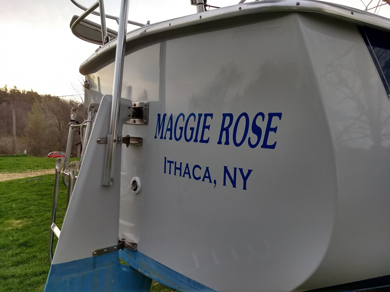

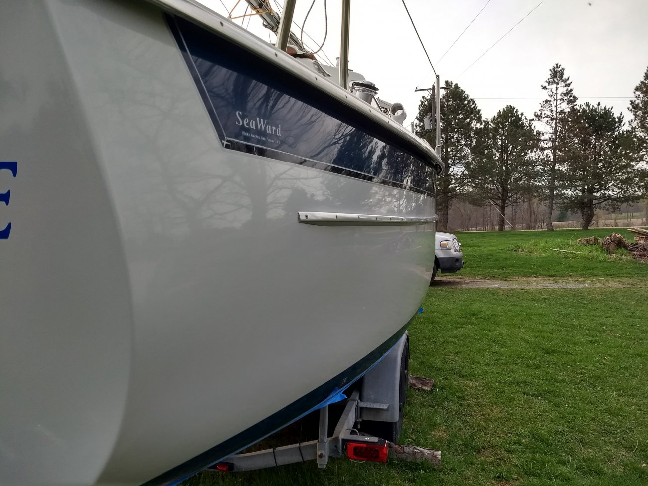

I tried a little experiment this last spring on mine. As you can tell from the side pic below, I have no problem buffing and bringing the shine back to basically a new boat. However, after 22 years, how much longer can you do this? Don't know the answer.
So on the transom only, I did a little experiment. I cleaned it with Bar Keepers friend, and TSP. Then put aboout 8 coats of Zep commercial acrylic floor polish on it. Even went a step further and burnished (in floor wax terms) the acrylic with a fine pad and Presta Chroma. Job was indistinguishable from the rest of the boat that I buffed and put a couple of coats of wax on. Transom held up better this year than ever. Previously, when waxed, diesel exhaust haze would embed itself and could only be cleaned off totally with a cleaner wax. Washes right of the acrylic without leaving a trace. All I'll have to do to it in the spring is clean it well and add a couple more coats of acrylic. Not sure I have the nads to do the whole boat yet though (old habits die hard). Pics below taken this spring.

Your boat looks good!
