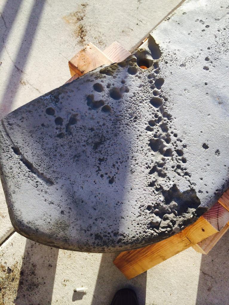

I'm reposting the pics of the keel post sandblasting so you can compare the worst damaged areas to the post repair. The missing cast iron around the keel pin had me most concerned. I filled this area with epoxy mixed w/ high density microfiber filler. This stuff is extremely strong when cured and very tough to sand. WEST technical support advised that this was the best filler to use, that its bond to the ports cast iron would likely be stronger than the original metal itself. Its so tough that I had to rough shape it with a sure-form tool (rasp) before sanding with 80 grit. Then I laid 2 long layers of 6oz biax tape on the 'back-bone' above the keel pin.

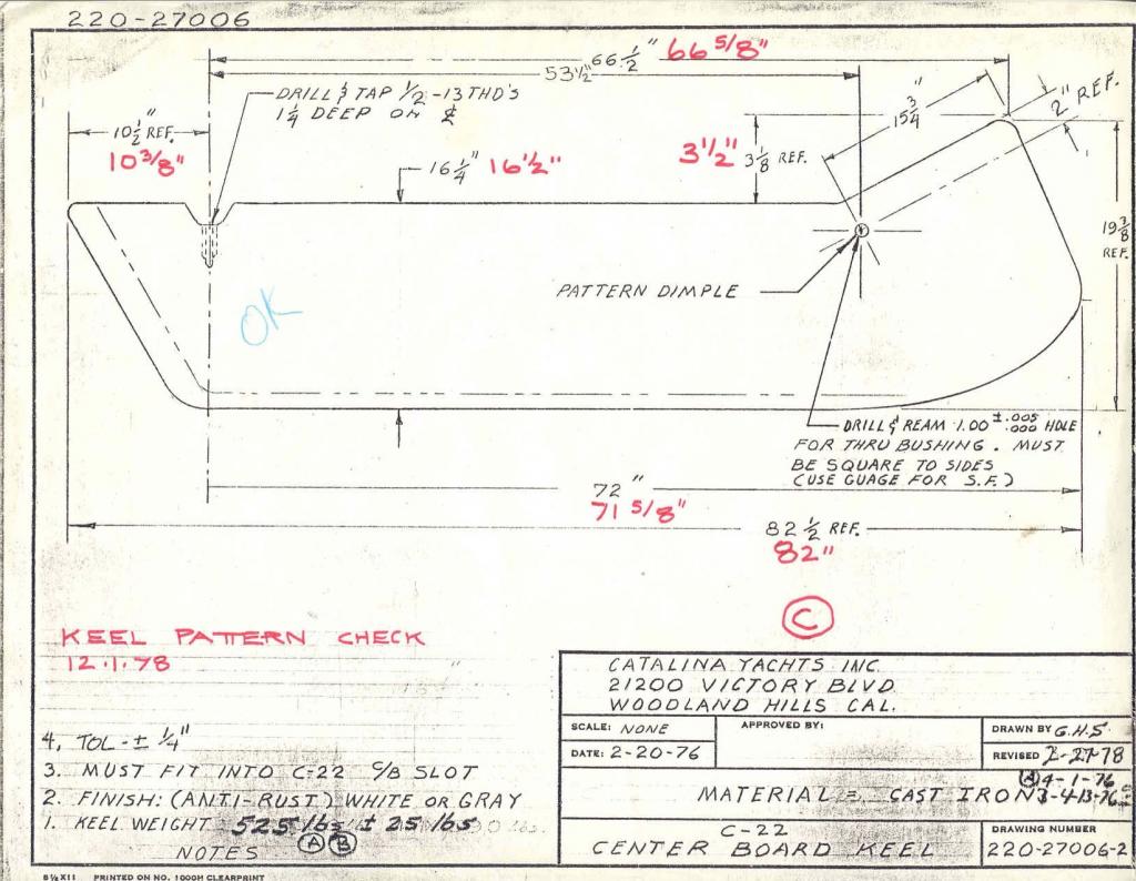

I used the original factory keel drawing to check my work, making sure my repair areas were shaped correctly and matched the drawing and verified that my keel pin location was still correct. I did not bore out the 1 inch hole up to 1 and 1 & 1/4 inch for the bushing until the repair was complete.

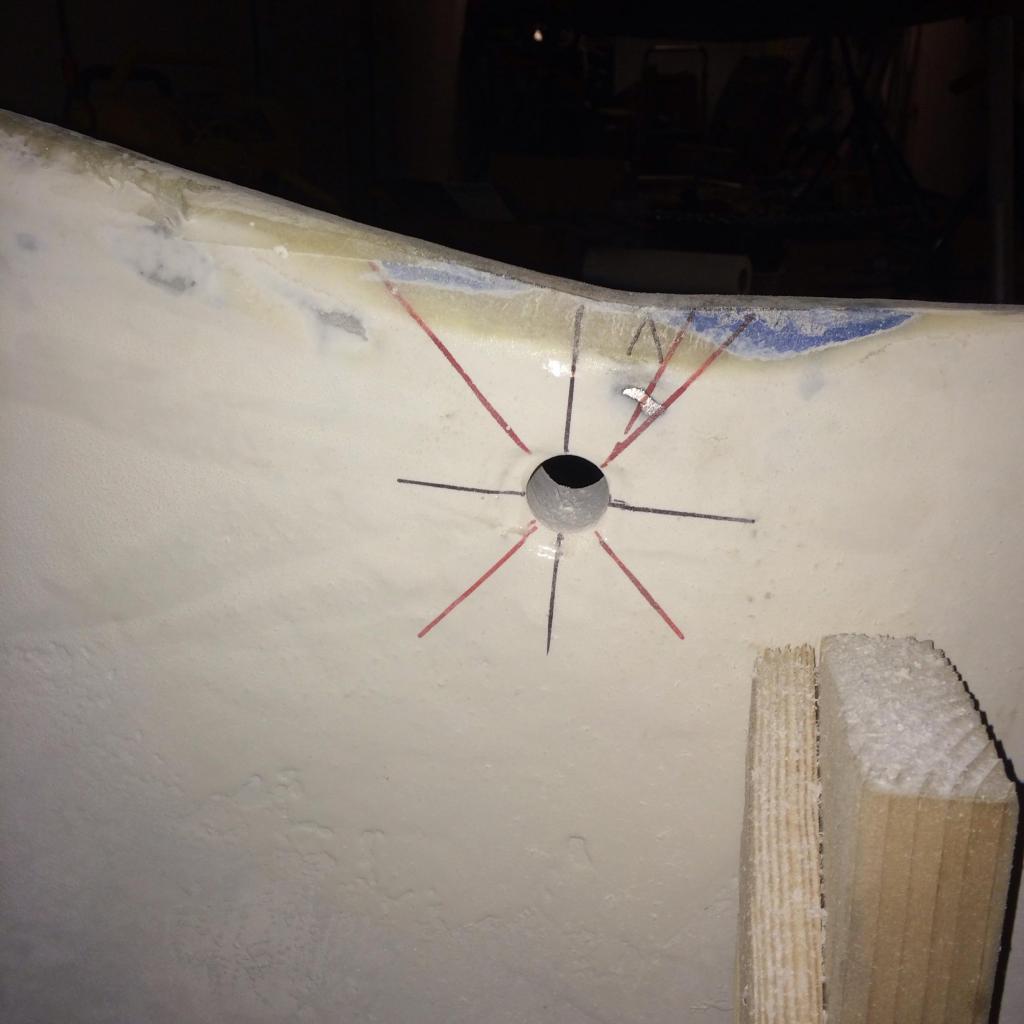

Results of the new bushing
Well, as I mentioned above, despite the issues the installation of the Pin Bushing turned out really well. Here is a shot of 'filling in' on one side. I used very light coating of zipper wax to coat the keel pin and the inside of the bushing; When it cured the pin slide right out and I sanded everything flush leaving a perfect epoxy 'collar', sealing the bushing in on both sides and filling any voids.

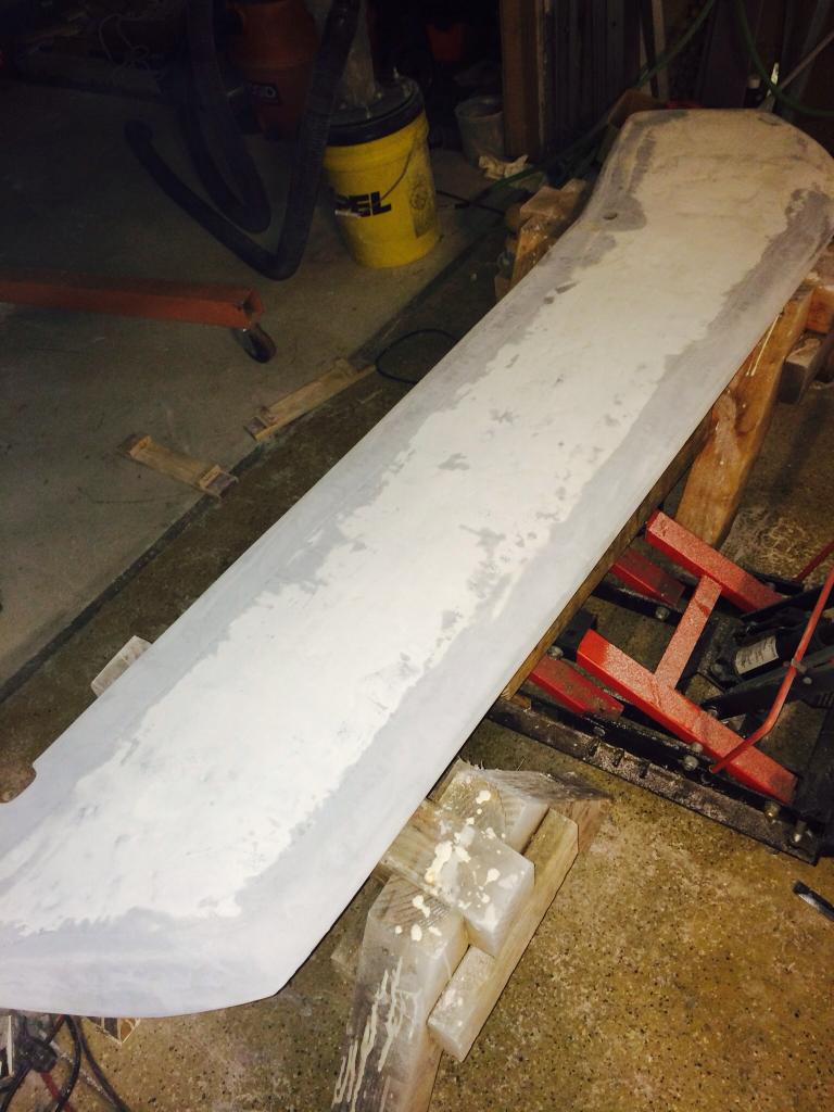

First coat of fairing compound applied (West Epoxy thickened to PB consistency with fairing filler, reddish in color) Note the lighter color of the fairing compound, that's because I put grey pigment in this first batch which was really a waste of time. It just made it a pink color where you can see in the pics of the other side that the compound is pretty red.

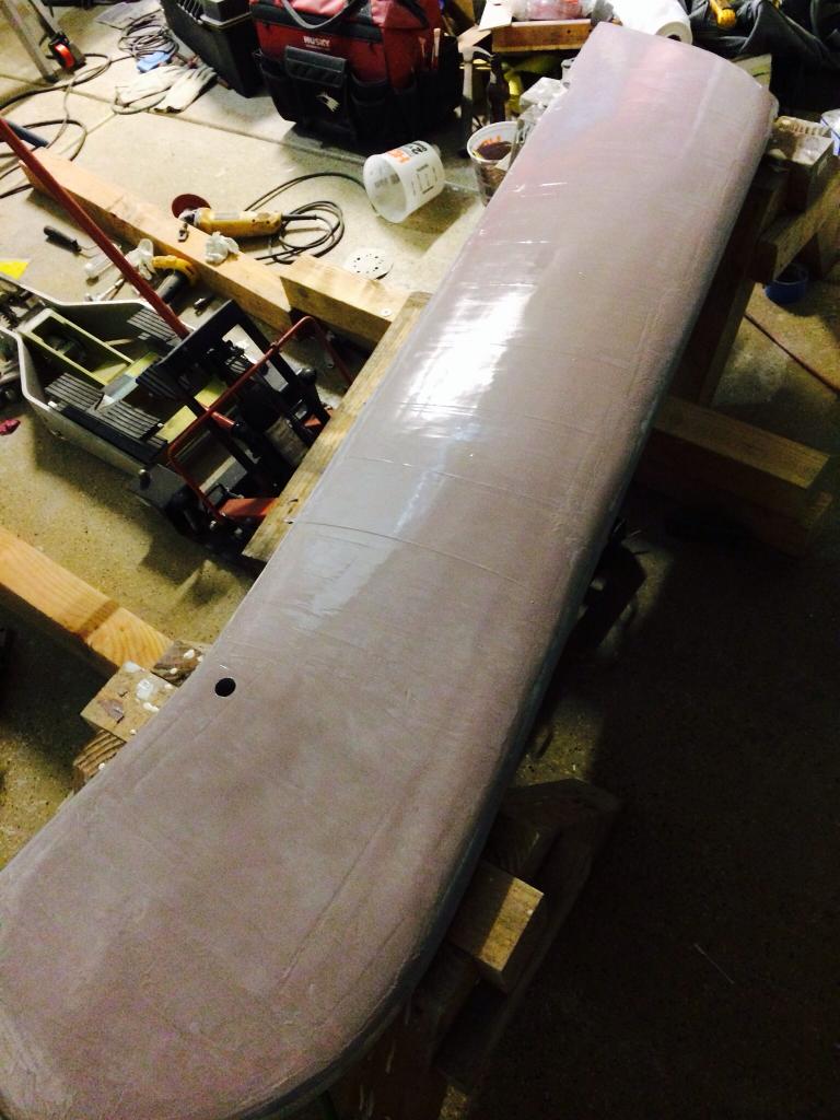

On the other side this is a before shot showing the 6 oz tape I used on the leading and trailing edges. I put grey pigment in the epoxy, this helps as a visual aide when sanding.

This side was overall more fair to begin with so I had to use less fairing compound (12 pumps plus hardener and fairing fillier on the 1st, only 10 on this side).

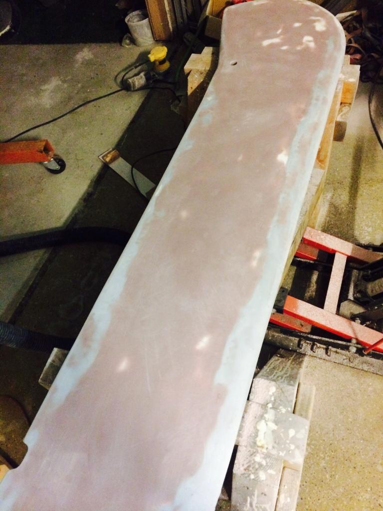

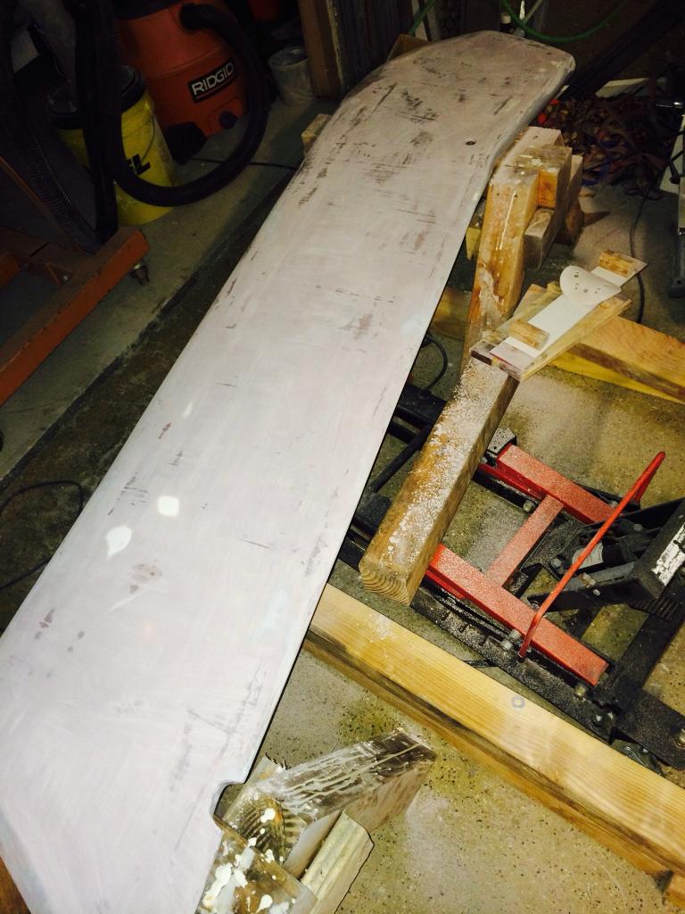

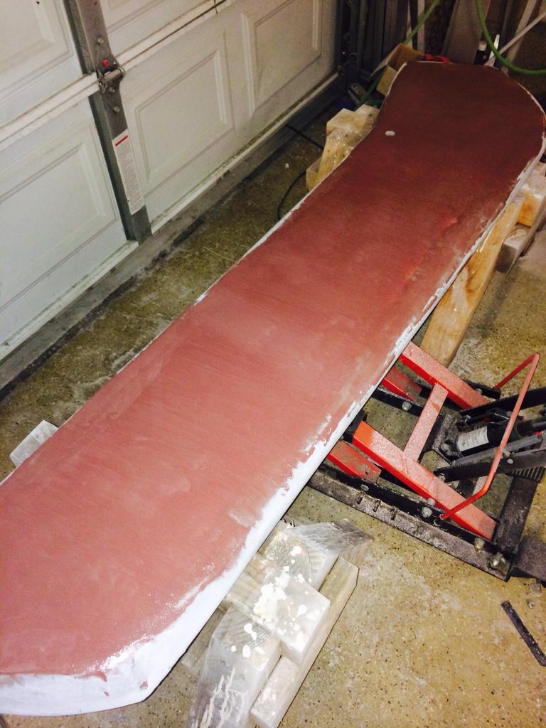

After about 20 minutes of longboard sanding, first with 80 grit to get the high spots, then 150. The dark spots are the remaining low spots before I used 180 on the orbital sander, gently.
Sep 8, 2014
2,551
Final fairing results; I have a bit left to do around the edges by hand but otherwise its ready for primer;

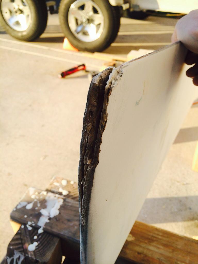

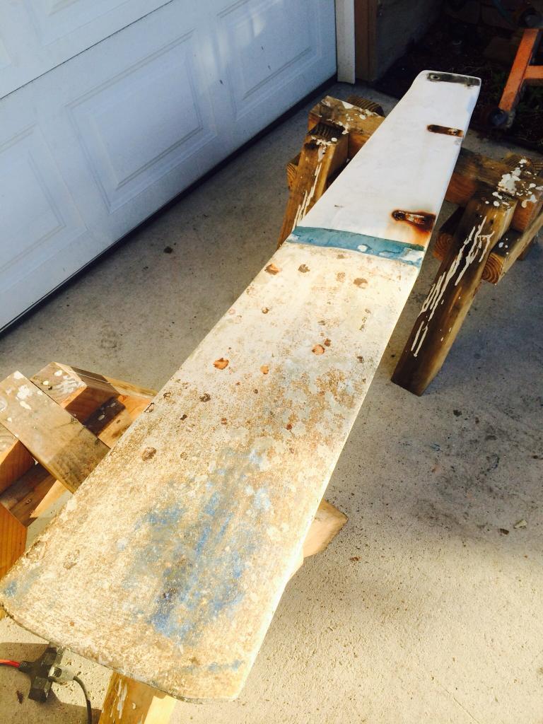

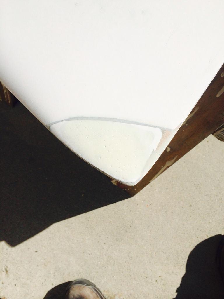

The following weekend for New Years I got another 4 day weekend so I got back to work. Here is my Rudder which had some light delamination at the bottom leading edge corner.

After removing the hardware, then a good scraping and sanding I got a good look at the damage.
Sep 8, 2014
2,551

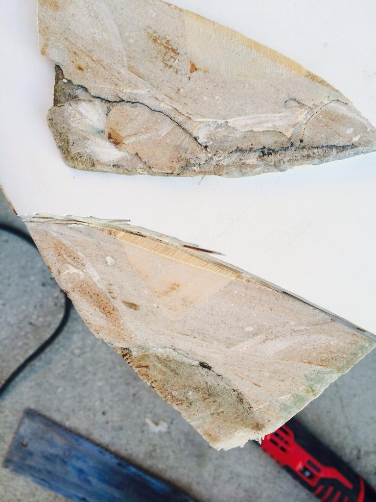

I used my new Milwaukee Oscillating Multi-tool with the half circle cutting blade to remove the corner where it delaminated. You'll notice in the pic that wood core did not soak up any water, the de-lamination didn't go deep enough and that was good news.
Sep 8, 2014
2,551

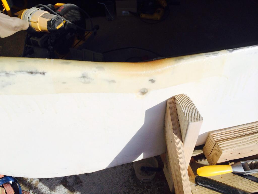

After scraping and sanding away the junky polyester filler that was damaged I mixed up some epoxy with colloidal silica filler and clamped the piece back into place. After curing I rough sanded the area back into shape. I may add a little fairing compound later and fine tune the profile a little later, but otherwise after some additional sanding the rudder is pretty much ready to repaint. I am debating if I should bother adding some glass tape to the leading edge and bottom edge for additional impact and abrasion protection... might be over-kill. At some future date I think I want to invest in a kick up rudder anyway.

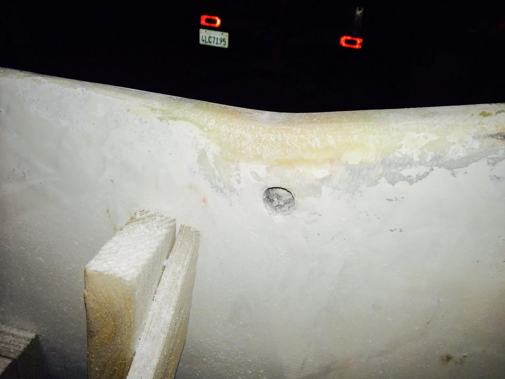

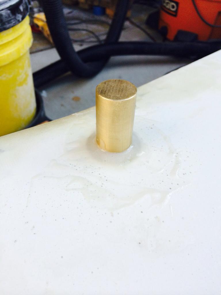

Back on the transom I decided that my bilge pump thru-hull was too low. Pretty much you can see its right at the water-line. I've looked at pics of other members boats and noticed that it should be a few inches higher and inboard toward the rudder. I over-bored the previous sloppy hole with a hole-saw and used thickened epoxy to fill the gap between transom and hull liner. I used the same hole saw to punch out two plugs of my 1/2" marine plywood and glued them together with epoxy. The pic below is the hole with gap filled. I forgot to take a pic after the plug was placed and cured but I can add it later.
