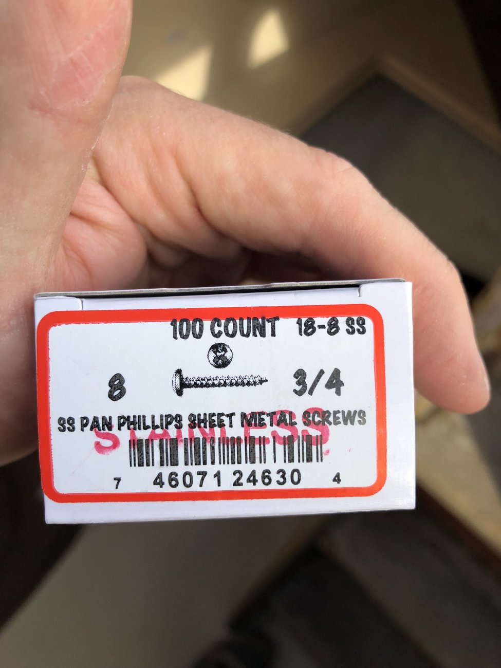

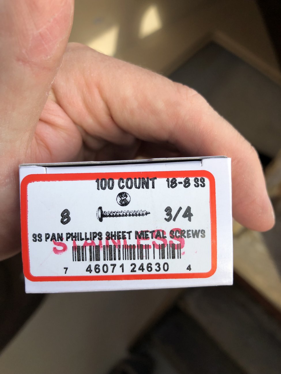

I'm creating this post to document the window replacement on my Catalina 25 in case it's helpful to other people. I ordered the replacement seal kit from CatalinaDirect.com and yesterday I pulled out the two windows that were actively leaking. In the starboard aft window, 3 of the screw heads were stripped and none of the basic "removal" methods worked (rubber hand, reversing with a drill bit, tapping with hammer and screw driver, etc.) so I got a "tap and drill" kit from Home Depot that came with four sizes. It worked on some, others took a lot of effort starting with the smaller size and going up to the second smallest in the kit. Luckily for me, the PO hadn't used any adhesive trying to hack a window replacement so they came out pretty easy. A couple of the screws in the port aft window were partially stripped but only one required the "tap and drill" method to get it out. I took one of the screws to Ace Hardware and got an entire replacement set of stainless steel screws because I would never put screws back in that were even slightly stripped. They're #8 screws 3/4" long (pic attached).

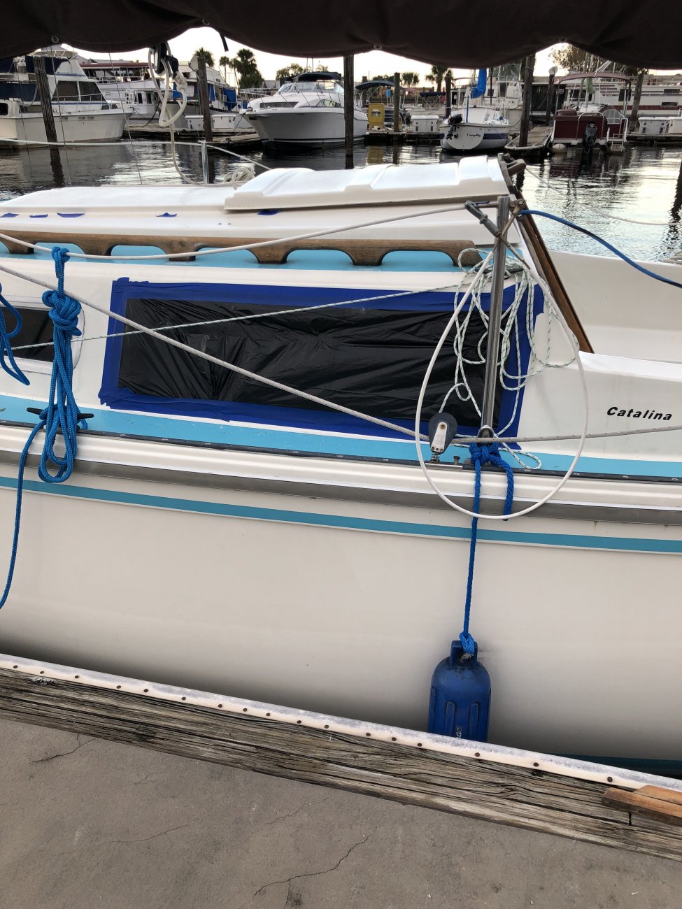

I cleaned up one of the windows at the dock, scooping out all the old sealant with a flat head screw driver. My god, that stuff is messy and sticky. I would definitely not recommend doing it there. Also, I would wear latex gloves because it was nearly impossible to get that gunk off my hands. I brought the second window home to do it in the shade, so I cleaned up the exterior around both window openings and ghetto-taped up trash bags keep water out in case it rains.
