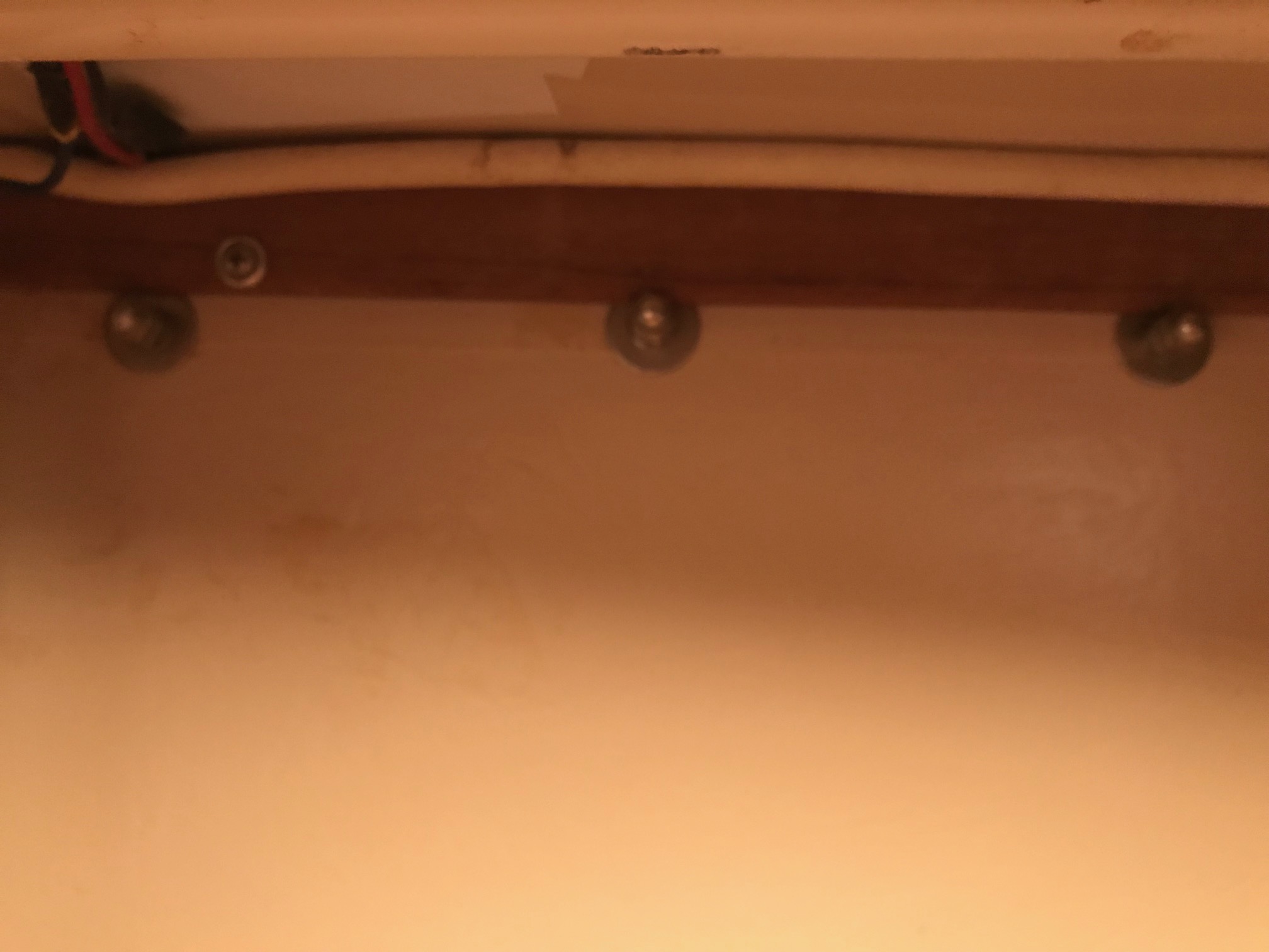

Does anyone recognize what these screws are screwed into. I believe that it is below the rub rail.

If I am seeing it correctly, those are the screws that connect the aluminum rub rail extrusion and is part of the hull / deck joint.

I agree with Steve, they are below the rub rail and do not show on the outside of the hull.
They appear to be holding the back wall of the cabinet to the hull and only show in the cabinet when looking at the starboard side. That back wall is part of the inner liner.

I called Catalina and talked to Warren in customer service. He confirmed that the cabin liner extends up the side to just shy of the bottom of the deck. The bolts and nuts showing on the inside are the where the rub rail is bolted on.

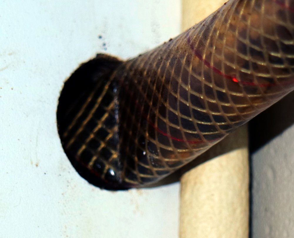

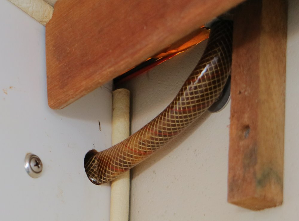

The existing vent hose was a 1/2" hose, and I am under the impression from reading info here that bigger is better, for more airflow. The problem for us was odor. When trying to discover the source of said odor, we noticed that where the 1/2" vent hose goes through the bulkhead before reaching the bottom of the stanchion, that it was essentially smushed. It appears to have perhaps even been built that way. Like not enough hole, so they just kinda crammed it in there. So almost no airflow getting through it. The fitting on the tank was also loose, and the only way to correct that would have been to make the hose go a different direction, because the fitting, when screwed down tight, would be facing away from the stanchion. Also, the hose leaving the tank was 3/4, and then there was a 90 degree elbow connector/adapter taking it down to 1/2" on the way to the vent.
So the prospect of resolving all that sounded a lot more difficult than just going the "Peggy Hall way", which would also be an improvement. We are quite happy with it. And, if anything every goes wrong with the solution, everything is super easy to access now.

We took the head cabinet out today. 4 screws inside the cabinet and two on the aft side of the saloon bulkhead. Turns out the vent hose was kinked. The cabinet itself was squishing it. My plan now is to just remove the old vent hose completely and cap off the bottom of the stanchion vent with a cap nut. Looks like it will be a 1/2"-13 size cap nut based on the dimensions of the stanchion on Catalina Direct. By the way, the entire length of this old vent hose stinks to high heaven!
