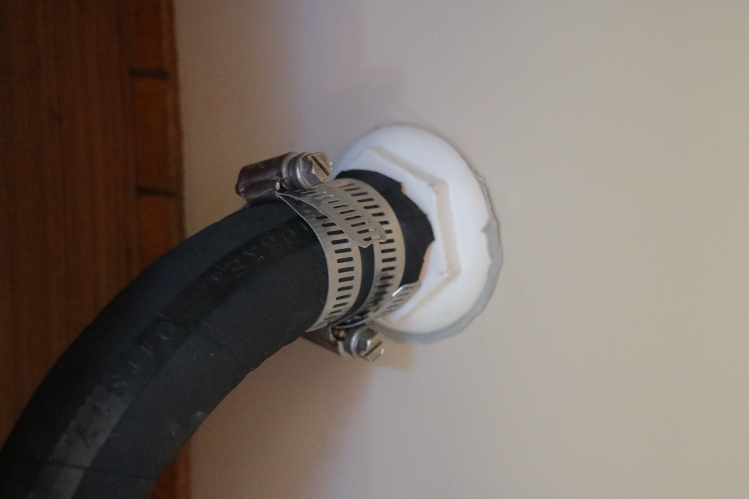

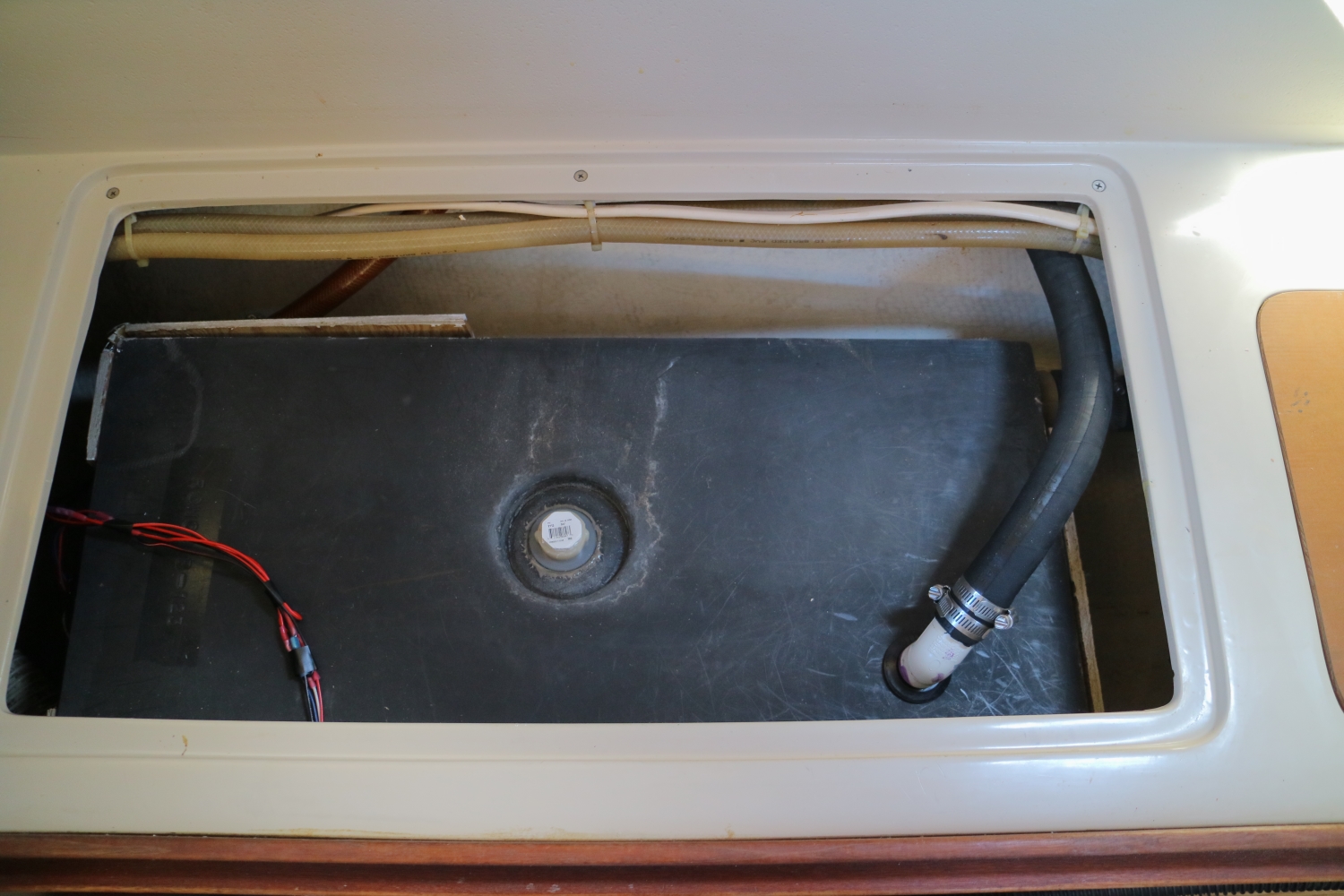

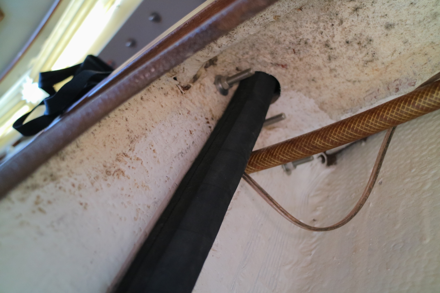

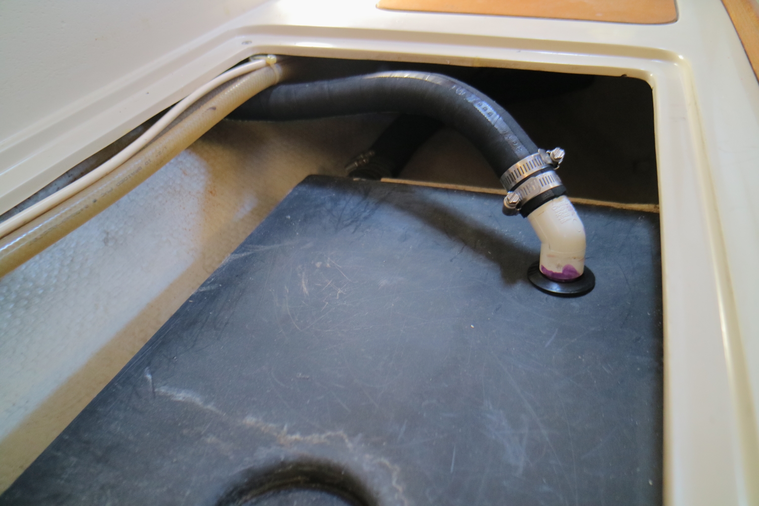

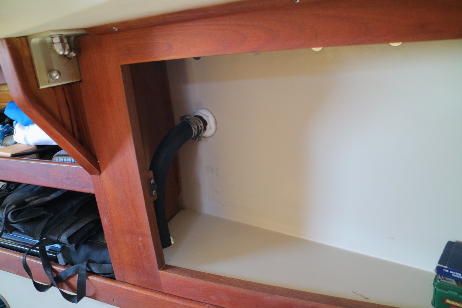

I just did this project last week on my 88 TR. I drilled from the outside in, because I was worried about coming out in the raised section below the rub rail and going outside in assured that I wouldn’t. It wasn't very hard to figure out the horizontal position by just eyeballing it and measuring a little just to make sure.
I used Trident 101 as suggested. Found some 1-inch ID on eBay at a good price. I bought 5 feet, but the guy only sent me 55 inches. This is ok though because it still fit. Seems like anything between 50 and 60 would have done the job.

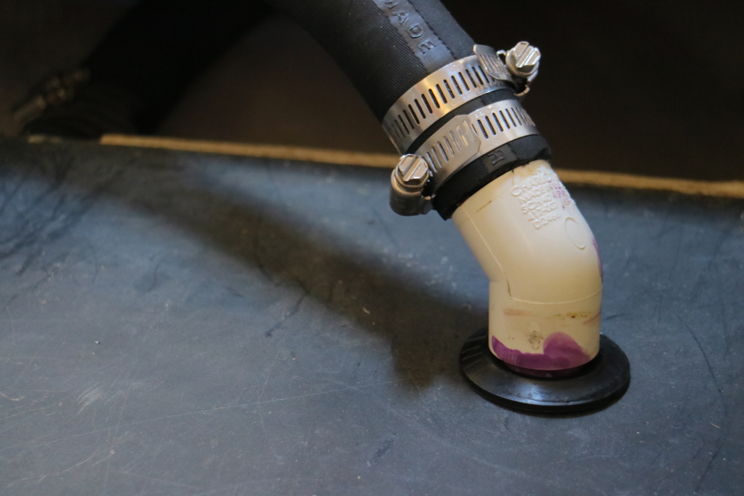

I used a Uniseal and a 45 degree PVC elbow, with about 1.5 inches sticking out either side. I used two hose clamps on either end in opposite directions.
Since I was not sure how it would all fit together, I bought a pack of 1" Uniseals and a pack of 3/4" Uniseals. Then one of each size PVC pipe and elbow. I also had two hole saws, 1-3/4" and 1-1/4". My thru hull was a 1-inch Forespar marelon mushroom head from West Marine.
The hose fit the thru hull no problem, but the hose would not go onto a 1" PVC pipe, so for the tank end, I had to use the smaller Uniseal, elbow, and pipe.

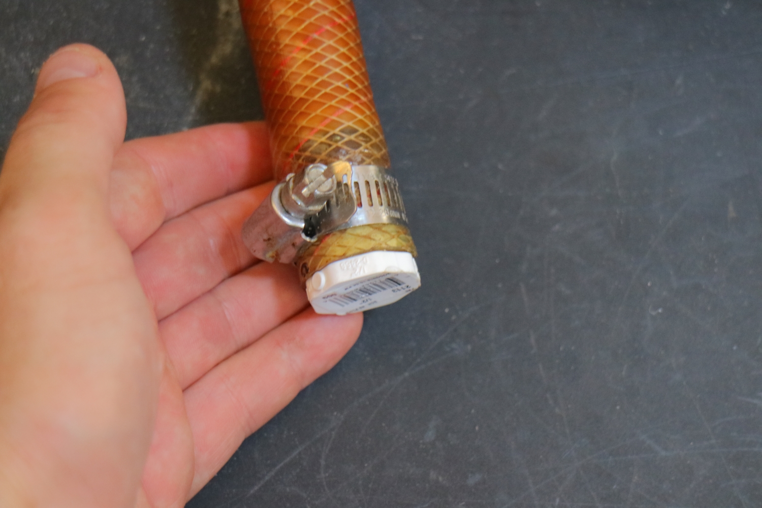

I used a 3/4" PVC plug in the tank where the old vent connected. I then used a 1/2" PVC plug in the end of the old vent hose, with the intention of shortening the hose later and moving the plug closer to the stanchion, rather than trying to remove the stanchion and plug it.

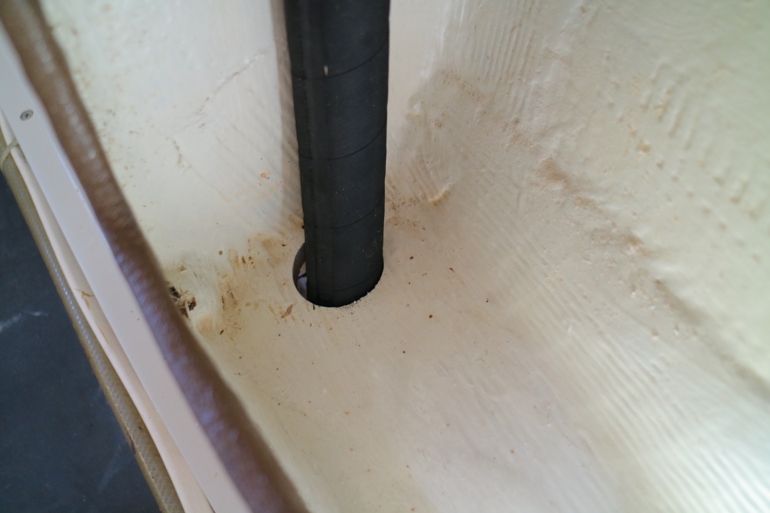

For the gap between the hull and the liner, I did nothing. I debated using thickened epoxy but voted in favor of butyl tape on each side. I can always add epoxy later if necessary.
I had to drill 3 holes. One through the boat, one through the bottom of the shelf, and one through the storage compartment behind the port side settee back cushion.
I also added a SCAD solo tank monitor, which seems pretty handy.
I will attach a few pictures. I didn't really have any issues other than the temperature being 95 degrees in the boat at the time, but I am kind of used to that now, plus cerveza makes it 72 degrees in my head. I can also say with 100% certainty that it has helped with odor so far.

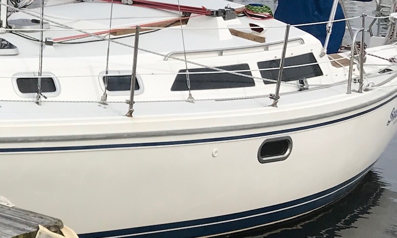

Any chance of getting a picture of thru-hull on the outside of the boat? I am hoping to do this project before I splash and the boat is on the hard and temps Not in the 90's.
Ward H
Nov 7, 2011
3,827
Here's a cropped shot of where I put my vent. Above water when heeling and inside the port cabinet.

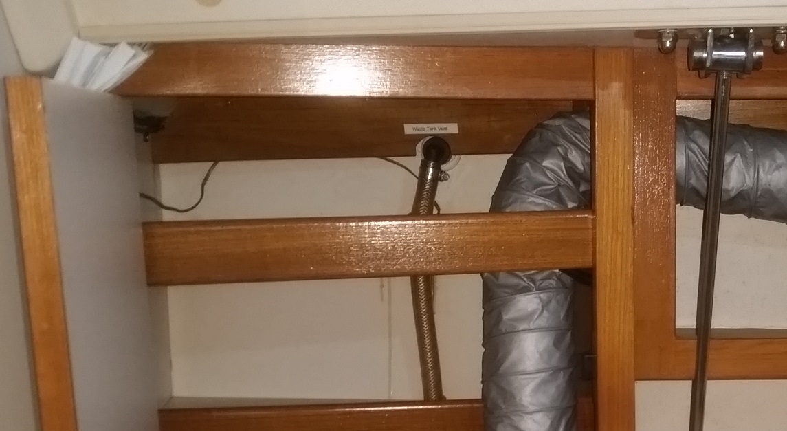

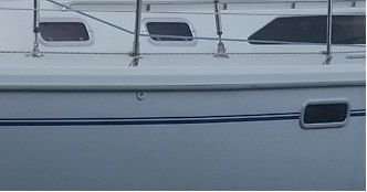

Here's other cropped photos, from inside and out. As you can barely see, I selected a vent spot too high, and actually had to shave off part of the mushroom head of the external through-hull to fit under the rub-rail. I excuse my over-abundance of caution due to occasionally "accidentally" burying the saloon ports, even with the stripe, on breezy days and I did not want to have seawater back filling my vent pipe. I did not want to re-route the vent line out of the head area even though it is a longer vent run due to (1) laziness and (2) could not get it high enough and still hidden behind cabinetry by going straight up above the waste tank in the saloon. I had to Dremel away a bit of interior trim, which may not have been needed if I had placed it only an inch or two lower.
