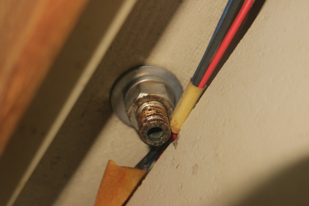

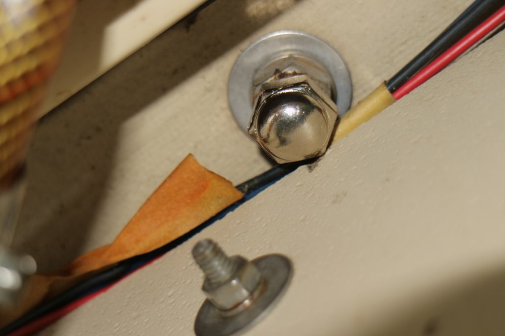

I was finally able to remove the offense hose. Here is a picture of the threaded end of the vent stanchion and then another after I cleaned it up a bit, added thread tape, and capped it off. I am so glad to have that hose out of my boat!

VERY cool.

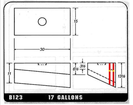

So I had the same issue. I ended up contacting Michael at SCAD Technologies to ask him about positioning on the tank. What I ended up doing is this (or as close as I could get):
Now, obviously you can't get there, so I had to cut off the aft end of the retainer "box" that holds the tank in place. I used my handy dandy oscillating tool to just make vertical cuts on the corners where it was just fiberglass. I then notched the wood piece where the sensor sits, and then glassed it back in when done. Less than ideal, but it's there!

Oh also, Michael from SCAD told me to use the "tapered" setting. It works like a champ.
