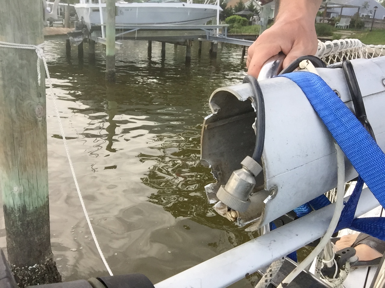

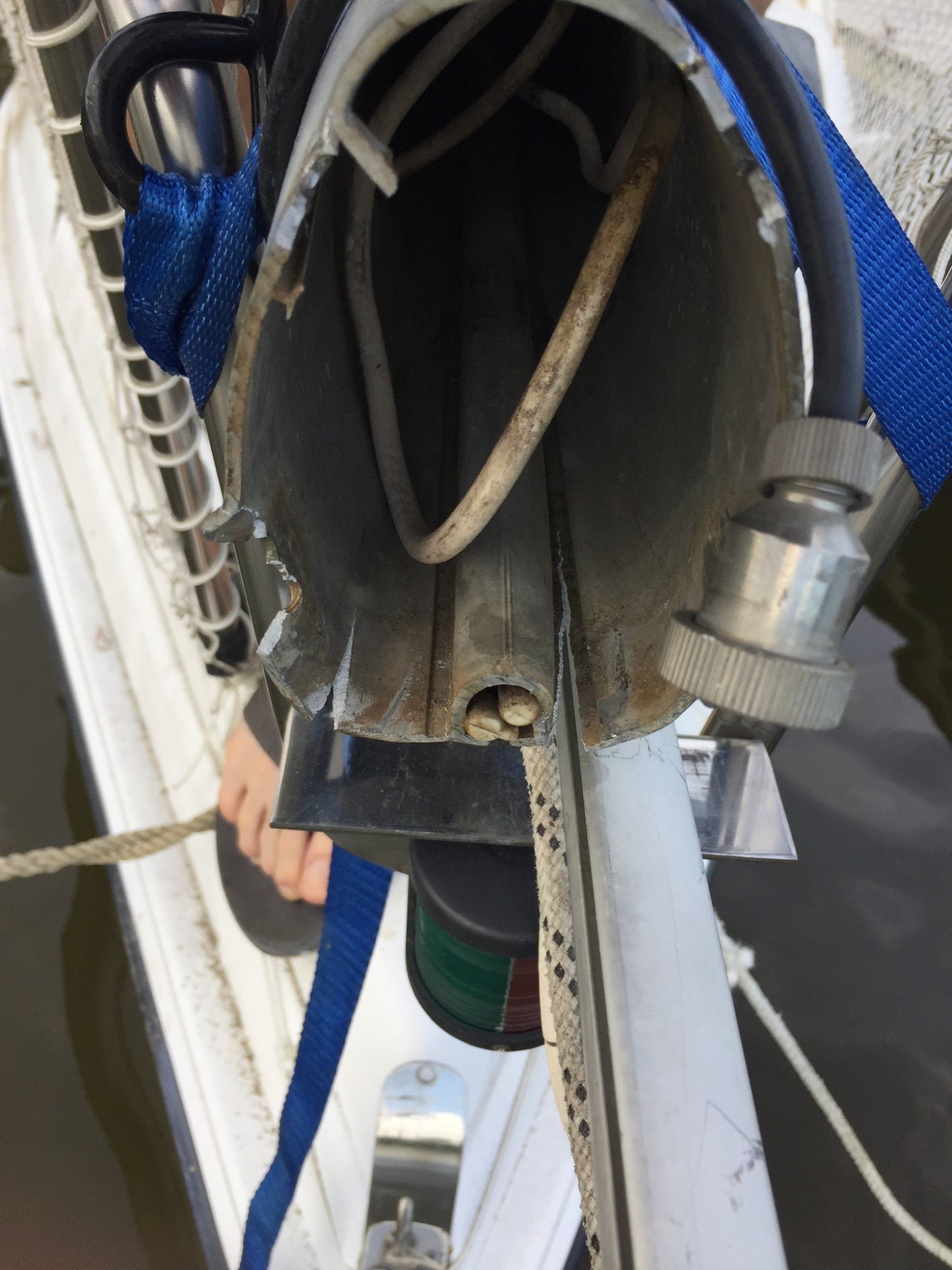

Anyone have experience repairing the mast foot on a 1995 Hunter 26? Any advice is welcome.
We tried to raise the mast today and forgot the baby stays. The mast then pitched to the side and ripped out the mast foot. I was going to order a new foot from this sites store but I am not sure how to repair the base of the mast.
Thanks

Ouch! Sorry to hear about this. That must have been quite a surprise when she came down. As mentioned, there are a few good threads on this for the H26 and 23.5.
You have two options, and one doesn't look possible. That is, dressing the end of the mast and installing a new foot. It looks like you lost a significant amount of mast material around the base edge of the mast. I dont think cleaning it up is a good option, judging from the pics.
The second option is cutting off the damaged portion of the base (3/4-1") and putting on a new foot. Then you have to either shorten your stays, or raise the mast back to original height with a spacer on the deck. There is usually not enough adjustment left in the stays to shorten them enough. There is a good thread on making a plastic spacer.
Good luck, and let us know of your progress and solution. You arent the first, and you wont be the last with this problem.

Sorry for the late reply. I am near Annapolis MD and have found a rigger that is currently repairing the mast.
He is going to cut off about 0.5 - 1" from the base and weld the crack, then reattach a new mast foot. He will then create a spacer to keep the height the same.
The rigger is an very experienced shop that works on offshore sailboats so I am comfortable with his plan of repair.
