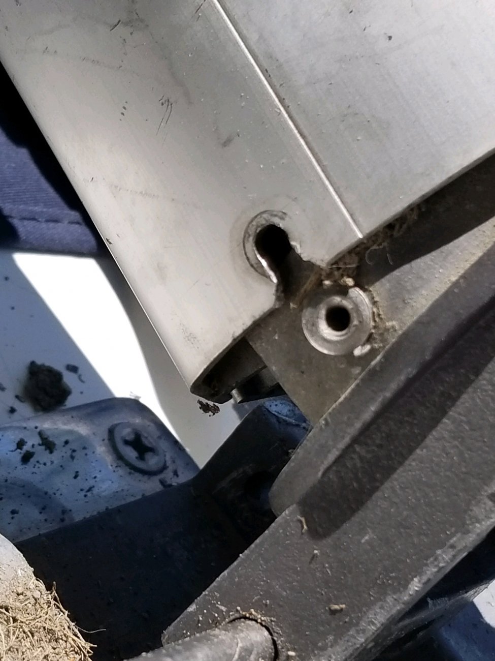

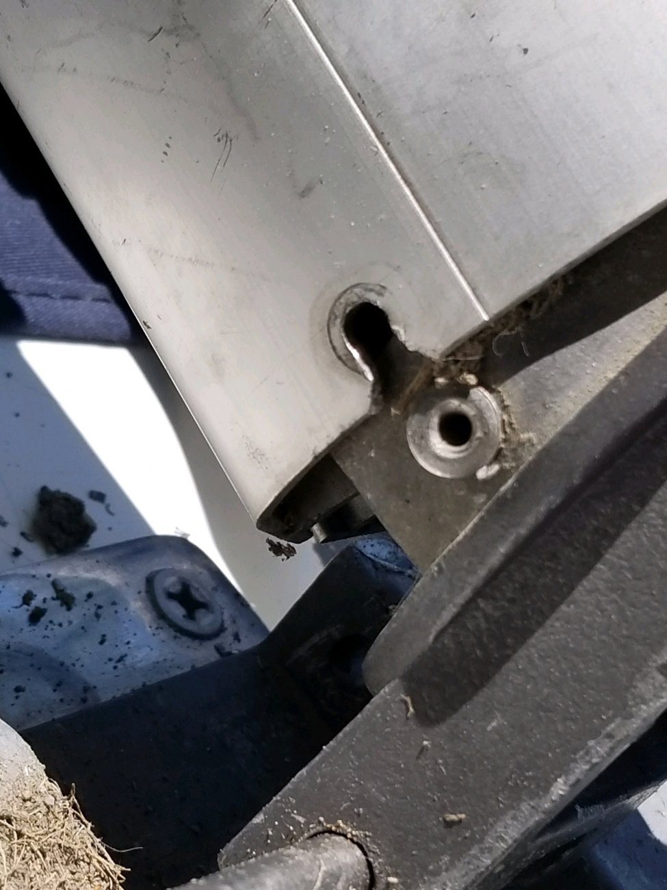

Finally got the boat to the ramp this year and broke the base of the mast because I forgot to connect the shrouds in step 2 of the mast raising ceremony:
The baby stays were on, but without the shrouds connected the mast keeps going until, BANG! Both sides. Ugh. Fortunately, no other damage.
.jpeg
I resisted the philistine impulse to just blast away with more rivets, I mean, it would defy my principles to not pursue every possible, more expensive, time consuming alternative.
So I thought about TIG welding a patch on each side and called a welder experienced with welding aluminum (pontoons). His advice was "don't". 1) Heat anneals the Al and might make the area around the patch soft, 2) He would have to grind off the anodize to keep the arc happy (grounding). In addition, @Crazy Dave Condon cites Hunter directives against this, and @CloudDiver has warned of the perils of welding extruded aluminum. Still, I might be willing to send the rig off if there is technology available to overcome these pitfalls.
Thought about sawing it off and starting over, but that's complicated by shroud length, boom height, sail luff length, balance, rake, and probably the position of the moons around Pluto.
So am I looking at a replacement? Or should I cave to my uncultured instincts and blast away with more fasteners? The vessel is insured, but are they responsible for my inability to follow directions?

Post photos of the entire base before doing anything as it may be a simple fix. But photos first please post photos

Anyway, I think the simplest repair would just be to drill 4 new holes and re-rivet the mast to the base. A properly standing mast doesnt put a lot of bending stress on those rivets. All the force should be straight down. I re-revited my mast base (H 23.5) a few years ago. I used the same original holes, but larger rivets. My situation was, over the boats lifetime the rivets had become loose. Pretty easy job. Check the base of the mast for flatness. Over the years the mast had worn a very slight curve where it contacts the foot from rocking slightly with the worn out rivets. Only takes a good steel straight edge and a file. And lots of test fitting with the mast foot.

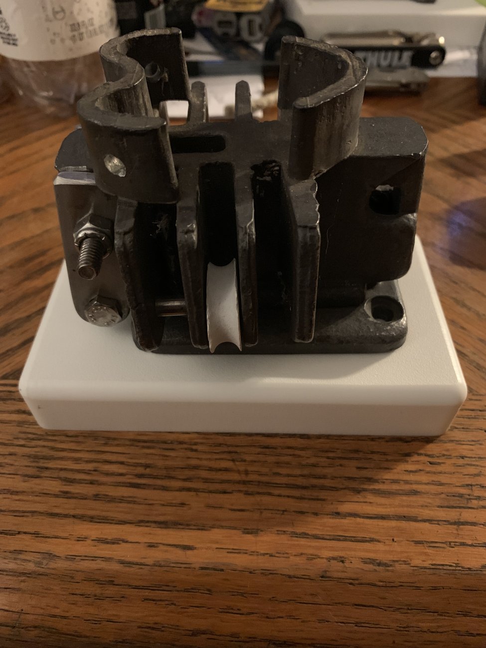

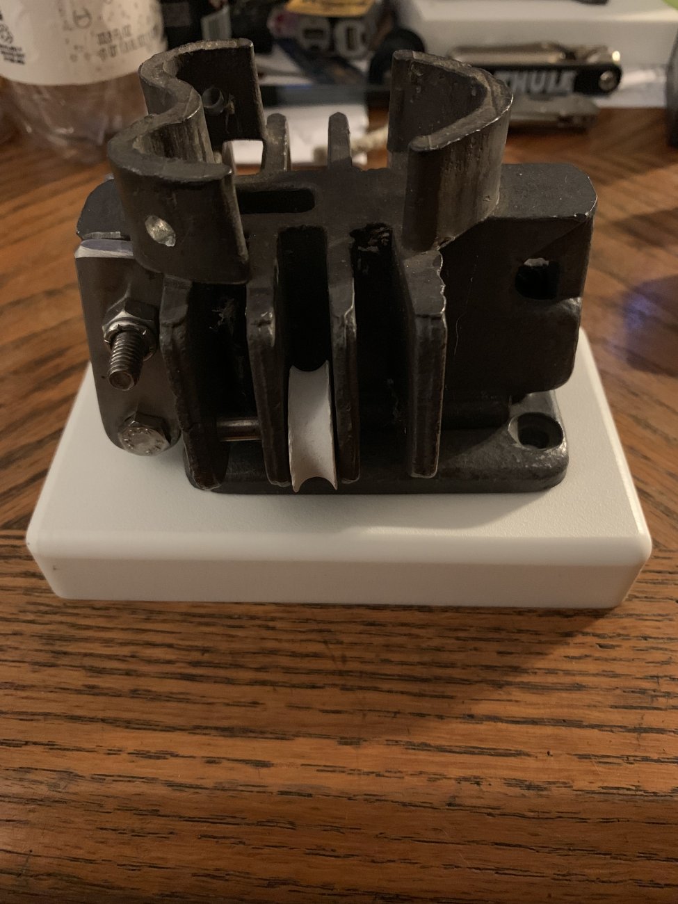

Here is a pic of my 23.5 mast base. For the non-H23.5 folks, the smaller angled pole is not normally installed and is part of the mast raising system. The pic was taken for another purpose. Just the best one I had of a 23.5 foot.
Looks like plenty of room to drill new rivet holes to me.
Shortening the mast doesnt seem like too bad of an idea, if you decide that route. I think the only hassle would be having to adjust the stay length and getting the mast cut perfectly square. My turnbuckles have way more than 3/4" between the two screws. Maybe 2". You will never know its a half inch shorter after the mast is up.

Without disrespecting Judy and Jracer (they are both right), I would take a second look at chopping off 3/4" (or whatever) and restepping. I suspect it will be within the range of adjustment and might be super easy and strong as new. Maybe. Check everything.

The rivets are there principally to keep the base attached to the mast when not stepped.
The quick fix is to add more rivets. My concern would be that the holes where the rivets were will split as there is no support at the bottom of the hole any longer. Were it mine id finish out the summer with the additional rivets and then cut the mast at the top of the rivets holes cant imagine the half or three quarters of an in would be noticeable. The tough part will be cutting it straight and perpendicular to the mast. If you have a chop saw that might be the way to go.

I'd do what CrispyCringle recommended. The rivets do essentially nothing once the mast is up. They only (IMHO) keep the base on the extrusion while you are raising lowering. If you can easily drill new holes to fit the 4 or 5 rivets you'd need, just re-rivet. Not sure if all holes were split or just the one.
FYI, I'd use aluminum not steel rivets. If the mast tilts again, best to sacrifice the rivets and not the mast or fitting.

First the original plans for the 23.5 were submitted to Hunter by me and as a dealer nearly sold a quarter of the production but mainly I worked on them as well. Your mast came from Z Spar and the manager and I were clos friends whom I consulted in problems like this.
First do not shorten the mast. If the standing rigging has stretched and you have some room left, by shortening the Standing rigging, you in essence will have loose rigging which you will have costs to repair. In addition, many do not cut the mast square and true causing additional problems.
per what was suggested by @CrispyCringle,
and Z Spar, I would simply removed the old pop rivets drilling four new holes using pop rivets to the mast base. As mentioned the loading is downward and would not affect the mast by adding additional pop rivets for securing the mast. Every fix this way I did held even one boat I recently saw performed over 20 years ago has held fast

Strongly suggest posting photo of the base of the mast
I can’t seem to find one anywhere on my phone. The forward “hole” is a triangular tear that’s about fairly wide at the base. The 2 aft holes are about the same if not worse. I may be able to put 2 rivets into the front of the mast but the sides/ rear is toast.
