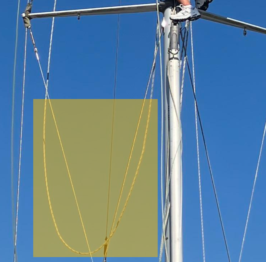

Hi
I looked as closely as possible at your on-mast photo, and it looks like you were only on one halyard. Please tell me I’m wrong.

Hi
You can clearly see that the main halyard is also clipped to the bosum's chair. It is the line that is looping down on the aft side of the speader. It aught to pull tight a few inches before he hits the deck. :yikes::facepalm:
Yes, I did see that.
But, my procedure for man aloft is to have the secondary halyard tightened as the primary is pulled. Lowering is reverse order. I always hate 2 people in the cockpit. You don’t want a guy falling 15 feet before his safety takes effect.
I’ve been up as high as over 200 feet on rigs, and almost got dropped more than once owing to crew error. I’ve also known 2 guys not as lucky.
I totally agree. It is apparent that was the intention, but somebody dropped the ball.
I actually have three lines on me when I go up.
  1. I climb one step at a time on a static line with a prusik knot on stirrups to lift myself and a "lineman's belt to lean back into.
  2. I have my climbing harness on a halyard that my wife pulls up tight after each step for me to sit in while I adjust the prusik/stirrups for the next step.
  3. I have another halyard attached to a seperate safety harness which my wife draws up every few steps. At no point can I drop more than a few inches no matter what breaks.

Fabulous procedure.
I totally concur.
My worst “oh sh*t” moment was 200 feet up, when the winch guy got distracted, and I was literally 3 feet from a very, very, bad situation.
Unfortunately, on the really huge rigs, they only use one line, (as they are huge), and you’re in a harness ; no chair.
There was an awful situation on an Amels 53 a few years ago. The husband had his wife singularly hoisting him on a large winch, and she had it in the self tailer.
There have been problems with the Lewmar winch switches, that they can stick closed.
I’ve actually had this happen on my boat.
Anyway, her husband is flying up the mast, and she panicked.
Instead of simply taking the line out of the self tail, and letting off 2 wraps (so that the ascent would stay static), she got her hands into the line, and it was absolute carnage.
Worse still, a passer by jumped on the boat to help, and he also got his hands seriously mangled.
Lesson:
If your power winch stays “on”, the line won’t go any further if you reduce friction
Quickly peel off wraps, and yell as loud as you can for help.
Then tell whomever to shut off your battery switch.
It’s a good idea to rehearse this in your mind.

What you don't see in the picture is my safety line. When I go up solo I use an ascender (for going up) and a gri-gri (for going down) on an actual climbing rope which I tie off to a halyard and hoist so my climbing gear friction surfaces are on the proper type rope, then I have a separate halyard as a safety line.
That day I had a winch operator so he hoisted me on the halyard and I used the gri-gri/climbing rope as my safety line. The loose line you see was attached to my toolbag and was loose after I hoisted it up.
I may be crazy - 66 pages of boat repair proves that ;) - but I'm not that crazy! Plus my winch operator climbs Navy masts for a living - he wasn't going to participate until he was satisfied.

Thanks. This is the only way that this fat old man can go up the mast with just the help of my most trusted helper. We go slow but it is totally under control and fully redundant.
All good.
I’m glad that I was wrong on this !!!

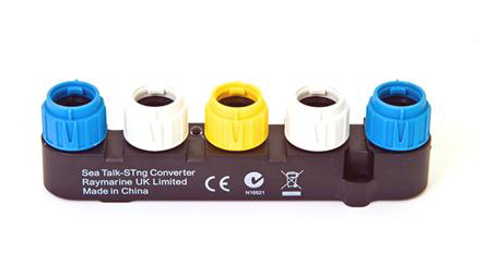

Help requested on a totally different topic:
A friend down the dock asked for my help the other day and I have to admit I'm behind the curve on this one!
His Raymarine chartplotter has given up the ghost and he's looking at replacements. His electronics are as follows:
Chartplotter: C80
Depth, Speed & Wind: ST60
Autopilot: not sure of the model but it is Raymarine as well
I'm not sure of the age but the boat is a 2002 and the electronics might be the original installs. He's looking at either replacing the chartplotter since the other instruments and autopilot are still working well, or a total replacement of everything if the new one won't play with the older instruments.
I've always had Garmin and all my new electronics are Garmin as well so I'm not too sharp with Raymarine. I suspect that the brands aren't that much different, but rather his problem might be incompatible cables, or Seatalk vs. NMEA 2000, or network cabling, or some other insurmountable hurdle.
Anybody with some knowledge care to chime in?
Cheers,
Mark
May 8, 2013
629
Hunter 40 Dataw Island, SC
Update to previous post:
New information - his depth, speed and wind displays have gone dark. He wants to find out if just changing the displays with new units will work with his older cabling. He's also thinking of upgrading the chartplotter to a new unit - that's the big question. Will it play nice with the older instruments and autopilot.
Thanks guys!
Johann
Jun 3, 2004
586
Leopard 39 Pensacola
Yes the old raymarine will be fine with new raymarine or garmin or any N2K. I am running a Garmin 1042xsv with St60 instruments and a raymarine autopilot. Seatalk ng is N2K with different plugs (better imho) and you can get adapter cables. He will have to create a network backbone and get a seatalk 1 to stng converter and then all the old St60 info will be on the N2K/stng network.
