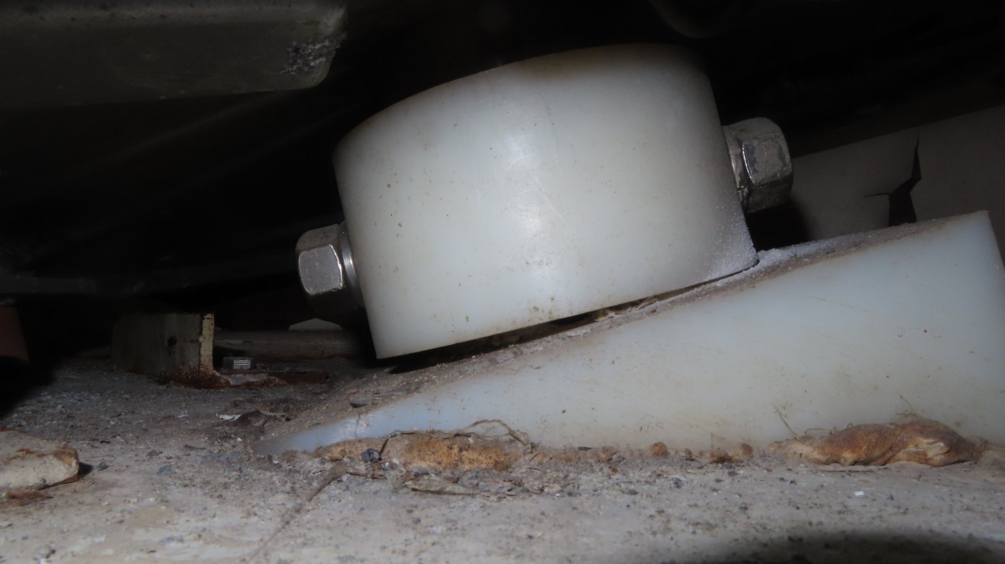

Attached is a photo of my rudder bearing on my H40. The steering quadrant is dragging on the stop angles. The UHMW bearing is not flush with the bearing surface and I am not sure if it was like that when it was built or if it has worn down and now the stop angles are holding it out of true.

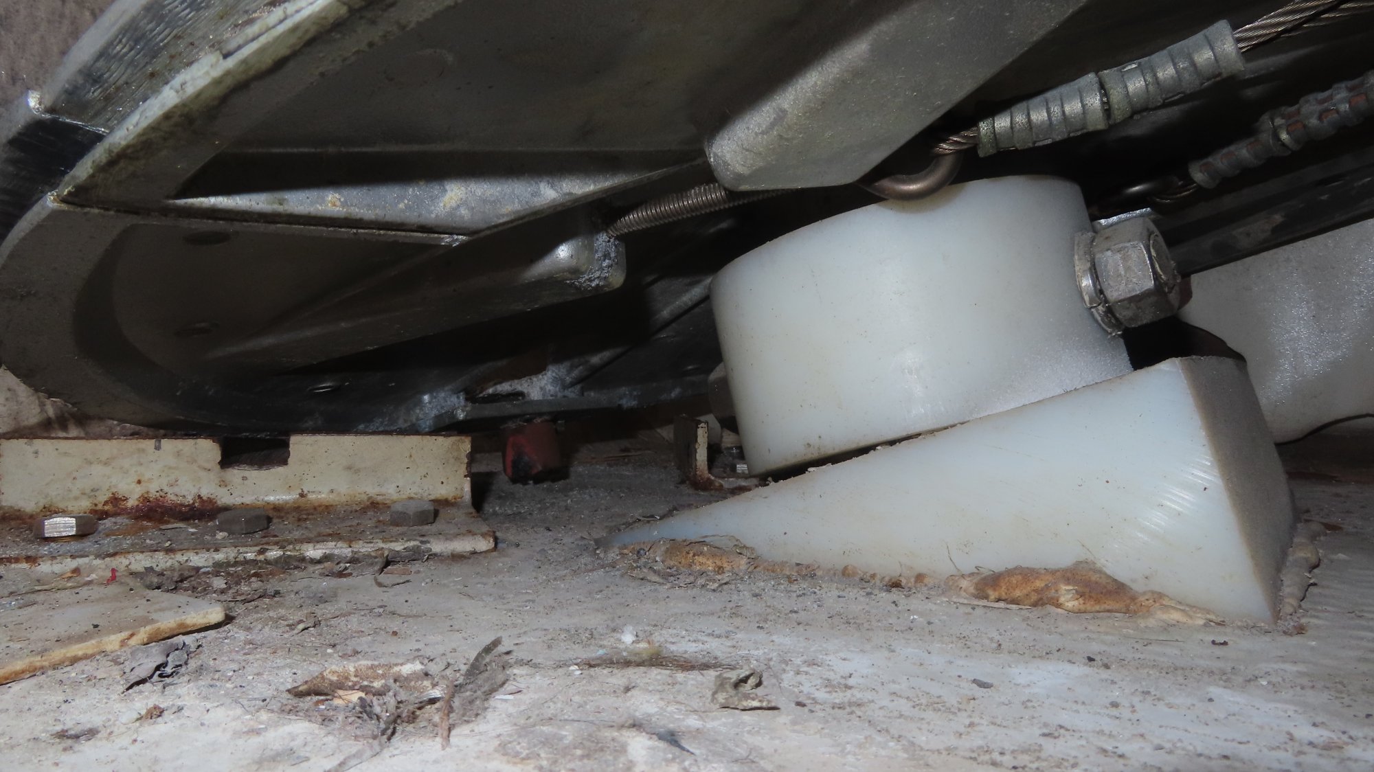

I'll try to remember to get a pic of what mine looks like - was tied up all day today but will be back on the boat tomorrow.
