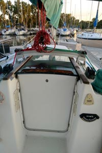

FYI. I replaced my wood hatch boards with "Seaboard". 3/4 inch thick. Had to machine the edge to fit the 3/4 inch track to allow for expansion. Worked out great. Heavier than the wood boards they replaced. But, zero maintenance from then on out. Got the Seaboard in less than full sheet size from usplastics.com. Their tech support was very helpful in determining how much material to remove along the edges to give the needed room for expansion on those 110 degree days we see now and then. PS: was in your neck of the woods last week, son got married in Charleston where he lives. He's a C-17 pilot based there and just got back from the overseas CF moving cattle.
