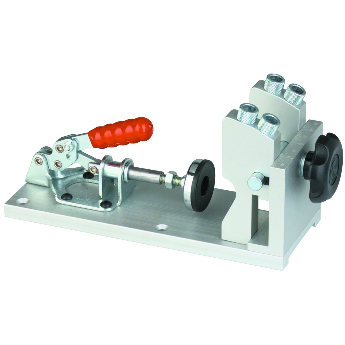

Chip. It is a nice tool. They hook you with the slick jig, then got you with the continuing sale of screws. Like HP and their give away of printers so they can sell you a continuing supply of ink. The HP engineers call it their retirement plan.

A Kreg knock off. Do not know. I bought the Kreg. Works great with consistent hole placement and depth.

Oops, yes, that is what I meant. I could blame spellchecker, but that would be lying. There are other knockoff brands that I have used. The problems with them are two fold. The drill bits do not fit perfectly in the holes, which means the shavings get wedged between the sleeve and the bit. This tends to chew up the sleeve. The bit gets scored at which point you throw it away and buy the good one.
There are other brands of screws, but I tend to like the ones made by Kreg jig better. I tend to use their screws even when I'm not using their jig.
A couple of things not mentioned in the video. Make sure that the two boards are tight before screwing them together, otherwise they mating area will not be flush, because the screw will pull on an angle. There is a cheaper version that does not have the whole clamp setup. It is more portable, so it can be clamped anywhere directly to the work piece. When you drill multiple holes, make sure to blow the saw dust out from under your work piece, so the board rests flat on the surface. Otherwise your hole will be the wrong depth. We replaced their clamp with an air cylinder and a foot valve, which makes it much faster when you have multiple holes to drill along the side of one board.

I agree that pocket screws with the Kreg jig make a very strong joint and we have made a lot of furniture with it. The drawback is that if you are joining two pieces of plywood, the end/edge grain plies will show on one side of the joint. You can avoid this by using the bullnose corner piece without the rabbits to attach the ply to the corner. If using pocket screws, I highly recommend the Kreg right angle clamp and face clamps. if you do not clamp the two boards together for the first screw they have a tendency to shift which causes misalignment.

I have built several cabinet face frames using the Kreg jig and pocket screws. Excellent joinery. I got turned on to it several years ago when I saw Norm Abramson use it on the New Yankee Woodshop series. I always glued a screwed my joints; however, you can actually assemble the joints with pocket screws and not glue, in the event that you want to disassemble in the future.
