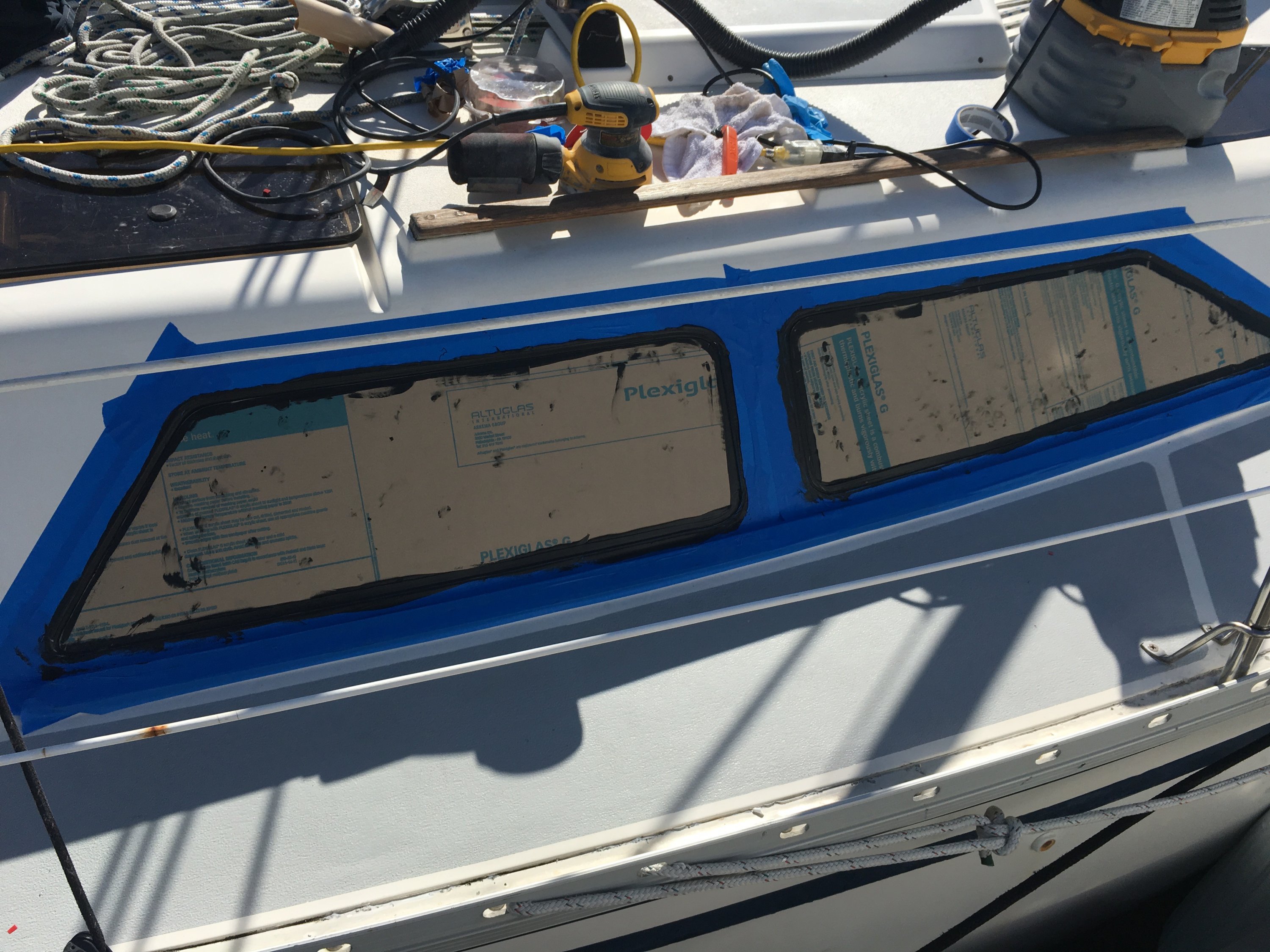

Just did 4 windows on my 35.5. Had the local glass shop cut new plexiglass. Used the DOW 795, take your time and prep. I put some small spacers in between the window and the window track. This kept the sealant from all pushing out when I compressed it. It is so so nice not to have leaks! Good luck and feel free to reach out with any questions. Its a lot of work! : -)

Thank you. I used a lot of sealant, I filled the "gap" between windows with sealant just like Hunter did. When I set the plaxi and pushed it into the sealant it did not move again. I had read in many of the forums that I may not need any pressure on the windows while they cured and I did not. I am very happy with how they turned out and have 4 new widows. The old ones were crazed, cracked and leaking. (25 years old). Two full days of work and $300 in materials.

I would get a tube per window, they only cost me $7 a tube, better to have more then not enough. I pulled the paper off the glass the same day and then started the clean up 24 hours later. The spacers are 3m vhb tape as njlarry mentioned above. Good luck.

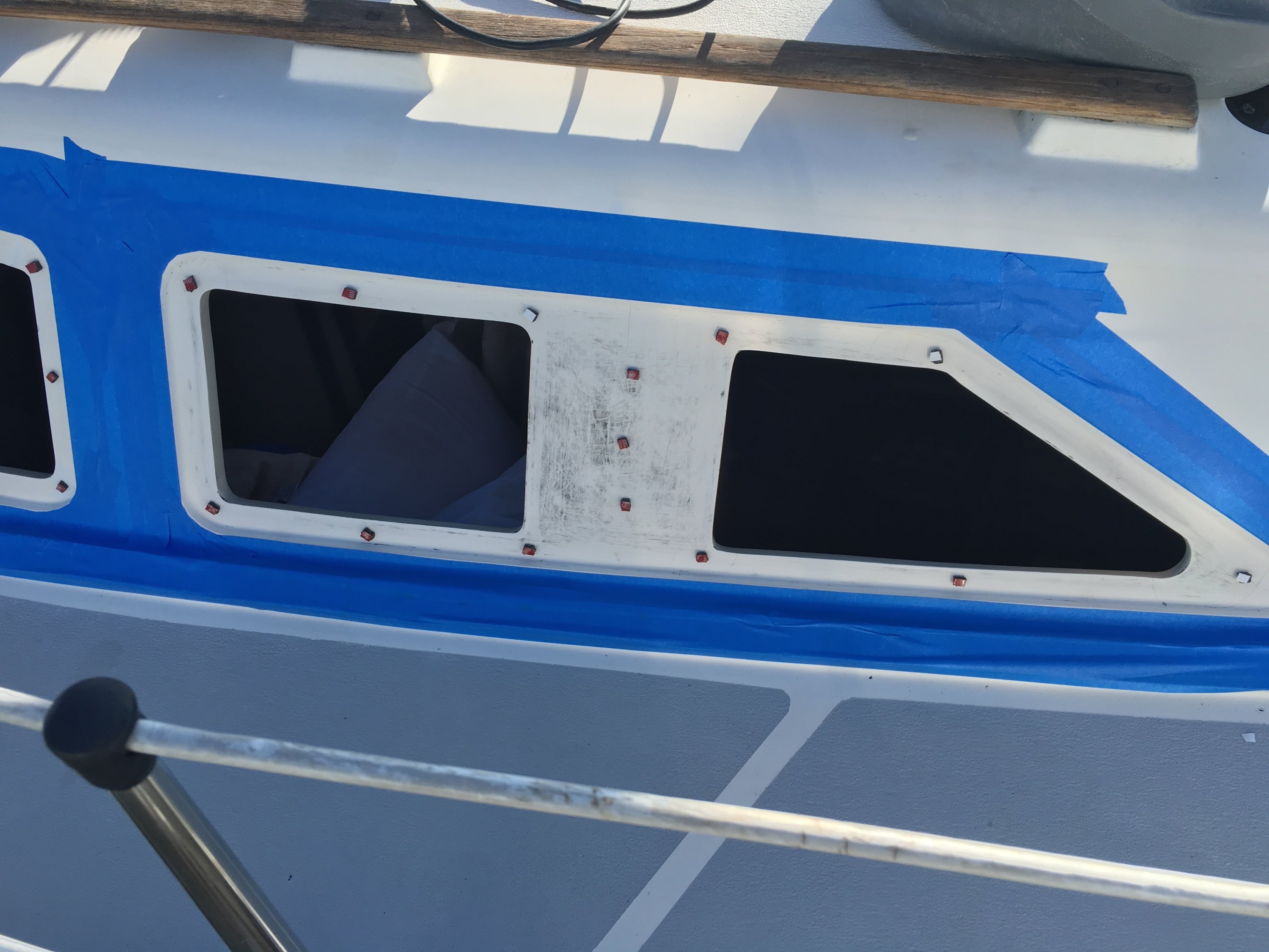

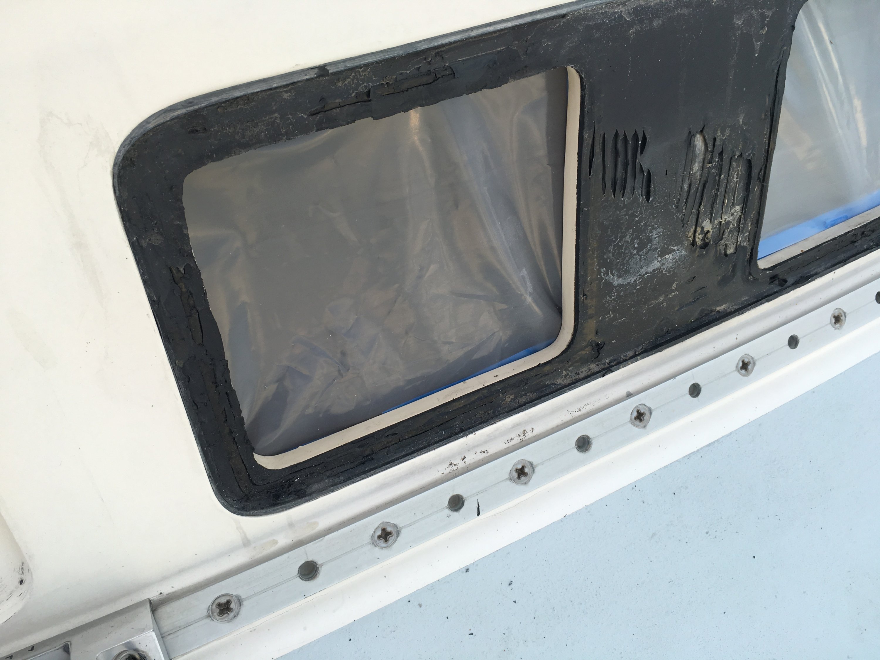

nfg2u- in your pic one- all black- is that all sealant that you had to clean off- as in the following pic 2- now all white?
I have o do my big side front salon window in my H42!
nfg2u
Feb 13, 2016
92
Hunter Legend 35.5 Fort Pierce
@eianm Yes all the sealant had to be scraped out and off. Its wasn't horrible but it took some time. I sanded some of the area as well. The better you prep the better your results will be. I re-filled the entire area with sealant just as it was before. Hope that helps.
