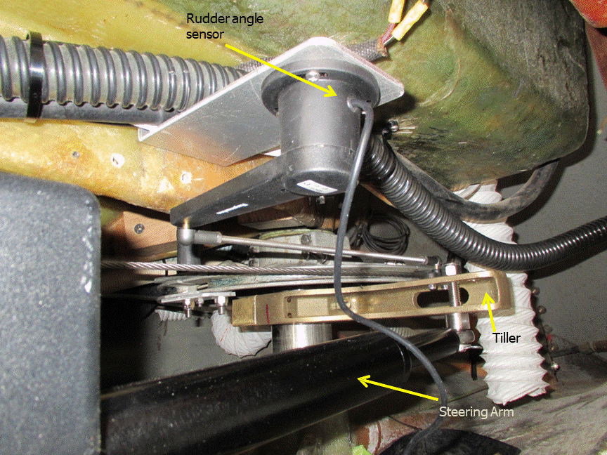

I have a rotary drive that would allow the AP to drive the boat with no wheel, cables or chain. The drive unit is removed in this picture, it's a chain drive, same kind of chain as you see on a wheel. Not something you could fit under a cockpit panel in Hunter 336 though.

Wow, thats a cool rotary drive but something that I'm pretty sure is unique. Not easily adapted to other boats and probably pretty expensive compared to a linear drive. Cool none-the-less.

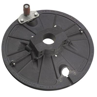

I think it is really important to consider the material used in manufacture of the quadrant. The radial drives made by Edson that many of us have on our boats (at least from the 1990s) on appear to be made of cast aluminum and are essentially pretty thin "plates." In fact, when mine was off my boat to replace the rudder I was afraid of dropping it after I saw how thin it is and how it sounded like you struck a dinner plate when you set it down on concrete. I am sure it is engineered for the forces applied in the design application. It is very beefy where you clamp it to the shaft and a little thicker where the steering cables run in the grooves around the circumference. I'd be worried about "point loading" a high stress inducing component like a linear drive. As an Ngneer we typically design in a "factor of safety." You can probably lift a 2000 pound load with a nylon sling rated at 1000 lbs (based on the safety factors in sling design) but should you? As @jviss said just because it works doesn't mean its within the design loads for the component.

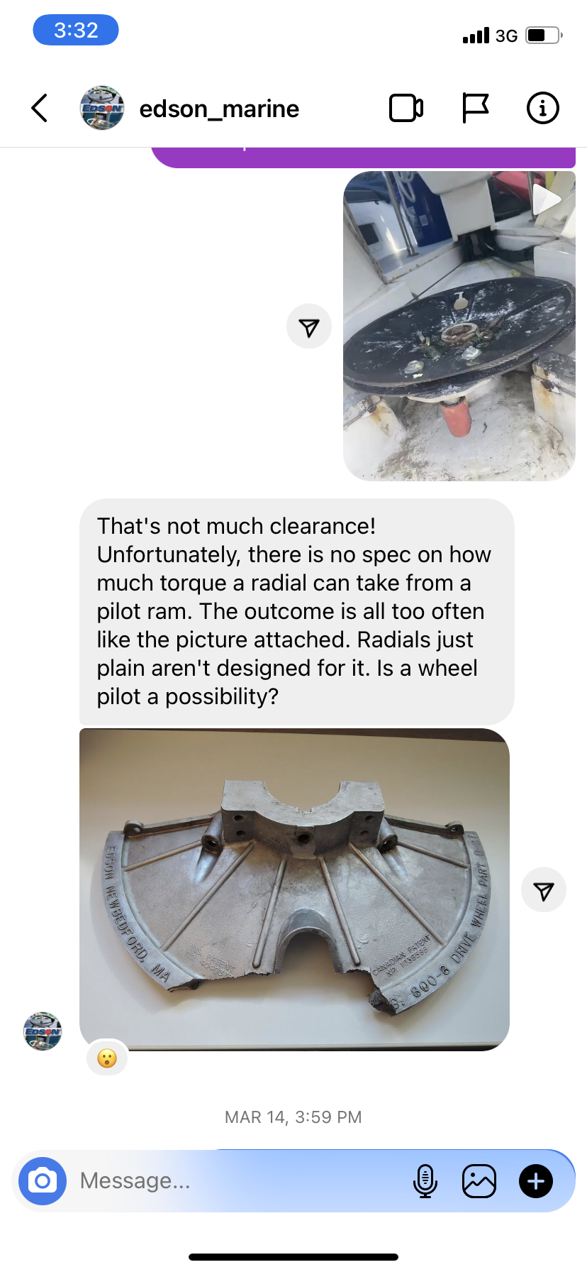

I thought of that already, I was told to buy an Edson tiller arm to connect Autopilot mechanical to the quadrant. I wrote Edson (they made the quadrant for me) here is their answer
questions for you:
Do you have the AP mechanical arm attached directly to the quadrant? is it Bronze of Aluminum?

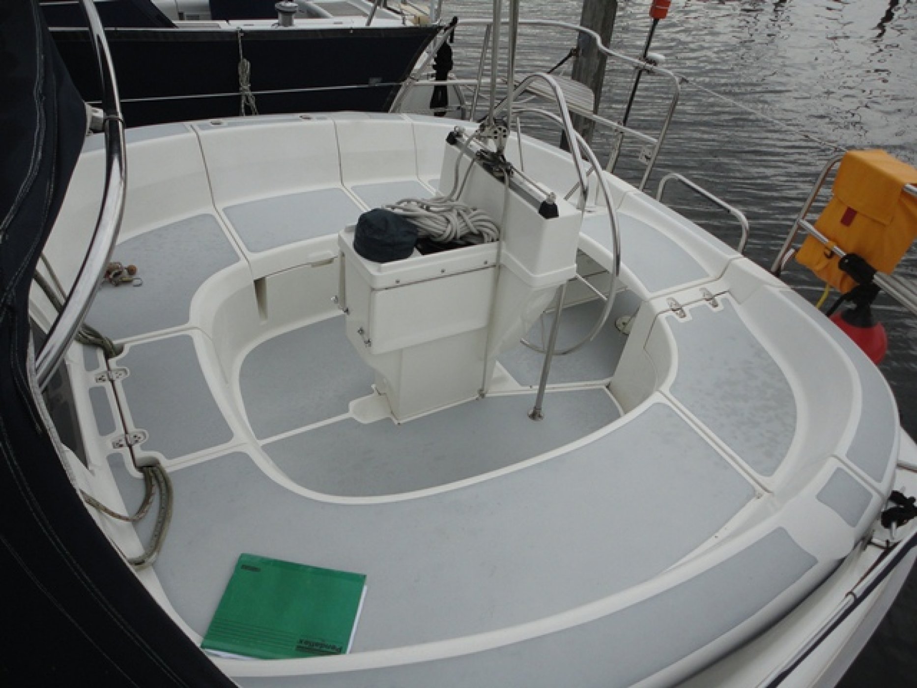

As Higgs points out, you want to attach to the Quadrant which I'd assume to be above the pictures, it's where the steering wires attach to the post. Not familiar with your boat, but on some there is a panel on the cockpit sole that must be removed for access.
And do not cut that, I think it may be necessary and it's not where you need to go anyway. Your looking for one of these.

to attach the AP Linear arm to the quadrant, I was told to buy an Edson tiller arm to connect Autopilot mechanical to the quadrant. I wrote Edson (they made the quadrant for me) here is their answer

I thought as well of attaching the AP mechanical arm directly to the Quadrant but I was advised against that by Edson, the makers of the Aluminum quadrant. see picture. The suggestions are to attach the AP arm to the rudder post by means of using a tiller arm

Whatever you do, don’t cut the post housing. Your boat has to have a quadrant to which it should be attached.

It looks like the quadrant is under the panel behind the wheel. Open it up and see if there is room to add the arm you bought. If not, just get a fitting to attach the linear drive to the existing quadrant. I would not want to cut into the rudder post tube.

Remove the sole under the helm seat to reveal the quadrant. There isn’t enough room to add another tiller arm. You should replace the quadrant with one designed to support an autopilot linear drive with an attachment point at the rear (Jefa?). Install the drive in either port or starboard lazzerette and drill a hole to connect the arm through to the quadrant.
that is a great suggestion ;) I only know about Edson Quadrant Edson calls them Radial drive unit The one they make they suggested I dont connect AP arm directly to the Quadrant.
That makes sense what you wrote about the Edson Quadrant, I asked Edson & they dont suggest to connect AP arm directly to their Quadrant which they make in cast Aluminum & Bronze.
What do you think of Jefa Quadrants
It looks like a replacement quadrant, made with the auto pilot connection point would be the way to go.
You don’t have room for a separate tiller arm, and Edson doesn’t recommend attaching directly to their quadrant…
