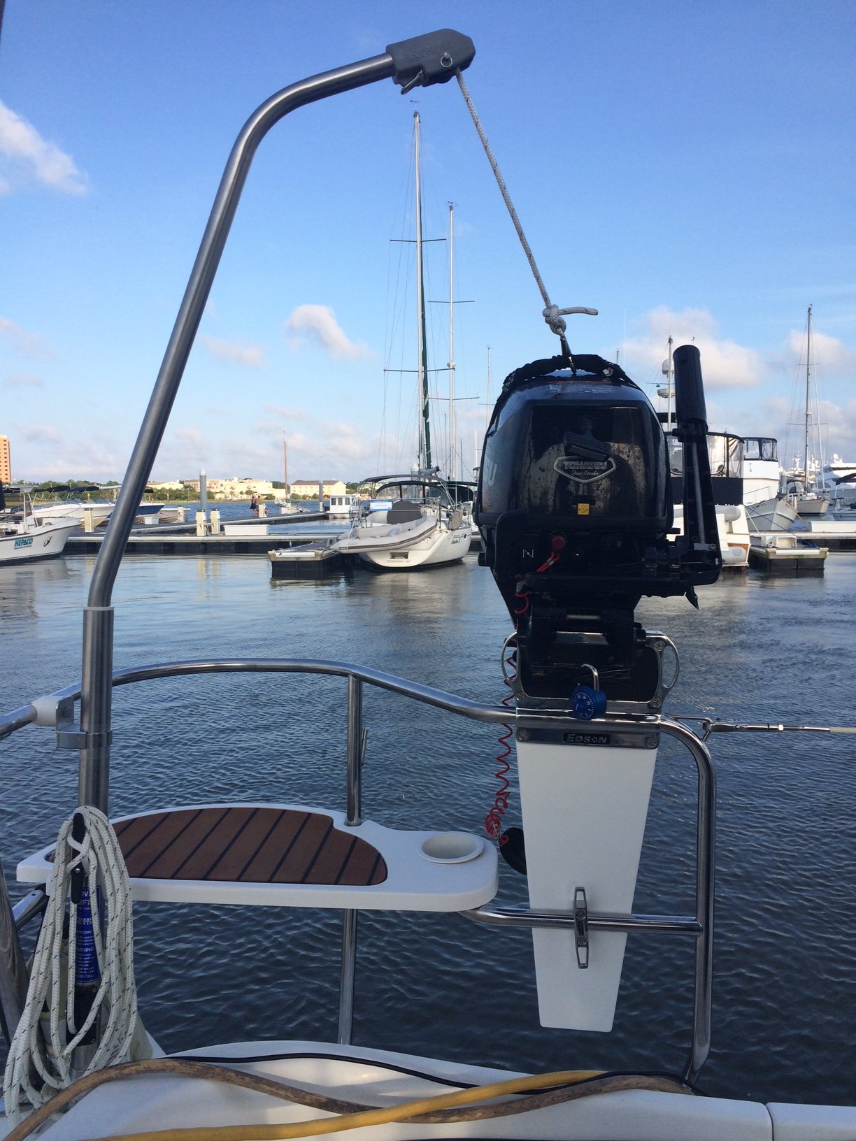

Well... I just purchased an Edson Marine mount at West Marine for $279 (Ouch!).... However, it only needs two rails perpendicular with each other... It appears to be a large mount, maybe best for my 85 pound 4 stroke... I also purchased the Nova Lift... I figured that it is time to stop playing games and get this thing done right. I had a close call last weekend and almost lost my Tohatsu.

Edson and Nova Lift installed. Works great with two people. I struggled a bit with trying to use it solo. It can be done, just need to protect the motor with some life jackets or something. It tends to want to scuff the boat with blue Tohatsu motor paint.
