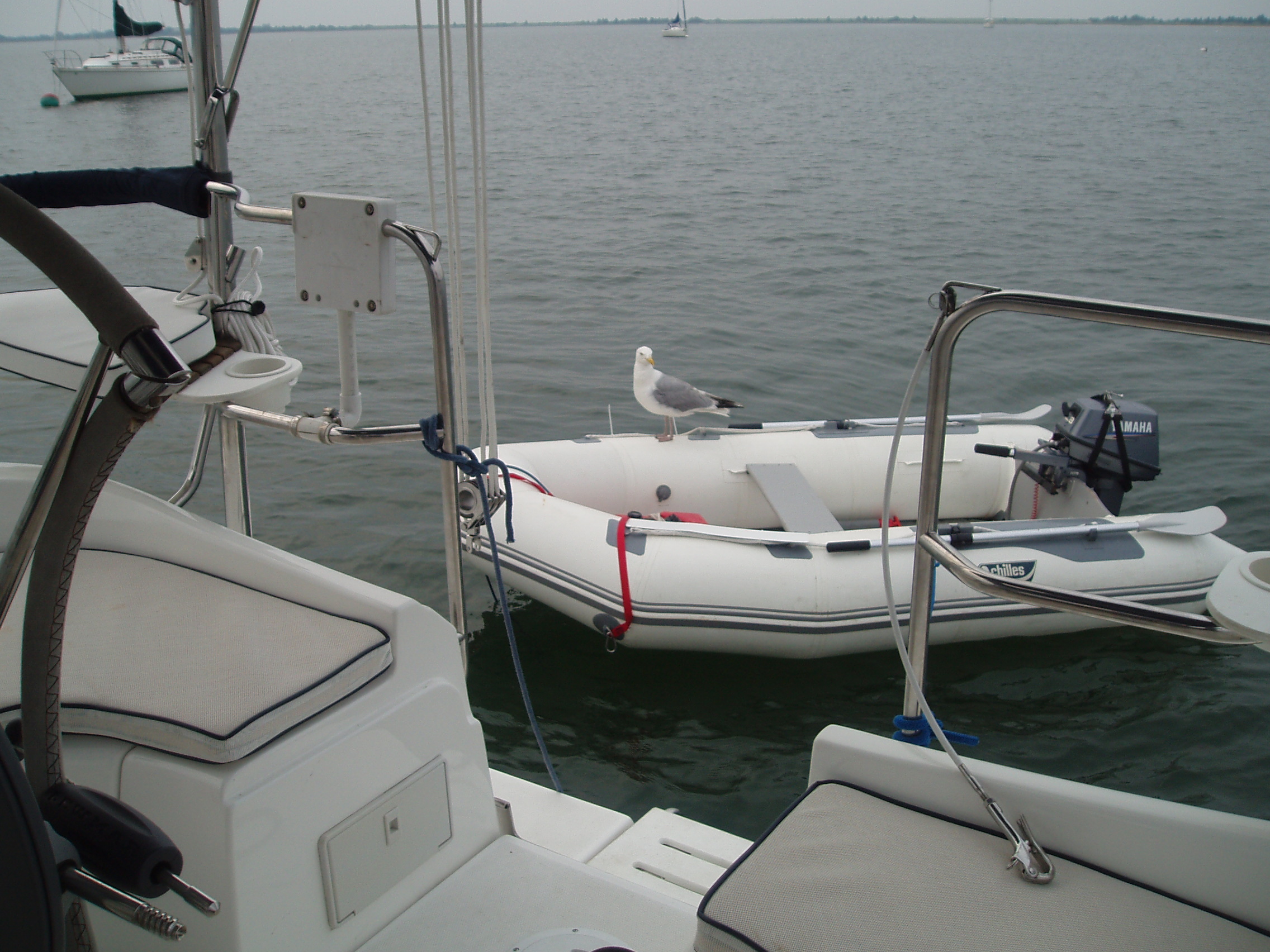

May 12, 2004
1,505
I have a plastic two-piece rail mount that clamps on where the vertical rail meets the horizontal rail. As others have said, mount it where the vertical rail takes the load.

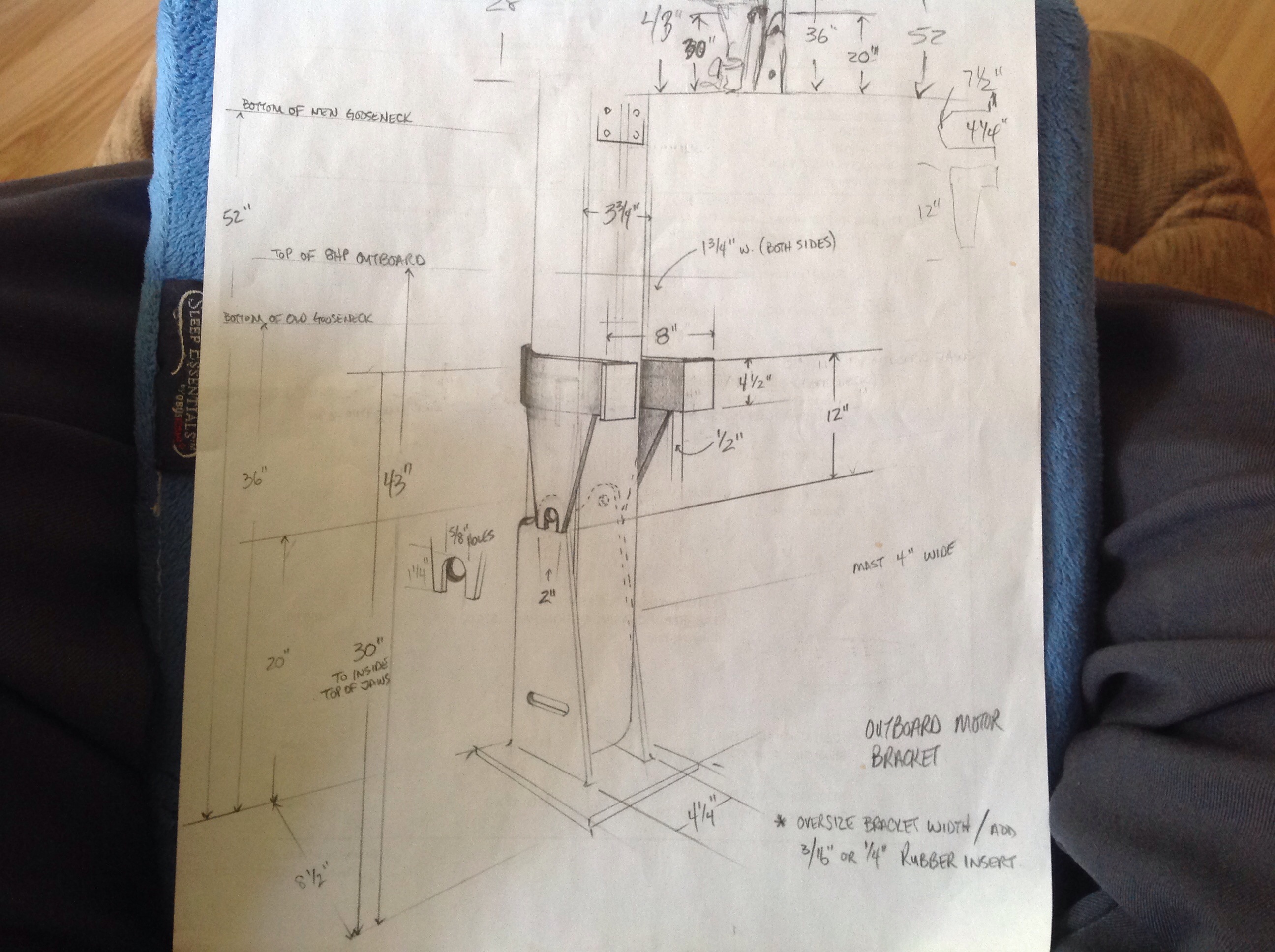

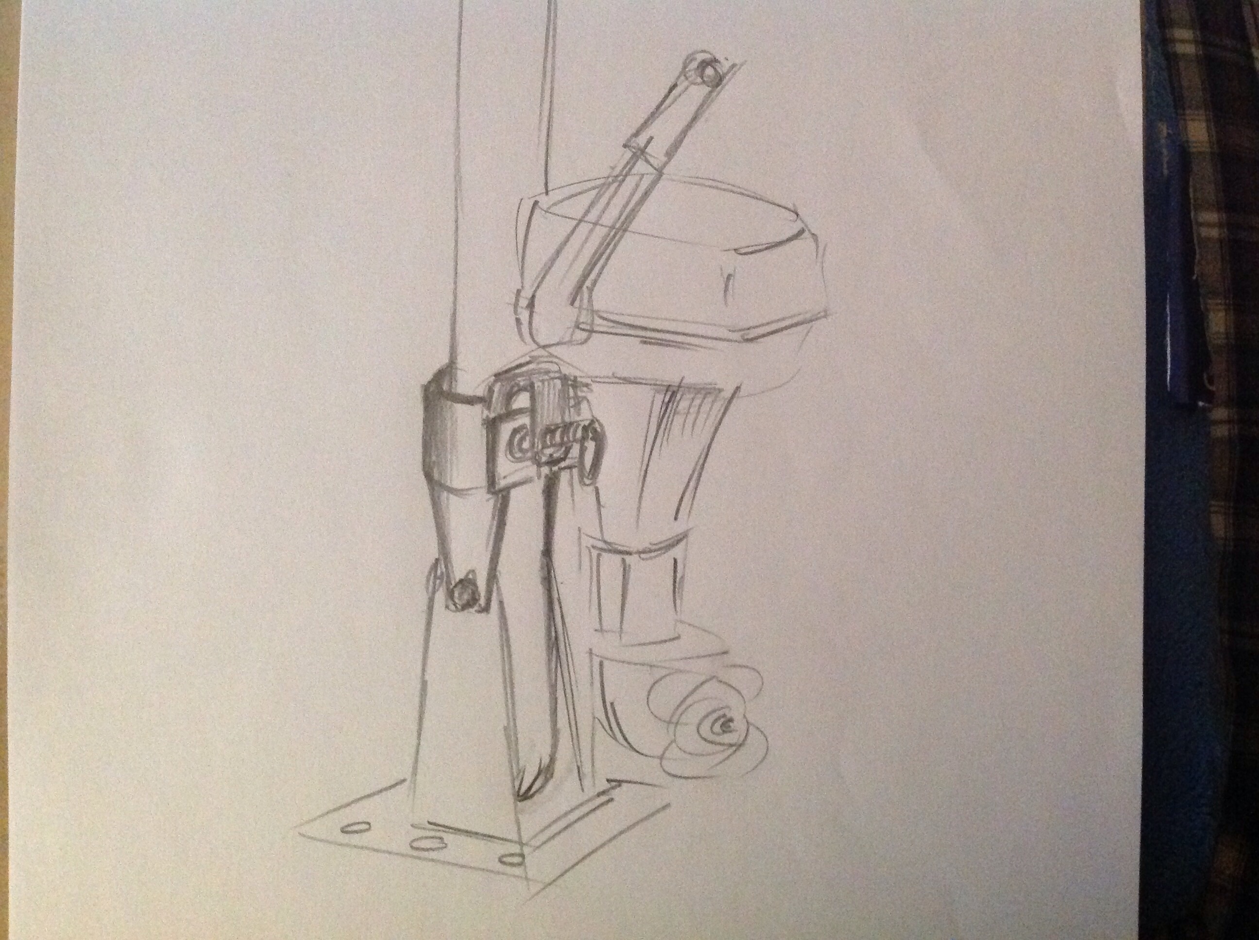

Feb 11, 2012
271
C&C Mega 30 Long Point, Lake Erie
Came up with this...having it made as I type.
Mast tabernacle aluminum outboard mounting bracket.
No holes drilled, no extra hardware....use extra halyard and winch to lift on and off the dink.
